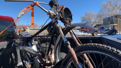

Captonzap, this was my old one… :ugeek: Victor
