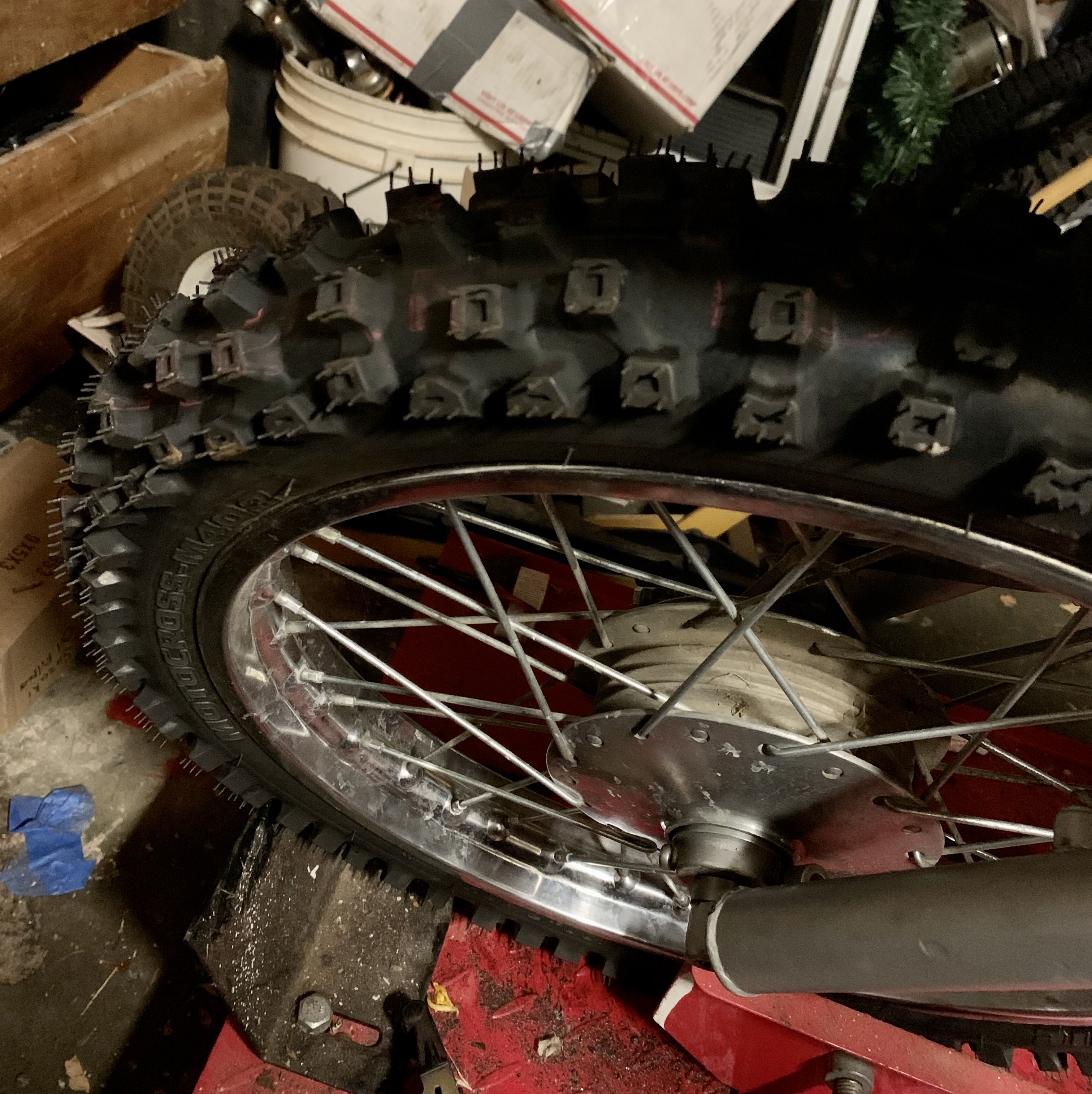

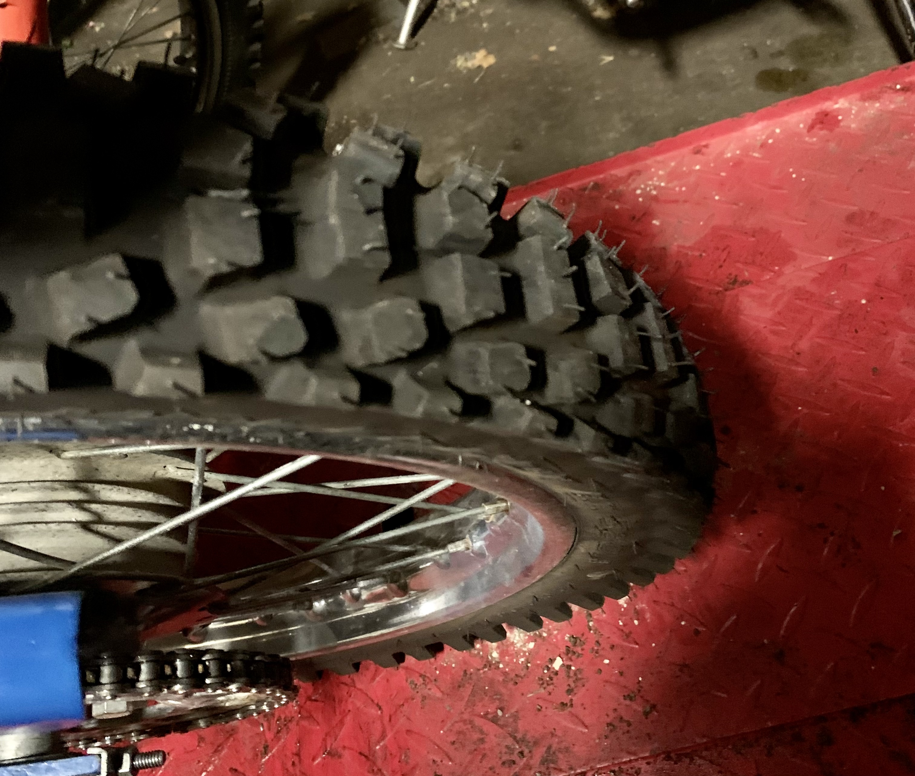

My 90 has a Shinko HoleShot 520A a 17 X 2.75 on the rear and a Bridgestone Motocross M100, also a 17 X 2.75 up front. Here’s pics of both the front and rear tires.
