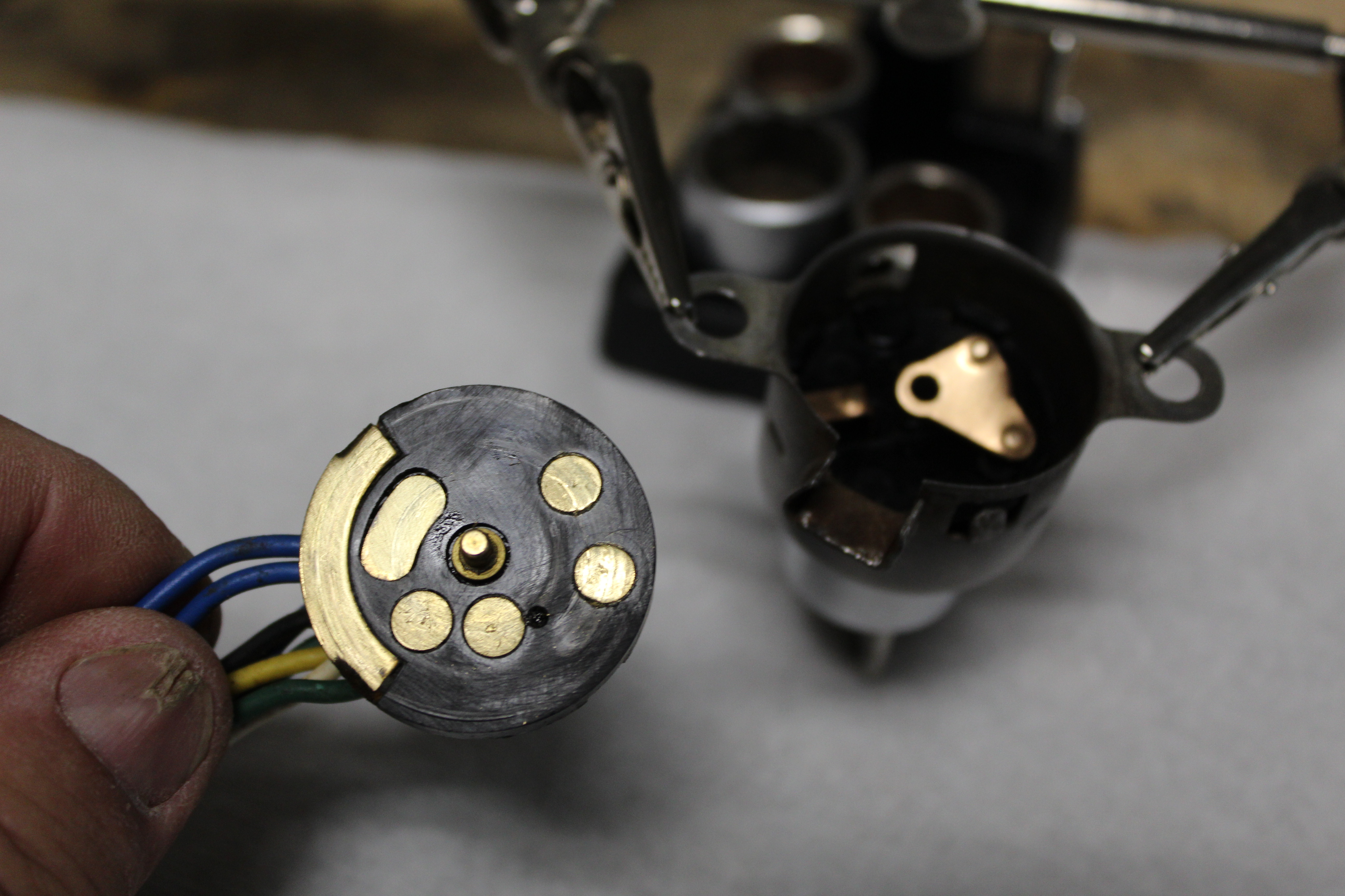

Howdy,
Does anyone know of a source for the internal wiring diagram of the ignition switch for a 100 Ace? (model 92)

I am doubtful on an actual wiring diagram but there are tables showing the connectivity between the terminals in each key position. These tables can be found on the online wiring diagrams for "some" of the models. Unfortunately it looks like the model 92 diagram does not have this table. You might find the table in a shop manual. I believe that you could use the model 99 table as it also utilizes a 2 position switch as opposed to a model 94 Wombat which has a 3 position switch.
Here is a link to the model 99 drawing:
http://hodaka-parts.com/mfg-subcat-item ... -1&Format=
The table is in the upper right corner.

if you can describe what your looking for in more detail i might have something as i take a lot of pictures of most every thing i take apart ....albert

Thanks for the reply Albert.
Dale pointed me to the site that had the information that I was looking for. I don't know if the switch could be taken apart and reassembled without some major craftiness.
Mostly what I needed was what terminal was connected to what terminal in the various switch positions.

Re: Ignition switch schematic needed
Thanks Dale, that is exactly what I was looking for.
And as an added bonus, you showed me where to find out what the wiring was inside the magneto/alternator.
Now I can ascribe some ohm values to the various coils.
good ,glad you got what you needed but every thing can come apart its the putting back together that i find elusive
