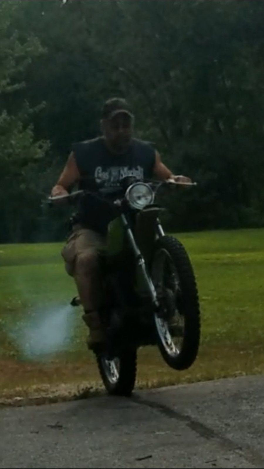

No lights, not one...but seems to run good after its 10 year storage stint with me anyway. 2100mi indicated. Seems a bit lean so I didn't run it long.
The oil on my air filter might be too light. If that dont fix it I'm going to check main jet..160 is that correct? Hoping I don't have to pop a seal in it.
Thanks for the help on here.
76 alive!

Re-oiled the filter properly and it ran much better. Actually had to raise idle speed and add more air screw. Running both injection and 50:1 and started dropping the plug. Decent amount of smoke so ill try straight gas now.
