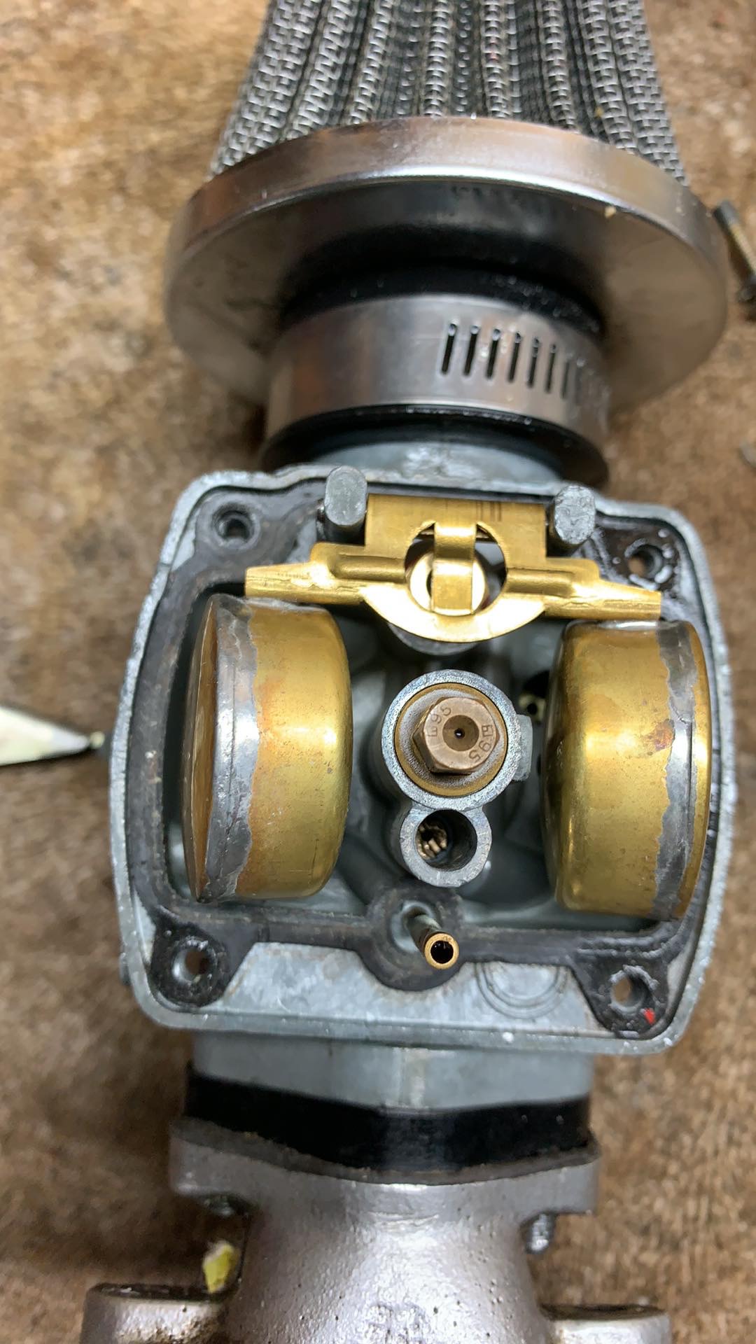

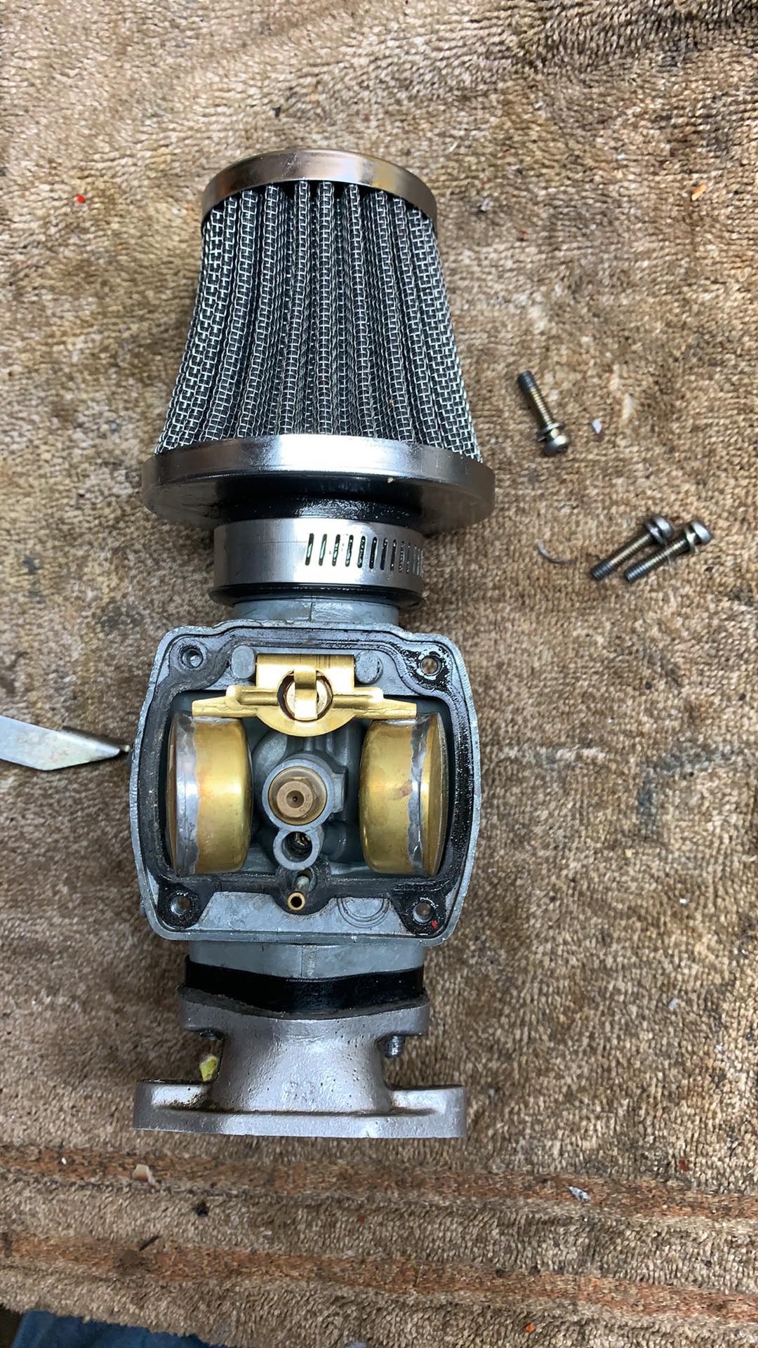

Well, we figured it out! Alan’s original statement that the carb leaked on one bike & not on another was not a correct statement.
It turns out the brand new floats put into the carb we’re rubbing against the side of the bowl. It caused the floats to hang and therefore the fuel flow did not shut off when the bowl was full.
A simple bending inward of the floats to avoid the bowl edge was all that was needed. Here’s a before & after pic! See the right float. :ugeek: Victor
Before...
Before...
After....
After....
