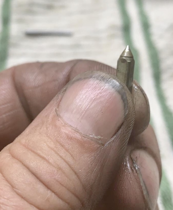

OK. Biggest problem is I’m not hands on. The bike is 1500 miles away. Alan is still green at carb working. Sometimes I have to restate what to do more than once or twice.
I’ve asked him to remove the float needle & seat. The photo shows the condition of the needle. I figure the seat is worn just as badly but he didn’t remove the seat.
He’s going to order a couple more float needle & seat assemblies from Terry in Monday.

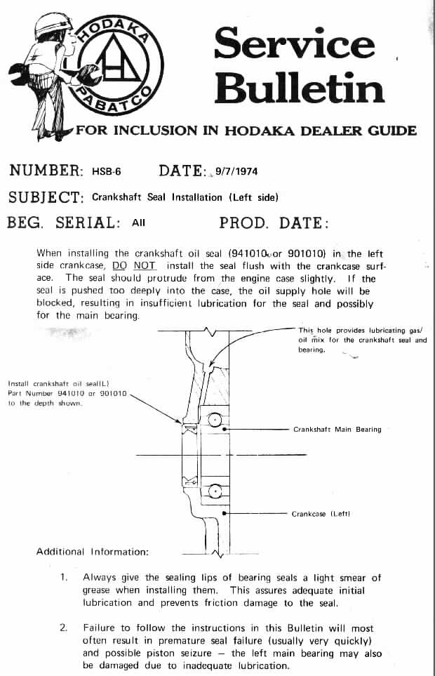

Dang! Sorry I was busy all day today. It was designated as a "burn day" by the county, the winds were low, it rained a bit last night so the neighbor's field of dry grass wasn't a tinder-box AND my burn permit came in the mail on Friday . . . so the day was spent taking care of a LARGE burn pile.
. . . and dagnabit, who knew the one factually erroneous bit of information posted in this thread would be one which was acted on. The magneto side seal should NOT be pressed flush with the cases.
So now, in addition to the distinct possibility of an air leak - which almost certainly was not cured by pressing the seal flush with the cases - the path for pre-mix oil to get to the main bearing may have been inadvertently closed off. Failure of the mag side main bearing is now a possibility too.
A pressure test is in order. If there is indeed an air leak, rapid and catastrophic seizure is a distinct possibility.
Sorry to be the bearer of bad news.
PS: Did I mention that a pressure test should be completed?
PPS: Slow down. You'll go faster.
Re: Running Rough!
All is not lost by pushing the seal flush with the case. It needs to be fixed but is relatively easy to remedy, however the next step is definitely a pressure test. If all the information in the earlier posts is correct, it still could be a carburetor issue. We know that the conditions changed drastically after the carburetor was disassembled. Here is how I would approach it. (This is only my opinion and should be approved or modified by others before being accepted as proper protocol and taking action.)
1. Do a leakdown pressure test before doing anything else.
2. If the engine fails the test, locate the source of the leak.
3. If fixing the leak requires the engine to be torn down, replace all bearings and seals and gaskets in the process.
4. If fixing the leak doesn't require a complete teardown, do the necessary repair, then remove the seal that has been pushed in too far and carefully replace it. It can be done without splitting the cases.
5. If the engine passes the pressure test and there is no leak, the magneto side seal still needs to be removed and replaced. Again this can be done without disassembling engine. I would only take this approach if there is no leak.
6. Once we are sure that there are no leaks and the seal has been replaced, attention can be directed toward the source of the problem.
This is only offered as a starting point for conversation. Good luck!
Posts: 2798
Re: Running Rough!
Ivan's note is spot on. There is one thing I would add - it is important that a pressure test be completed AFTER all engine work is done. Pressure test may be useful multiple times - at the start to identify what and where the leakage is . . . at the end to confirm that all the work . . . worked. The pressure test is the diagnostic procedure which says, "OK. This engine is now proven to be ready to run in terms of air-tightness." Lack of a pressure test is just going with a "gut feeling" that it is ready.

There is a separate issue with the carbs. Both have worn float needle assemblies and so both are causing too much fuel to enter the motor and habitually flooding the motor. It becomes especially evident by the fact that the carb, with the motor off, continues to flow out the overflow tube, even though I have guided him through leveling the floats and that has appeared to have been done correctly.

Re: Running Rough!
Leveling the mag side seal?
"So he has now tackled leveling the left crank seal and will be calling Terry tomorrow morning to order the float needle & seat assembly for both carbs."
Do NOT "level" the seal. See previous post with Hodaka Service Bulletin.
Re: Running Rough!
What’s been explained to me is the seal needs to be level with the case surface into which it is installed. If the seal is higher than the case surface, or below the case surface, this can cause an air leak.
Where do I find said service bulletin???
Ahh. I see it a few posts back! Thx! :ugeek: Victor

Victor read what Ed sent you look again at the picture and reread the script. Sometimes these things remind me of Mission Impossible. All of my last seals I purchased are taller than the origional. Without the leak down we don't even know if the seal failed. A air leak will let a engine over rev, then the needle seat leaking could mess up everything. I would blame me, before I would the machine shop. Does Alan have a ace 90 shop manual?? if not he needs one. I was looking forward to your Oregon visit this spring, stay positive and keep an open mind. ---------------- Clarence
