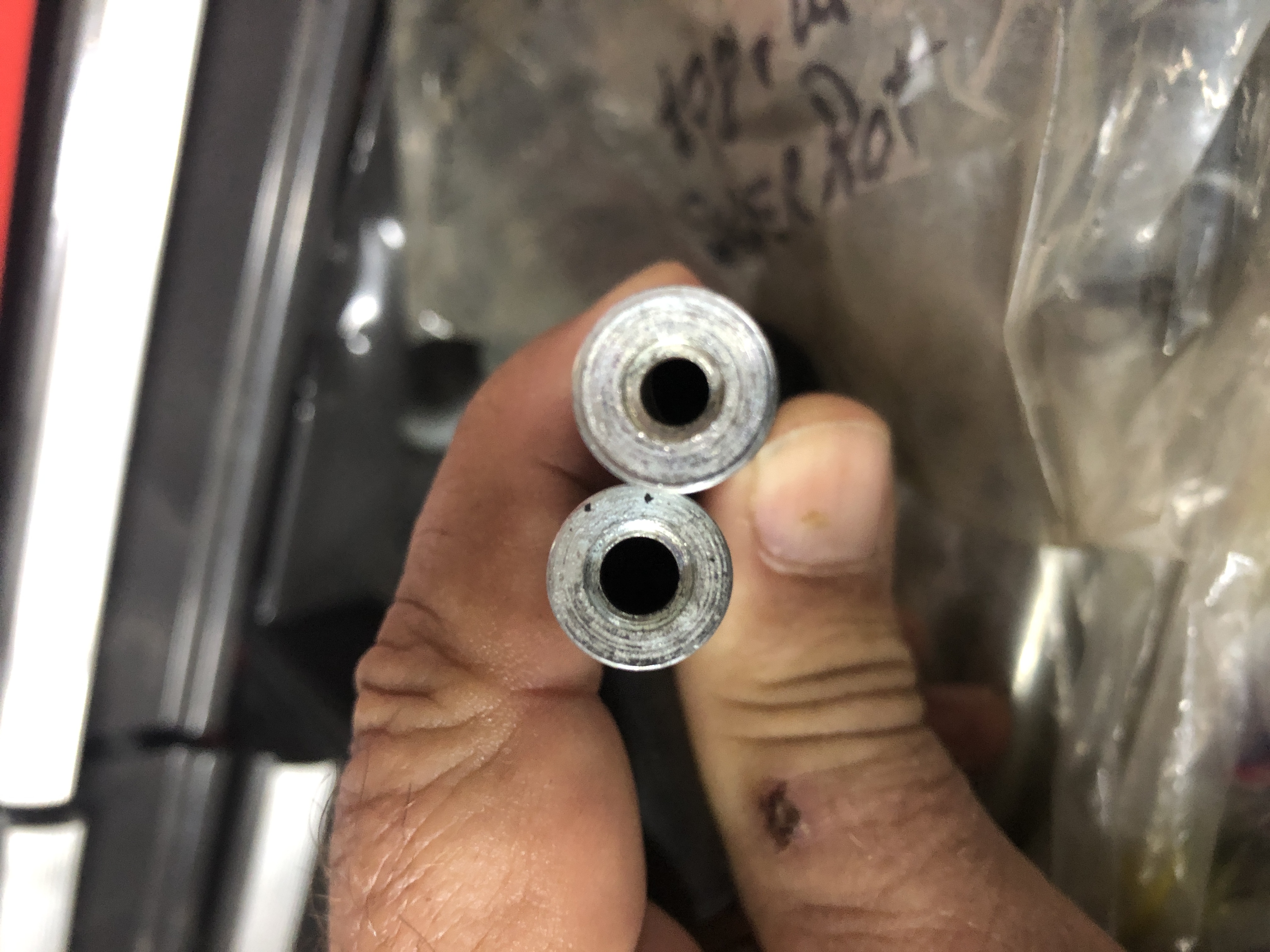

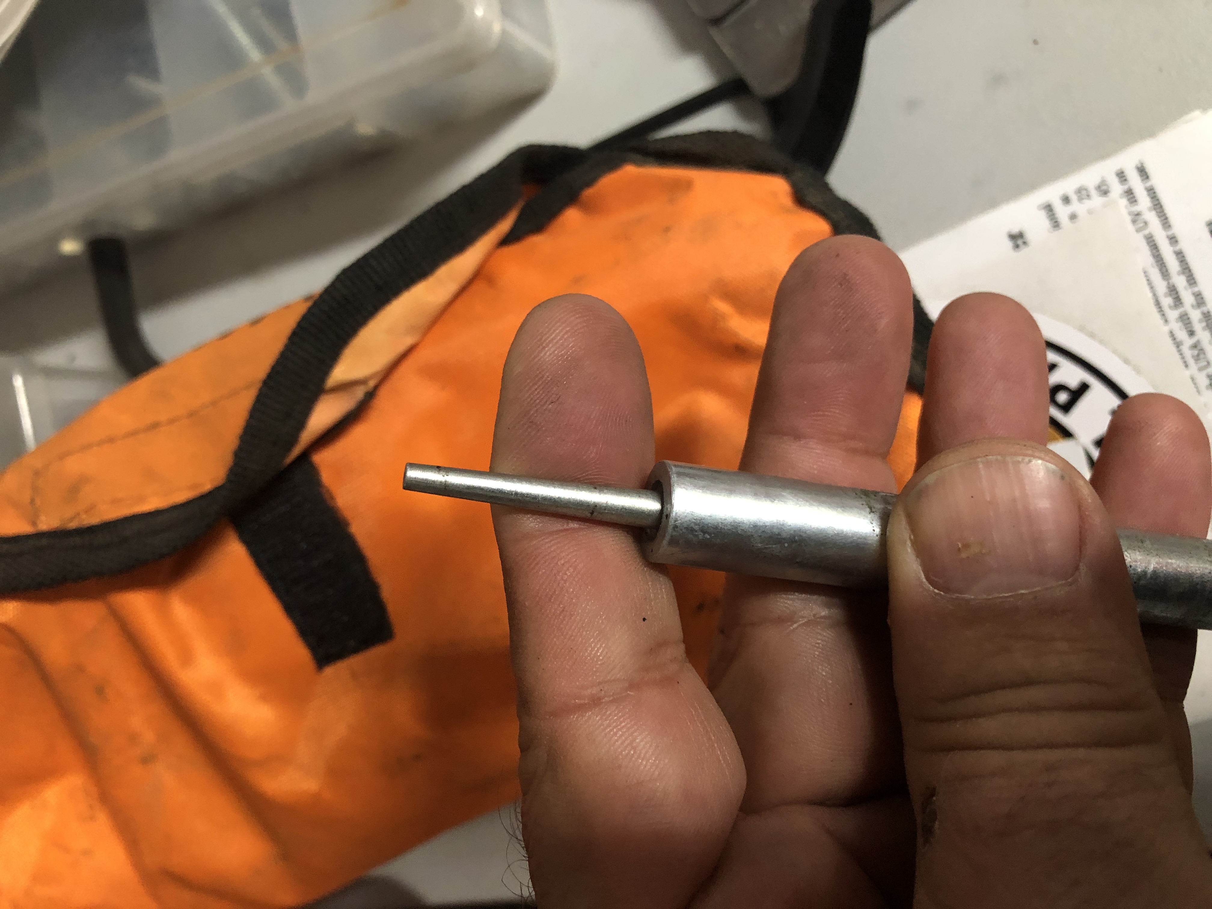

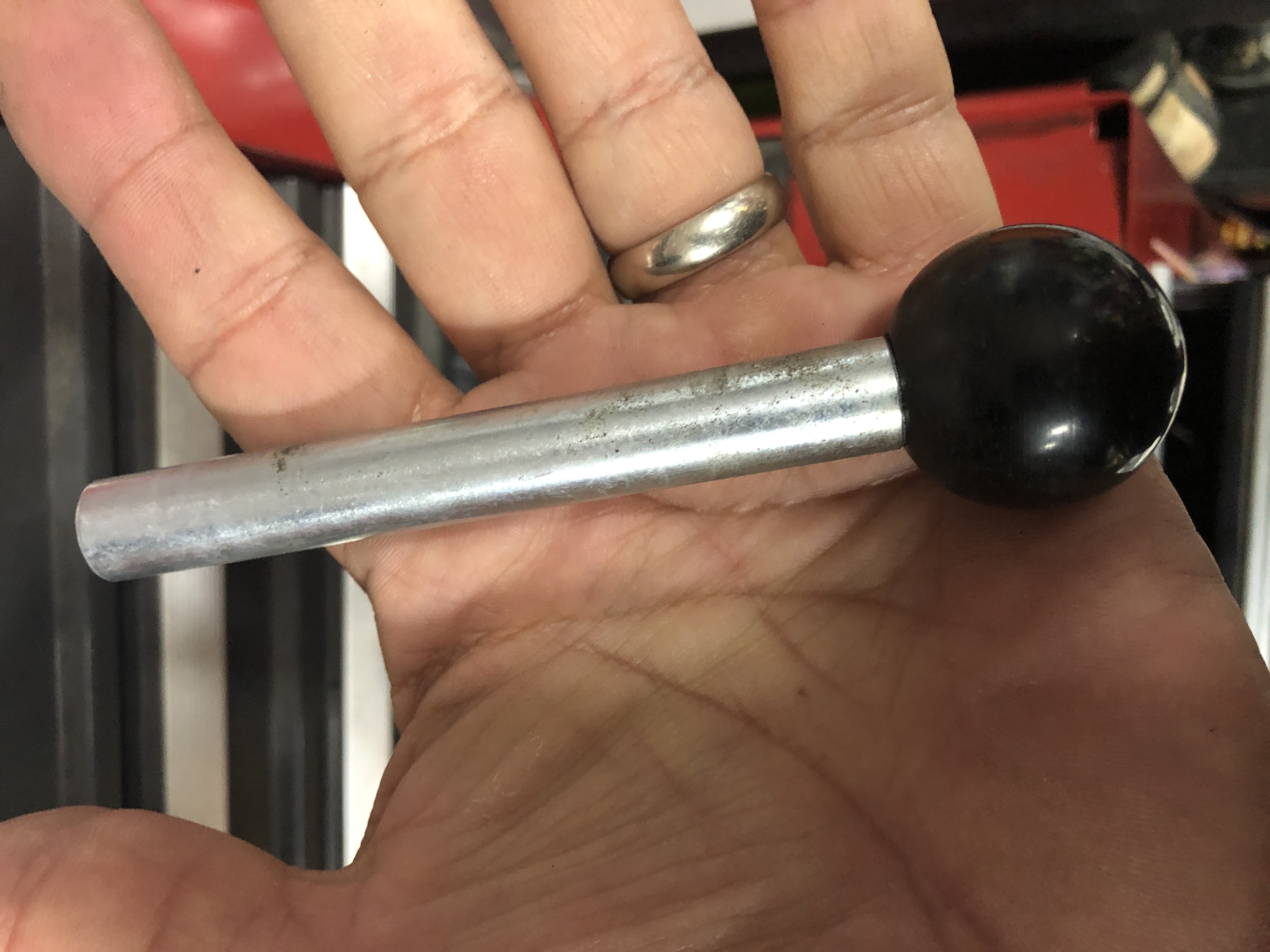

Re: Main Shaft C Ring Tool???
gearyoliver wrote:Can someone post a pic of one or description?
And I have to say that the Hodaka people I've met here, on Facebook, and in person are what makes this the most enjoyable time I've ever had fooling around with dirt bikes.

Thanks for the pics! I purchased one that looks similar from SH for the control shaft. Mine is for the 125. So if there is another size count me in for one if there is a group buy.
The third picture in SoCals depiction of the tool shows the ring expansion shaft in backward. The large end of the tapered shaft would be faced outward for use...
