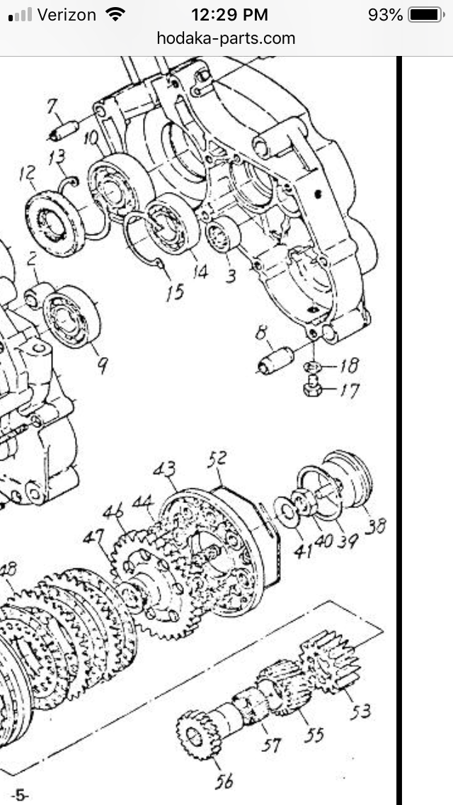

OK. So I looked at the microfiche for the oil drain plug on the Road Toad Cases. Part #17 is the Drain Plug (bolt) & Part #18 (below) is listed as the oil plug ‘gasket.’
Is this not just a lock washer but some type of rubber gasket to stop the plug from leaking oil?

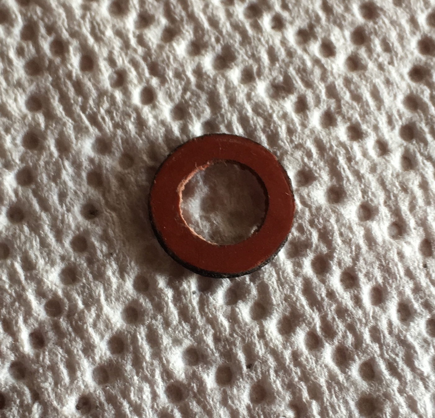

Well I’ll be darned! I pulled the drain plug and checked the washer. It was a red fiber washer!
So I cleaned it off and set a piece of 800 grit sand paper on the workbench top and burnished the gasket smooth. Let’s see if that clears up the leak?!?! :ugeek: Victor
Re: Road Toad - Oil Plug Gasket?
Best just to buy a new one. The old ones dry out and don't do as good a job of sealing as a new one would.

Cracks in the fiber washer - especially when old and re-used many times - are not rare. And they may not be easily visible when inspected. But I suspect Joe was wondering about hard to see cracks/porosity in the die cast case. New fiber washer should cure the issue - we hope.
Well I hope so. The smoothing by sanding didn’t work. So I ordered 6 of them from Terry, just to keep extra on hand.
