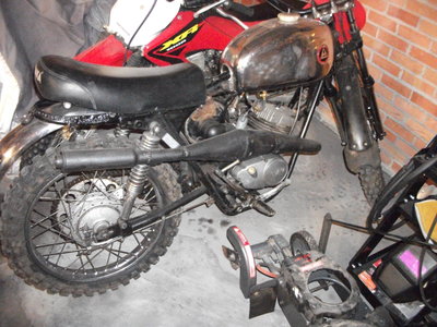

Come on pictures, I want to see what kind of pipe is on it.

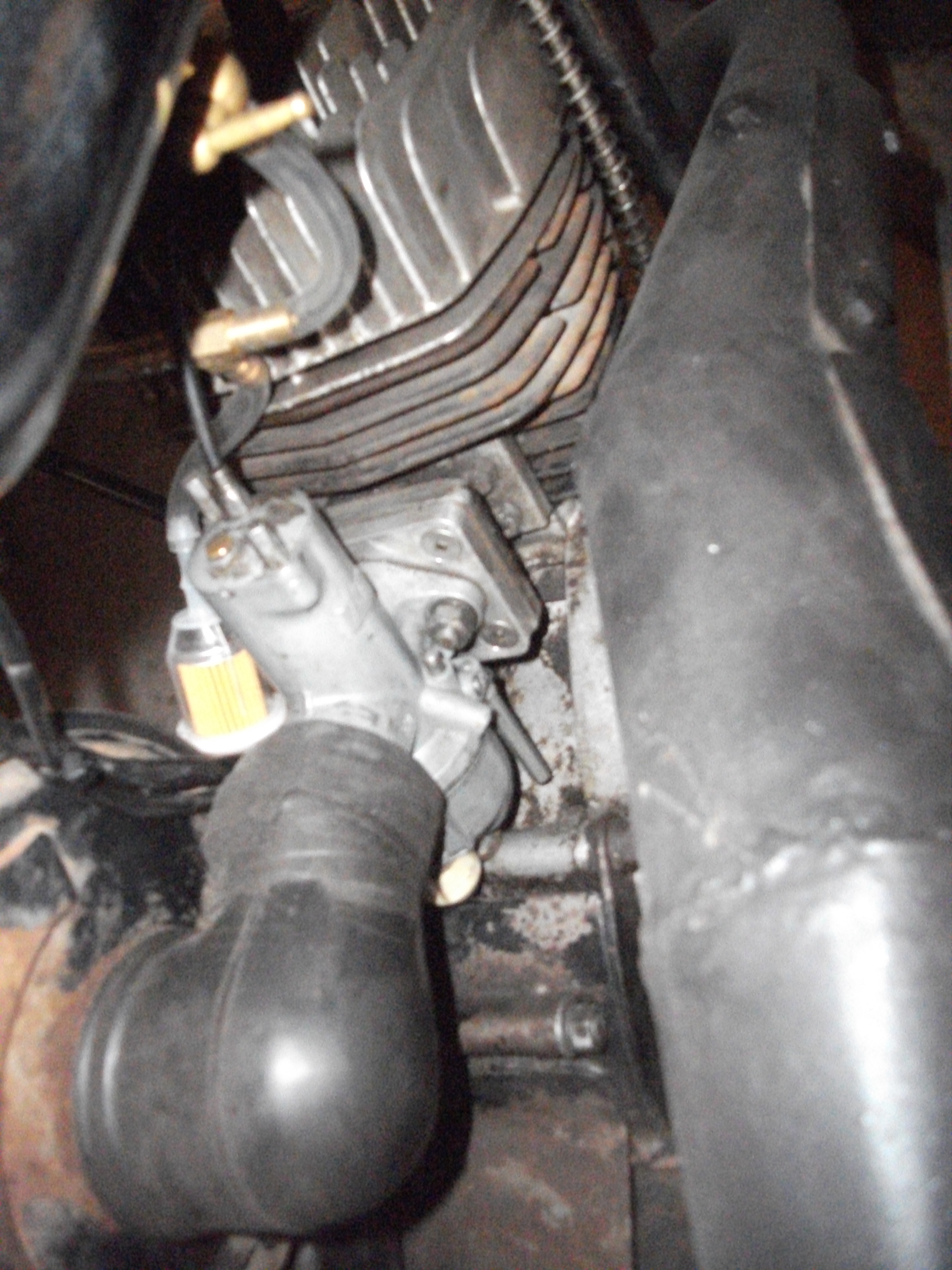

Here's the pictures Socal
When I got it the right petcock wasn't being used and probably hadn't been for awhile. When I hooked it up there was a bunch of rust particles/chips in the line. I pulled the tank, painted some of that rust performer on the underside, inspected the inside, cleaned and reassembled the petcocks, put some rubber grommets on for the tank mounts and got a big ass fuel filter and T fitting. I'm still routing the fuel line so it doesn't rub on anything, especially the cylinder.
Someone forced the stock air filter boot onto the bigger Amal carb and then tried sealing it with an entire tube of some goop it looks like. I wrapped it with some of that tape that can stick to it self (it's not at all sticky it just bonds I guess) and it looks like it'll hold. Also there was nothing in the silencer and it was pretty loud. I know most of you guys will disagree with this but I actually stuffed regular insulation in there.
I got into this for very cheap. It was almost a 3 hour drive to the guy's house and I had just learned what a Hodaka was after seeing his ad so I had to buy it, even though I knew it was in pretty rough condition. I'm just trying to piece her together right now but once I get some money I'll get her right.
