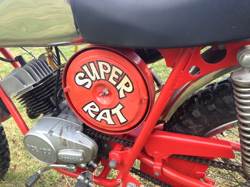

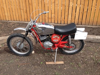

Try VHT SP119 Chevy Red Orange. You can clear coat it with VHT145 Clear gloss. It`s as close as it gets and holds up fantastic!!! I will post photos as soon as my son shows me how but until then go to EBAY. Look up SUPER RAT SOLD Listings. I sold a new Carburetor and you can see the dusty frame tube. Joe Ormonde.

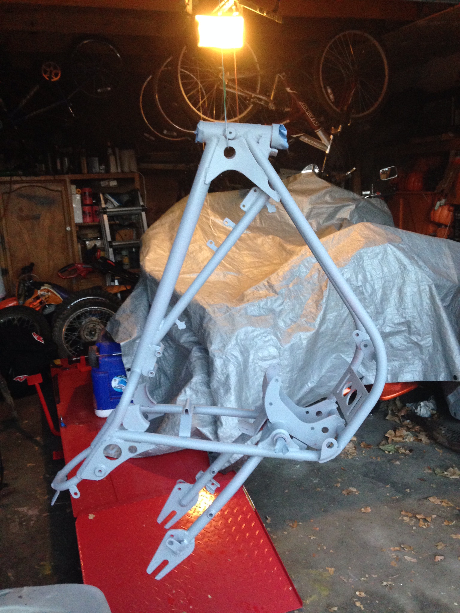

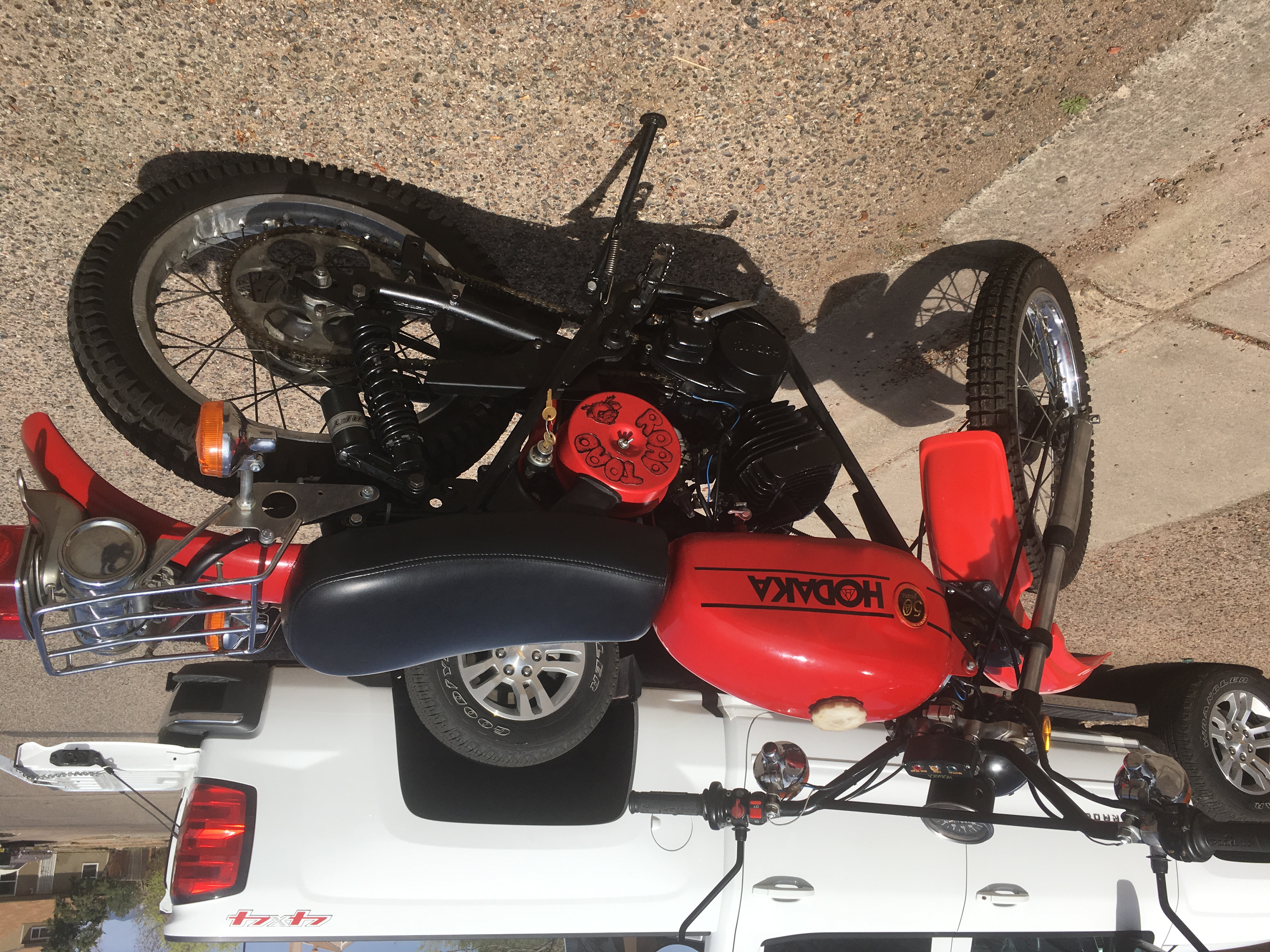

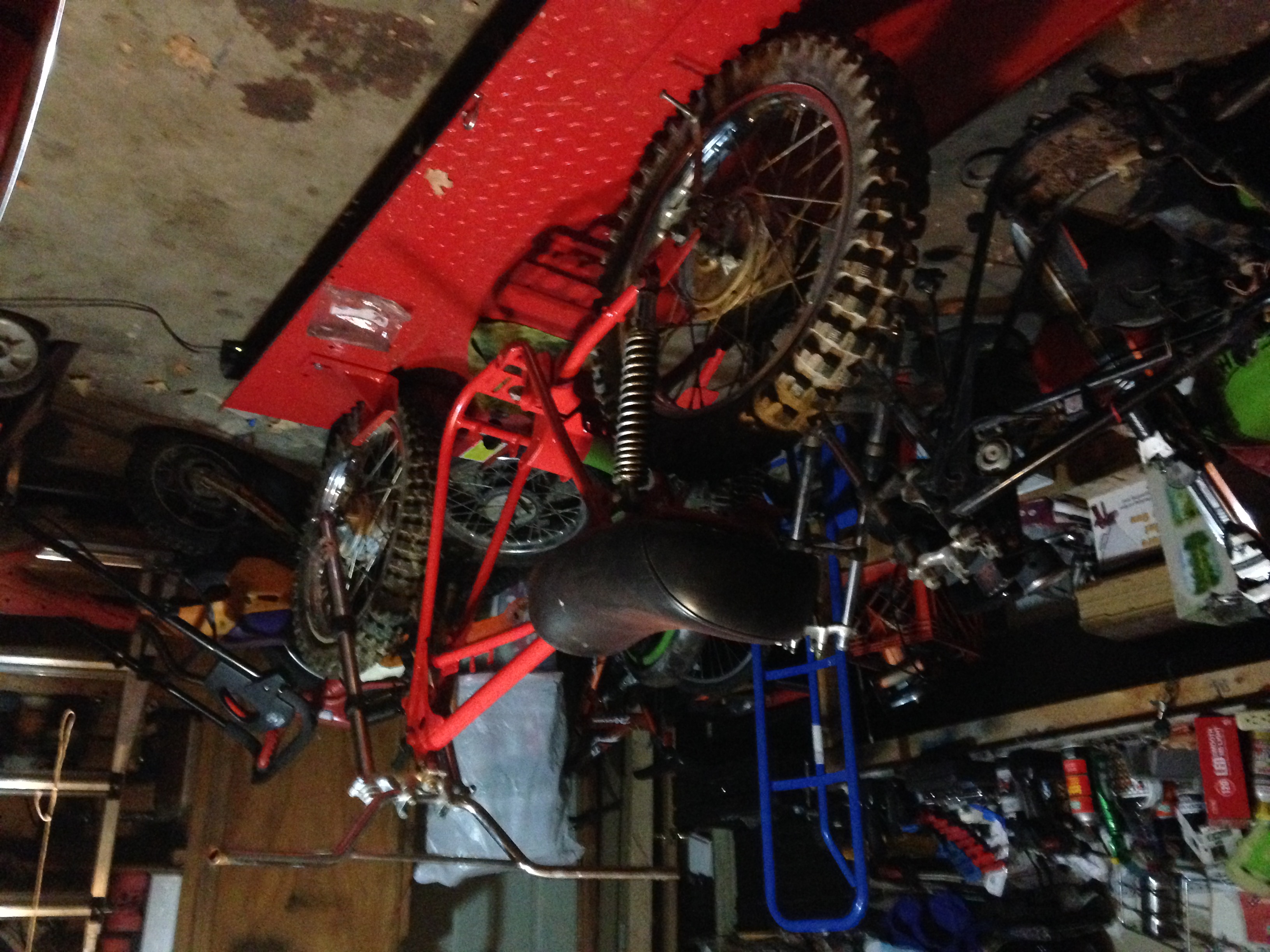

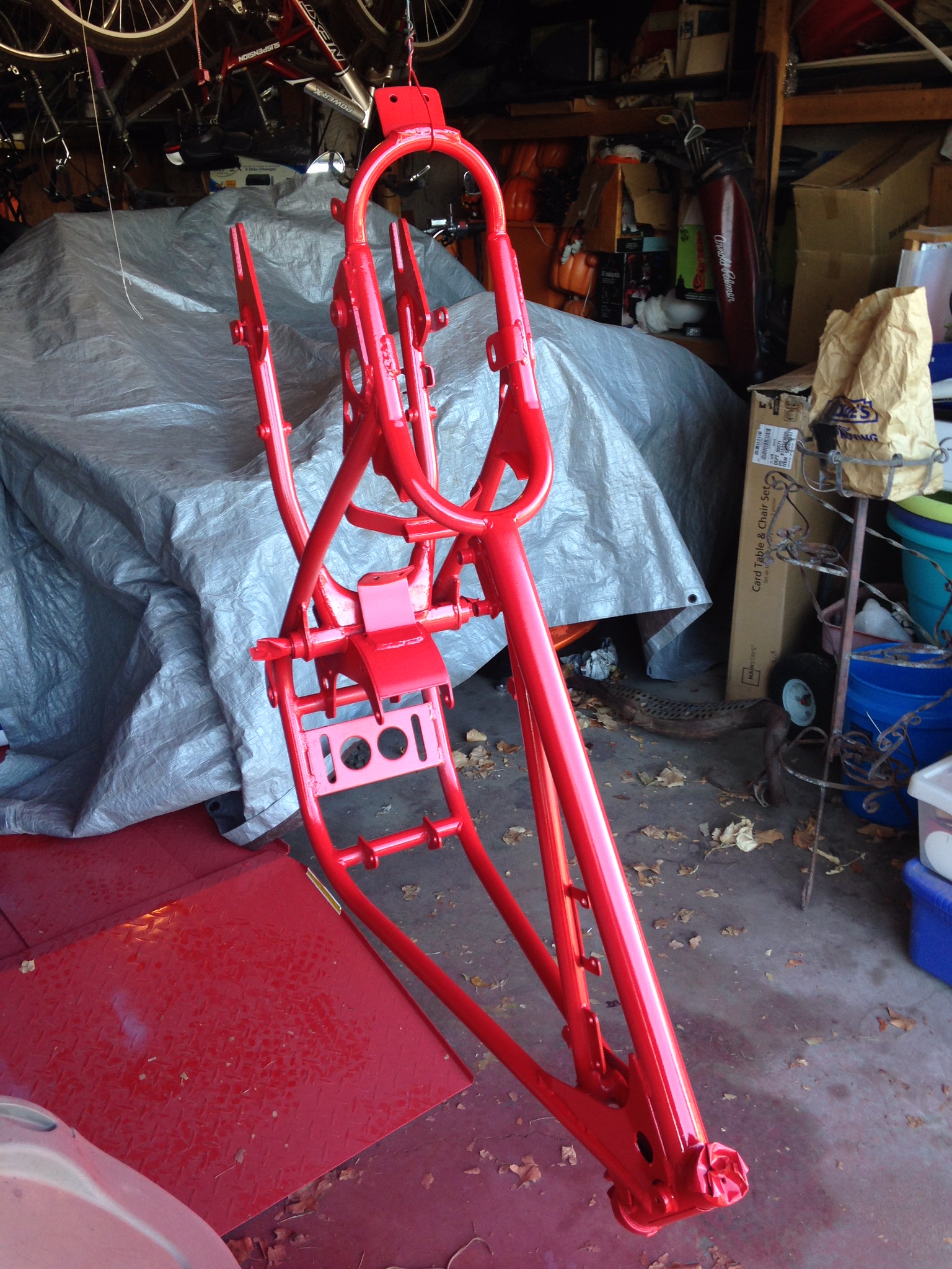

For my Ace 100 B+, I used a paint I got from Lowe’s. It was their brand or Valspar Rust Spray, and comparable to the Rustoleum Red. Here’s a photo of the frame after painting.
I also used a grey primer underneath it. :ugeek: Victor
Re: Paint

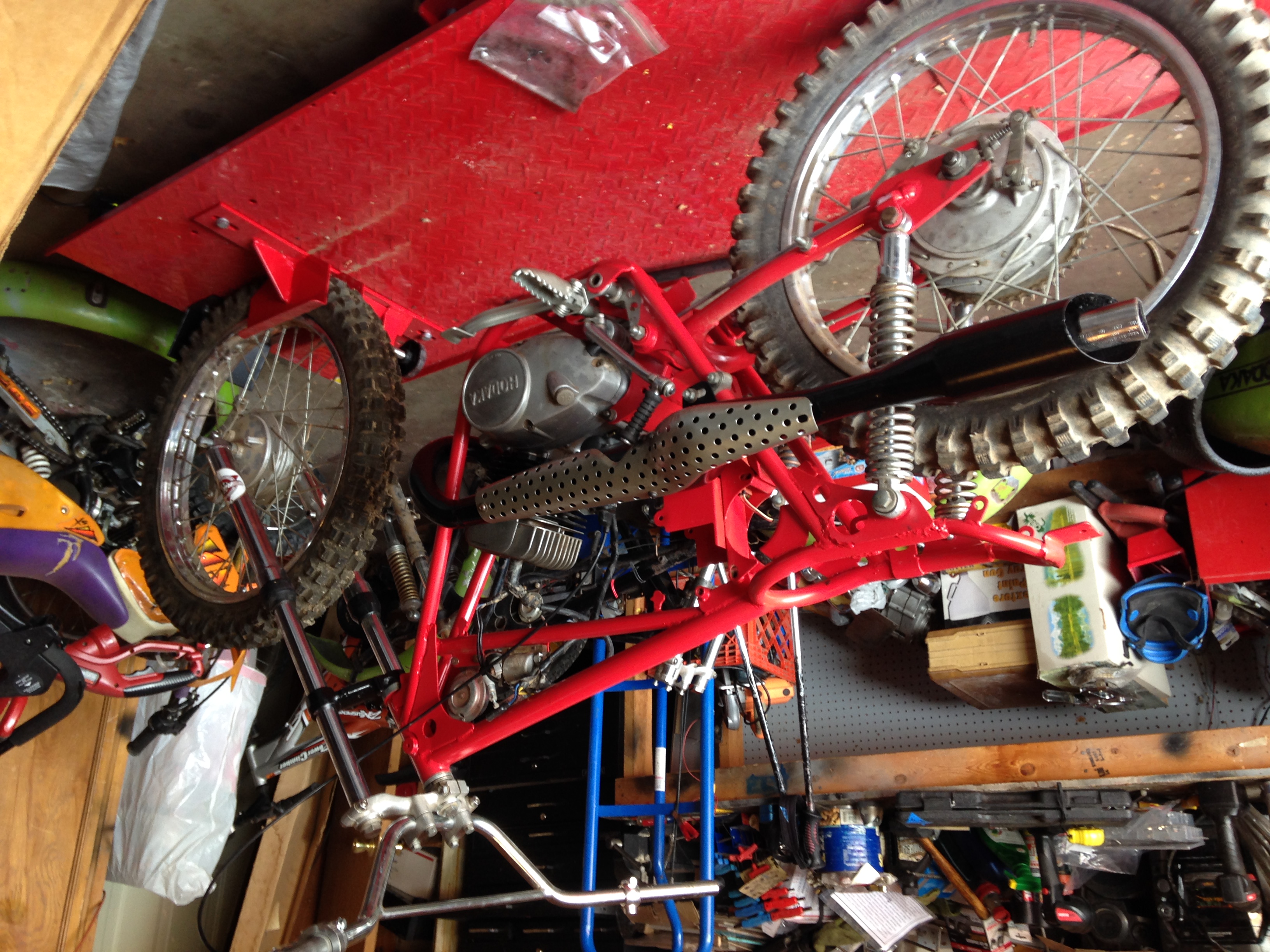

Here’s a photo of it as a rolling chassis. And another with the motor in it. :ugeek: Victor
Re: Paint

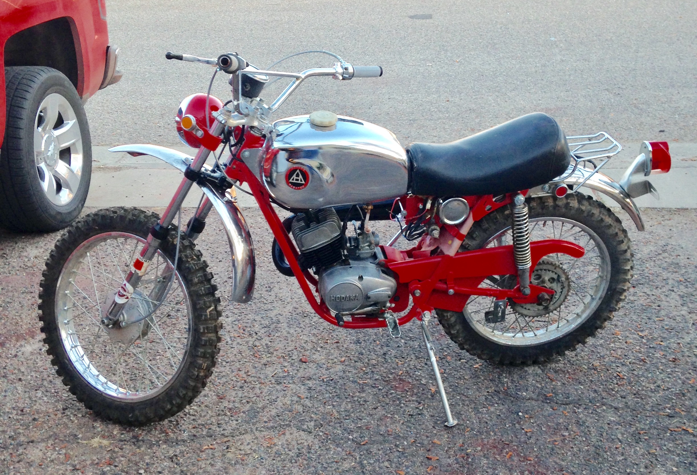

And the final product! :ugeek: Victor

You bet Go Hercules!!! The other Chevy paint is TERRIBLE!!! I painted my Super Rat 4 years ago and it still looks fantastic. When my Rat was 4 years old, it faded to that awful orange color. The best way to describe the color when my bike was Brand New would be TANGERINE. Some faded and some did not. I found out that my Super Rat was painted with Synthetic Enamel:Not Acrylic Enamel. That`s why it faded so fast. Joe Ormonde.

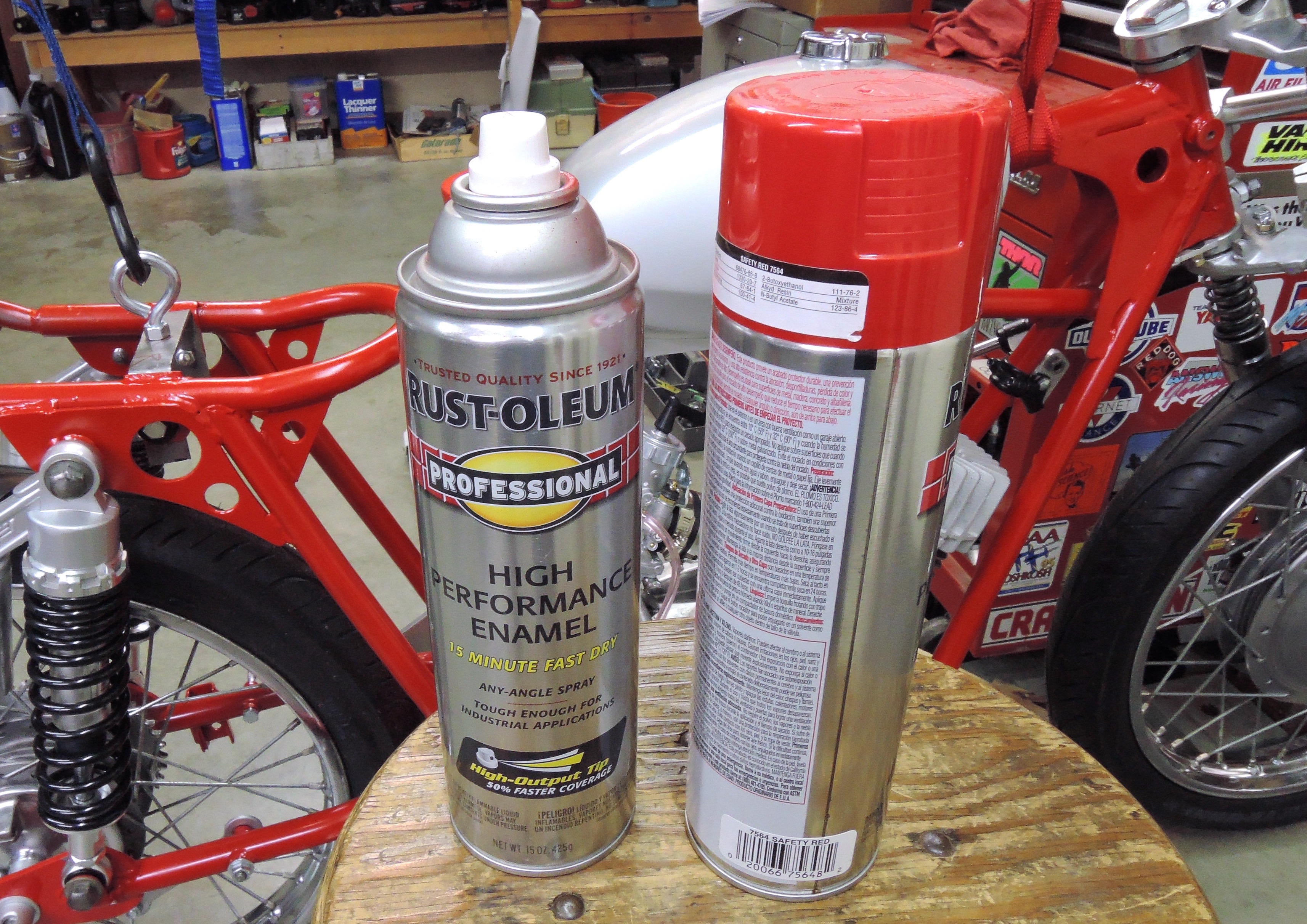

This stuff is bright and a good match. I've used it on the last two restorations. #7564 Safety red. Sometimes hard to find. Try Farm stores or online.

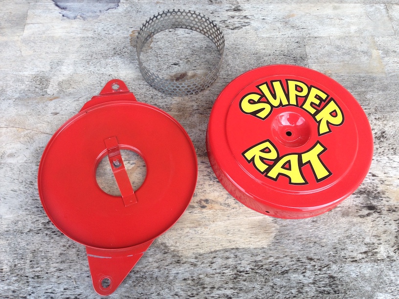

A couple years ago, I spent a few weeks and the extra dollars for a professional color match. The end result was an indistinguishable color match against the test frame. I used the main Frame support under the tank that looked to have never been exposed to direct sunlight and the inside of an early headlight bucket. Since I had intended to paint more than one Hodaka, I asked them to save the color formula, which they did under "Hodaka Red". Here's a couple photos to show: (The 2nd Photo shows an unpainted and a little faded Air cleaner for reference. The 3rd photo is a 2nd Air Cleaner that I painted using the same paint.)
I usually have them put it in rattle cans for me for a couple extra dollars. The benefit of this is that I can also have them mix it as a lacquer, enamel or two-stage. These photos depict two-stage.
