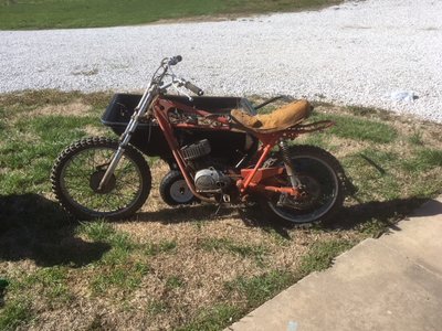

Hello Forum. I'm new to Hodaka and found a solid project, minus a few things (tank). LOL. Anyway. Here's my questions. First off, I need to know what I have. My frame number is E06119. I'm thinking that its a Dirt Squirt yet, not 100% if Model 92 or Model 96. Any help or guidance would be appreciated. Also, which is the best manual to use once I take on this restoration? Thank you for the help - Jack

Great find. That's a chrome tank Dirt Squirt. Same tank as the Combat Wombat, so finding that that might be your biggest challenge. Rest of the parts are very common with other bikes in the family. The chrome tank squirt with the red frame was one of Hodakas best looking bikes. Enjoy building and riding it. Lots of help available here.

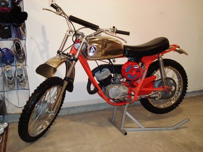

Hey GutterRat, here is my 1973 Dirt Squirt. I never quite figured out myself what the deal is with model 96 or 92C. I don't know why it just wasn't one or the other. Oh well....

After looking at my Dirt Squirt. The top end was loose, so I took it off and guess what I found.......well, what I DIDN'T FIND. No piston. So now I'll need to look for a piston, however, the cylinder will need to be honed or bored. The gift that keeps on giving. At least I have a couple other projects ahead of this one. LOL. Oh well........Mr. Murphy is ALWAYS hanging around me. LOL

Thank you all. I'm from SWMO. The Hodaka caught my eye and I had to grab this Squirt. Its lived a rough life, so hopefully I can resurrect it and save it. LOL. Missing some things.
Re: Hello All: New to Forum & Hodaka
Easy, worst have been saved. Nice Webco Head it looks like on there.
