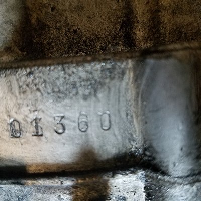

I'm getting ready to list a 1973, 125 Combat Wombat to the January Mecum Auction, Las Vegas. While gathering the frame and engine identification I noticed the second and third engine numbers appeared to be stamped twice. (attached picture) The J01360 comes out clearly. But it looks like it could have originally been stamped J13360. As you can imagine this poses a problem for the auction. I purchased the 125 sight unseen a few years ago and did not ask for pictures of the identification numbers. My mistake!
Do you believe there's a real problem here or a factory slip up while stamping the identification numbers?

01360 is about what the serial number could be to match the frame number only off by 80 and seldom, if ever did they match. The engine numbers started at 00001 and frame numbers started at 14501 --------------Clarence

You have an implied question regarding authenticity of the engine number. I don't think anyone is going to be able to answer that question. Personally, I have never seen an engine or frame with an overstrike number, but lots of folks have seen altered ID numbers on vehicles. That would be where the problem arises with the auction house. My question would be whether you have documentation for the bike showing original purchase with both numbers on the paperwork matching the bike as it is, or at least some sort of State official paperwork showing both numbers. Engines were frequently replaced during the life of the bike, and as mentioned, there was no official nexus between engine number and frame number at the time of manufacture.

And if you are a true glutton for extreme punishment, have the DMV run a check and title search for the engine number - both the apparent original and overstruck numbers. Even though the frame number is commonly used as the "VIN" number, if the bike was hot at some time, a previous owner may have attached the legit engine number to the frame number in the report. Its unlikely this will reveal anything, but at least you could demonstrate due diligence in the spirit of full disclosure. That might be enough to satisfy the Mecum folks.

Did they ever make 13360 combat wombat engines? I doubt it they started with 00001.----------Clarence

Hodaka-Parts.com shows the engine number for the J engine starting at 00001, and frame starting at D 14501. Paul used to include engine start numbers on his chart, but all that data was apparently abandoned when completing the "new" chart for the Hodaka Book thing. Didn't do the chart any good. Perhaps if Paul still has the chart he used to use just before the current one, he would share with the group. It was a much better chart. His current chart has errors that can't be explained, although none in the Combat Wombat range that I know of.
As for a J engine in the 13,000 range, no. Only 4,400 Combats were made. The frame number shown would have been the 1,280th Combat Wombat made, so having an engine number of 1360 doesn't sound so far off. The number style and size look right, so perhaps it was an overstrike. At least the digits are the same ones.
