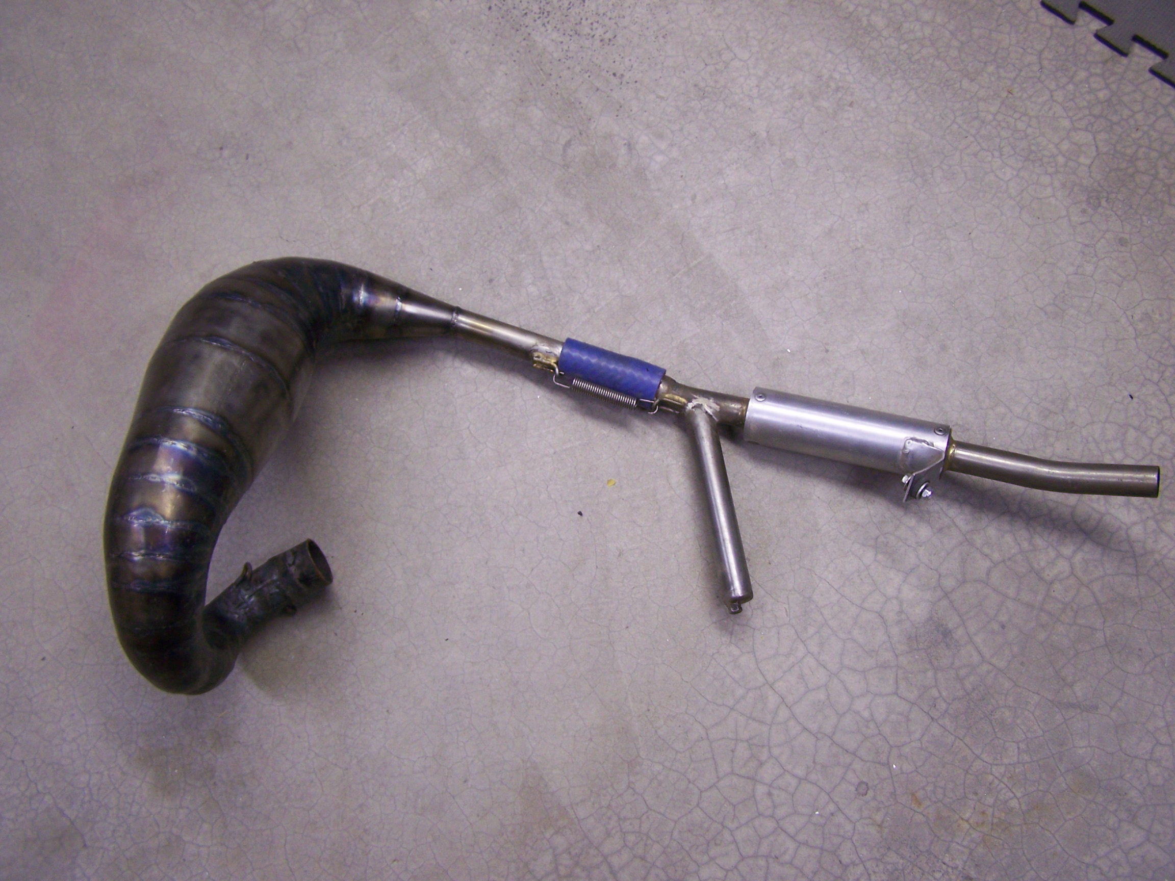

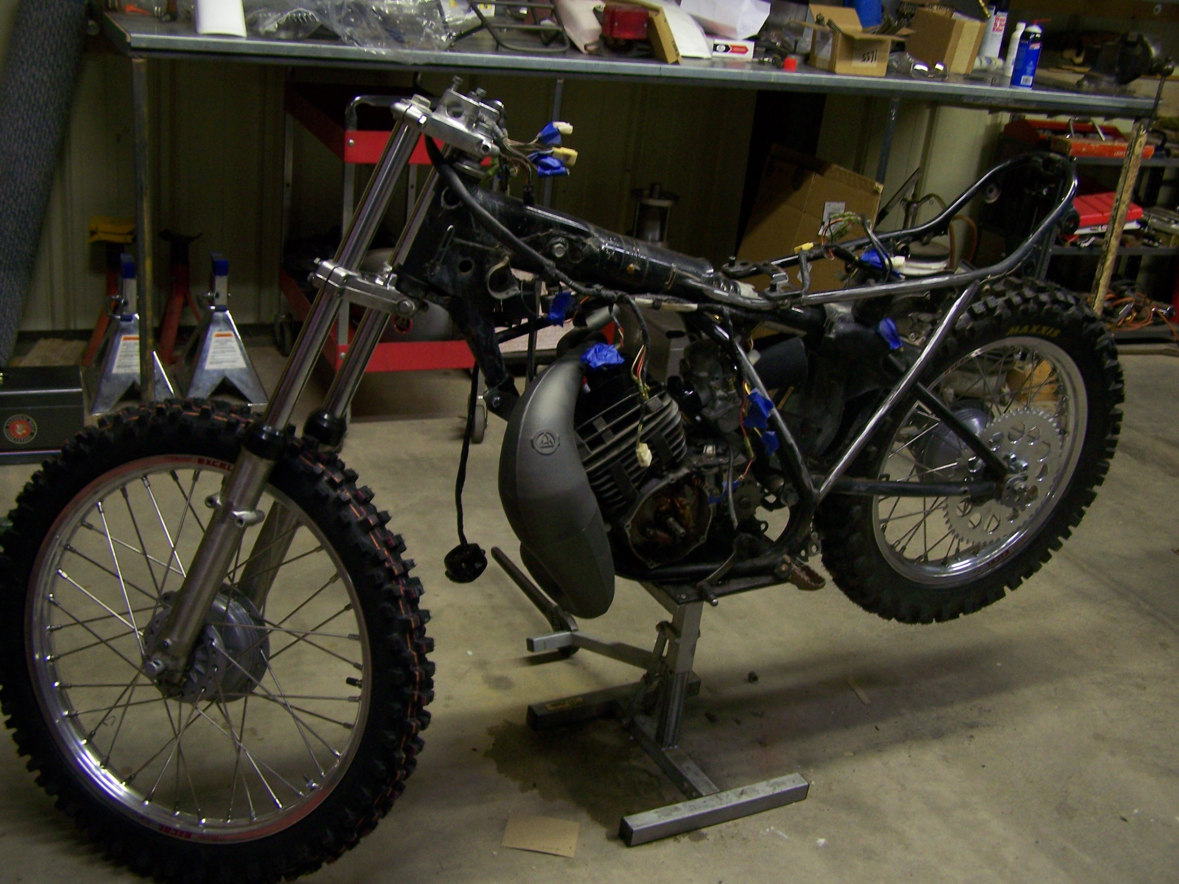

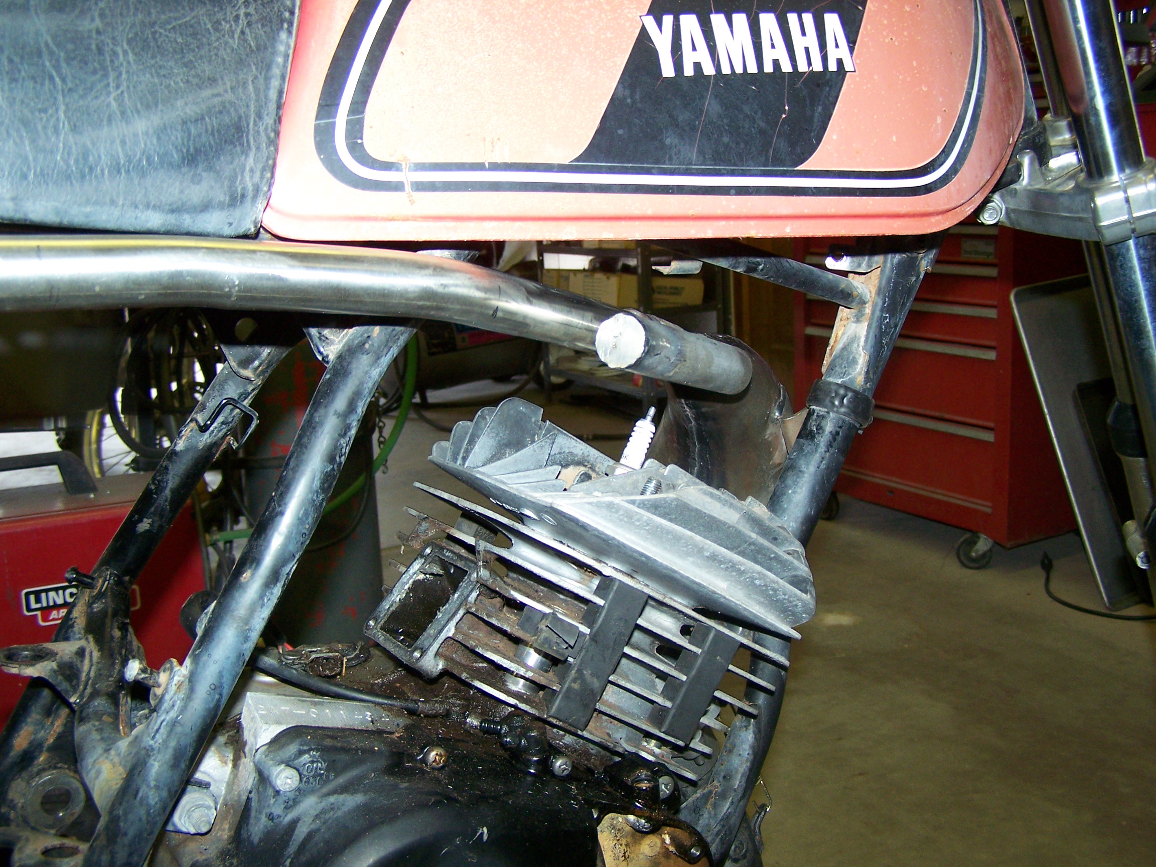

I'm back to work on my 1978 Yamaha Dt 175 that I picked up last Christmas Eve , This has been the most stressful year of my liand havnt had much time to work on it with My Dad passing and then Mom issues still happening and also I had a stroke , so I just pick away at it. I have adapted a HT2 pipe to it as well as a Hodaka 250 front end to it. And today just got the new excel rims with stainless spokes mounted , just as a mock up though since I'm still doing other mods before disassembly and powder coat. Then I get to do the fun part of the engine work, If anyone is interested I will update when I'm farther along and if not then I wont .

Is that pipe routing going to be an issue with the spark plug cap?

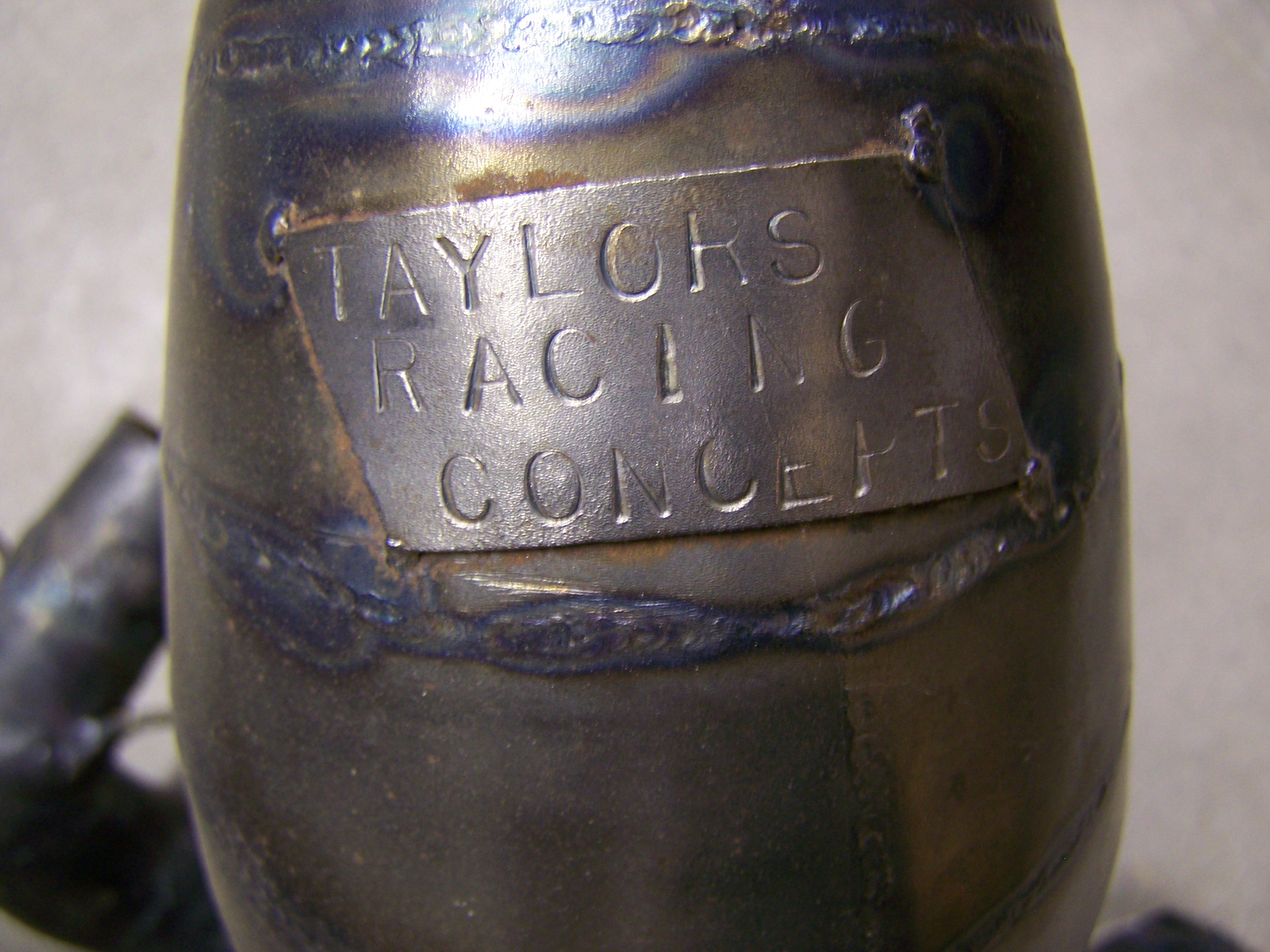

I agree with Victor and Dirty_Rat. Challenges encountered and solutions developed when working on vintage 2-stroke race bikes are often applicable to other brands. Its the thought process that is interesting. Please keep up updated on progress. Condolences for your father's passing. I too lost my father around the holidays a couple years ago so there is always a bittersweetness this time of year that I can appreciate. I noticed that on your HT-3 pipe mock-up, my impression is that the "TIT" is in a more horizontal configuration than typically seen. Is this a potential issue with its secondary function as an oil trap? I'm thinking of trying to fit one on a TM-125 I'm working on so I'd be interested in your experiences with fitment on a different marque. Thanks!

Thrownchain, the spark plug cap is close but will work , I'm using what is called a vari angle cap , very cool piece we sold in the late 70's at Goodies speed shop that I was working at , its very slim and very cool

The Taylor TIT never had a secondary function as an oil trap , the screw in the bottom of the production pipe was an idea that I did on the hand built pipe that Harry built for me which did not come with a TIT but after reporting to Harry that the pipe didn't have any bottom or mid range grunt he had ne fab one on my pipe and I put a screw in the bottom so oil , if any that might accumulate could be drained out and Harry thought it couldn't hurt so that's why they come with them,

Rich, tell us more about the TIT, it improves low and midrange? Where on the stinger should it be located? Same size od/id as the stinger? How long should it be?

Harry scientifically explained to me that TIT means Harry's idiot tube. Its function is creating a secondary pulse making a slight power surge when the throttle is popped open . I can say from running pipes before and after it does work.Placement works in the stinger as well as where I placed mine at the end of the last cone.

Hey Rich, any info or formula on diameter or length? Should we all install one? Just questions. :D

Max, at first Harry told me to make it about 7 inches long and place it like in this picture , I don't think Harry had a formula just trial and error , both that I made worked , as well as one I built on my trials bike and it was 1 1/4 In diameter and 5 inches long and on a straight pipe basically , it worked really well. And the production pipe is different yet . I guess if someone wanted to keep cutting and welding his pipe you might find an ultimate.

Interesting project with the TIT. My first thought is that it is rather like the arrestor used to reduce hydraulic hammer in plumbing. It works by providing a springing in the system and pushing more of the unburned charge back into the cylinder during scavenging. The tuned expansion pipe does this with a reflected pressure pulse and I can see how the springiness of the closed pipe would compliment this.
A little reading on water hammer and pressure waves is at Wikipedia under "water hammer". Couldn't get the link to paste.

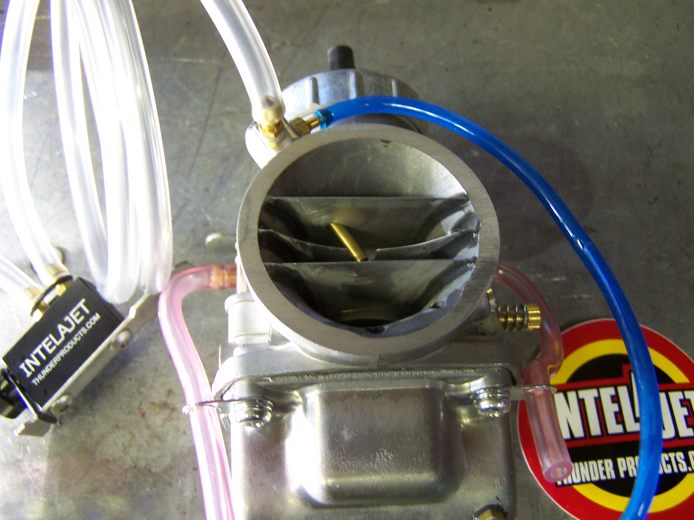

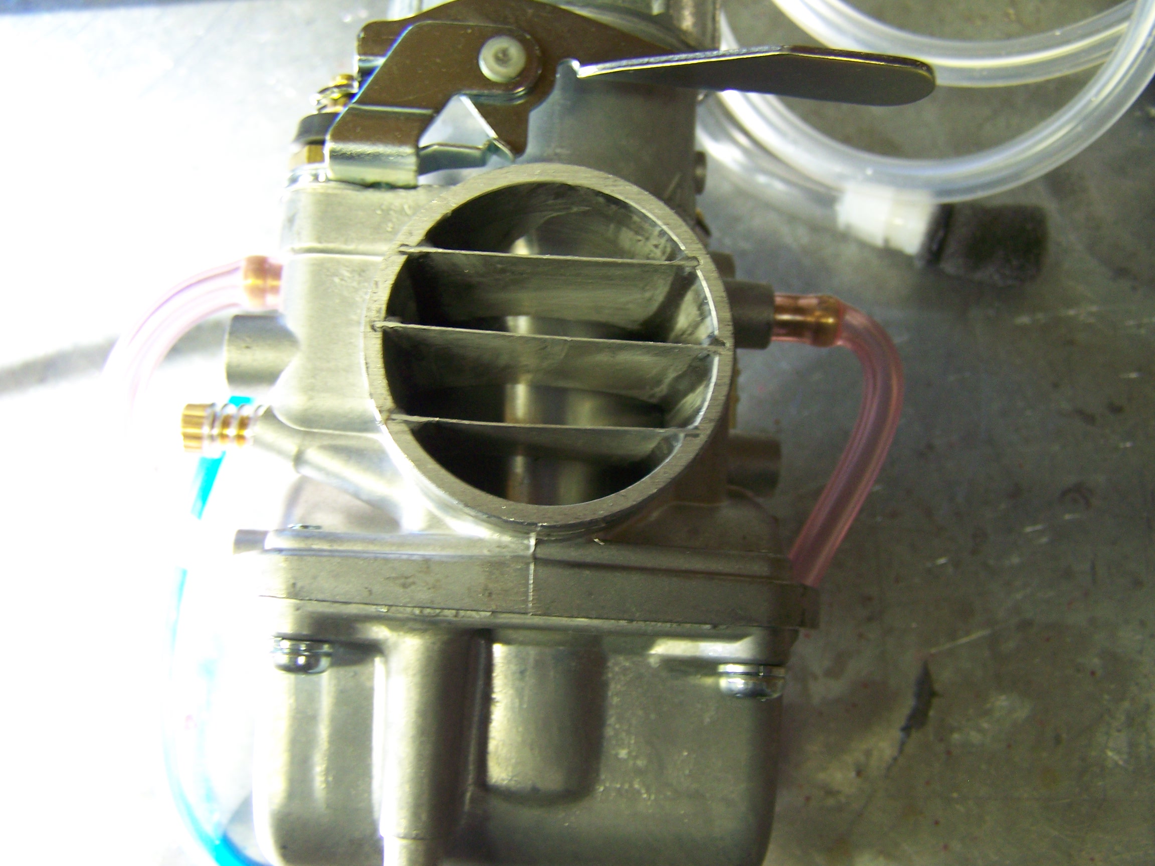

More Yamadaka work today , building the 38mm mikuni with 6 venture dividers and an Intela jet. I will get a picture up tomorrow.
racerclam
Posts: 588
Re: Yamadaka project
Post by racerclam »
More Yamadaka work today building the 38mm Mikuni with 6 venture dividers and an Intela Jet , I will get pics up tomorrow.
racerclam
Posts: 588
Post by racerclam »
Just finished the carb for my Yamadaka , a UFO and an Intela jet. Next to make front fender fit without hitting the HTpipe

Rich, Just curious. If you wanted to campaign this cool bike, how would the use of the Intelajet effect classification of the scoot per AHRMA rules? I'd also like to hear of your experience with the Intelajet system. I have a 94 I'm diddling with as an open-class MXer for the upcoming season. I might throw one on for fun. Does it work like the old Dial-a-jet rig? Those seemed more important when one expects drastic altitude or temperature swings over the course/ride/day. Thanks!
Best,
Matt
racerclam
Posts: 588
Post by racerclam »
Matt, the venture dividers are legal in all areas of racing so far. The only one now that has outlawed it is in Go kart box stock class racing since my customer has one two years in a row , they just out lawed it about a month ago. The intela jet so far is legal as it basically is just a tuning device, it differs from the dial a jet in that its control piece can be mounted anywhere for remote adjustments and where as the dial a jet has 5 settings this has 3 turns of notchless adjustment so between adjustments are possible. Another advantage with the dial a jet or intela jet is that the fuel mixes with air before it leaves the discharge nozzle , pre atomized and lighter therefore accelerating through the venture faster
