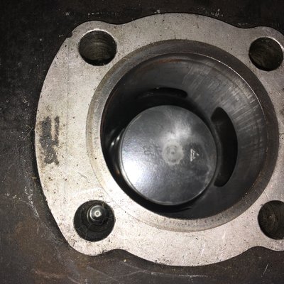

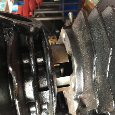

Mr. Gardner! Just for grins & giggles I reached into my parts bucket and grabbed my .040 Combat Wombat cylinder. It dropped right over the existing Road Toad cylinder bolt rods, nicely centered. Indeed though, the case would have to be machined open to accept the bottom of the cylinder spigot, by about the thickness of the spigot, from casual observation. Didn't measure it though. Here's a photo of a Model 95 cylinder sitting on my Road Toad tranny! And a picture of the nicely centered bolt rods from the top! ; D Victor

And here is a photo of the CW 125 cylinder spigot overlapping the 100 RT spigot. You can see there is even a bit of a gap between the 100 spigot outer dimension & the 125 inner spigot dimension. The only thing I can't tell you is the overall difference between the port openings in the cases, as I don't have a CW case to measure for comparison with the RT case. ; D Victor
