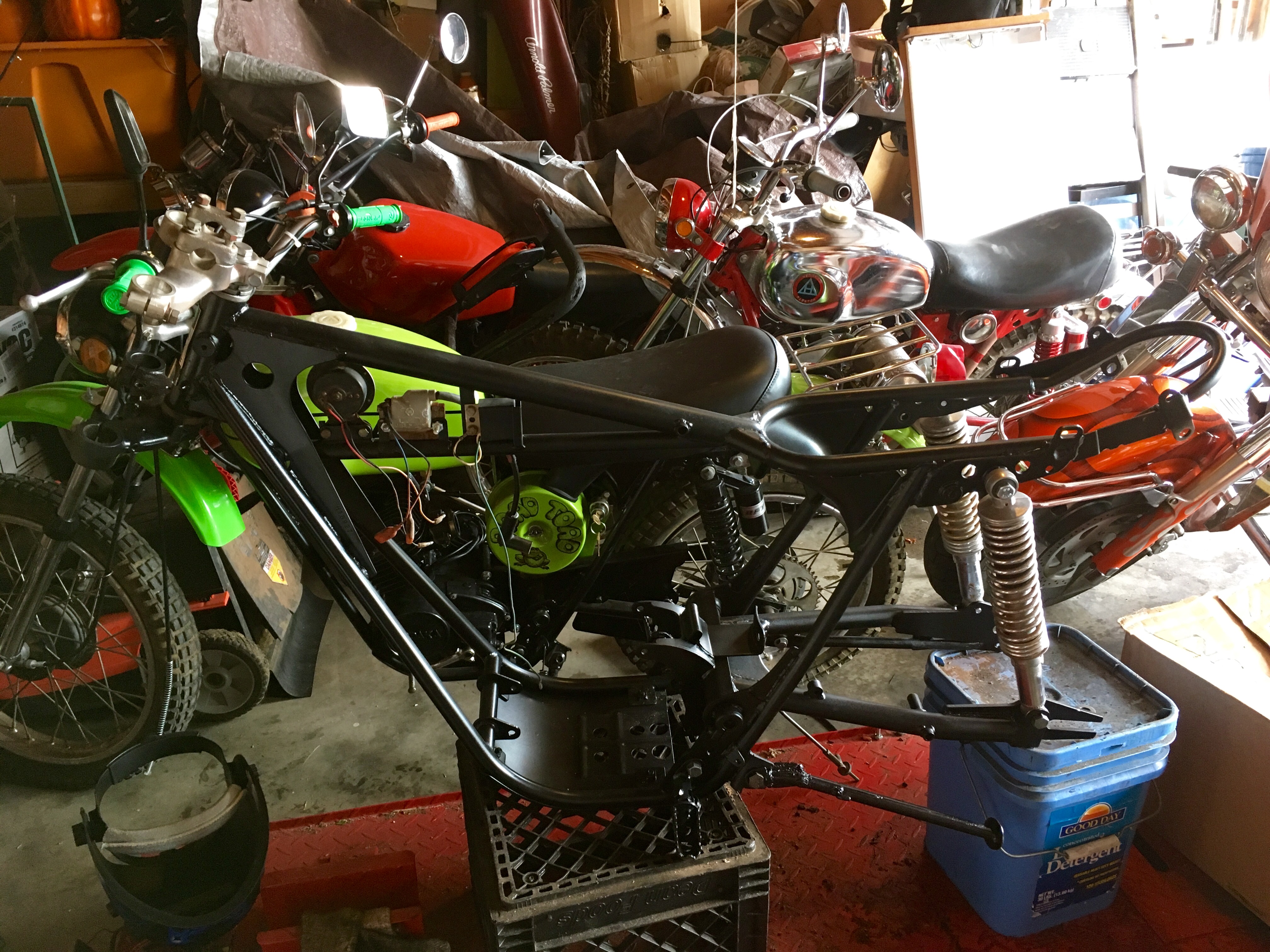

But, a few days ago, my nephew, Jonah, came over and we "officially" started his bike with the sanding & painting of the frame!

A little more work done. Got the foot pegs from the previous owner! Painted & installed along with the voltage regulator, horn & coil on the bike. Also added the painted brake stay and the newly acquired brake activation rod.

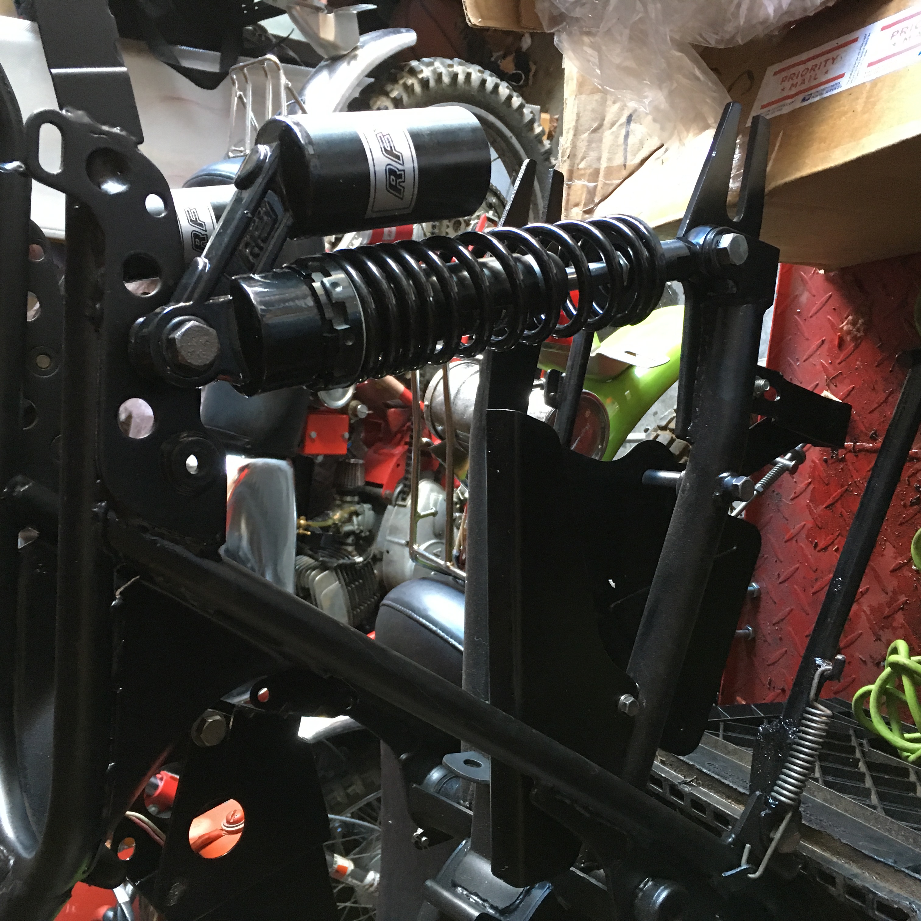

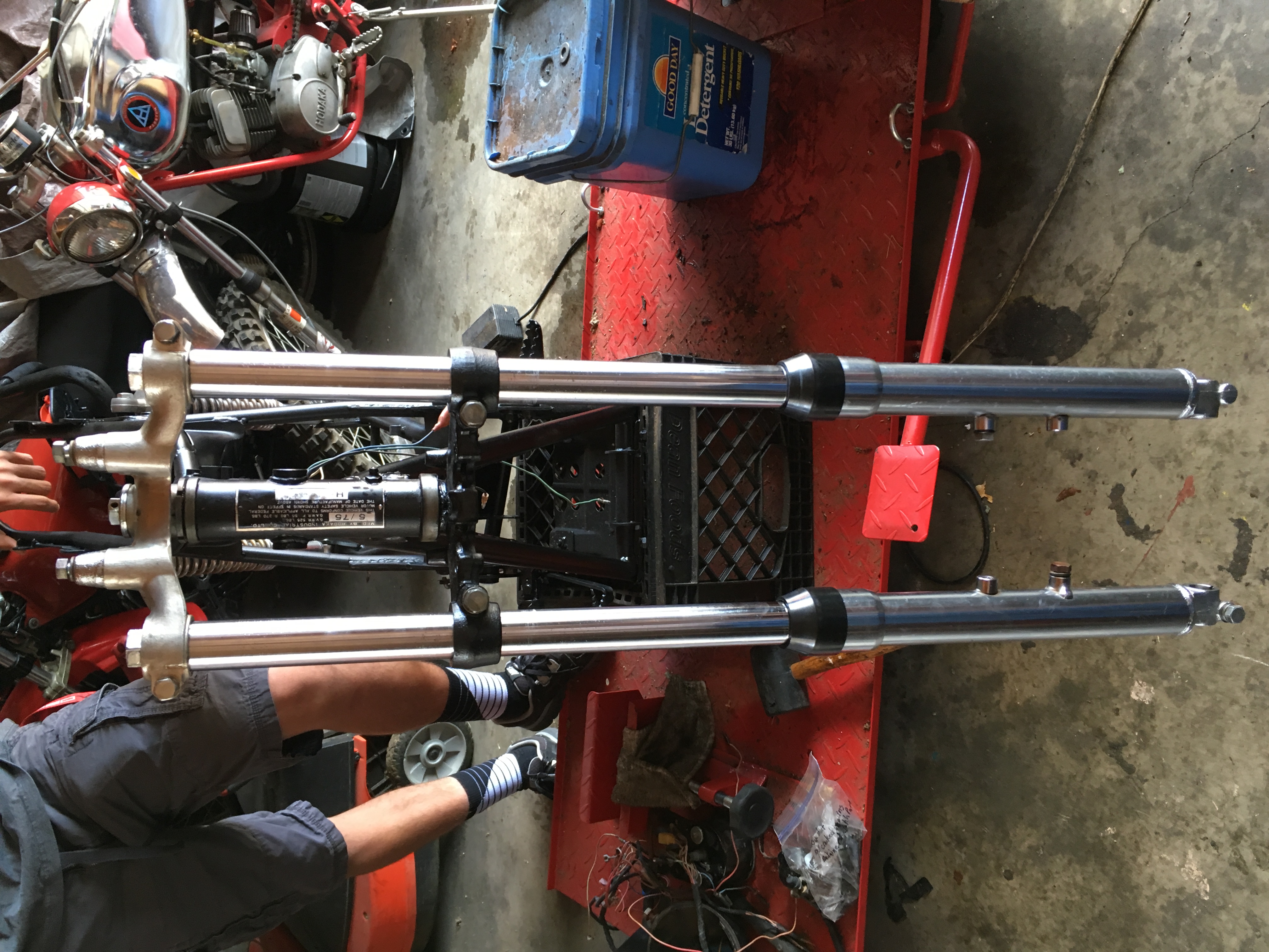

Steering head with all new upper & lower bearings mounted & the OEM shocks cleaned and mounted. The tires I ordered arrived today but still waiting for the tubes to come.

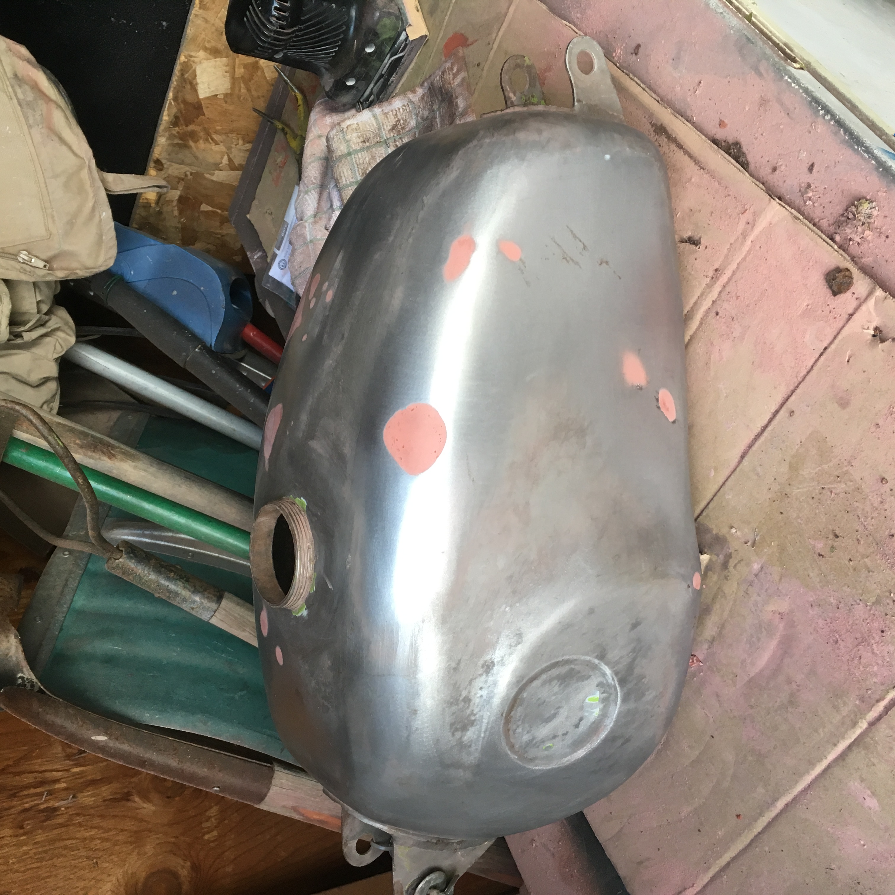

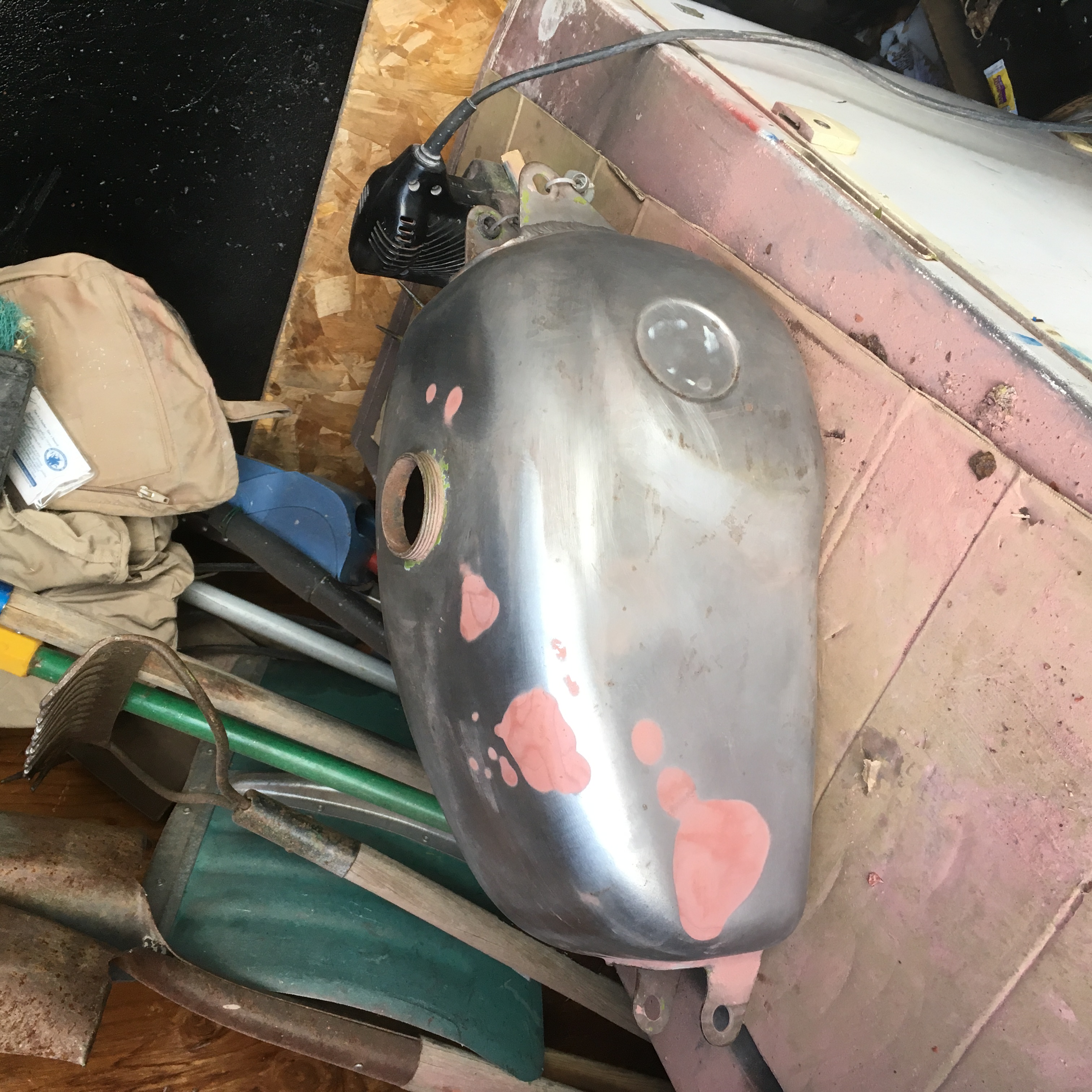

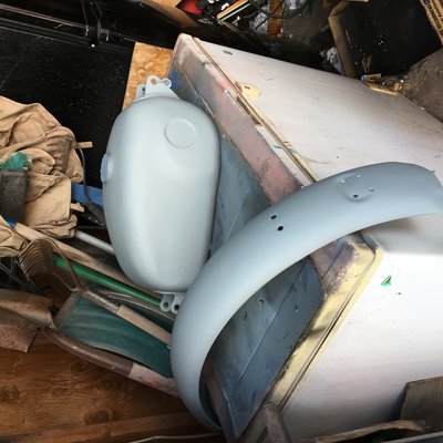

And the tank had been stripped, dings filled with glazing compound & first coat of primer us on the tank & rear fender. Still need to strip & primer the air cleaner cover. Also waiting for the fork rebuild kit to arrive.
Another thing discovered with the tank was this. I thought there was a large chunk of rust sliding around in the tank. Shook & shook but couldn't get it to brake up & come out. Turned on the flashlight and looked inside the tank. Turns out it was a gas cap seal which was too small and fell inside the tank!

With 7 bikes in a 20x20 garage, and the lift, I only have room to work on one bike at a time!
Good old primer. It always shows flat spots or irregularities after you've sanded the glazing compound. Last coat of glazing now, to get the contours correct in the curved edges of the upper tank! ; D Victor

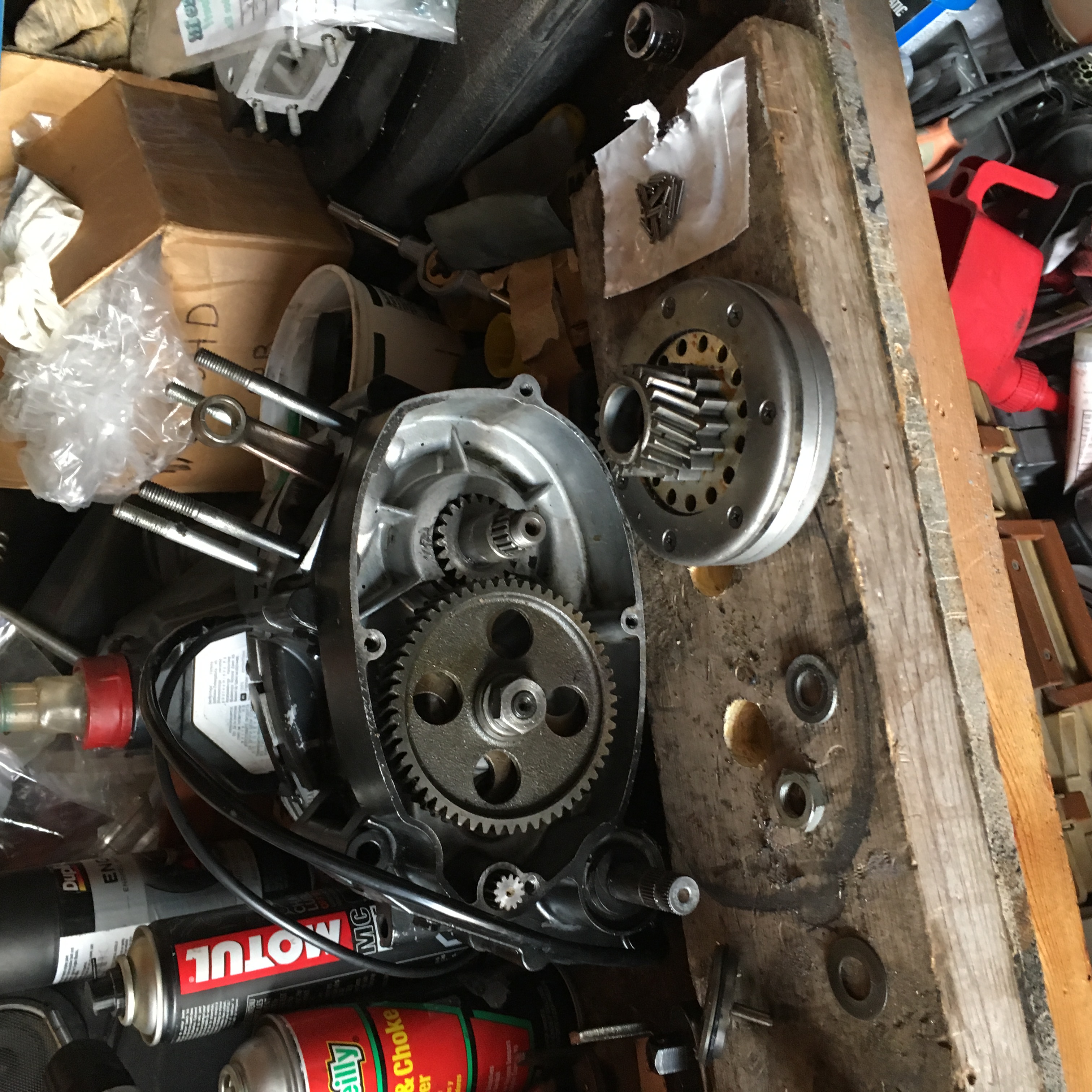

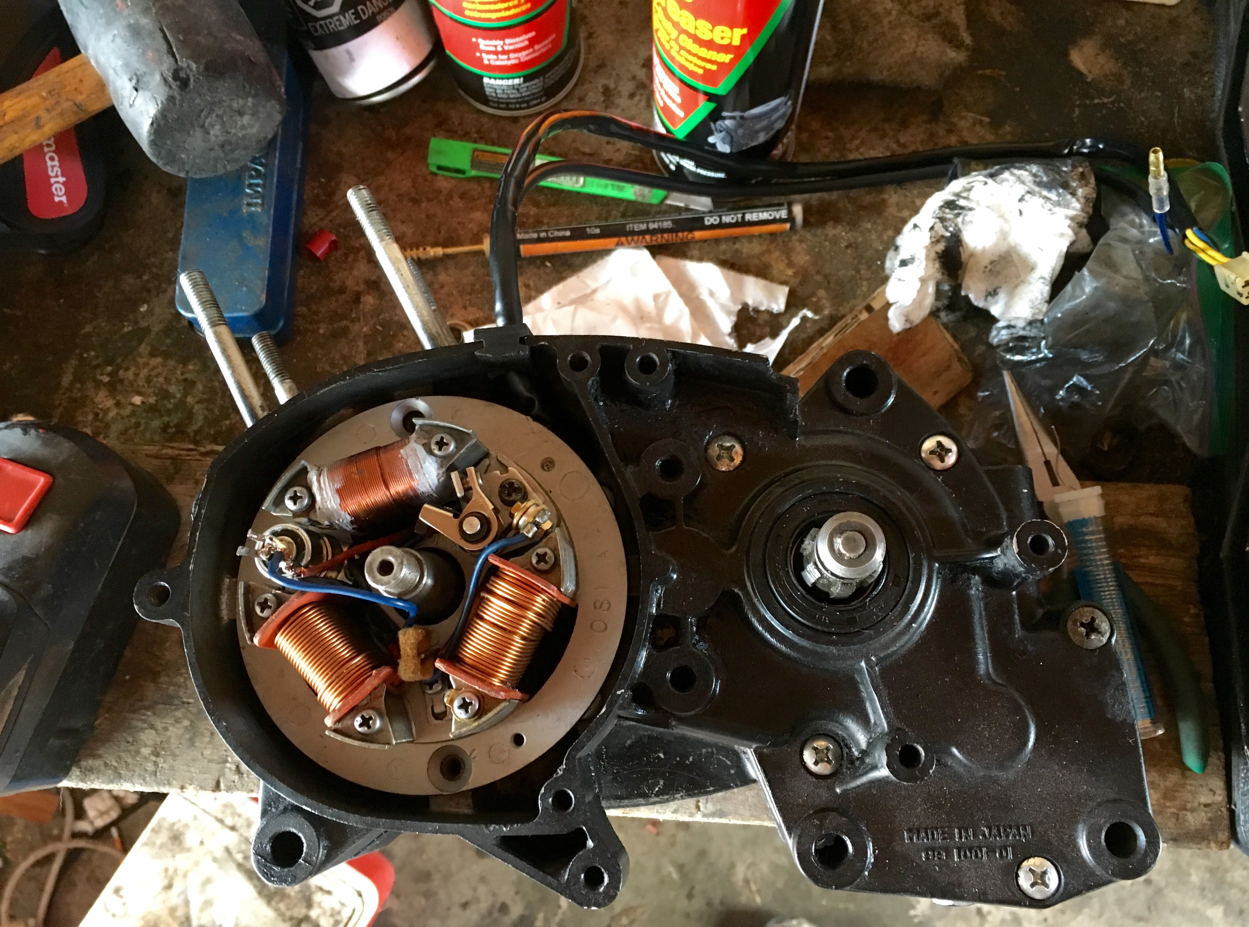

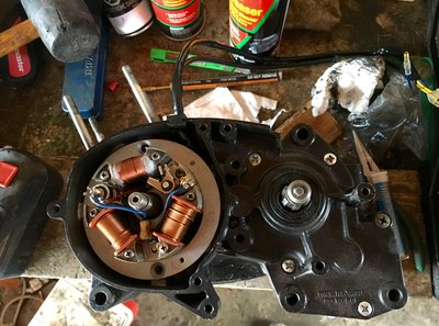

Forks are done! Also assembled the bottom end today! Just need to go get screws to hold the stator on. Tomorrow I can add the pirimary gear, clutch & kick lever to the right side & mount the flywheel! The nephew was absolutely amazed that one could put together a tranny from just an exploded diagram! Thanks again Danny Cooke for the stator! ; D Victor

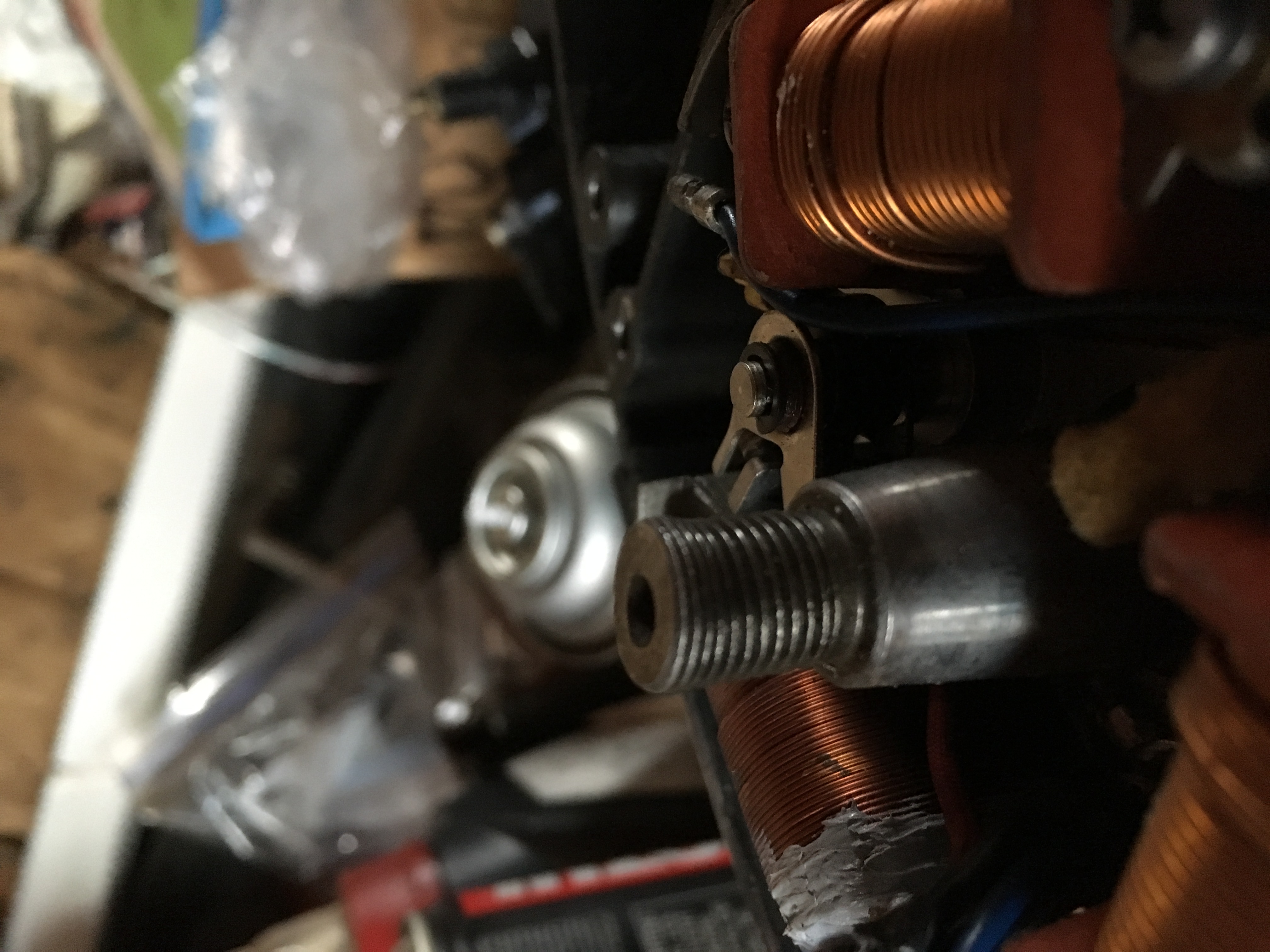

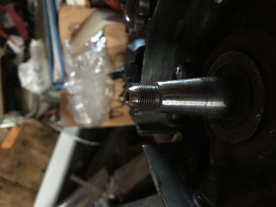

Had problems with the crank end being hammered by a PO. It mushroomed a bit and the nut wouldn't go on. Had to file it back and taper it off today till I got to better threads.

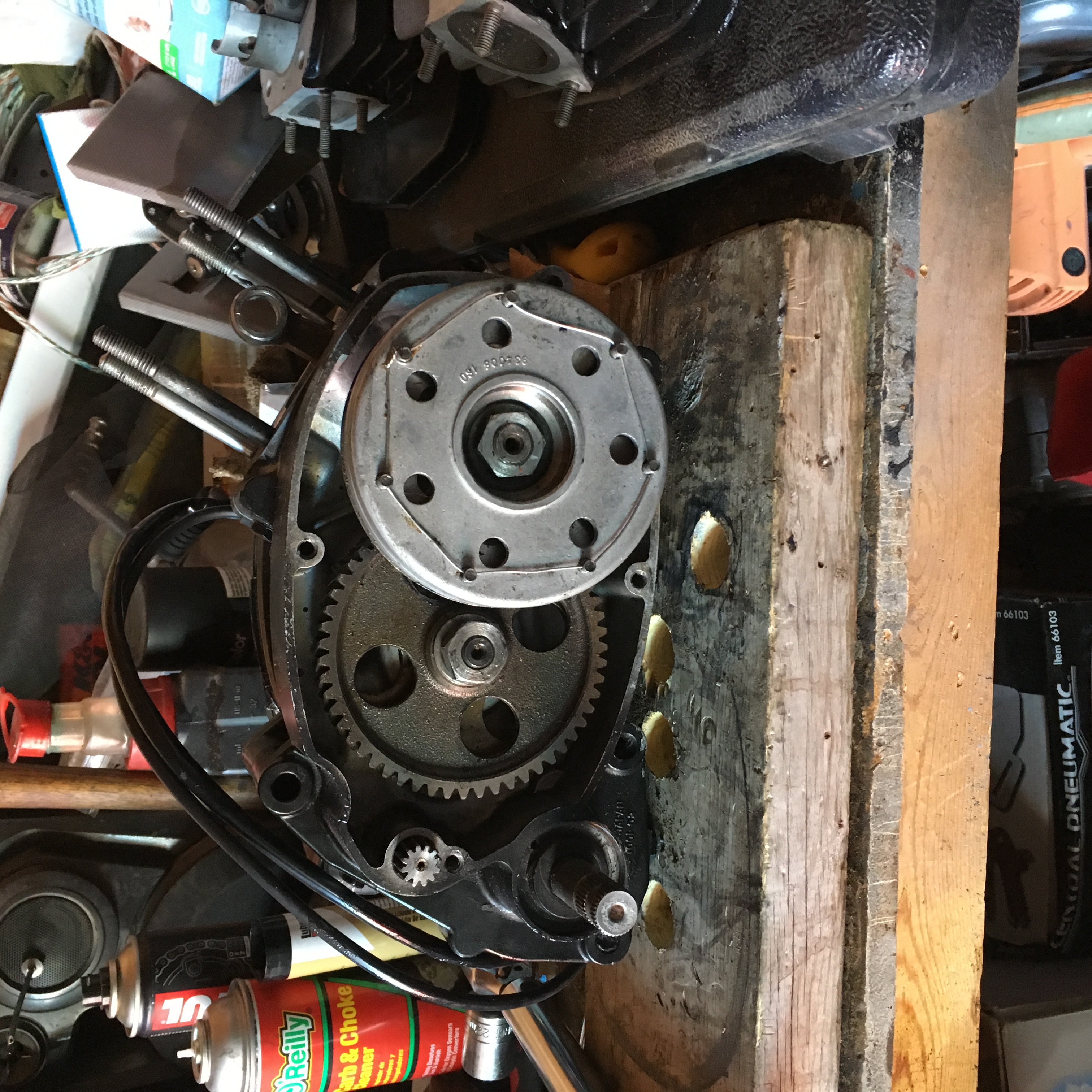

Flywheel mounted. Working on right side assembly now. Looks like it will all go together nicely. It does, however, get a bit befuddling when you spend an inordinate amount of time trying to figure out why the clutch nut won't thread back on, until you remember the darned thing is left hand threaded!

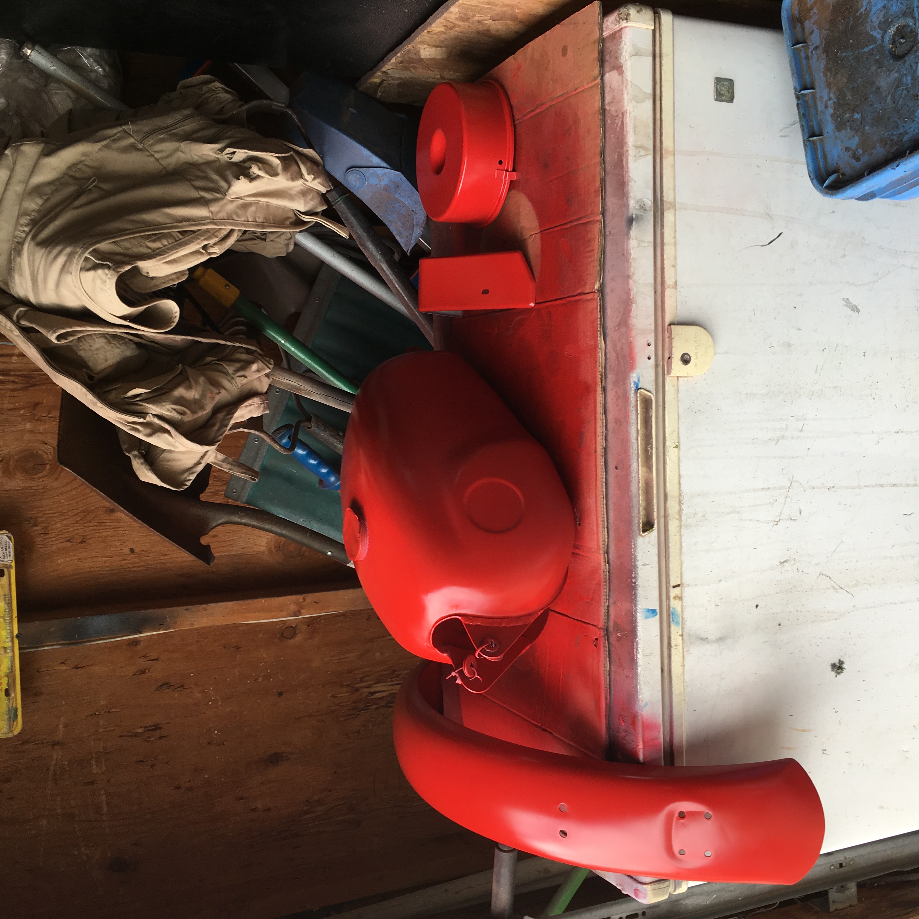

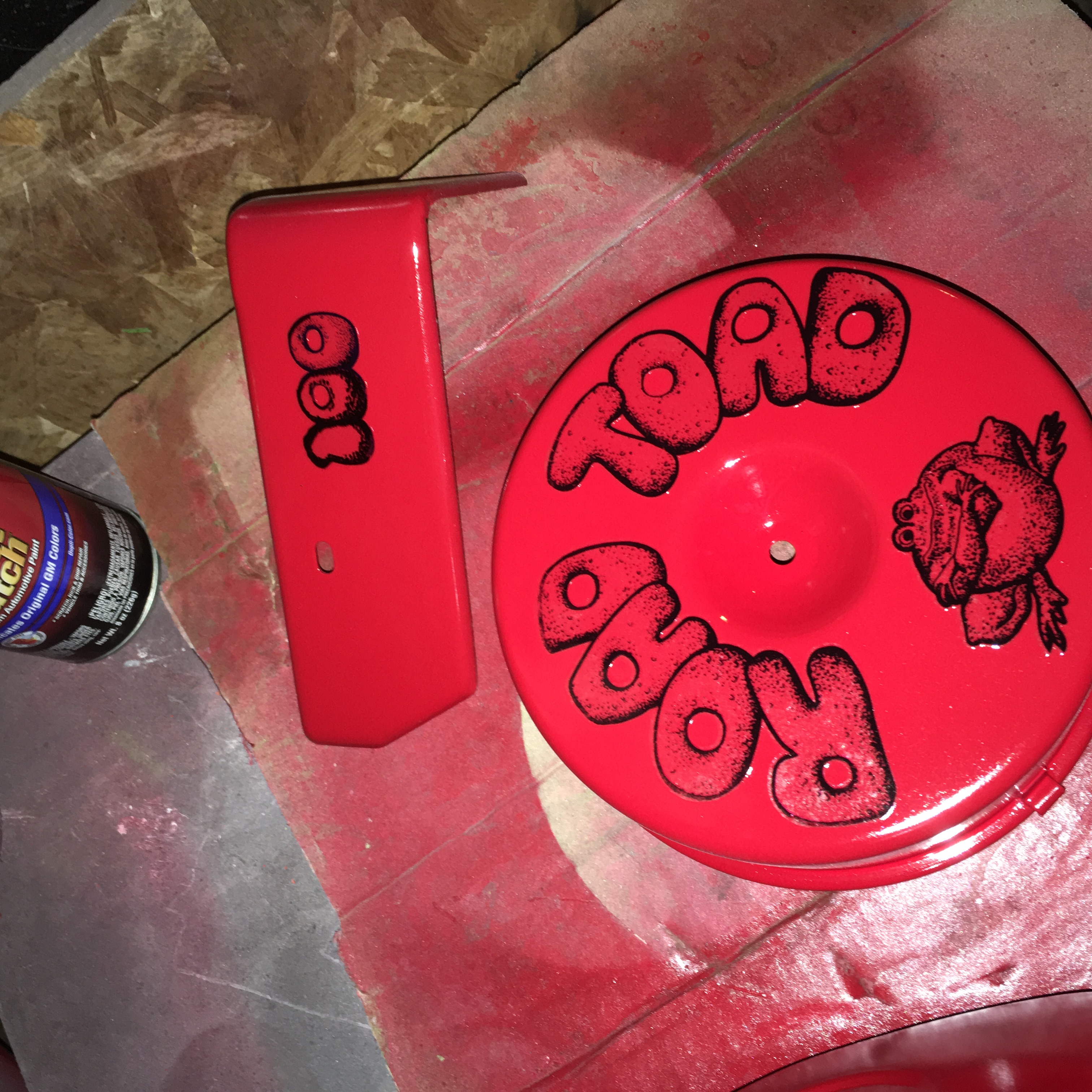

OK. So it's gonna be a Red Toad this time! Damn! I sure do like the Chevy Victory Red! Just like my truck! ; D Victor
So what do you think of the Red Road Toad? ; D Victor

Hey Victor, that red really pops. I dig it. Are you going to paint the tank and fenders the same or use the red air box as an accent. I've thought about channeling the all-red look of the late 70's Elsinores on a model 94 play bike I've been working on. I'm looking forward to seeing how yours turns out.
Matt, they are already painted. It's all Chevy Victory Red! But this photo was before the clear & graphics! Nephew wanted red & black instead of the Toad green. ; D Victor
Something inside the tank was banging around but it didn't sound like metal! I was afraid it was going to be a big chunk of rust that broke off from inside the tank. But I figured out it was actually a gas cap gasket! It was smaller in diameter than the stock one so it just fell inside! RELIEF!!! Fished it out and put the right sized Gasket in the cap! ; D Victor

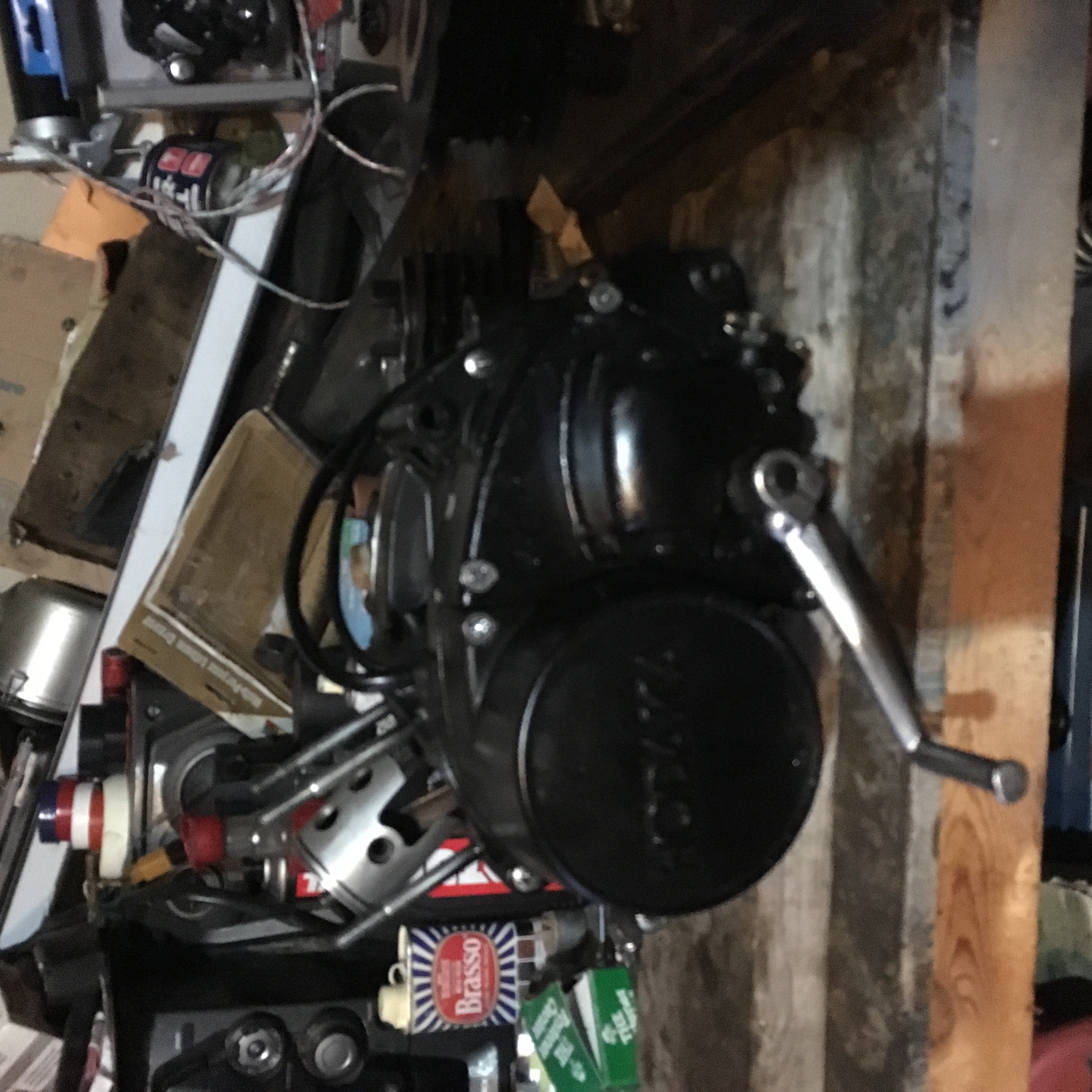

Clutch assembly on! It's amazimg what you can do when you turn the nut In The Correct direction! Need to pack the shifter case with grease and remount it. Then it's time for the clutch cover gasket and the top end!! Yippie! Getting close! ; D Victor

Matt. I did ALL the paint! The frame is Rustoleum Satin Black. The motor is painted with high heat engine paint I bought at O'Riley's Auto Parts. The red, is the Chevy Red "match" from O'Riley's as well along with the clear coat they sell to go with it. Since the tank is the biggest thing painted, I just use enough gloss coats, probably 5-6 coats of clear, so there is enough to buff back smooth. So far, only $25 in paint for the tins and another $21 in black Rustoleum.
I could have bought paint from an auto paint store, but, my compressor gave out on me and I decided to try this rattle can stuff, since the compressor was non-functional. Graphics are the same I got earlier for the Green Toad. The guy made me several sets no extra charge so I had more than enough for two bikes and it's why I didn't have any color behind the black on the graphics. ; D Victor

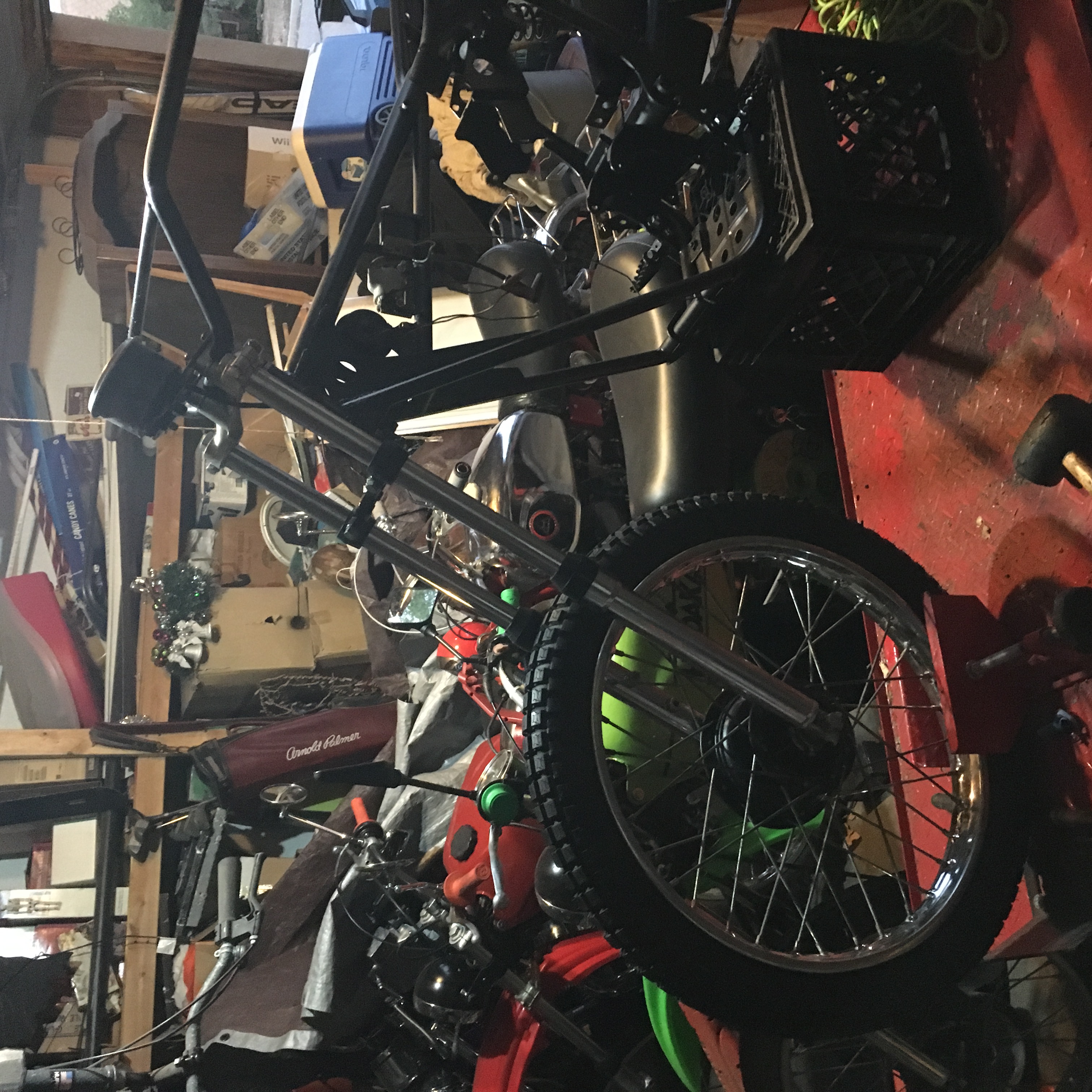

Shocks came in the mail today! Got the same kind again in black. They are all mounted.

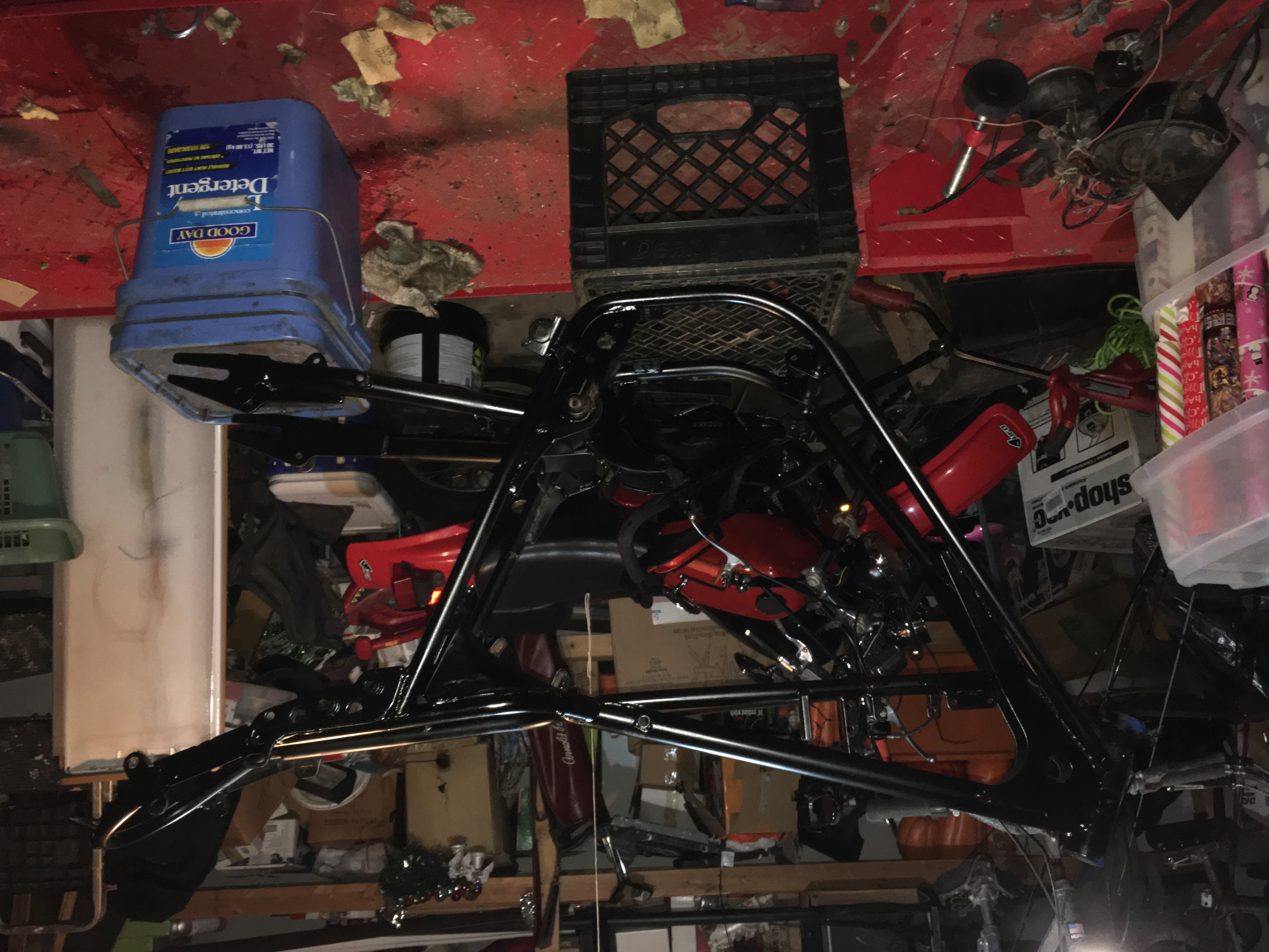

Got most of the wire harness back on today.
Question. Those plastic covers which go over the bullet & female single & double connectors. Is there a place to buy those in bulk? Online maybe or a type of store I might find locally?
I used a lot of shrink tubing today, and over wrapped the main harness sections with fresh black electrical tape. The wires weren't too brittle, so I won't be replacing very much of it. A bit faded is all but u can still make out the insulator colors fine. Now to go get a second set of keys made for another ignition switch. And I can do it locally using the pad lock blanks they figured out last time! ; D Victor
