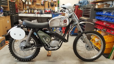

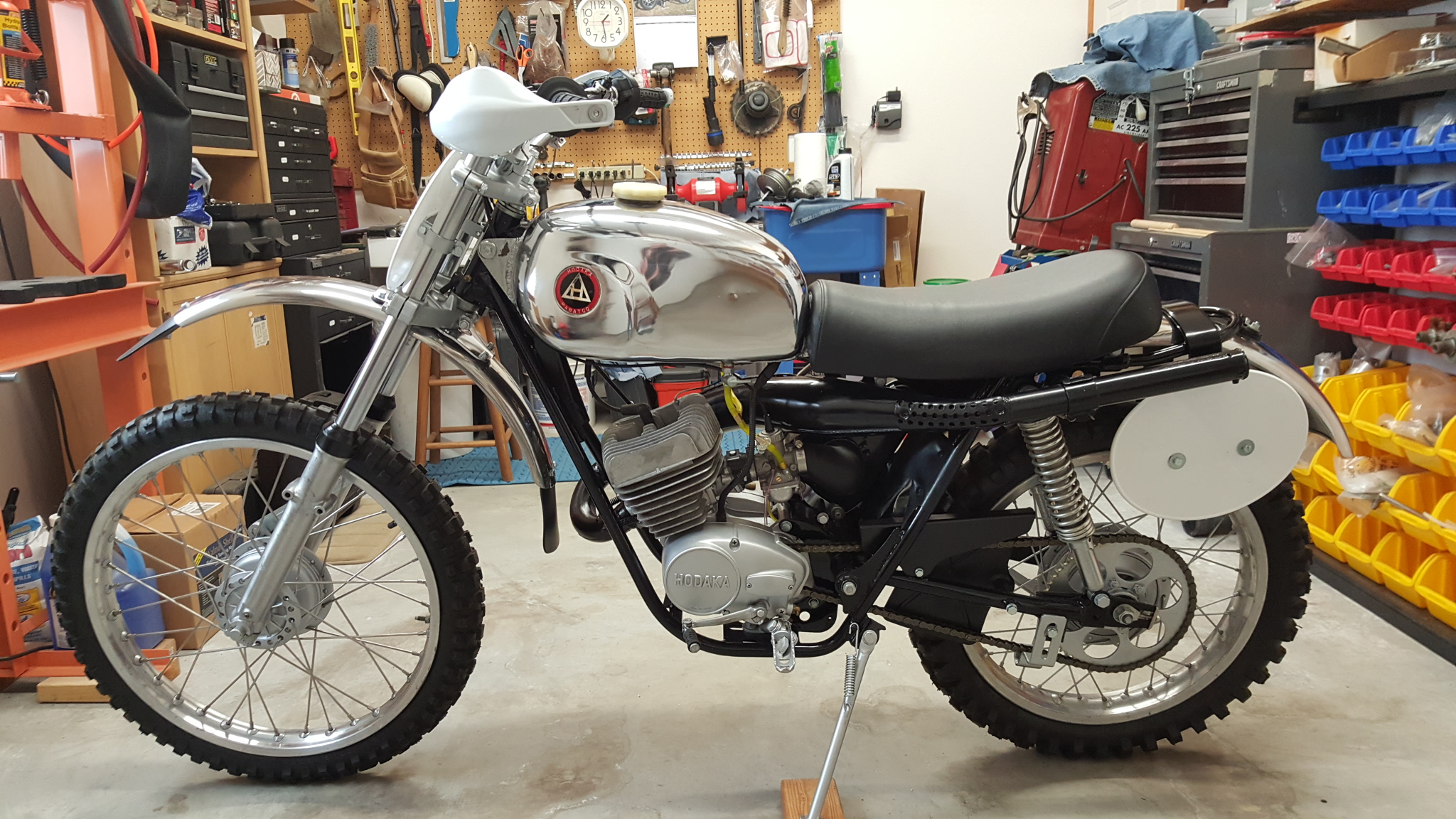

18 months but it is finally where I wanted it. Got it from Kelly at Hodaka Days 2014 and it sat for almost a year as I gathered the parts I wanted. Stripped it down to the frame and powder coated it. Installed Hodaka 250 fromt forks (still looking for some 03 springs for it.) Has Super Combat ignition, 03 cylinder ported by Rich Gagnon for low end. New 28 mm carb and 03 reed assembly. Stock alloy front rim laced up to an 03 brake assembly. Original tank had several holes in the bottom so I found a really nice chrome tank supplied by Randy Smith (via eBay).
I will have to give you a performance report later. It cranked on the 4th kick (almost started on the 3rd) but there is 5" of fresh snow and I just didn't want to try to final jet it in the snow.

That is awesome Bill. Very nice!
Re: Finally Combat Wombat Complete
Bill that really came out nice. You are going to have fun! What no ridem in snow, you would have in years past?? Great work> Clarence

Very Nice Job Bill. I can only hope mine turns out just as nice when I'm done

Sweet! Bad Rock ready?

Bad ass ride Dale. Nice job!

that's as good as it gets. I may have to talk to you about your carb and cylinder choices. Also about the front hub. I'm using this bike for my benchmark. Nice job, ( that tank is awesome)Bud

Yep, that's a nice looking Combat Wombat.

Cylinder and carb choice was based on wanting to ride trail and woods and not motocross. Port timing was changed only slightly ... just opened up and case port added. I have this same cylinder and porting on my Super Combat, but I have an HT3 pipe and 32 mm carb on it. Just wanted a little more low end. Will find out if my choice was right when the weather improves.
Hey Bill, what more can I say, really nice.

Outstanding job on the Combat Wombat Bill! You took your time and did it right. Richard
Bill, this confirms my theory of Hodakas being built to be modified. Serial number beauties certainly have their place but we are limited on what we can modify. This is a great example of not only workmanship but of innovation. Good job! (again..) You're my kind of guy. :D
