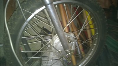

My father has offered me his Wombat, he has been the only owner. I was able to look it over today and it is all original, in really good shape considering the age. After looking at the ID chart I have verified that it is a 1972 model 94 Wombat 125.
The bike was put away somewhere between 20-25 years ago blocked up off its tires. I am not new to bikes but new to preparing one that has been sitting for so long. I have a few questions I hope those of you more knowledgeable on here can answer.
1. What, if anything, should be replaced? (i.e. gaskets, seals, bearings, cables)
2. What is the best way to polish up the chrome tank?
3. Do I need to pull the cylinder or just squirt a little oil in the spark plug hole and let it soak before kicking it over?
4. If I wanted to in the future is there a turn signal light kit that could be installed on this bike?
I intend on using this as a daily rider back and forth to work for now. As money allows I will look at possibly doing a complete frame off restoration this next fall/winter.
Thanks in advance for any help.

From the pictures, that Wombat looks to be in really nice shape.
In my opinion, any bike that is 40+ years old should have all the motor seals replaced. It would be a shame to fire it up only to have an air leak and seize the motor.
As for polishing the tank, it depends on the condition. If the chrome isn't blistered from rust or peeling, just go over it with chrome polish. There is a thread on this forum regarding different polishes. If the chrome has rust, try aluminum foil. Google it to learn more.
As for squirting oil in the cylinder, it certainly can't hurt. I generally try to kick the engine over to determine if the piston is stuck. Regardless, if you replace the seals the entire top end needs to come off anyway.
As for turn signals, the model 94A came with turns signals and they could be retrofitted to your bike if you can find them. Check the parts diagrams and wiring diagrams to compare the two bikes. This will give you a better idea of what you need.

The tank should clean up with a bit of chrome polish and some energy. The inside of the tank is far more important. Check for rust. If you find some and can't find out a good way to eliminate it, ask here. Most Hodaka's will have rust in the tank no matter how well stored.
I also check for a free piston from the get go. Just kick lightly and listen carefully. If it is free and moves without grinding, it may just start right up. If stuck, or you can here rust grinding inside the cylinder, stop and take it apart. Mine sat outside, not even inside in a garage, from 1981 to 2007, and it started right up. It was covered with a tarp, but that hardly counts, and it sat on my deck in Alaska all that time, but still had a clean bore. The carb was empty when parked, so it didn't have to come apart to work.
The tank however was a mess inside due to atmospheric moisture. I cleaned it with radiator cleaner and BB's. Shake, Shake, Shake, and so on.
As for engine seals, it is a crap shoot. Mine were fine, yours may be shot. Do a leak down test to start. Or, just figure on a comprehensive tear down and rebuild, and take comfort in having a nearly new motor.
You will get to know your bike by taking it apart and cleaning everything.

SpokaneHodaka, I just finished cleaning the inside of my tank with Metal Rescue and it turned out amazing! I did wash it pretty thoroughly first with hot soapy water and sheetrock screws, then let it soak for 3 days with Metal Rescue (purchased at Home Depot) inside of it. I was going to put the tank through electrolysis at first, but read too many positive reviews about this product to pass it up. Great stuff!!!
Also, I would certainly go through the carb and make sure nothing is plugged or the float valve and seat isn't sticking.

Be sure and rinse off the dust and dirt softly and gently before polishing . If the chrome is really good I use mothers mag wheel polish. Many of us have different favorites. Always put at least a teaspoon of oil in a dry cylinder before turning over and more oil if it wont turn over. If the bike was stored in a extreme heat as left in the sun the seals harden. The wombat looks good! ------------- Clarence

Very nice example of an original Wombat! I'd like to make a couple more suggestions as well. I would drain the transmission and refill it with fresh oil. Cheap 30 wt non detergent is just fine. I would zip tie/tape/rubber band the clutch lever closed to the handlebar. If the clutch plates are stuck, just leave the lever pulled in while you work on something else. This is where I start on every old bike that has sat for a while. After the bike has been run for 30 minutes or so I would drain the oil and refill with your favorite oil of choice.
After the tank and petcocks are clean, make sure the air filter hasn't turned to dust. Service or replace as necessary. Remember, when oiling the filter a little oil is all that is required. It's very easy to over oil a foam filter which can present a lot of problems when tuning the air/fuel mixture. I would suggest replacing the old brittle fuel lines and install an inline fuel filter.
I'll not go into cleaning the carb but would suggest that you remove the exhaust pipe and make sure it is unobstructed. That would include the baffle and spark arrestor. I hope these suggestions are of some use. Good luck with your project and keep us up on your progress.
