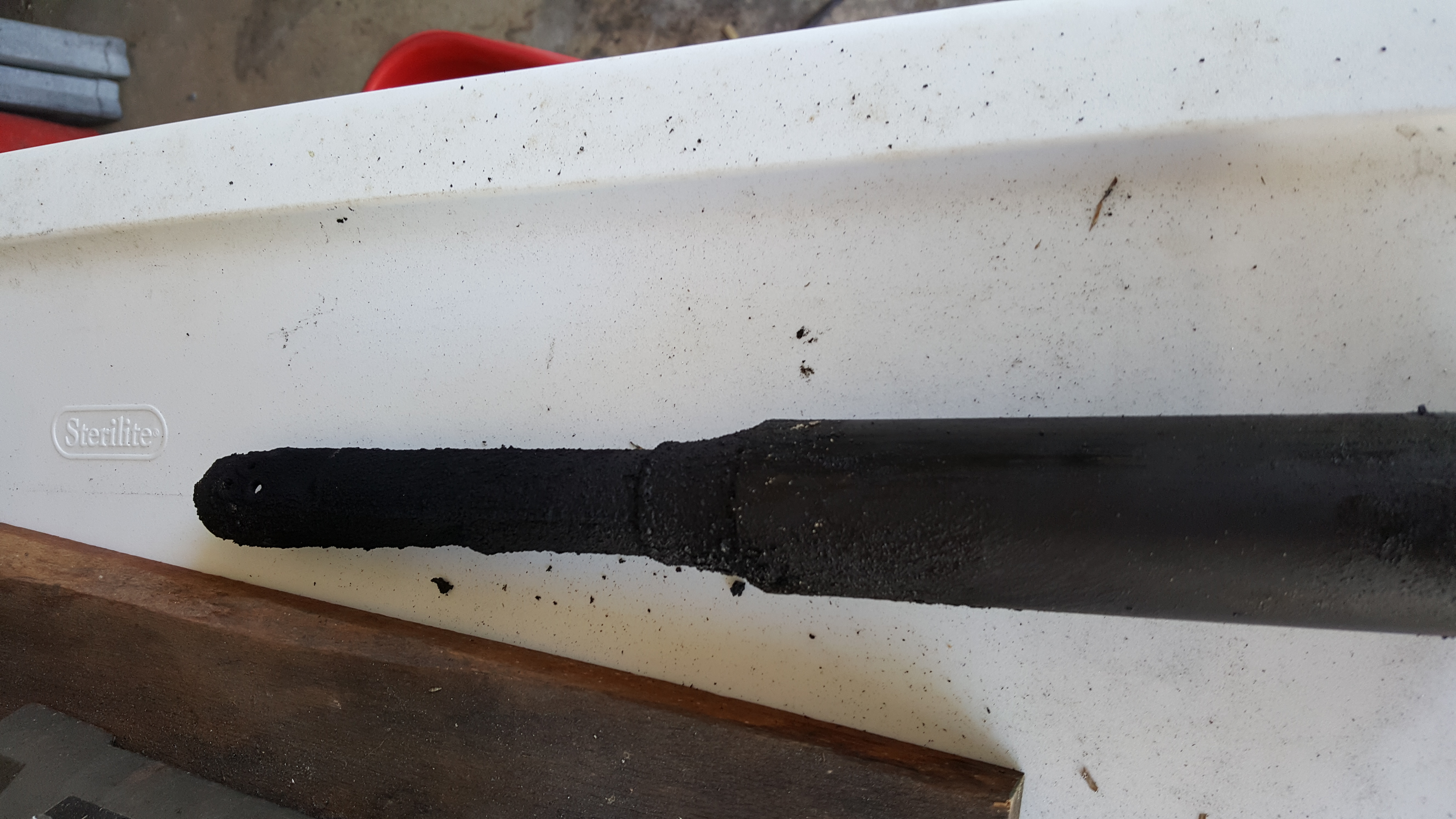

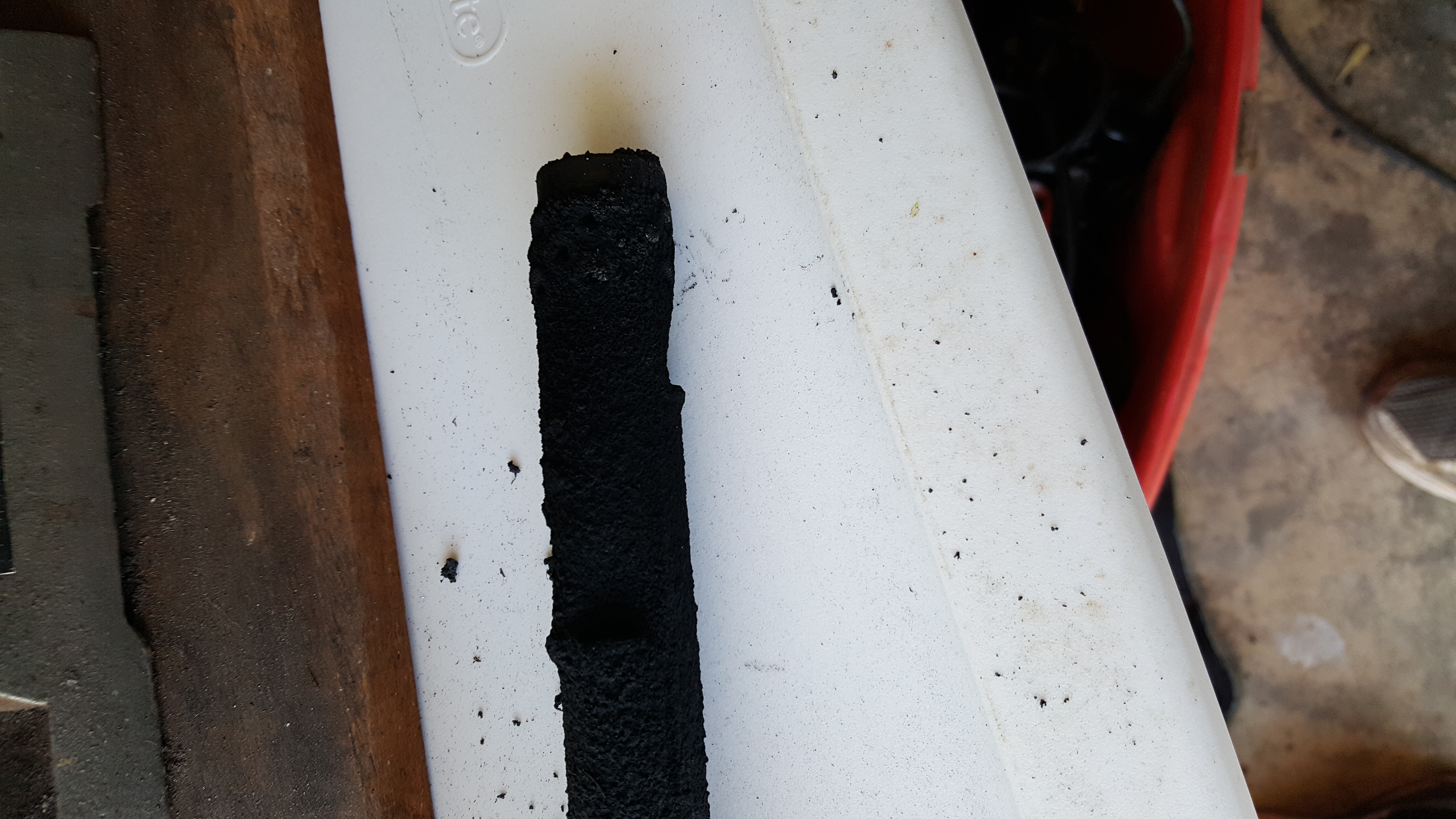

Was about 90% blocked. Didnt even know there was an insert in the muffler pipe. Pulled it out and it had about 1/2 inch of carbon on it. Wire wheeled it down and cooked it with a torch. I think the rest is pretty clear. Torch cleaned as much as I can in the muffler.

I’d still put it over a fire! You’d be surprised what will burn out of it! And a quick spray of black high heat engine paint will make it look new again! :ugeek: Victor

I am not an expert but in my research I hear many people say its Placebo Power to throw it on the fire once you get the choke points of the exhaust clear. They say you are talking about minimal performance gains but it looks cool and gives you a sense of accomplishment. I do not have the inner spark arrestor piece and I am not willing to pay for a new one. I feel with the inner arrestor missing I may want some restriction in flow. This is of course not a race bike.

I have burned 3, or actually 4 pipes so far. One pipe was the wrong model & got repainted & sold because it didn’t fit. Everyone of them loosened up old oil, carbon deposits and 2 of them actually became flame throwers for awhile. Just saying, never underestimate..... :ugeek: Victor

I made a flamethrower out of the inner spark arrestor. Clean now.
