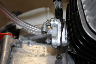

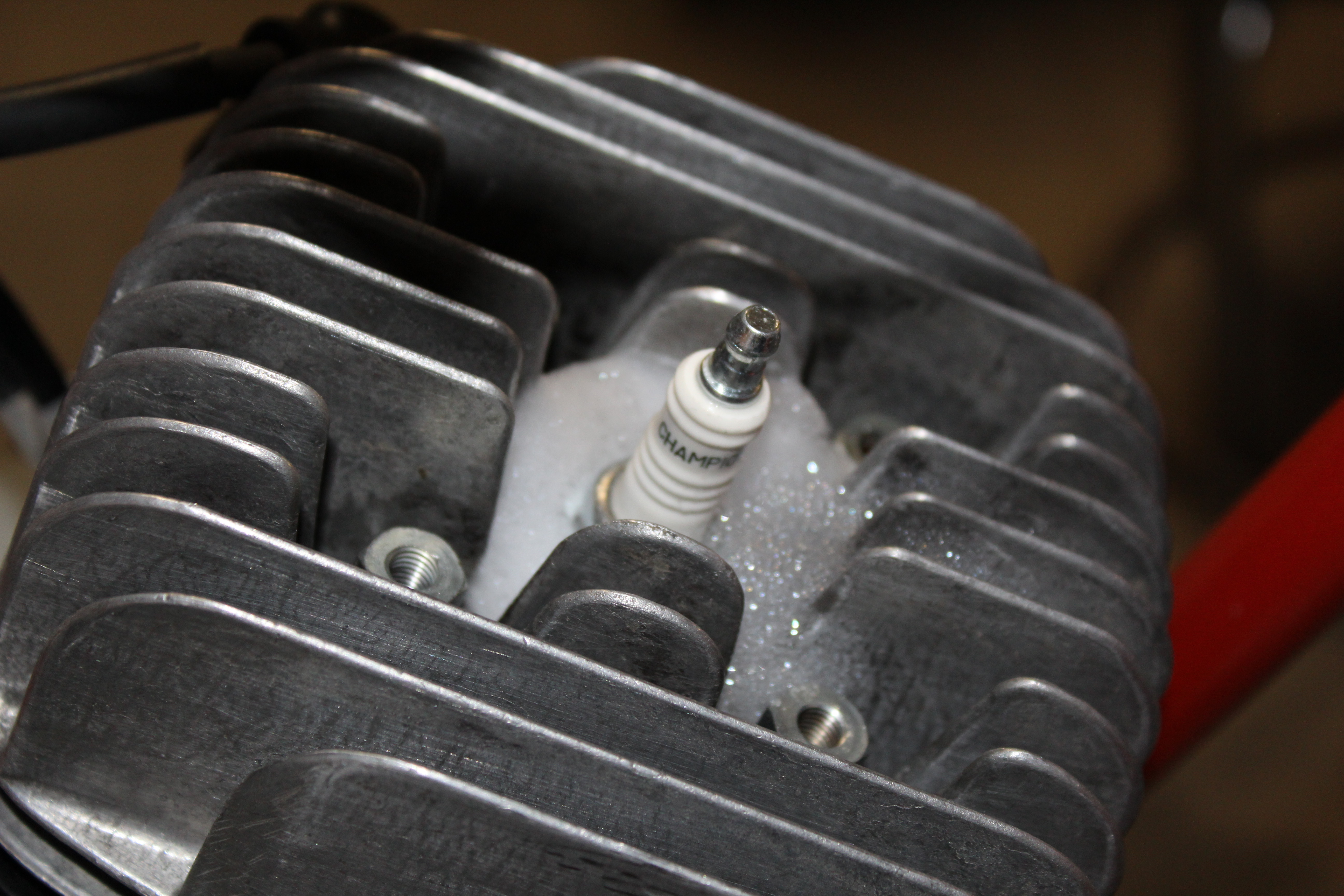

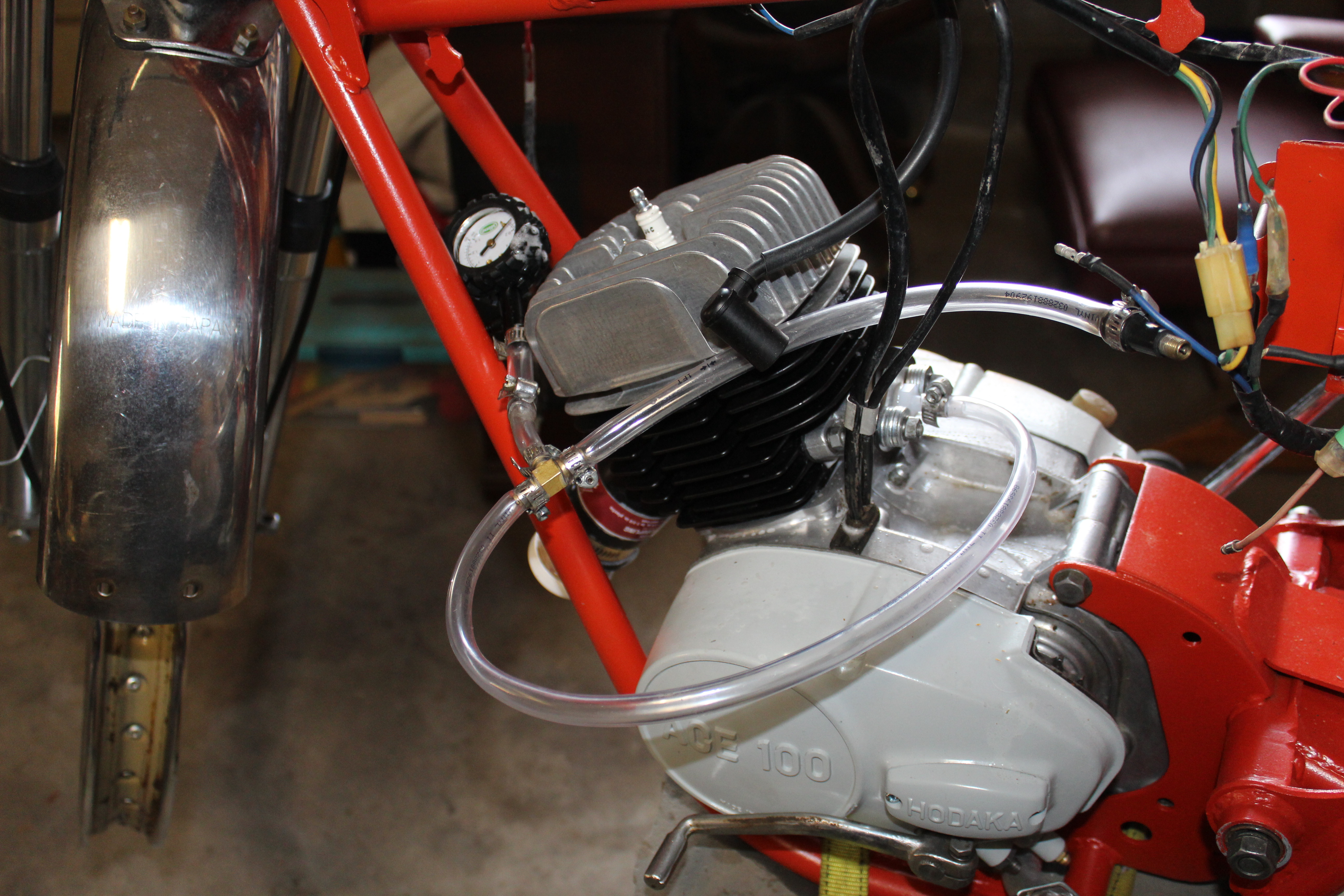

i did a pressure test and the results are in, from 6 to 5 psi.. less than 10 seconds... 5 to 4 ...psi... 45 seconds... 4 to 3 psi 1 min 45 seconds... 3 and undertakes for ever. i ran this test 5 times so this is how it averaged out. there is a little leak around the spark plug but i didnt want to crank on it to hard
Re: ace 100 project
Plug should be hand tight with a socket wrench. Don't wrench on it like it's an axle bolt. Actually somewhere there is a torque spec for it, but it should not leak at all.

There is no need to continue the pressure test for more than a minute (other than being curious about the leak-down rate curve). 6psi to 5psi must take one minute or more. Leaking down faster than that is a FAIL.
Your next step is to find out why the spark plug area was leaking and fix it. Then run the pressure test again, to search for other areas which might be leaking.
Re: ace 100 project
the spark plug is as tight as i want to go and it is a new one so i will check it out a little closer and and i was just being curious about the numbers. i didnt do a complete rebuild so i think i have to back up and go through with that. i was try to not go through with it as i was a little intimidated but ive been reading a lot the last couple of months and i think im good to go. theres a issue or two with the wiring so i might as well start with this and work out. ow well i do know if i got this litle bugger working the first time it would of been a modern miracle.... albert
Re: ace 100 project
You might try a bit of plumbing Teflon tape around the plug threads to see if it subsides. At least for the test you’ll be good. Then you can decide if the threads need repair or not. :ugeek: Victor

i put Teflon tape on the threads and it took the leak away so some work there . and no you cant have the head back i got a piece history and its mine now. i read about your racing days in the resonator and its a cool story. yep real or not i got a piece of history looks nice to...albert

sorry victor, it slowed down to about 45 seconds from 6 to 5 then just a hair under 5 it moved so slow i couldn't watch it any more. i think it needs the top of the hole cleaned up then we will see....albert

What is the thought on using Teflon tape on a sparkplug in a head that doesn't have pristine threads?
Can it be used long-term?
Re: ace 100 project

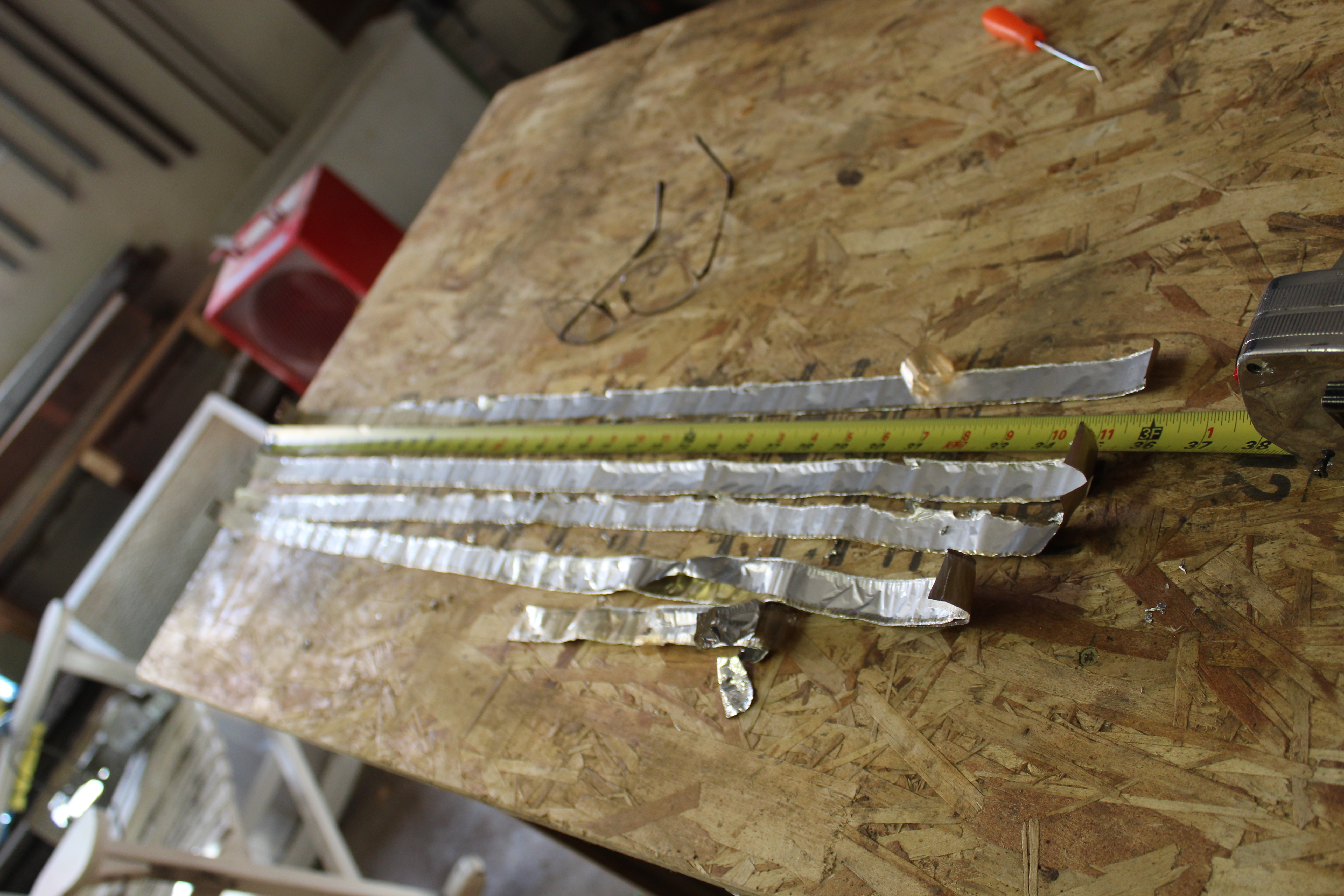

no you cant use it for any thing but a test, if you use it and run your motor it will just melt and ,stink make a mess. its my understanding that if you have a leak around the plug hole and the tape fixes it you now know you have a problem and can plan a fix for the treads. on a nother note i replaced the condenser and could not help my self so i took a dremel and cut open the old condenser. it had 13 feet of rolled up foil? with a clear plastic? sandwiched in between, with a plastic cover to insulate from the metal cover that holds it all togehter
