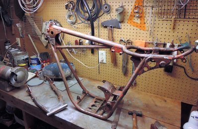

I've got the engine soaking in applications of penetrating oil to see if that decades old crud mixture coating can be softened before scraping and solvent. First I need to work toward a basic sound frame and swing arm. It's mostly just grinding off weld and crap but I do see where one of the swing arm axle plates is warped from the welding/bracing attempt from the past. I do have most all the grease and paint off to start the process. One step at a time.
One of many reports,
De-greased and stripped.

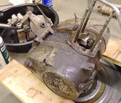

I'll think I'll let this soak a while.
Re: The 2 the Max Project
That motor looks like it spent a lot of time sitting outside uncovered. Now you have me curious to see how you refinish it! It's a good thing motorcycles don't have memories of all the abuse they've been put through. And the frame looks ready for some lifesaving as well! Air conditioned garage?!?! Man I wish I had that!!! :mrgreen: Victor

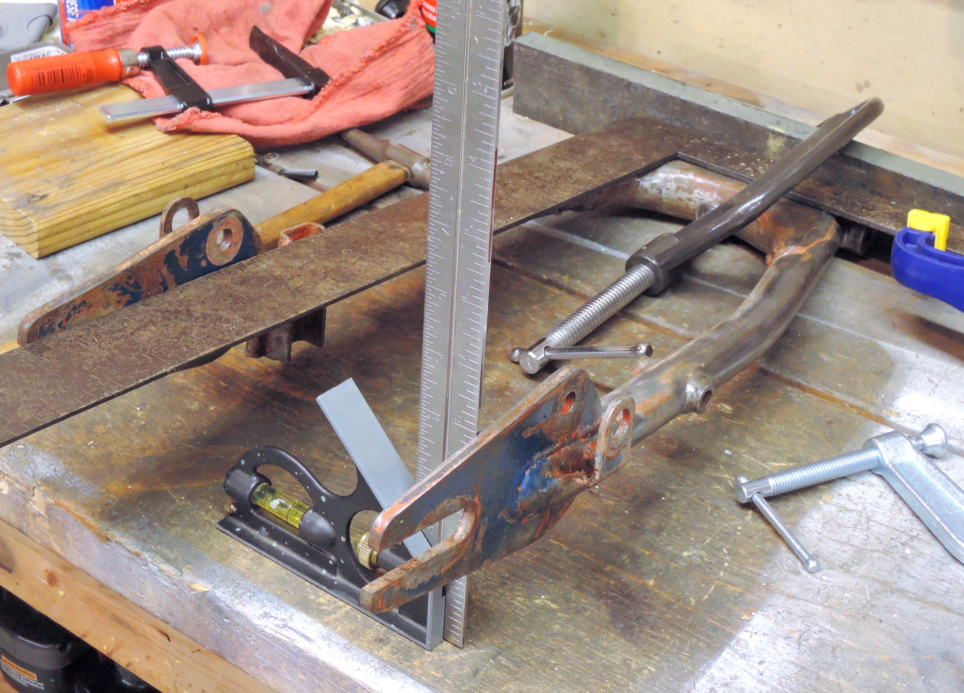

Hey Victor, I'm in the AC garage trying to see where the swing arm plate is bent. It's the left plate where the PO welded a plate on the outside for strength which only warped it. I've got the plate already cut off. Now to see if I can straighten this thing with what I have. Onward!
Homemade swing arm tester

Off to the metal fab guy. I don't have enough torch and flat metal table. This would be fairly simple if I had the right stuff. Grrr. Better to do it right but I always try to give it a shot. LOL!
Update: Having the right tools and a good eye for those things, my clever metal fab guy took about five minutes to fix the problem. Yay!

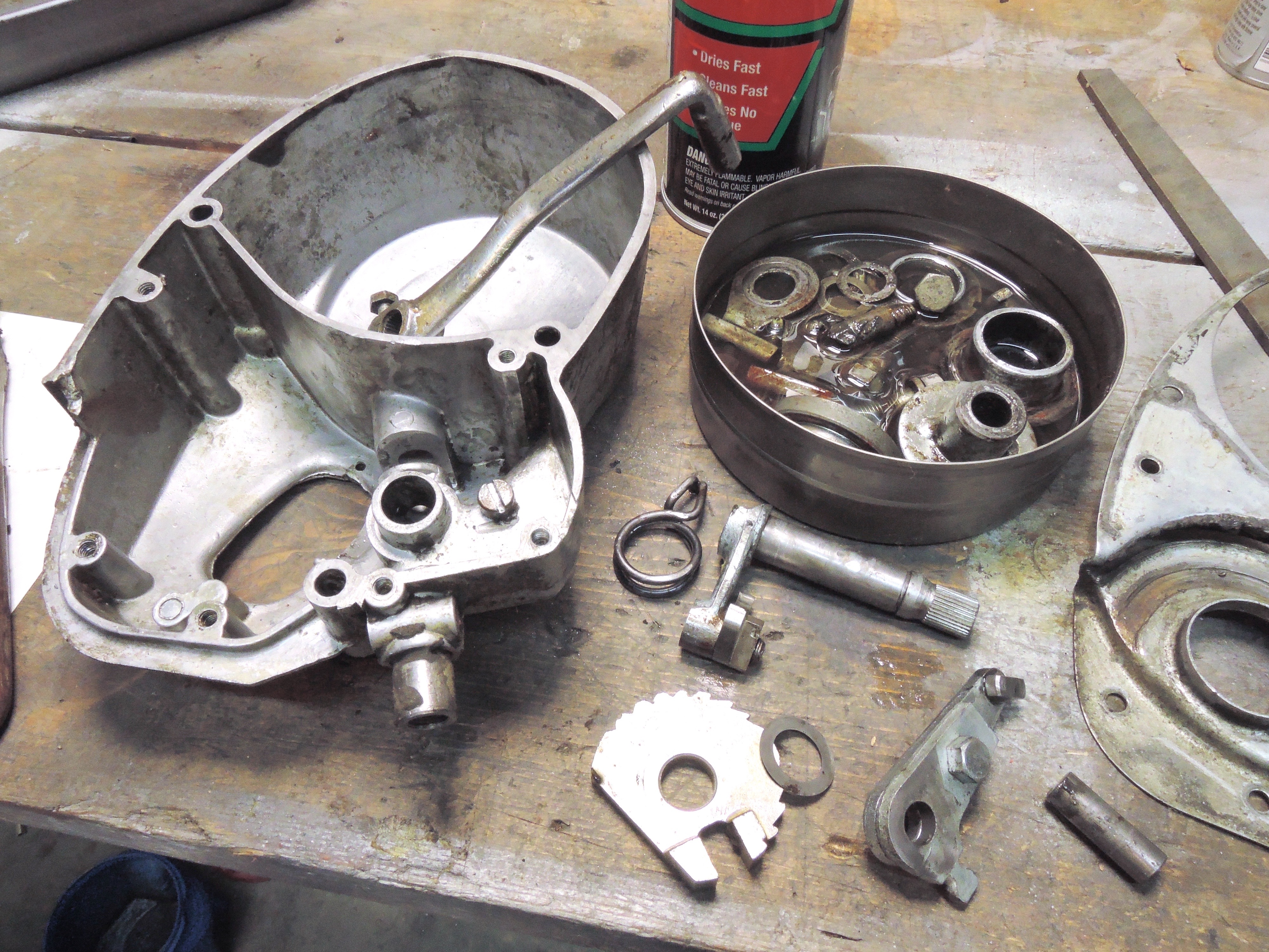

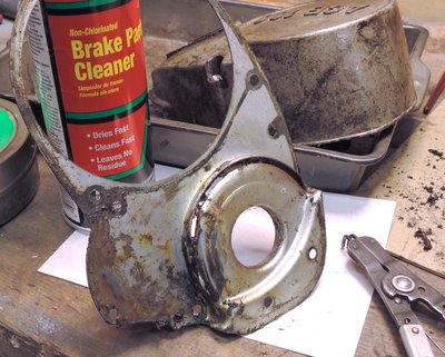

I have two new messes, enough for a W.I.P. I wouldn't anyone to miss out on the fun of restoration. Shifter case removed and it appears we were running battery ignition. Back shifter case stud on crankcase, always good. Plenty greasy but the shifter case appears rebuildable, also good. Reporting.
Gooey shifter case
Gooey shifter case

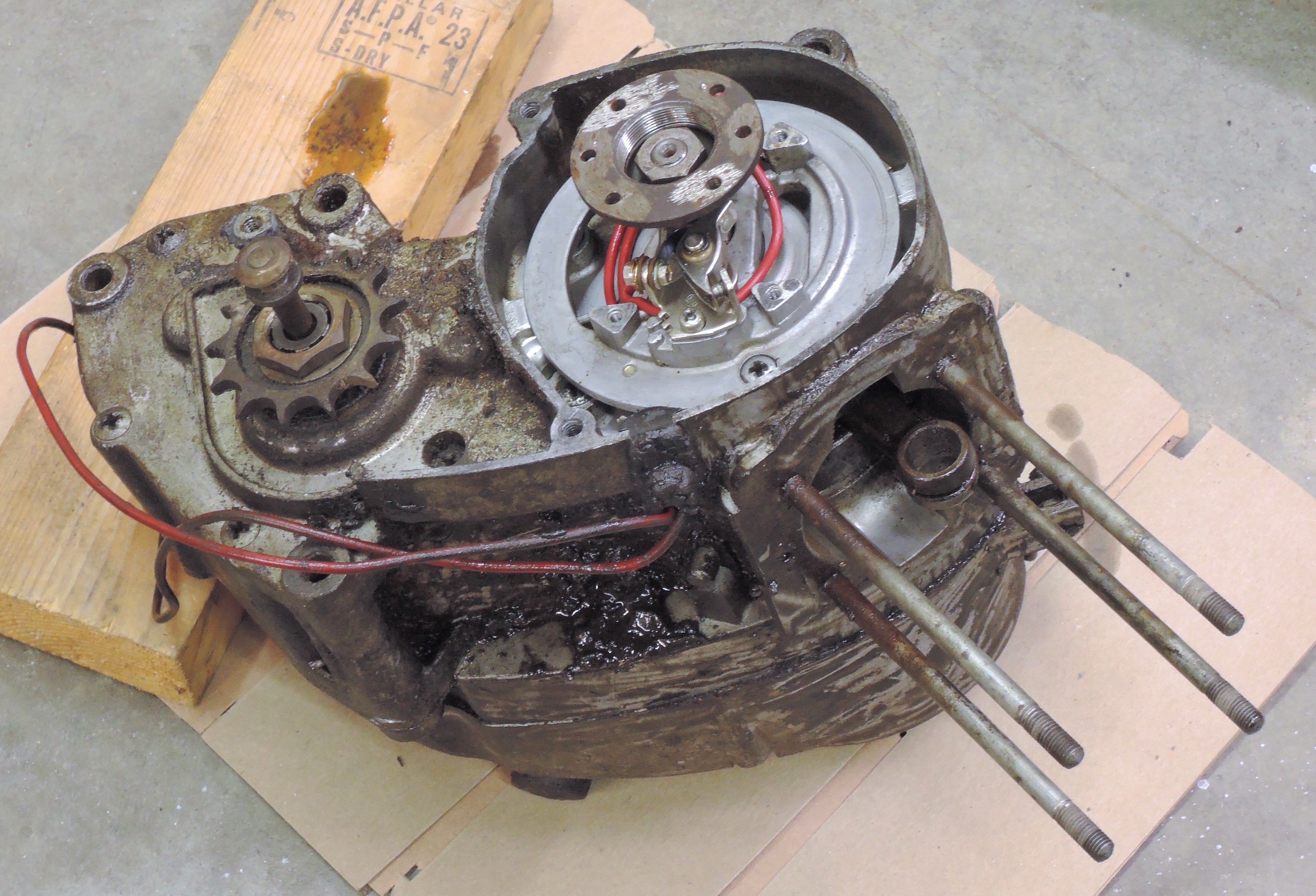

Battery ignition or at least no flywheel.
Funny, I thought that I had a really nice inside shifter case plate until I cleaned the grease off of it. The smoothest cut I've ever seen on one. Repairable.
Smooth job.
Smooth job.

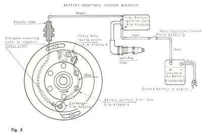

Beautifully cut by an oversize chain, Maxie? Kind of a cool surprise under the mag cover. Did you run a total loss ignition on your flat tracker? I thought that was the order of the day for go-fast bikes. No flywheel to contend with and quite a bit of weight loss without resorting to donut restrictions. Are you going to keep the total loss ignition on your go-fast build or is it back to the magneto or otherwise? Cool options, yes?
Hey Matt. We used the battery ignition on the flat tracker for a while. While it did seem to have more power and was definitely quicker reving but it lacked the momentum of a flywheel for a consistent good start. Fiddling with batteries was also a pain and yet another weak point. Most flat track races were won at the start or at least it was a really big advantage to be in the lead right off. The advantage was to the flywheel for consistent starts. Nobody had any more power than our engines so the flywheel was the way to go. For a speed attempt (still dreamin' LOL!) a battery ignition system is not out of the question.

Hey Matt. Now you've got me thinking about battery ignition for the project. I can see updating this set-up with light Li-Ion batteries and some hot coil. It all would all be much lighter than flywheels and ancient lead-acid batteries. I still have and original 913007R point cam from the day. Without measuring yet I wonder if the cam duration is any different than the magneto version. Just plotting!

For a dedicated go-fast machine built for for speed runs, the considerable weight savings would be a factor. It would be a period-correct, legit mod, and the lithium batteries deliver more consistent power and at a much lighter weight than the lead/acid batteries of yore. I've never operated a total loss ignition. Can you compare the racing cam to the flywheel dimensions through simple micrometer measurements?

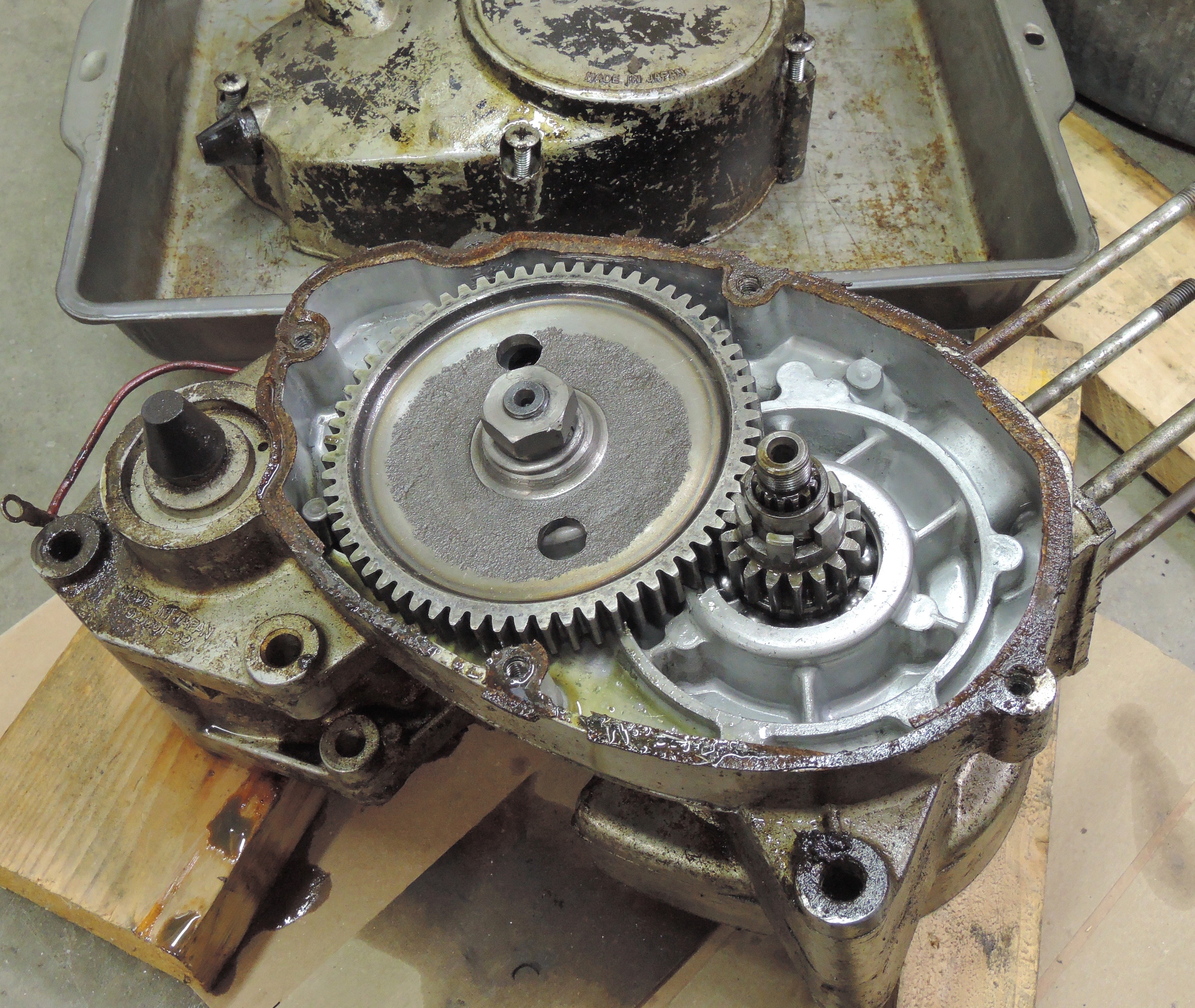

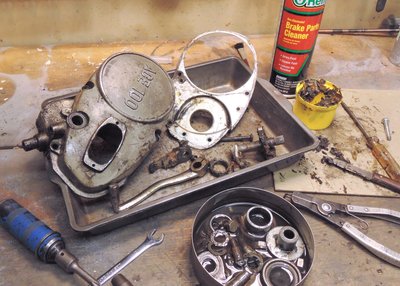

A quick peek on the clutch side reveals a couple of surprises. No clutch. It's remarkably clean inside and does have a nice set of straight cut drive gears. No kick starter shaft which was common in the day for Hodaka short trackers to get rid of weight and spinning gear in oil. It will be interesting to see what's inside! Now to post this before I stupidly delete it, lol.
Clean, straight cuts but no clutch or kick start.

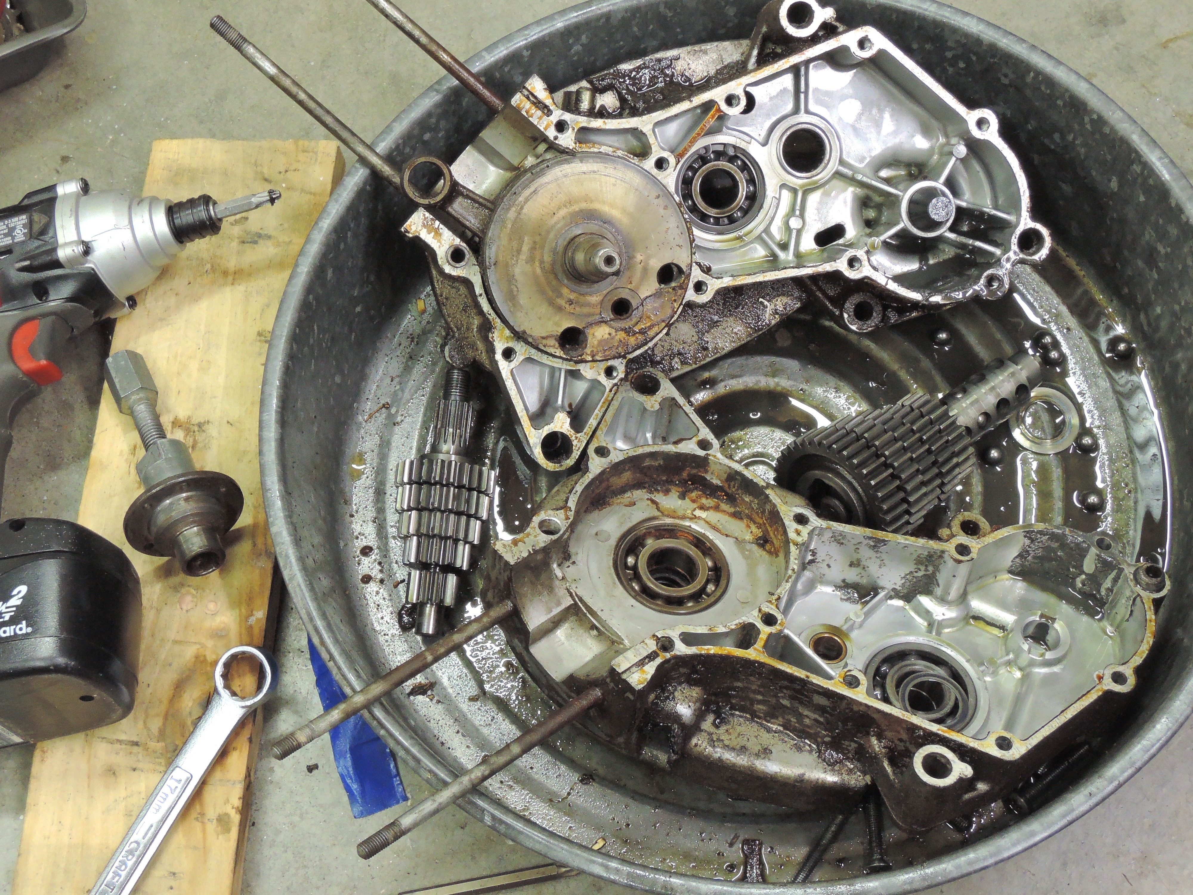

But wait! There's more! I was going to quit for the night but I wasn't far from seeing inside and had to push on. Tranny looks good. The crank assembly looks to be unhappy due to standing in water. Again the inside was shiny clean but with loose crud in the bottom. Whatever the lubricant was it didn't allow any deposits to form. Ok, I really am done for the day with some good and not so good news. All part of a $65 bike!

Wow! I'm still amazed by my inexpensive battery powered Craftsman impact driver. In the old days it was the old blue hammer driver and special tools to keep things from turning. Last night I disassembled the engine in minutes while hand holding primary gears and the flywheel cam as I just spun them off. Case screws, no resistance. Of course you do need the proper # phillips bit or equivalent. What a device!
