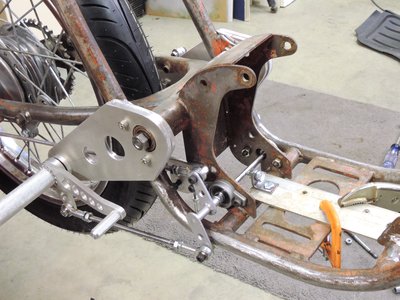

You've probably heard enough about solving first design problems of my pivot joint braking system but while waiting for the larger bearings and shaft to arrive I just had to review alternate fixes and to see how things work for my own satisfaction. The shafts ball bearings are needed for a easy return of the brake lever. The springs that do this are on the brake shoes. It works very well without supplementary return springs.
Even though the design actually works there is a flexing of of the 1/4" shaft of the original prototype design which is being updated with larger shaft and bearings along with stainless steel levers for appearance. Part of the flexing is due to the fact that the bearings gimbal which wasn't considered in the beginning which is what prototyping is all about at least for me.
More thinking on this while the new parts are in transit. With a healthy push on the rear brake lever the deflection of the 7" shaft is about .020" between the bearings, enough to be noticed at the pivot joint. All quite useable but not a perfect prototype design. My first thought was an additional support with yet another bearing in the middle. Hmm, bad design. The shaft is only bending under heavy braking and has stopped rotating. Only a stop in the center would be needed and as braking subsided the shaft would be free to return.
A quick working model was built and the clearance was set at a few thousandths. Quite an improvement when tested but still a slight deflection noticed at the pivot joint. Part of the culprit is the gimbaling bearings which still allow some bending in that part of the shaft. All of this confirms that we need a stronger shaft and/or non-gimbaling bearings. Hey, this is how I learn, I was probably taking an Art class at the time. :lol:
I hope I'm not boring everyone with my amateur research but I have learned several things about motion, physics, design and materials. Beats the hell out of TV. 8-)

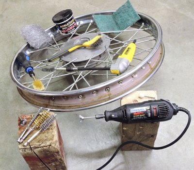

Hey Max, I noticed in your last pic that the hub is nice and clean. Do you have a special tool or product that you use to get them that way? I have a hub I'm working on with no spokes in the way and its still taking a lot of elbow grease to make it look good. Much harder when its mounted on the bike.

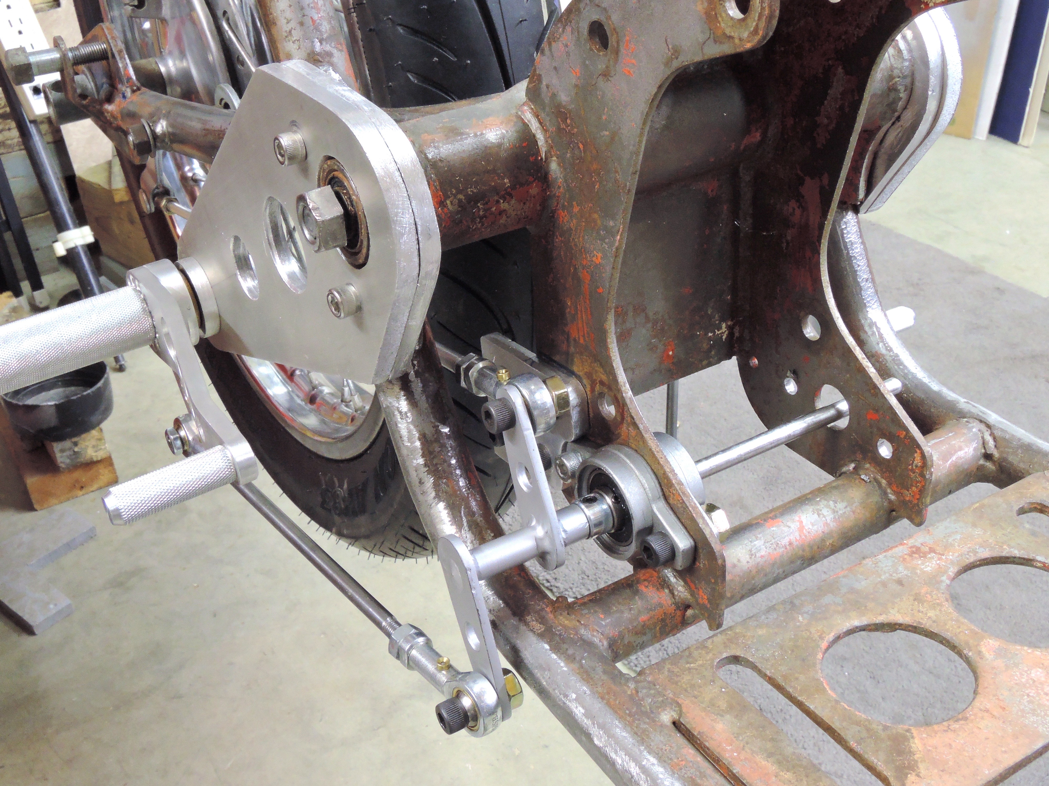

Eureka! Having fiddled with the problem enough and finding the gimbaling bearings were all allowing this flexing to occur let's move the bearings together on each side of the first plate. Wow! Works perfect with no flex or bend at extreme braking pressure! It appears that the problem is solved. Not only that, the 1/4'' shaft is not undersized in the change of position. Persistence and discussion. Yay! :D

Thanks Gang. Ah, but the story of my life. The day after I figure all this out, the new 12mm non-gimbaling bearings arrive and the new 12mm stainless steel tube is on its way. I'll still make the upgrade if nothing else for the cool polished stainless steel levers I'm working on. Better to look good we always say. 8-)
The moving of the bearing also saves a minuscule bit of weight as we don't need the the crossing shaft and the two bolts and nuts on the far side. We'll throw them in the weight saved pile for a weigh-in when the project is done. It all adds up. The 12mm shaft will be hollow tubing and shouldn't weigh too much more.
I'm happy with the final design as much of it is hidden and just a shaft sticks out as I originally envisioned it. A long path but definitely a fun part of the design process.

JackM wrote:Hey Max, I noticed in your last pic that the hub is nice and clean. Do you have a special tool or product that you use to get them that way? I have a hub I'm working on with no spokes in the way and its still taking a lot of elbow grease to make it look good. Much harder when its mounted on the bike.
Hey Jack, The wheels were both on the bench and the bike. Nothing magic but I did try everything that I could think of. :? The Dremel tool with wire brushes was used every where it would reach which missed a lot of area. Disassembly would certainly help but also labor intensive. Hand brass and SS brushes got other parts but again not all. Harbor Freight had a set of hex mount brushes and a long extension handle which worked fair but brush life was short. I even tried it on a right angle drill accessory with mixed results. I also tried some compounds on the brushes which seemed no better than the brush alone.
I tried Aluminum chemical cleaners with little or no effect. Scotchbrite pads and steel wool worked on spokes. It all came down to metal brushes and labor and the more time you spent on it the better it looked. Finally you just say "good enough". There's always work you can do later I always say.
So, my report is nothing new. There must be a better way and probably is. A snake Dremel would would be useful but not tested by me. I wonder if walnut hull blasting would work and where it would be available. Anyone else have any other ideas vs labor and time or new parts?
Well, that's my not so informative report. I must say the wheels do look quite good but maybe not show quality. Let's just say above average for a vintage refurbish. I'm somewhat happy with the results and what I started with. I am having some trouble with streaking with my Eagle One Aluminum polish on things like brake plates and I'm looking for an alternative. Is Semichrome still available? Favorites?
