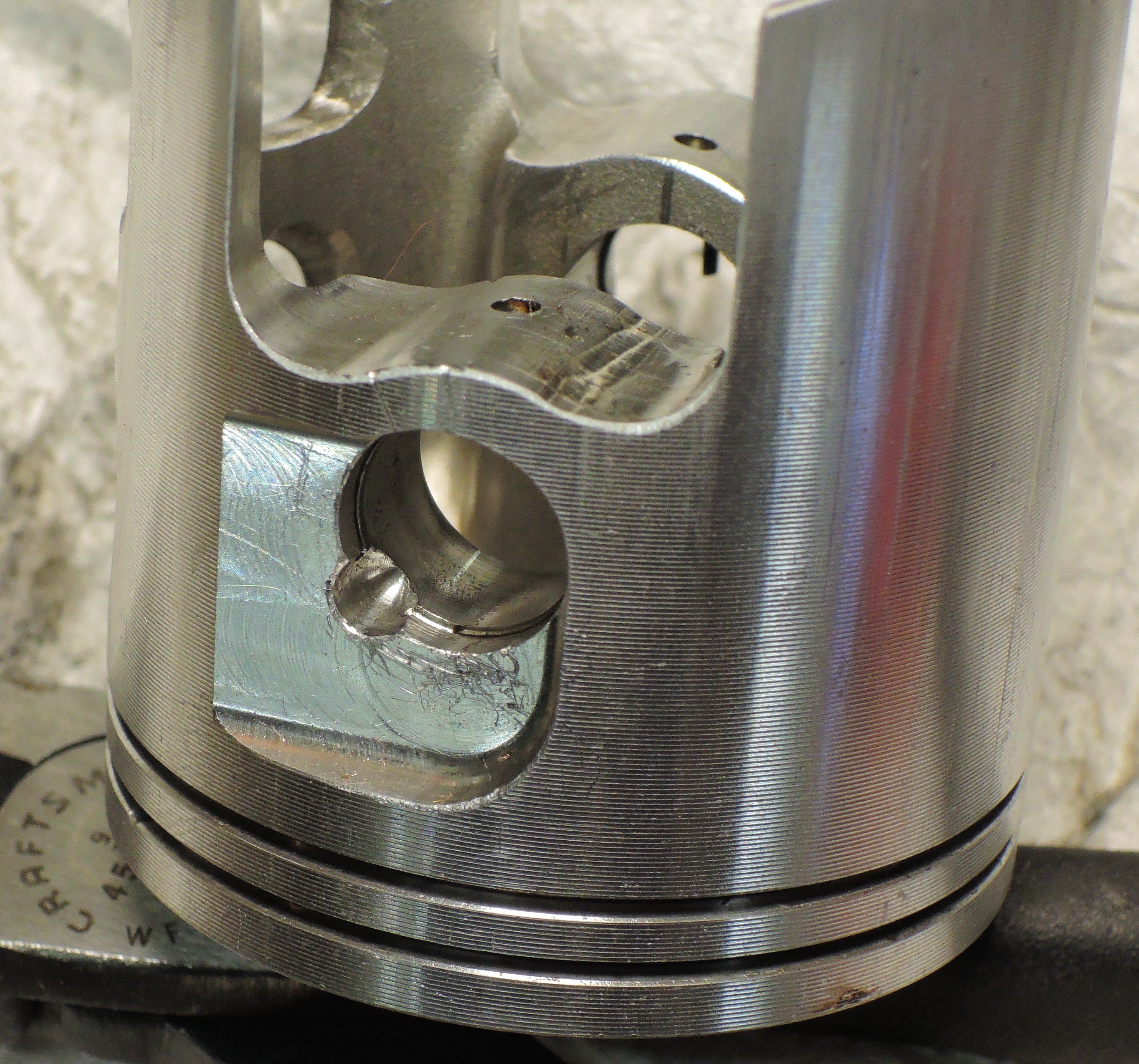

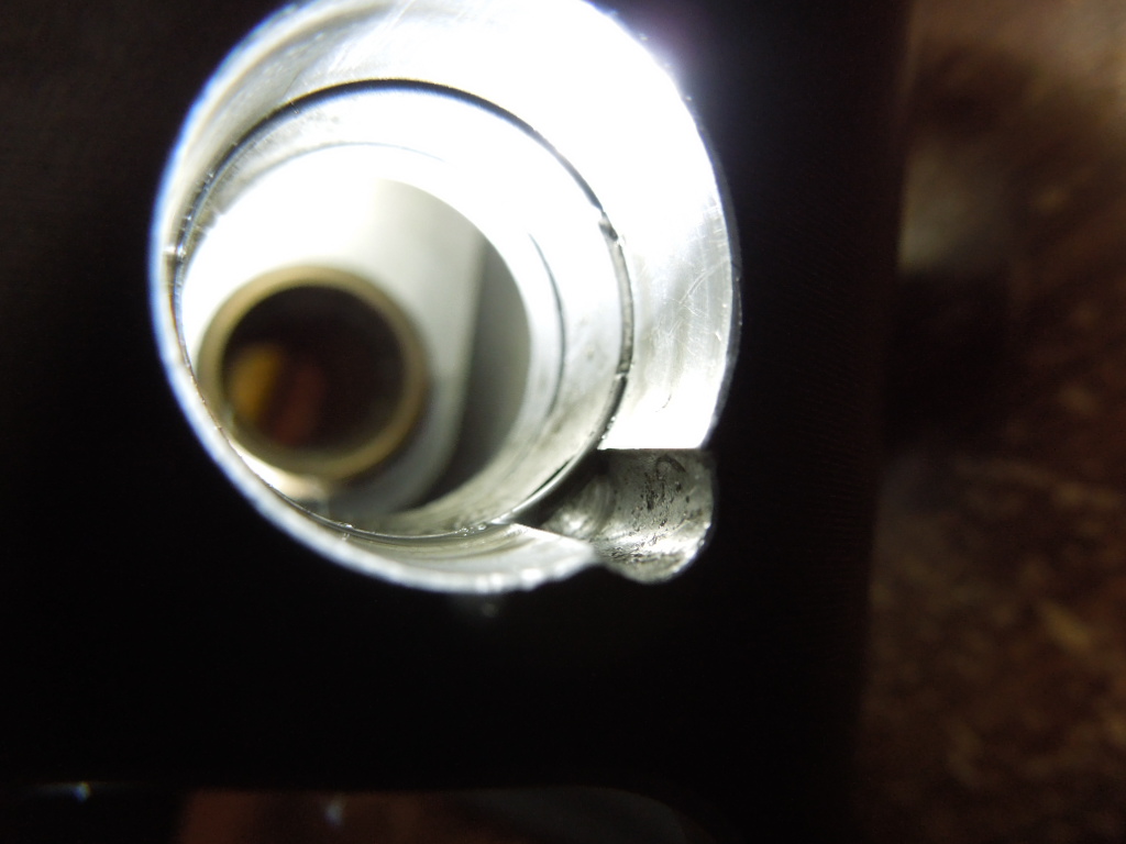

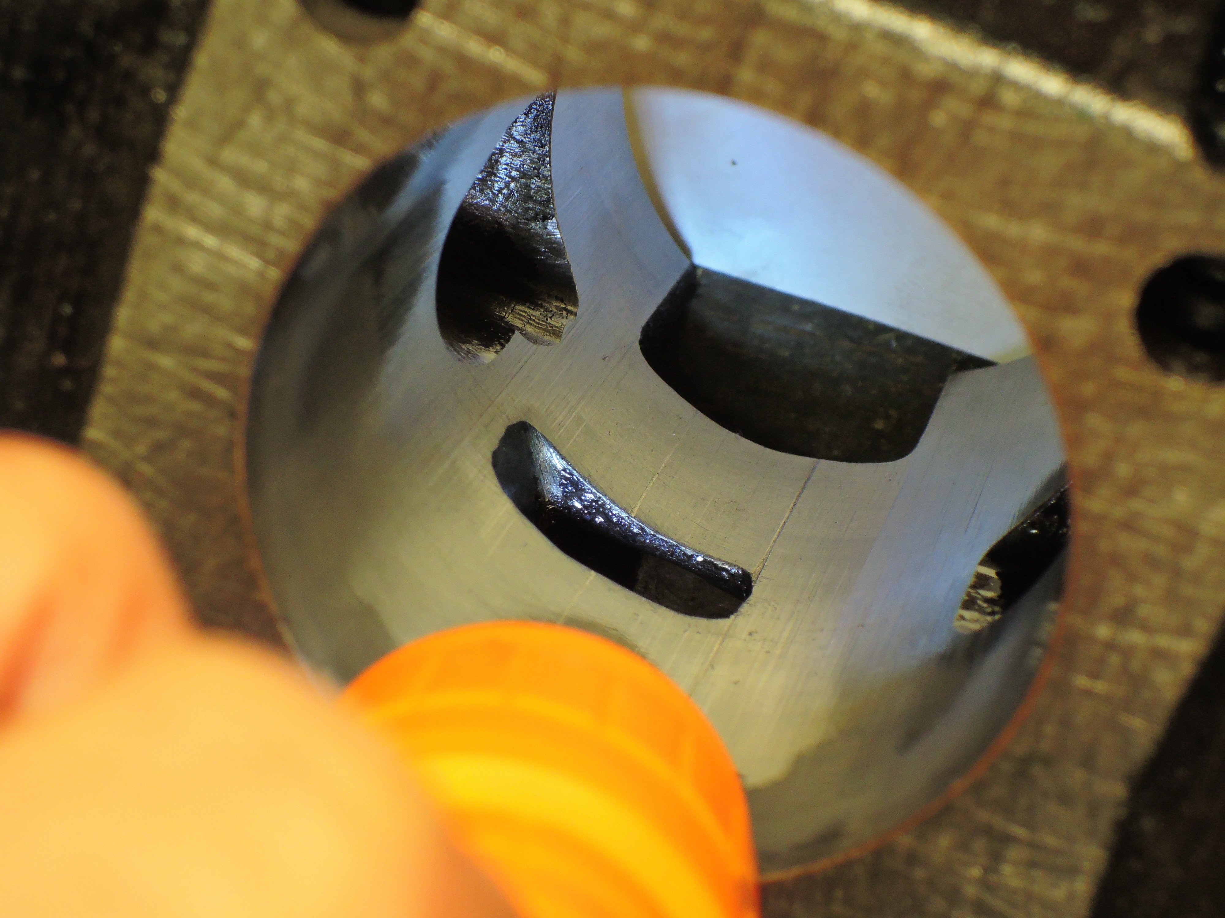

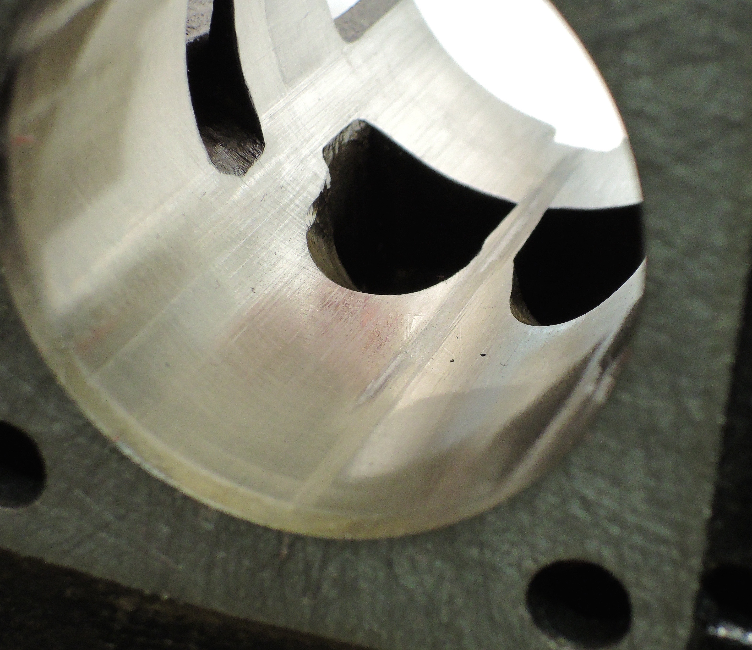

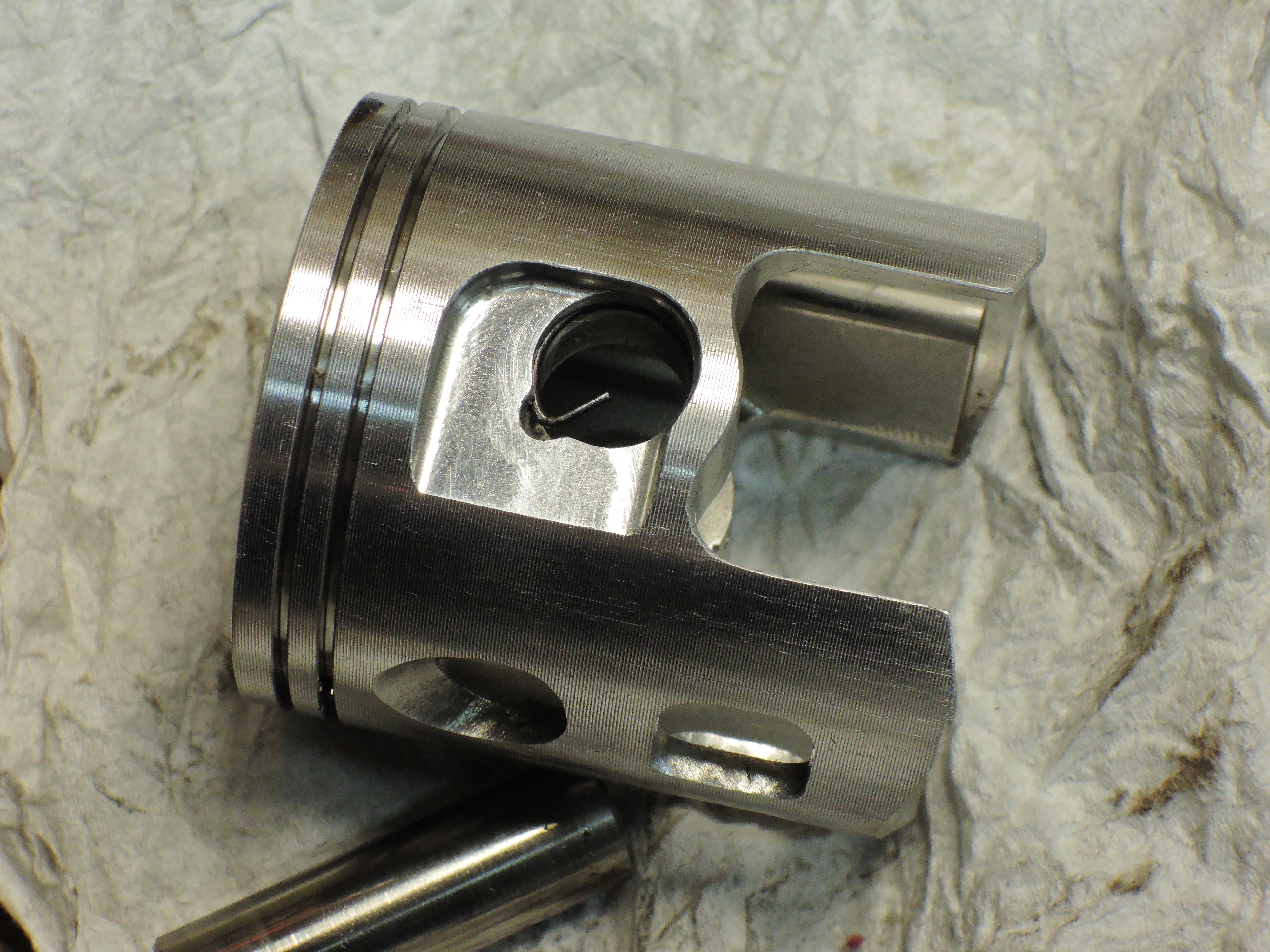

This gets even weirder. Piston skirt clearance is a snug .002". The pin clip was missing and the pin was starting to nibble on the transfer port. The question is, did it go flying while assembly and I thought it went in or did it leave out the exhaust port? Both scenarios seem unlikely. There are some dings inside the transfer port but they could have just tool marks while porting. The clip could have went in the transfer and been blown out on the down stroke and bounced out the exhaust. No marks on the piston neither scuffing or dings. I even put a light to the crankcase to see if it was hiding there and to check for damage--None. No major damage anywhere but how much clearance should the skirt have on it? .002 sounds a bit tight. I did find a stock clip that fit the piston.
Enough relief for the clip to go to transfer port?
Dings on bottom of transfer.
Pin scores in cylinder.

Snug .002 inch piston to bore clearance is to tight in my opinion. Especially with a cast iron cylinder. I prefer .0025 to .003 inch with the new Wiseco / Strictly Hodaka pistons.
I don't know if the orientation of the piston pin clip is in the same position it was when assembled. But, for me, I would not want either end of the clip close to the clip installation dimple, divot, slot...what ever it is called. Prefer to have the tab end of the clip at the bottom and the dimple completely bridged by the clip. Just should be less likely to exit the piston that way. Most of the time I will shorten the clip tab about 50 % to reduce the effects of inertia on the clip also.
Danny Cooke
Re: Day One - New Project
Hey thanks Danny, This is the position of the remaining clip, maybe that was the problem.

Ouch! A close look at both of the photos of the cylinder bore shows pretty heavy vertical wear marks both on the intake and exhaust sides. You've measured .002" clearance AFTER some quick rides and a whole lot of idling. It seems like it had to be about .000" to .0001" on assembly. I'm kind of worried that it may have to be bored to the next size, or that you'll be at .004" to .006" clearance after dressing out the visible gouges - of course it could run for a long time even with loose clearances. Bummer.
Hey Ed, The gouges aren't as bad as they appear and don't go all the way of the ring travel. They only appear to be a few percent as compared to say ring gap. I think all is well and I've increased the skirt clearance to a smooth .0025+ which should be better. I've also rotated the clip as Danny recommended. I was darn lucky the clip didn't snag on something as it left the engine. Back together soon!

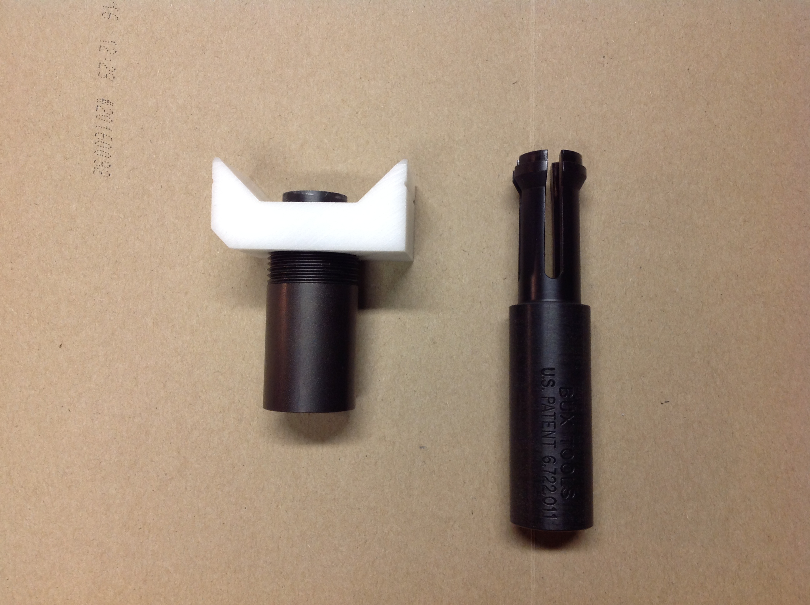

I had trouble with the Wiseco circlips on my 250. I bought this tool called the C-Clipper. Worked great.
Mike
BMW uses the tang-less wire clips. Dale's tool-less method is one that works, but can be tricky. The C-CLIPPER tool that MWL uses works very well. That little wire clip can be a PITA !!!

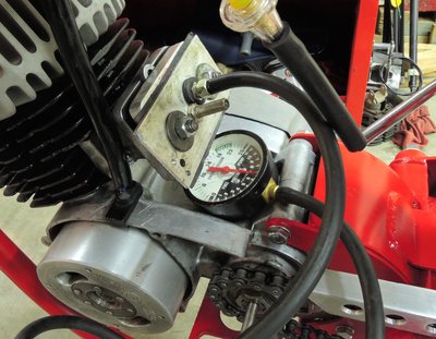

The Day One project is fighting me to the end. Today I decided the engine needs a pressure check and me without the equipment. I searched the shop and Hodaka shed and finally came up with enough stuff to at least rig one. A piece of aluminum plate was used to block the intake and I cut the valve stem from an old tube to use to charge the system with air. The exhaust was closed with a solid rubber disc in place of the exhaust gasket. I have an air brush and low volume regulator where you can set it at 6#s. I did have an old gauge and constructed a spigot from a cable TV connector. Most of the time was spent stopping all the leaks in my primitive device. :? Finally I did get it to hold enough air to squirt soapy water on everything. Wow, major head gasket leak. When resurfacing the cylinder top the grit was just a little too coarse and the gasket wasn't sealing. A touch up with a finer stone cured the problem and the engine finally passed the test. This was probably the cause of the jetting dilemma and I'll check it out with some test runs tomorrow hopefully!
For my recent top-end refurb I borrowed a commercial leak tester and adapted it to the Hodaka. I then fab'd my own pressure tester. An intake blockoff plate contains a tire valve for pressurizing the engine with a tire hand pump, with a hose nipple and hose to an old 0-50psi fuel pressure gauge. Exhaust is blocked off with an expandable rubber plug for auto engine freeze plugs (Dorman), though a rubber stopper jammed into the exh port woud work. I concluded that a leak tester is a gopd routine service tool for 2-stroke maintenance.

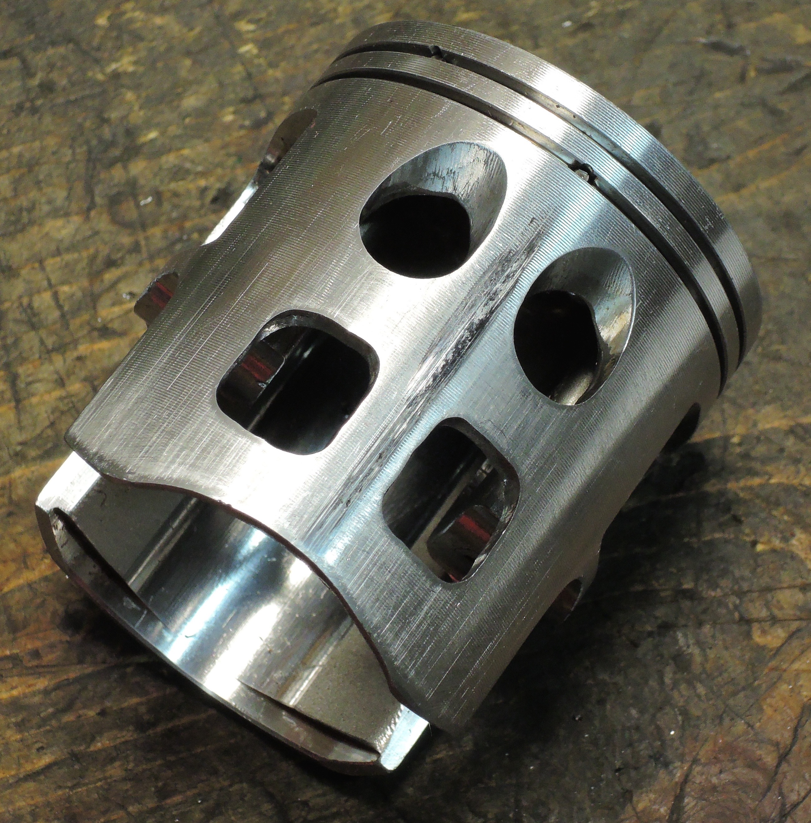

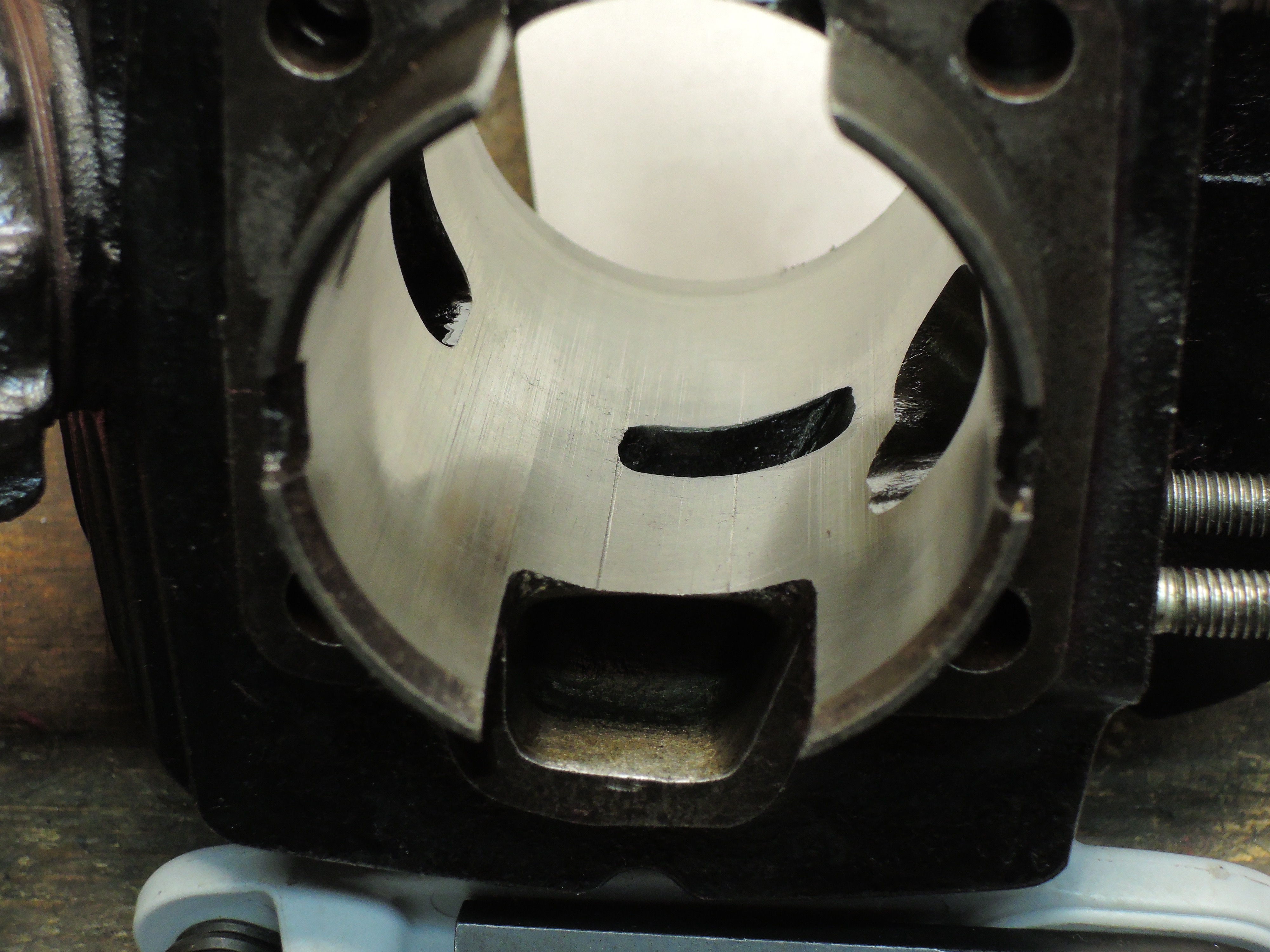

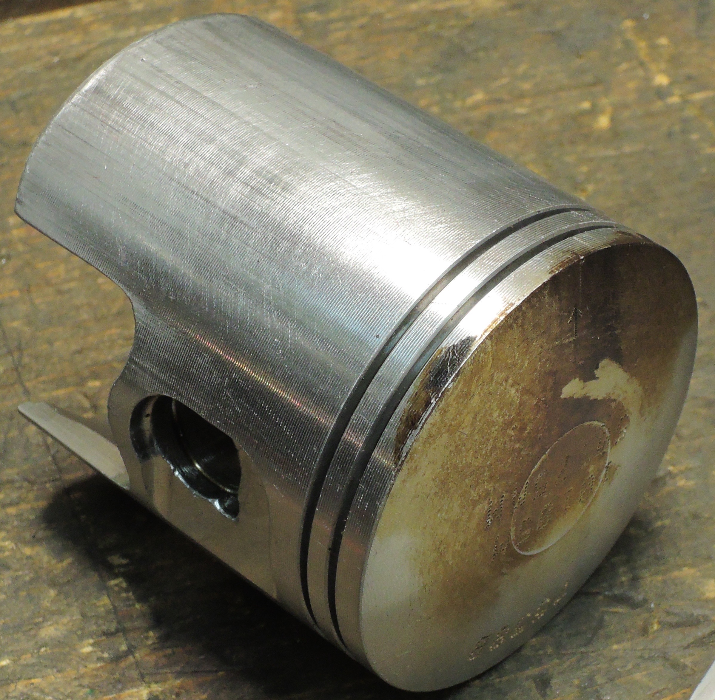

The mystery continues on the Day One Project. Perhaps it is the long header pipe creating some major leanness between idle and 1/2 throttle. The cylinder seems to have the proper clearances but eventually begins to seize at about 1/3 throttle. Strangely it has a good mid range hit with lots of smoke . Yesterday I pressure checked the engine and found a severe head gasket leak and remedied that. I was sure that was the problem but in testing even with two different carbs the problem persists. Meanwhile it appears that it has ejected the piston pin clip yet again or at least it started a strange vibration. Max wasn't in the mood to spend yet another day to check and see what happened. For the moment the plan is to take it to a car/motorcycle show this weekend running or not. Grrrr. :?
Her's some pix of the last fiasco. About 30 minutes running time. Strange deposits on the piston near the exhaust like burnt oil, hard to remove.
Burnt deposits on exhaust side.
Cylinder seizure tracks
Piston seizure.
Piston seizure.

Yes, 2-strokes can be quirky. This is why I am getting instrumentation like an EGT meter. This way you have something physical to look at besides a seized piston. You can guess that it seems that this is happening because that may be present, but good readings narrow things down. In addition to EGT, there are also AFR (air-fuel ratio) gauges available.
