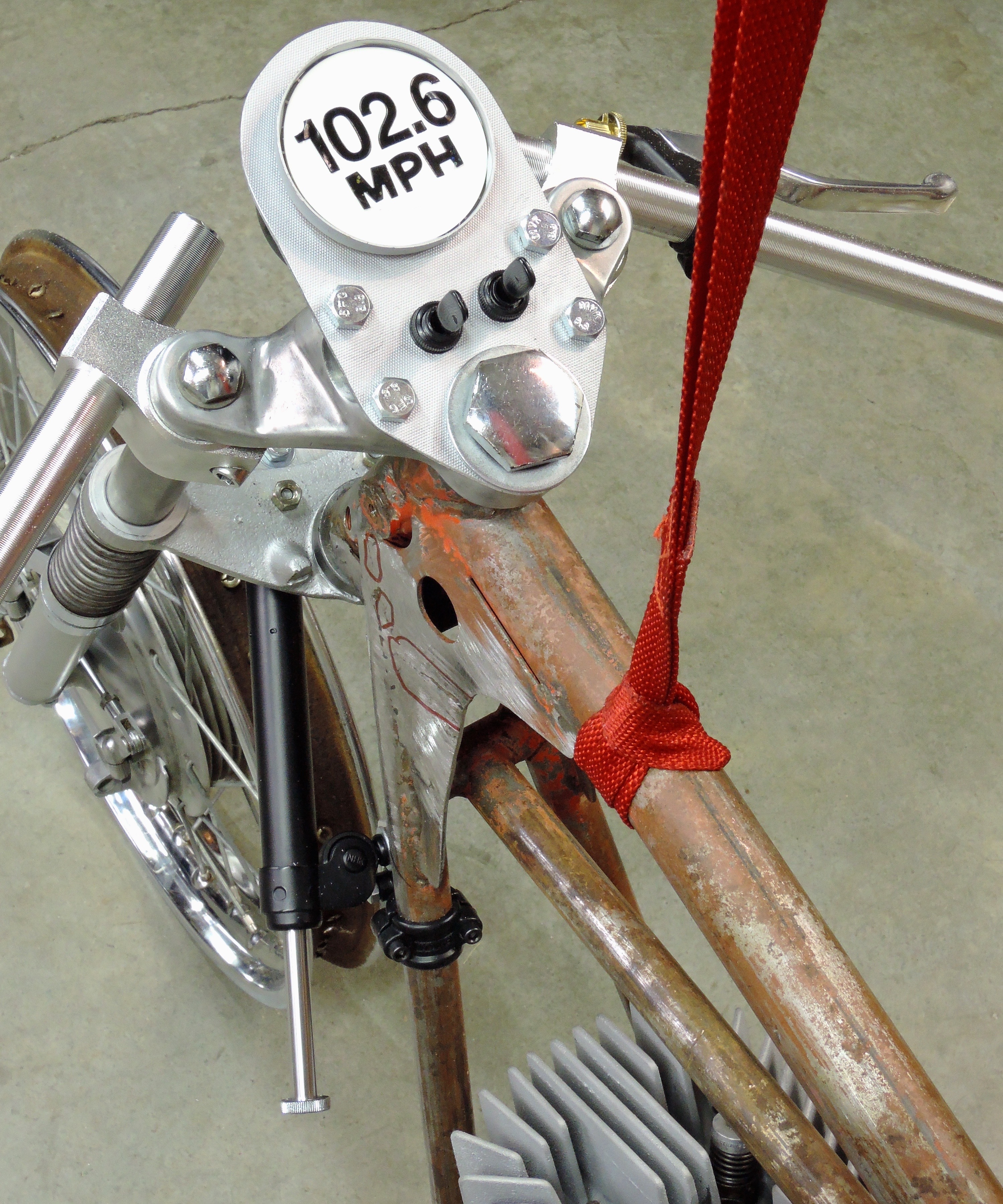

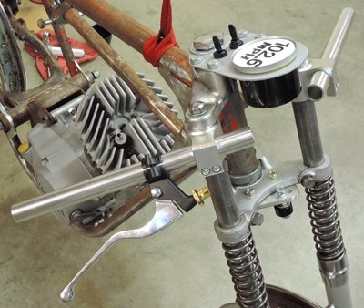

Here's a mock-up for the recording GPS speedometer if I ever get to that point. I've been studying GPS speedometers/tachometers and several have a 60mm gauge hole and about the same depth. I'm not ready at this point to purchase this expensive unit but let's consider one. I was thinking a bend in the plate at first but the viewing is in your face in riding position. I put some fake digital numbers on the face to remind what this project is about and to make you laugh hopefully.
The bolts need to have a little more class, maybe some Allen heads. Hmm, it doesn't look too bad for a piece of floor tile and a rattle can top.
Hey, unlikely that this will all come to be but one needs a path to follow on projects! We'll see.

It is not too early to be evaluating instrument placement. It looks do-able, with room for tweaking.

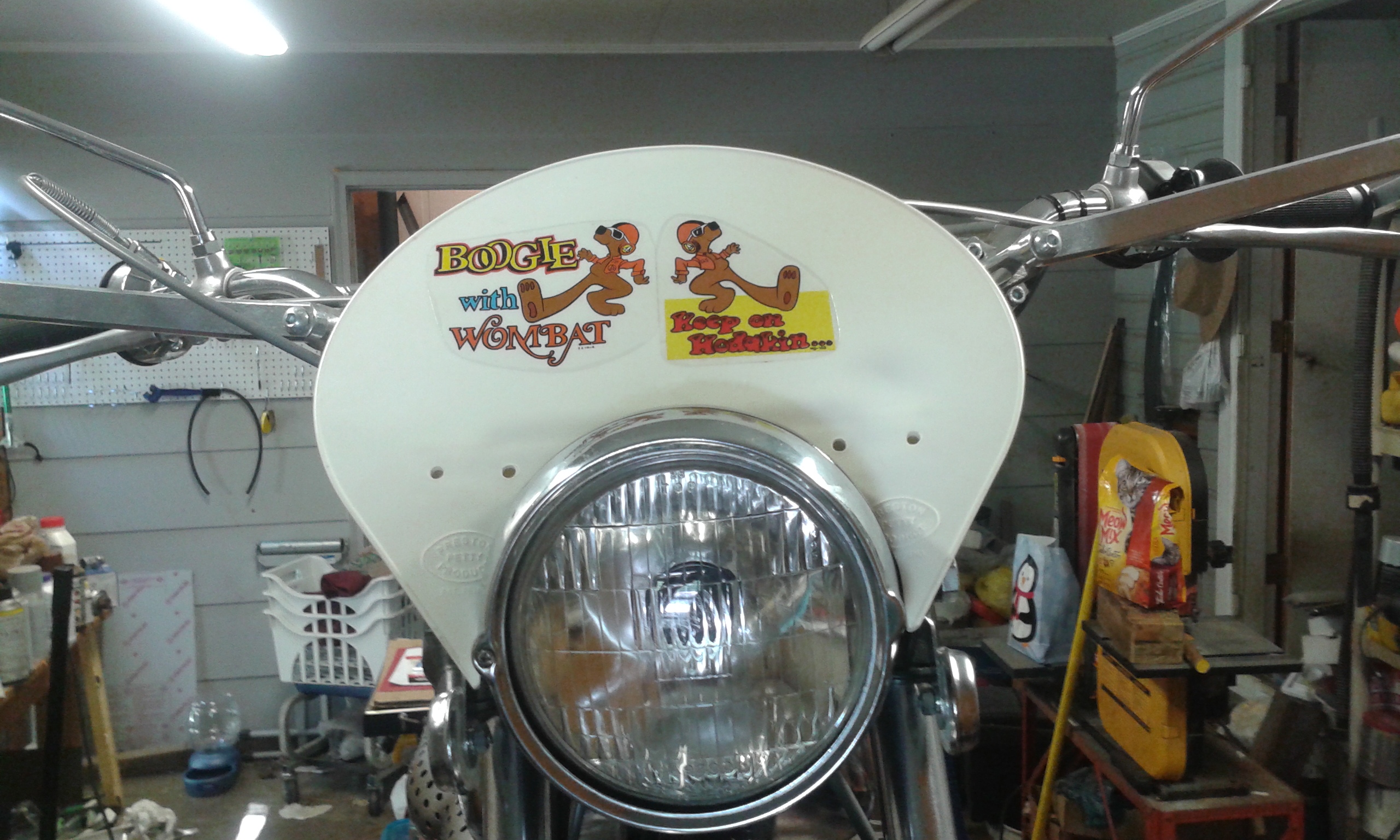

On the Wombat I fitted a Preston Petty front number plate around the stock headlight with intention of it working as a wind deflector to keep the wind blast out of my eyes. Not quite tall enough, but you get the idea.

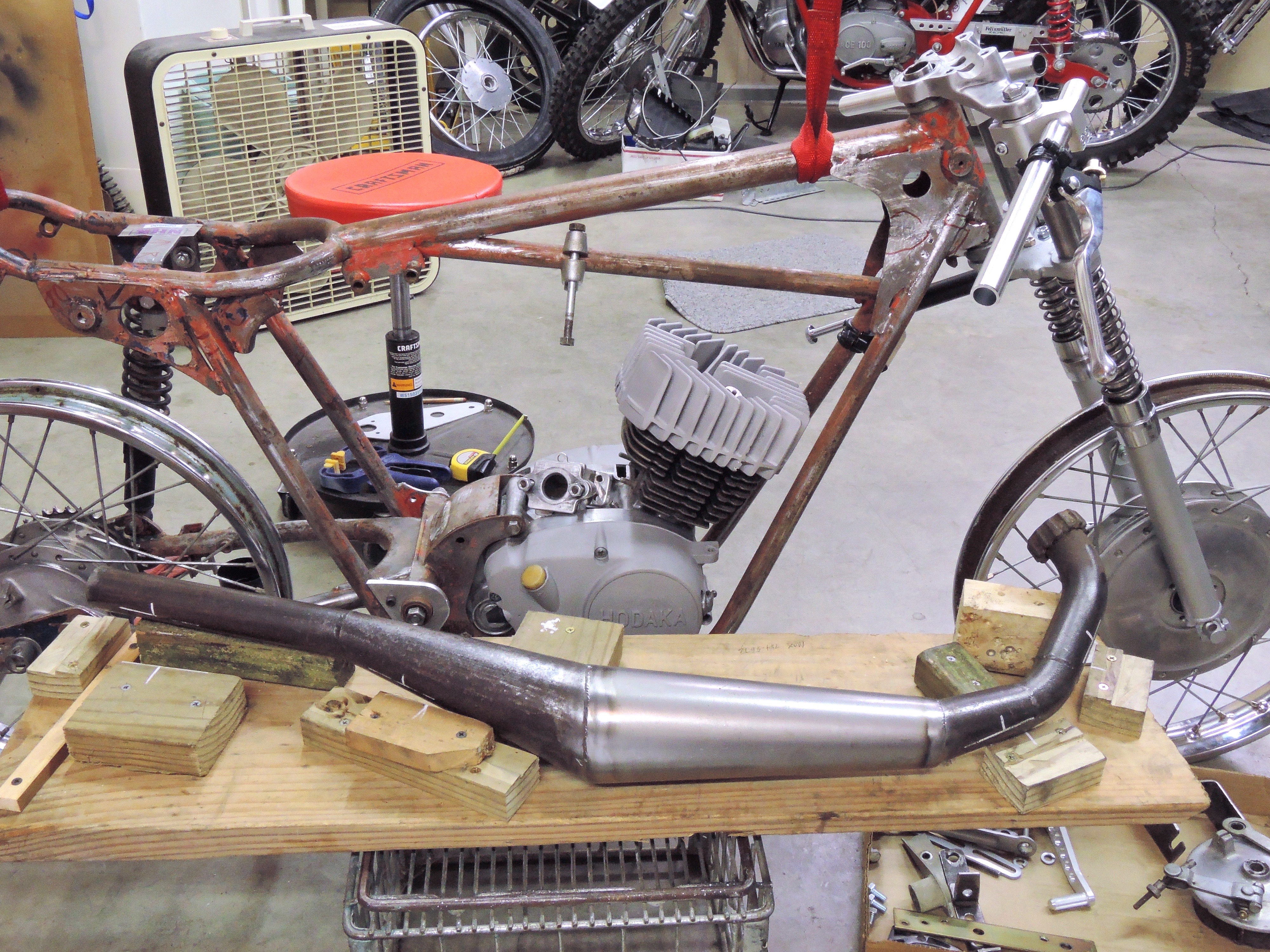

Yay! Back to the real world of motorcycle restoration. Yesterday, Eweleen, my wife and designated driver transported me to to Rod's Hot Rod Shop to check on exhaust modifications on the project. I had my head out the window all the way there as the family dog used to do with tongue flapping in the wind. All went well in the pipe surgery and even Rod was enthused. I think he really likes the challenge of fab work on custom devices.
Re: The 2 the Max Project
Pipe looks great! Which cone ended up on it?
Thanks Victor. He used the 1/4'' bigger cone because some of the original seams were rough and he could cut more of the old weld out. He did have to trim the full length seam for his extra overlap. It certainly looks much better! He's the Doctor I tell him.
