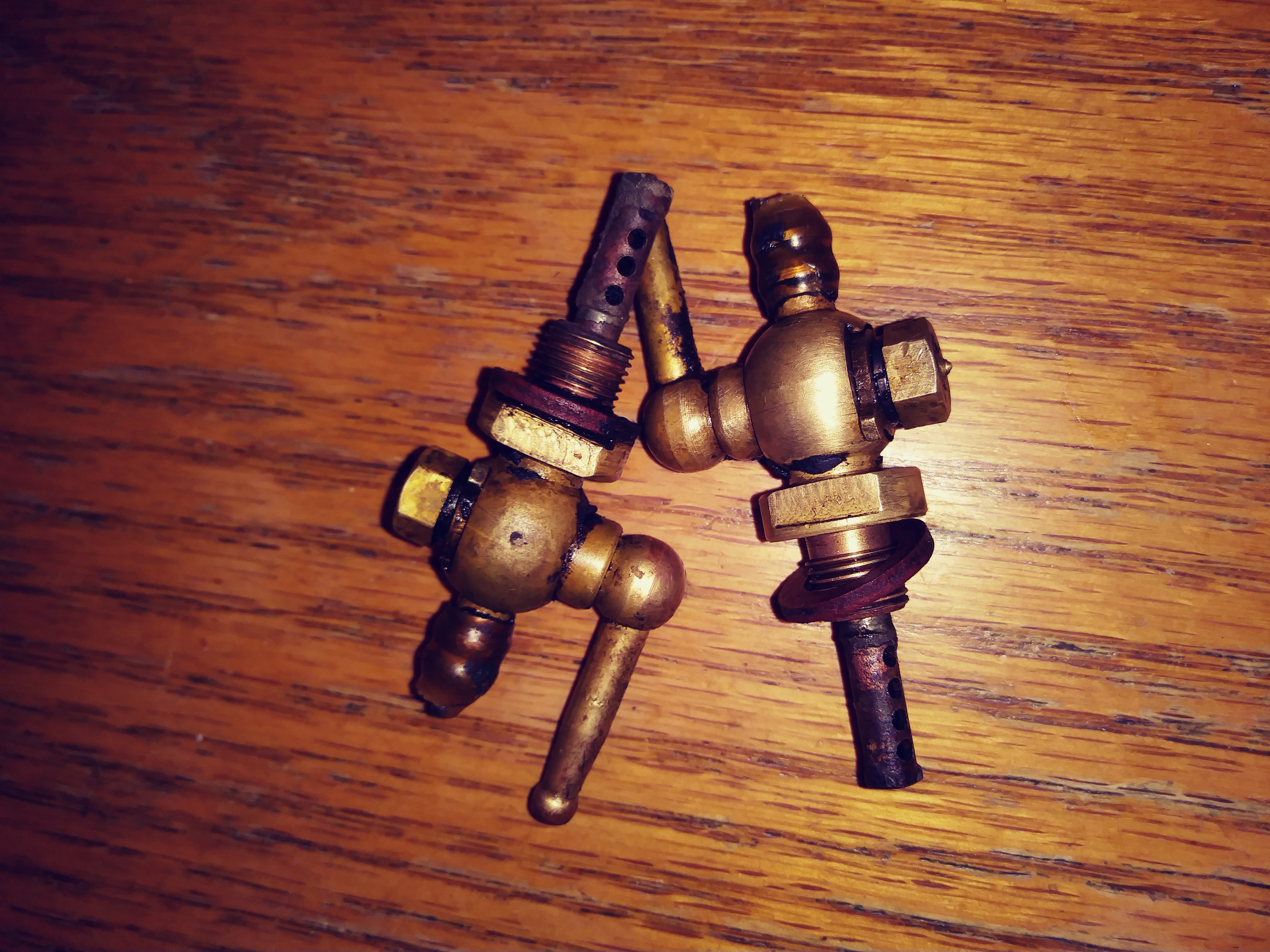

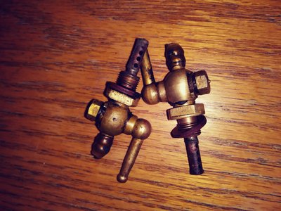

Workshop manual is on the way and carb is coming soon. Took a look at the better of two fuel tanks I have and started cleaning tonight. What's the best product/procedure to get rust out?
Checked old posts about these brass petcocks. It seems maybe they have a tendency to leak ... Is it possible/safe to use them? How best to clean them? They're so cool and vintage-y. I want to use them if it's safe. What do you think?
Re: new owner, need advice
They are cool for sure, but for ease, dependability, and rebuildability, the new pot metal petcocks are good. I've lapped the brass petcocks which improved but did not eliminate the fuel seepage. For rust removal, depending on how bad it is, it can be as simple as throwing in a handful of nuts or drywall screws and shaking the tank for 10 or 20 minutes, removing the hardware and flushing the tank. I've also used Evaporust with good results. There are a lot of folks who prefer electrolysis and an equal number of descriptions covering the technique for you to consider. I've not tried it, but you may well have the materials to do it in your possession right now and it is by report easy and very inexpensive. Now is a good time to mention the advisability of ALWAYS using an in-line fuel filter between the "Y" connector and carb.
The brass can be lapped and might be made to be leakproof. No guarantees. I'd save the brass ones for "vintage use" and get the new potmetal ones for daily use. I'm saving the brass ones for use with my pristine show tank.

I will definitely keep themBill2001 wrote:The brass can be lapped and might be made to be leakproof. No guarantees. I'd save the brass ones for "vintage use" and get the new potmetal ones for daily use. I'm saving the brass ones for use with my pristine show tank.
I would suggest that the proper choice of words would be something like, "Lapping can sometimes return the brass petcocks to leak free operation."
Can you tell me what part of it needs to be lapped? Pics would probably help!
I don't have the means right now at my disposal to provide any photos (actually, I'm diddling around when in reality I should be working
). First, disassemble the petcock by removing the small nut opposite the "handle" or "lever" that starts/stops the flow of fuel. That will allow you to remove the handle/valve assembly from the housing (the part that screws into the tank. The actual valve is a truncated cone which fits into the housing. The cone and bore need to be lapped together. Cover the cone-shaped part with the lapping compound, reinsert it into the housing, and start-a twirlin'. Needless to say, make sure all lapping compound is removed prior to reinstallation.
Perfect explanation. Thank you, Matt

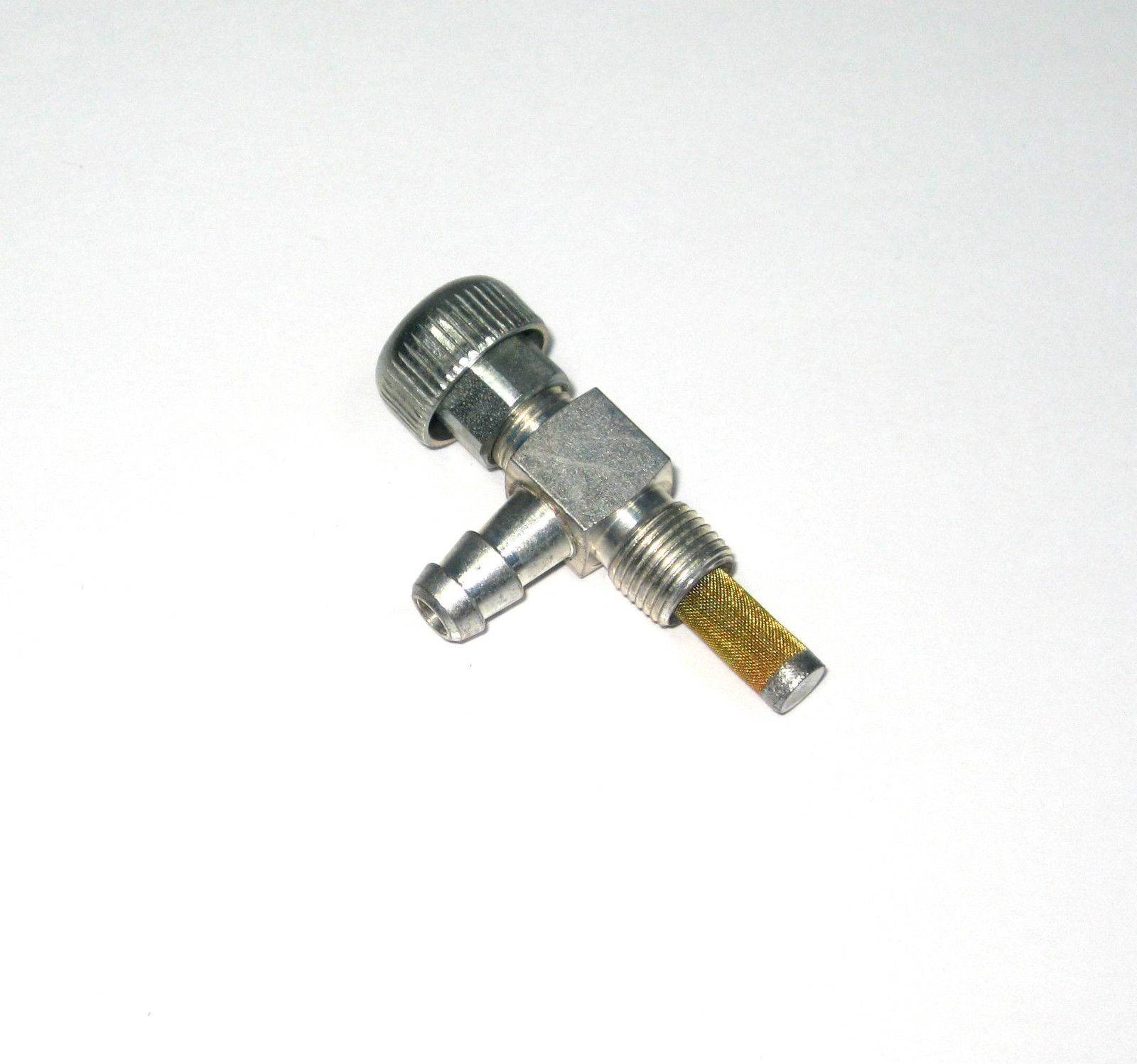

another petcock option which is both vintage appearing, and actually seals nicely are the RUPP mini bike ones available from Ebay and other sellers. They do require you to run a taper pipe tap into the tank hose, as the stock ones are a straight 1/8 pipe thread. Plus you get a full set for under $25 shipped to your door! We are running these on all of chrome tanks right now.
https://www.ebay.com/itm/Vintage-MiniBi ... 236d78e83f
And here is what it looks like installed:
Those look good, makotosun. I'm not sure what you mean by a taper pipe tap, but I can probably figure it out. I am going to try to clean up these brass ones and see how they well they seal when I clean the rust out of the tank.
There are two kinds of pipe thread, straight and tapered (NPS and NPT respectively.) Most common pipe threads are tapered (NPT), so the farther a piece is turned into place, the fatter the insert gets and the tighter the threads get, helping to form a seal. Straight and tapered threads of the same pitch, such as 1/8", are not interchangeable, although sometimes it appears one will thread into the other. That appearance is misleading. Mixing styles almost always leads to leaks and pressure failures.
So if your tank is tapped for 1/8" straight thread, running an NPT tap into the hole will sort of realign things and allow the NPT style fuel shut off to screw into the old tank and make a seal around the threads. I would still use Teflon or pipe dope, or both, on the threads if you do this. (Teflon tape techically isn't intended as a sealant, but rather a lubricant to allow NPT threads to fully seat. Some plumbers use both dope and tape thinking you get the best of both worlds. Personally, I think dope serves both purposes, whereas Teflon tape sometimes does not, but the choice is up to you.)

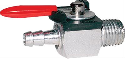

I did use a bit of teflon tape on the threads and after about 6 months, have not had any leakage from the threads or from the petcocks.
The tanks are originally the straight thread version. The NPT tap is very commonly available at any plumbing shop or big box Home Improvement store. It was also included in a cheap Harbor Freight tap set I had laying around.
I could never get the brass ones to stop seeping, even with new ones, so was looking for a good rider replacement. There is another type that will also work after using the tap which I saw in use on a nice Combat at Hodaka days last year. They are available online and look a bit more modern. I have seen this both straight through as in the picture, and with a 90 degree angle.
https://www.summitracing.com/parts/mnp- ... A-EALw_wcB
It is not clear from that ad that this is the 1/8" size, but they are available - just check the size before you buy!
