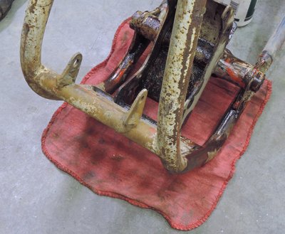

These near free buys do have their downsides. Just one more shot to to show what we're up against. Swing arm bracing? More grinding. Luckily it only is braced on the chain side for some reason. Not complaining but I would I would have went for two braces or none. None actually. :shock: "Hell for stout" Dad used to say.
Left turn racing brace

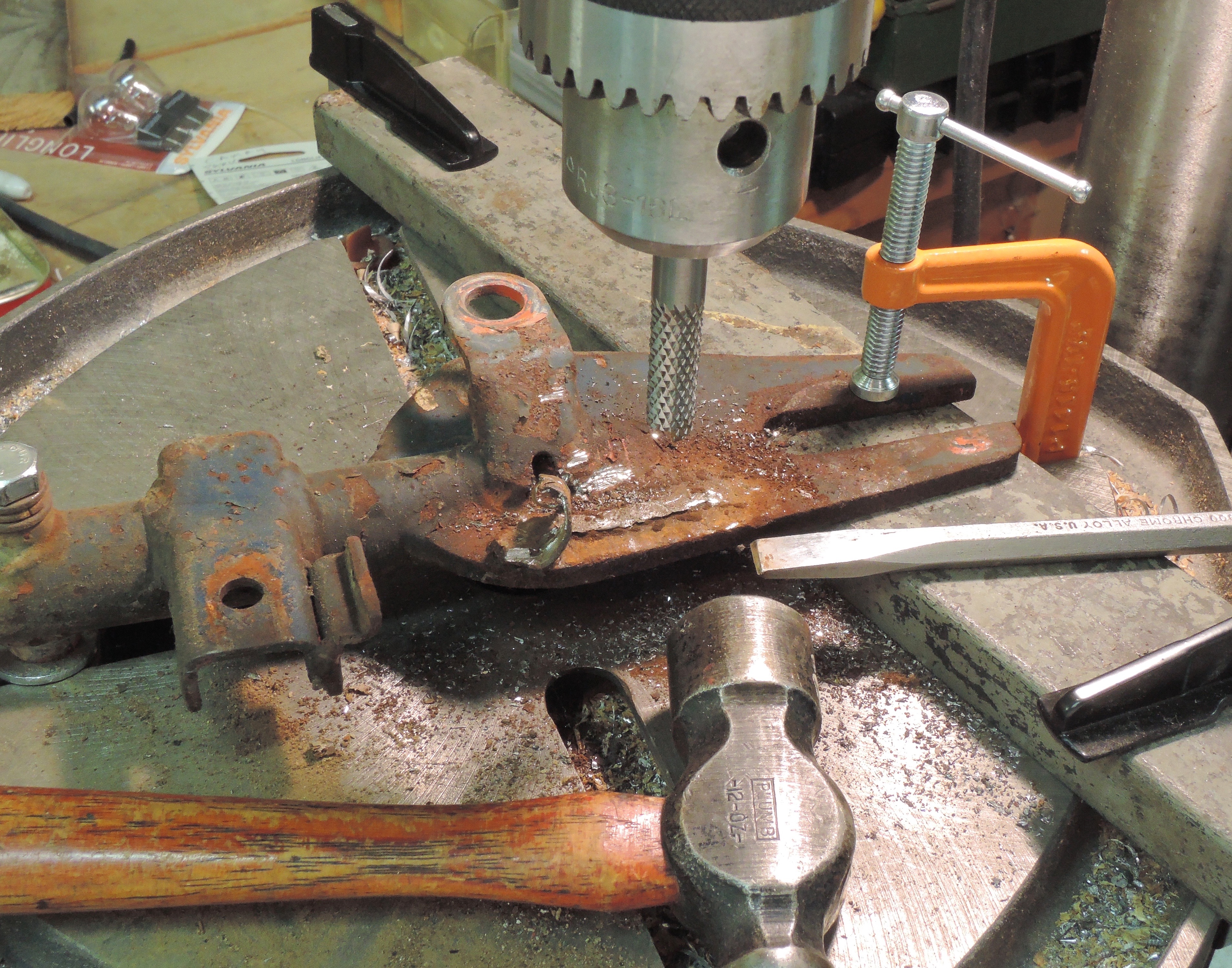

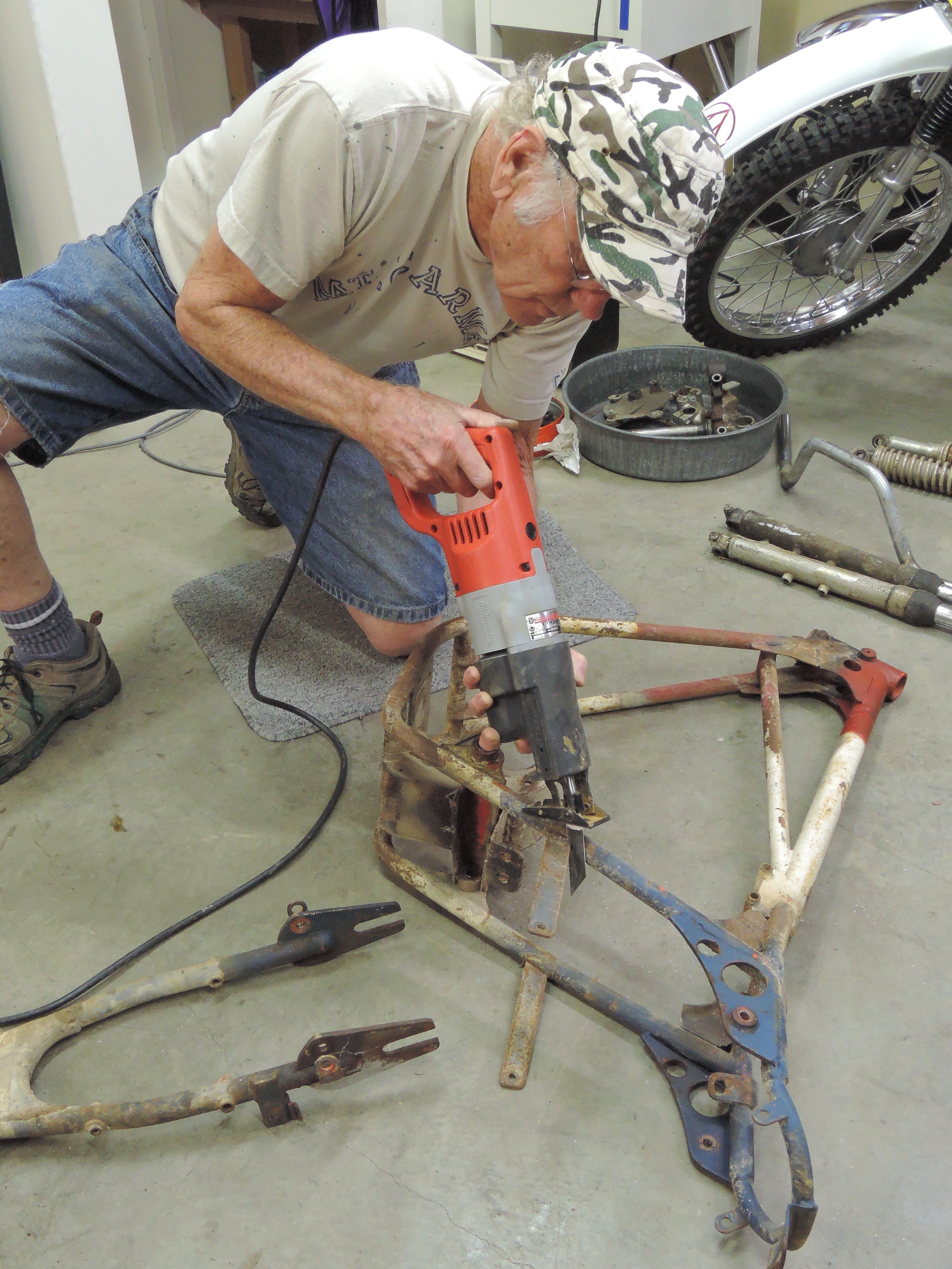

Time to lose some ugly pounds. Not too exciting but it does show I'm doing something. I tried to mill the plate off but the welds were plenty hard but no match for the die grinder. I won't need these weld-on # plate brackets nor the heavy steel seat. I feel lighter already. Another method to lose total weight is to take weight off the rider. I'll work on that later.
Mill attempt
Mill attempt
Done
Done
Removing welded on stuff

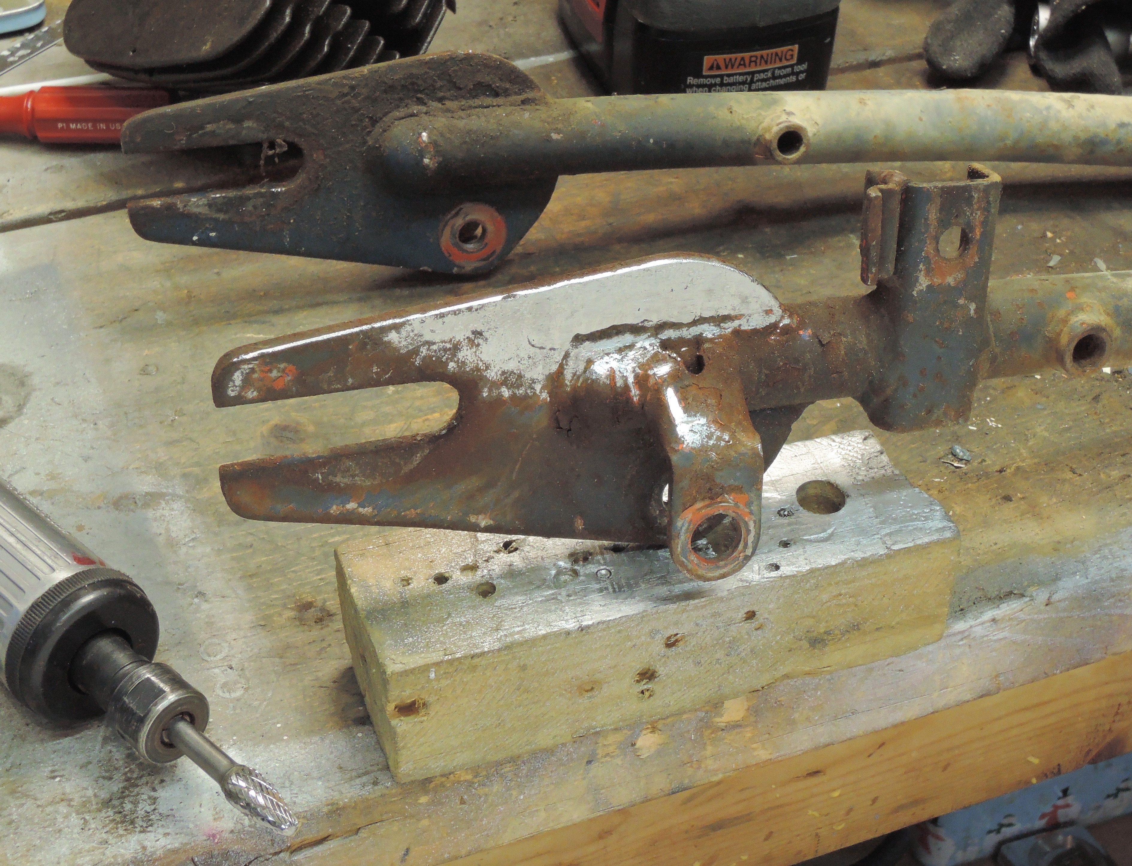

matt glascock wrote:Yikes Maxie, that looks like the front end of my first Super Rat. Hey, sometimes a guy's gotta put another guy into the wall - right? :-). Can you tell if the steering head rake is stock? It looks like there is a small fracture on either side of the steering head just above the original tank mounting bosses about where the gussets attach. No biggie. That weld job can be ground off and rewelded. Here's hoping the metal underneath is solid. If anyone can solve this conundrum, its you Maxie.
Hey Matt. The good news is that these welds don't seem to be filling fractures. The fork head appears to be straight. They seem to be attempts to re-enforce places. The bad news is there are other places with big globs of weld also like the motor mounts shown. Lotsa cosmetic un-doing to do. :? Just part of the project.
globular welding braces.

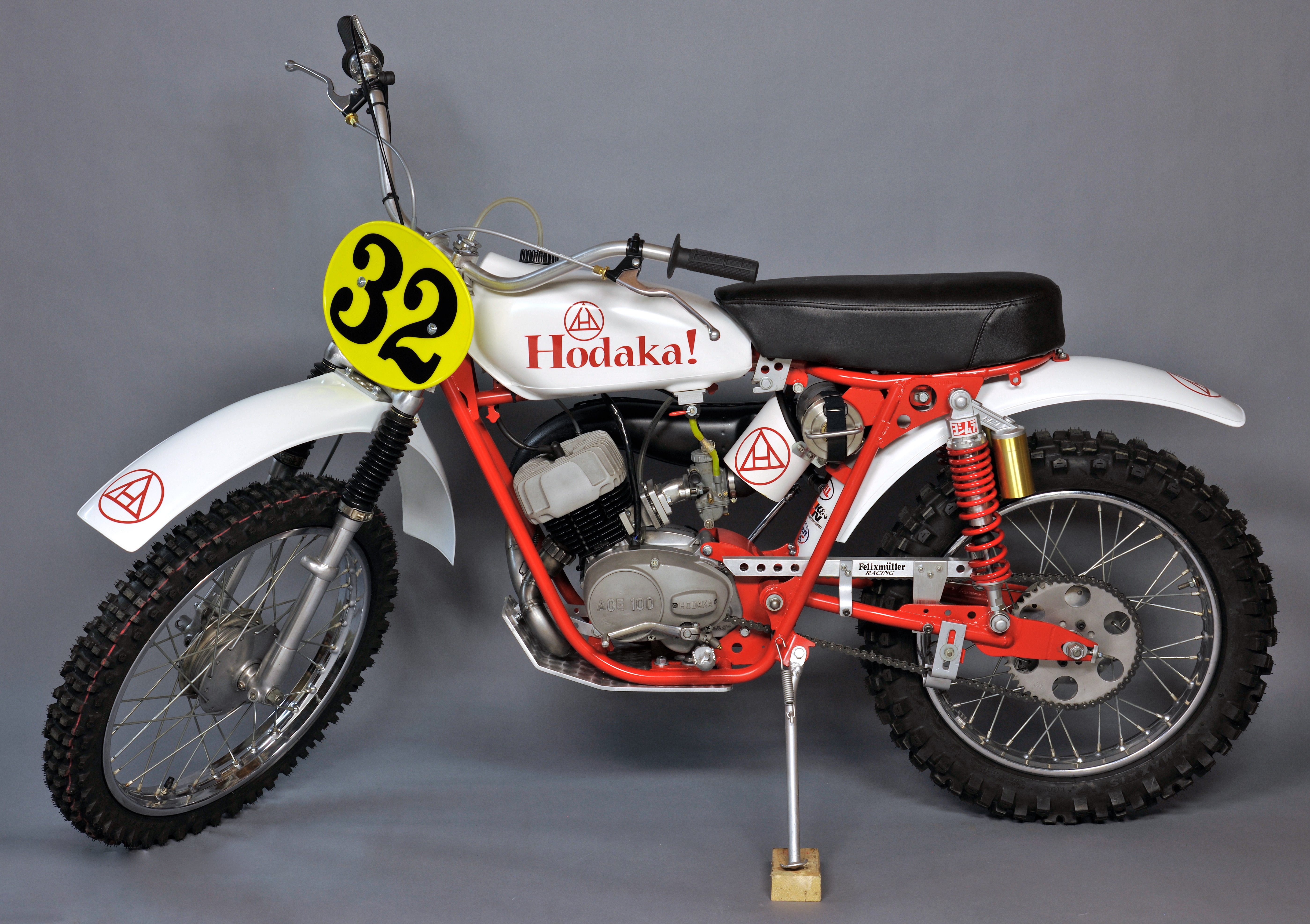

As for the white bike if you hadn't seen it was over a year project on the Forum. It was documented from day one hence the name The Day One Project. Big fun! One of those small fortune things but rewarding. Here's a shot of it.
Later,
The Day One Project

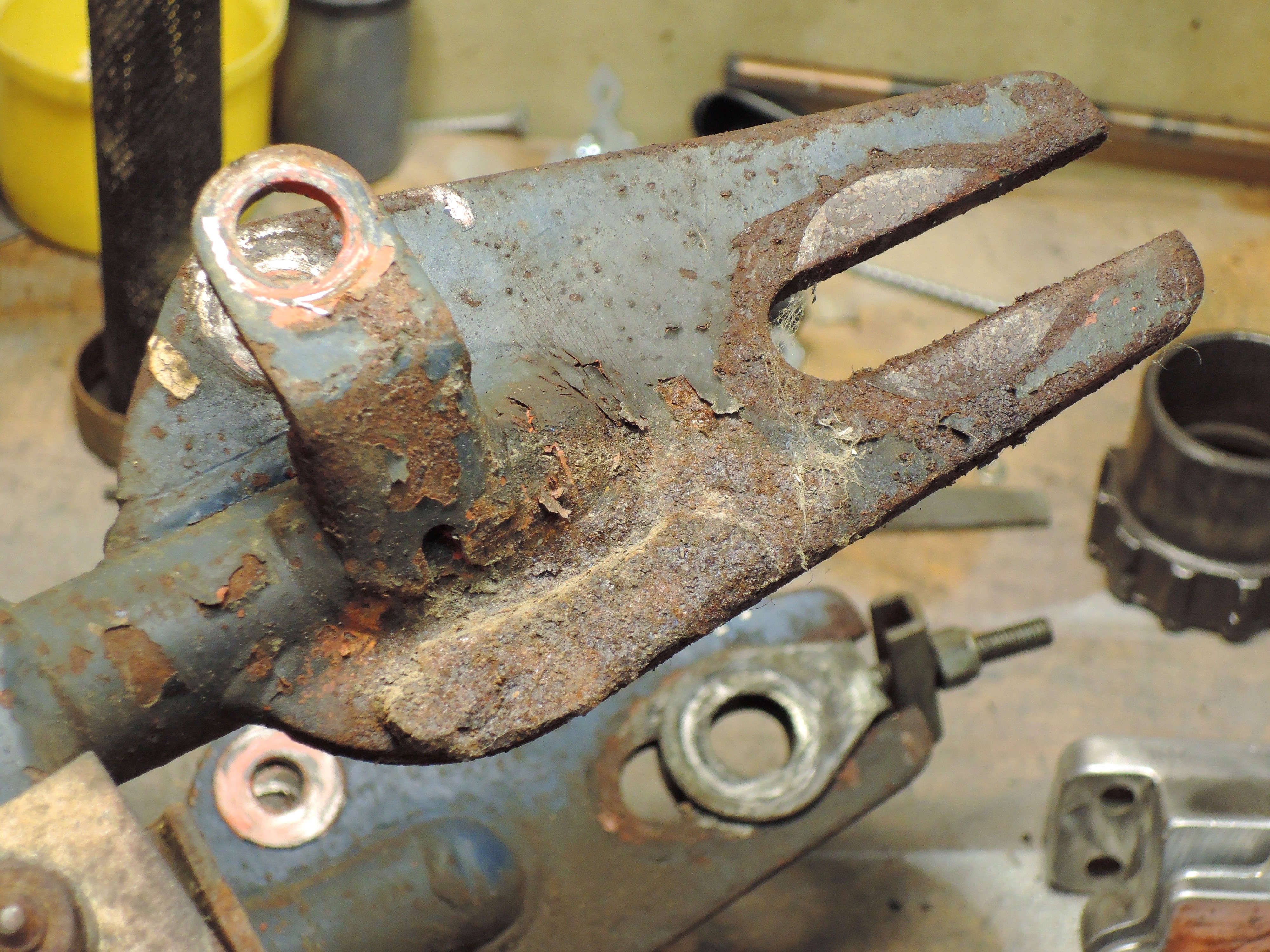

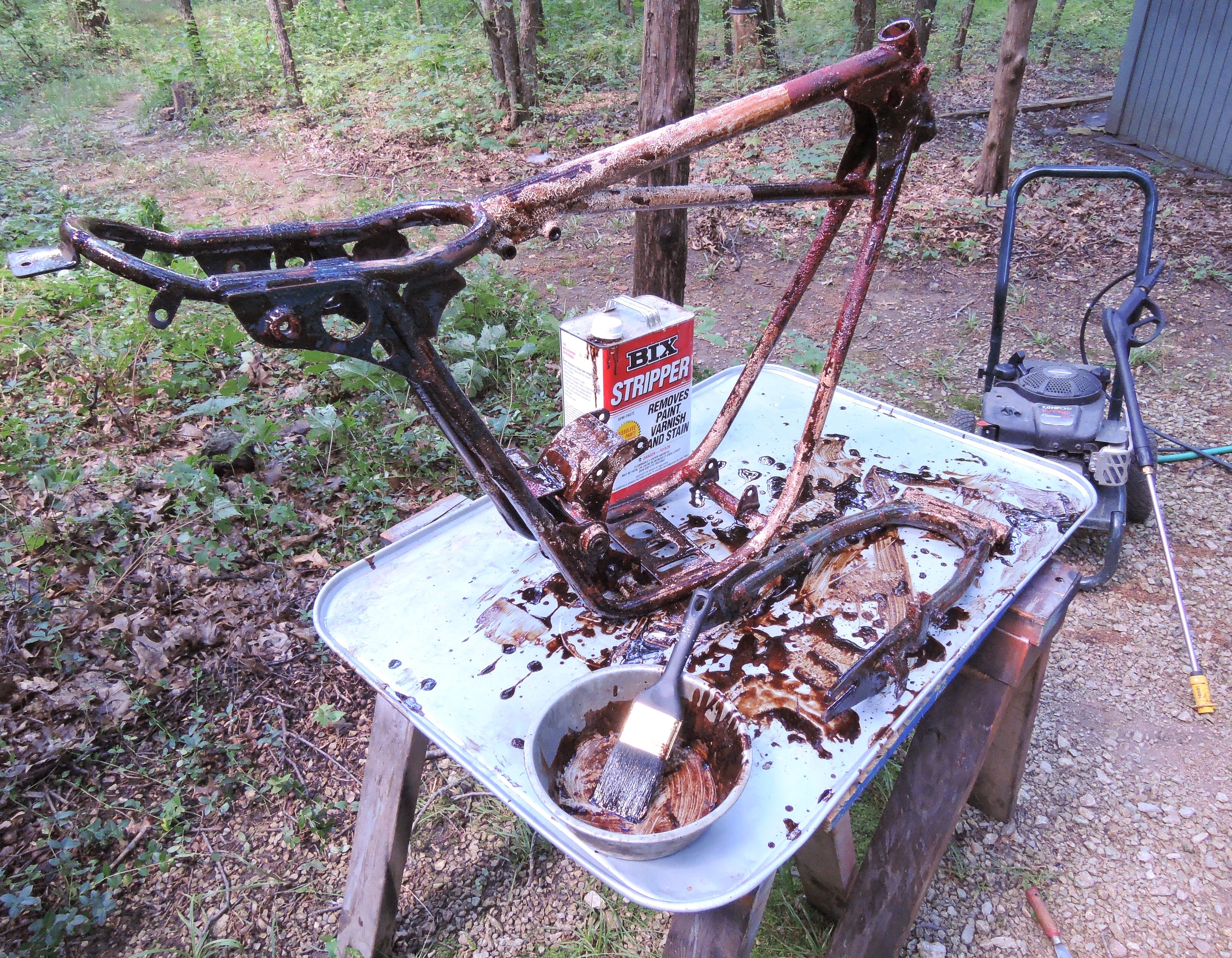

A gross report. Real work, not just talk is going on as we speak. Frame scraped, scrubbed with solvent, power washed, dried, stripper applied and that's where I am now, waiting for it to soak. It will eventually be blasted but it will be semi-clean for grinding and shop work. OK, back after it with the power washer. Reporting live,
Yuk, the bad part of restoration.

A good stripper sure does make life easier! Pretty soon you'll be dancing around that pole....errr frame!!! :mrgreen: Victor
