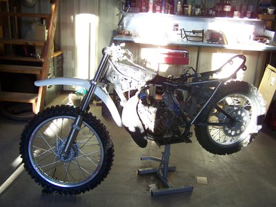

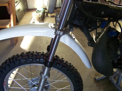

Finally made a front fender mount . The HT pipe cause the fender to be forward mounted a bit. Next step I'm going to weld up a 250SL chain tensioner to the swing arm that also functions as a chain guide. I cant use the Yamaha chain guide since it now has a larger 520 chain and that makes the sprocket larger with the same tooth count .

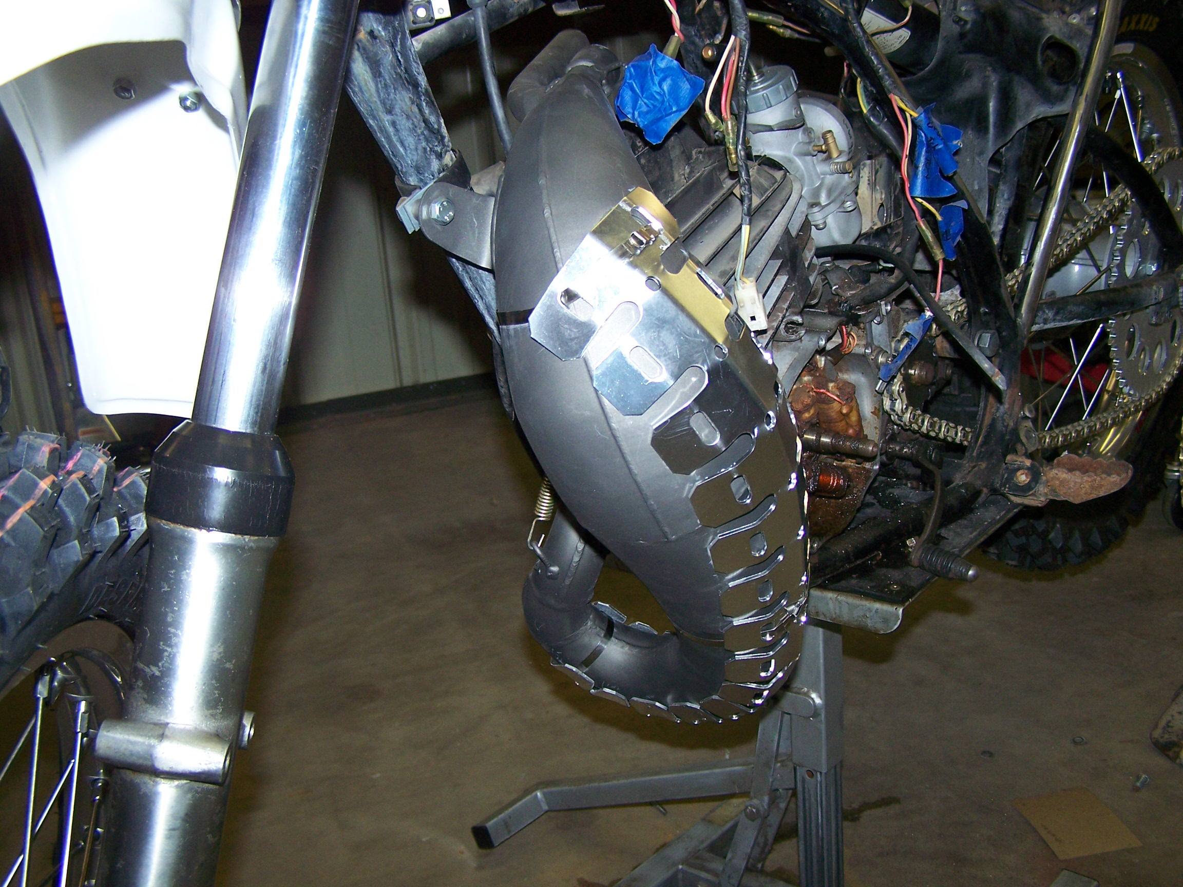

Well Now I have the pipe guard on to protect the expensive Ht pipe cost of pipe and ceramic coating over $500 don't want to smash it.

Re: Yamadaka project
Rich. What did you make the shield out of? It almost looks like stainless steel! ; D Victor
racerclam
Posts: 588
Post by racerclam »
I didn't make it , but its aluminum and from FMF
That looks sweet! ; D Victor
