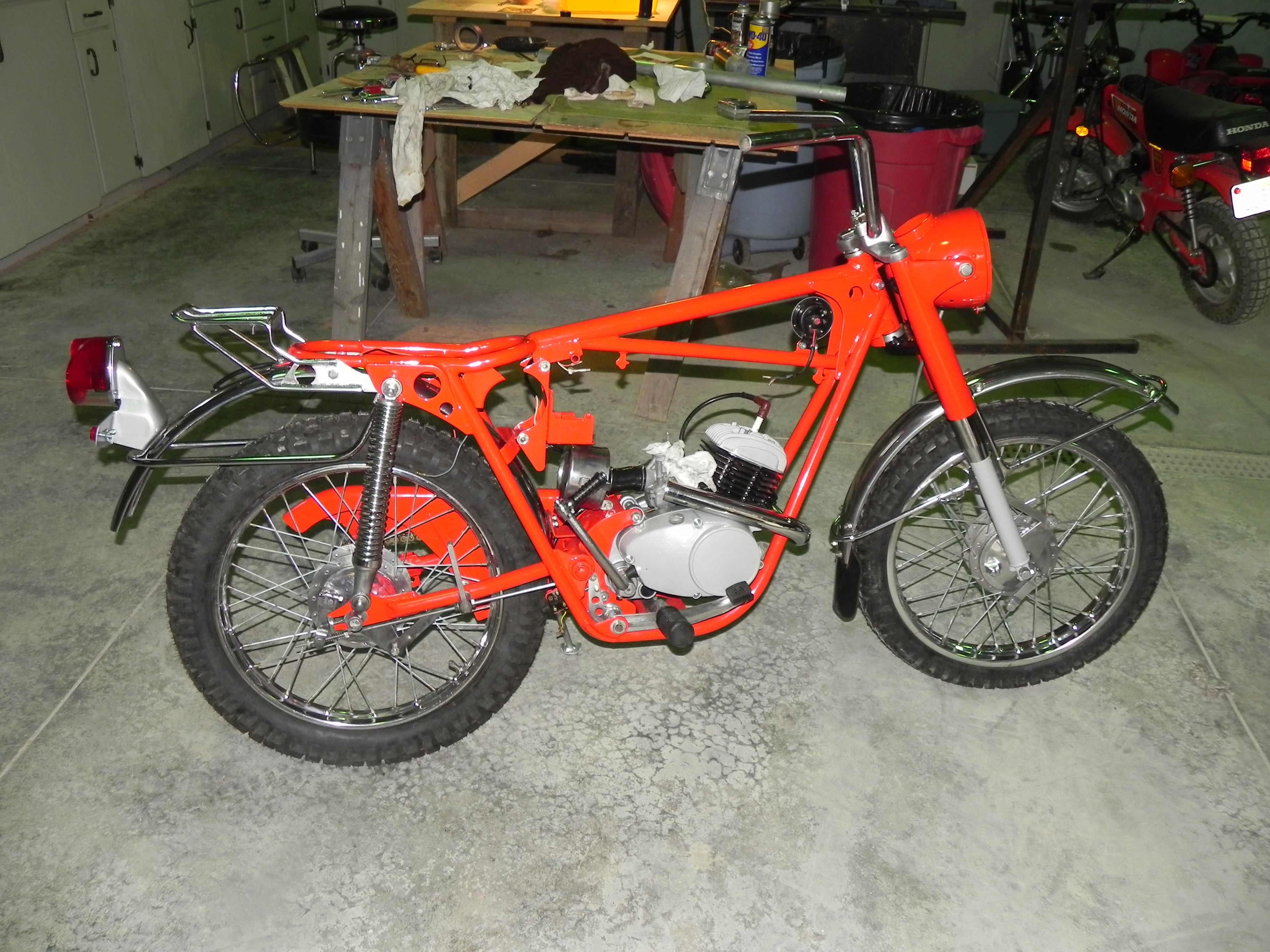

I took my 63 frame in and had it powder coated giving the company the hodaka color, they atch the color perfectly they sand blast the frame and all other parts cleaned it up and powder coated the frame and parts strong paint no worrys about gas and other oils. I agree with Clarence spray cans will cause problems with gas and oil.
this is my 90 after we had it powder coated. These pictures will show you all the parts plus the frame that was pow der coated. I also gave the company all the parts the were the orange color, :Battery box won't rust out or burn out. The best part is I didn't have to sand it down and clean it. for paint Just have it powdercoated It didn't cost but $150.00 for everyting
