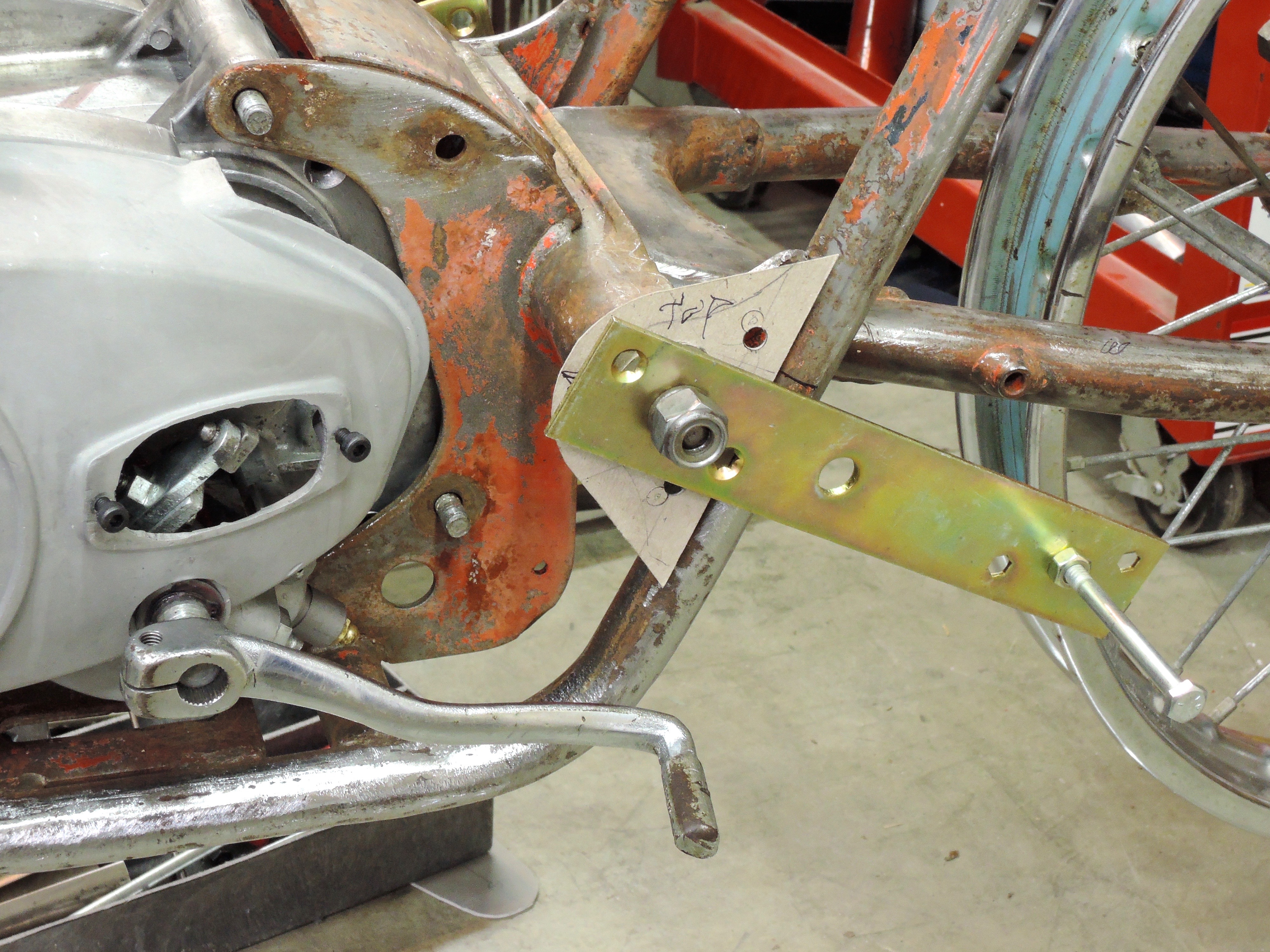

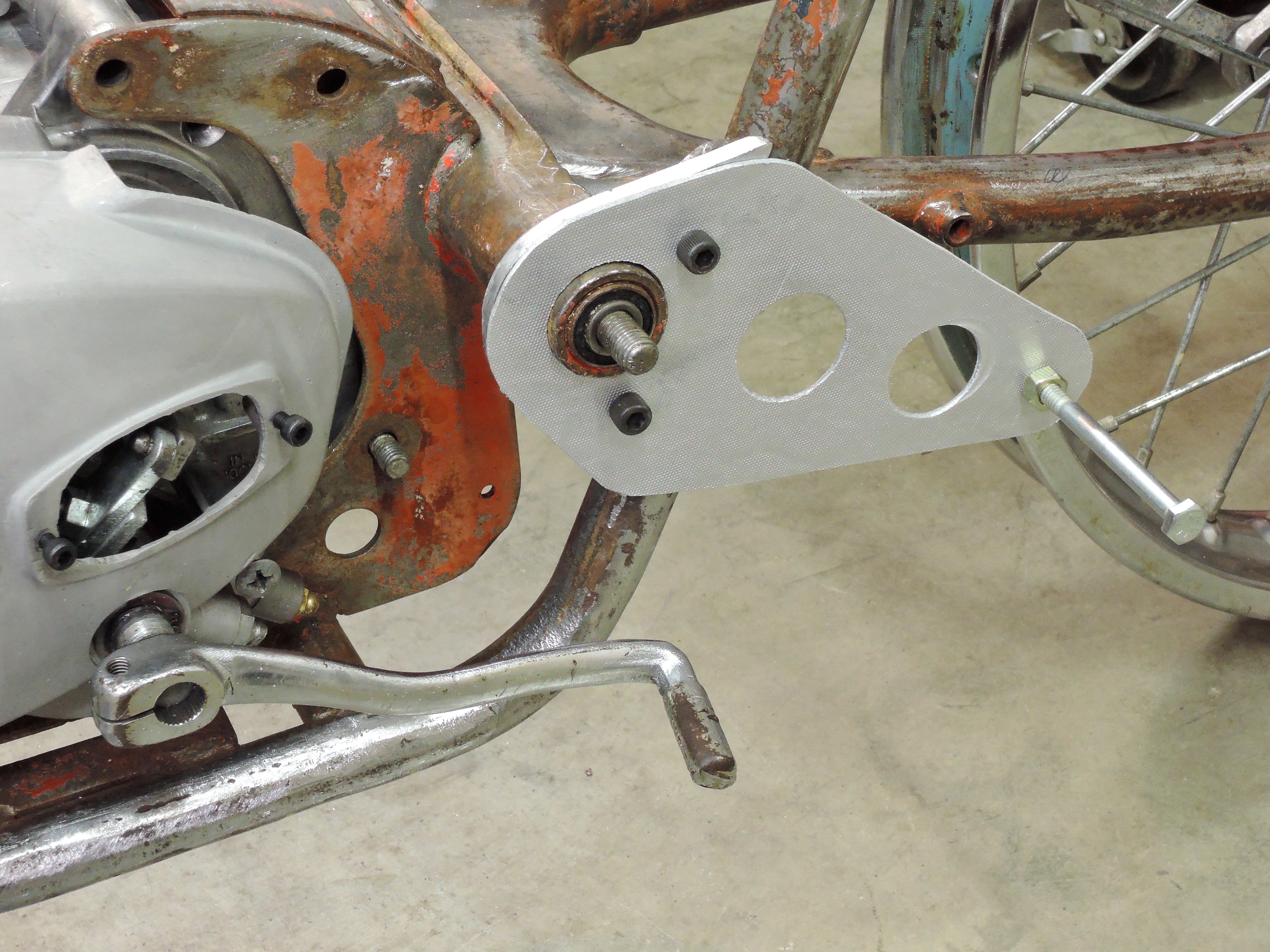

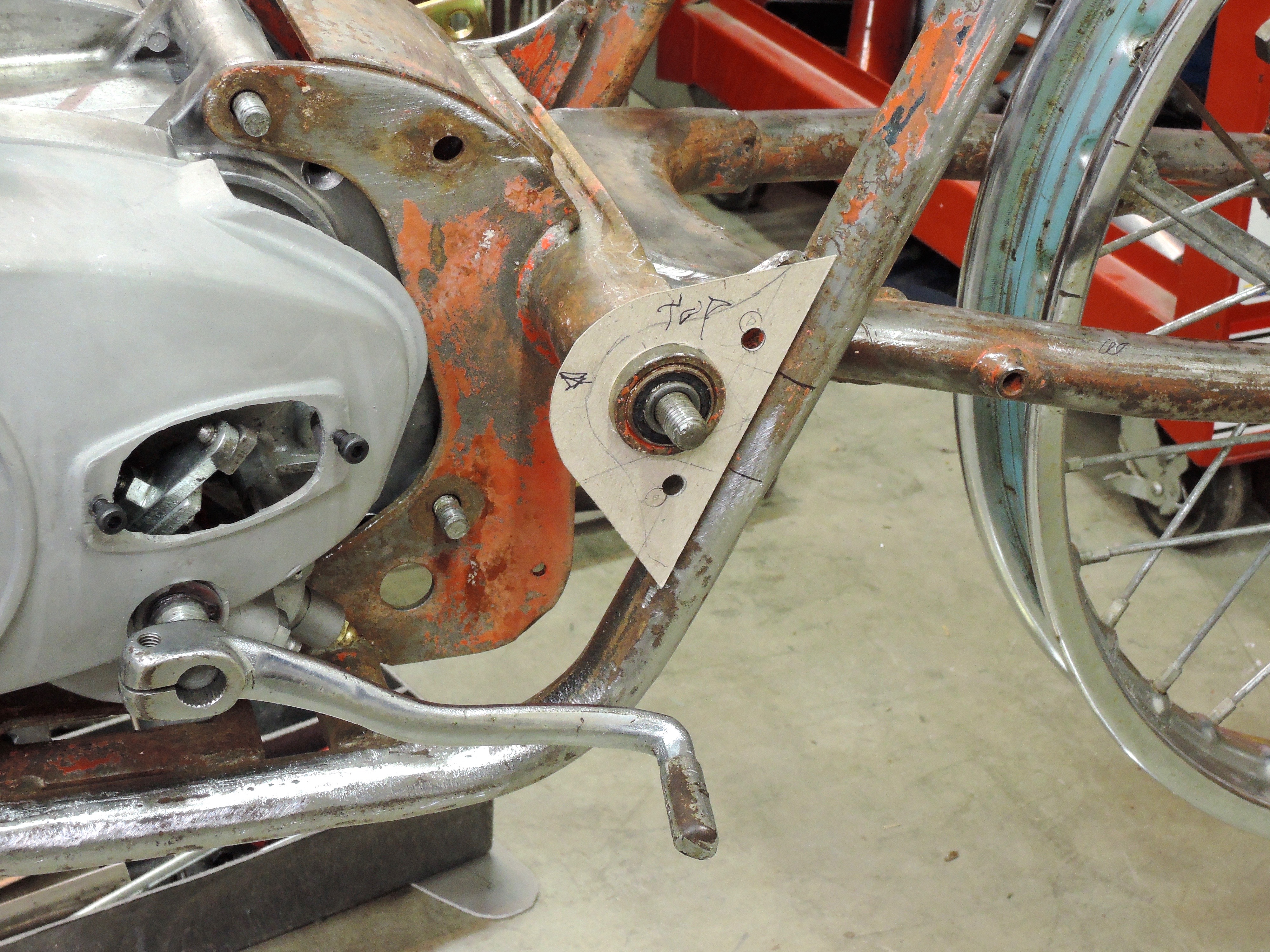

Here's the preliminary plan for anchoring a plate to accommodate the rear foot peg. A plate will also give me a place to anchor any linkage if needed. The plate and mount will be fabricated from 1/4" aluminum. It looks like it will work I always say.
Re: The 2 the Max Project
Max. What's holding it in place besides the single bolt at the swing arm?
Victor, Neither the spacer or the plate are bolted to the swing arm bolt. Both the spacer and plate will slip fit over the swing arm boss. Two bolts attach through both the plate and spacer into the swing arm boss braces. The spacer is needed to make the footpeg plate parallel to the frame centerline. The final shape of the plate has yet to be determined. I'll get a better picture when I get this all sawed out.viclioce wrote:Max. What's holding it in place besides the single bolt at the swing arm?Victor
Ahh. Now those pics look a lot different than the first 2 pics! Now I see how the extension will be held steady! Good job!
Good practice to use a template/mockup in the design phase. Ordinary poster board works well, but I like photo matte board.

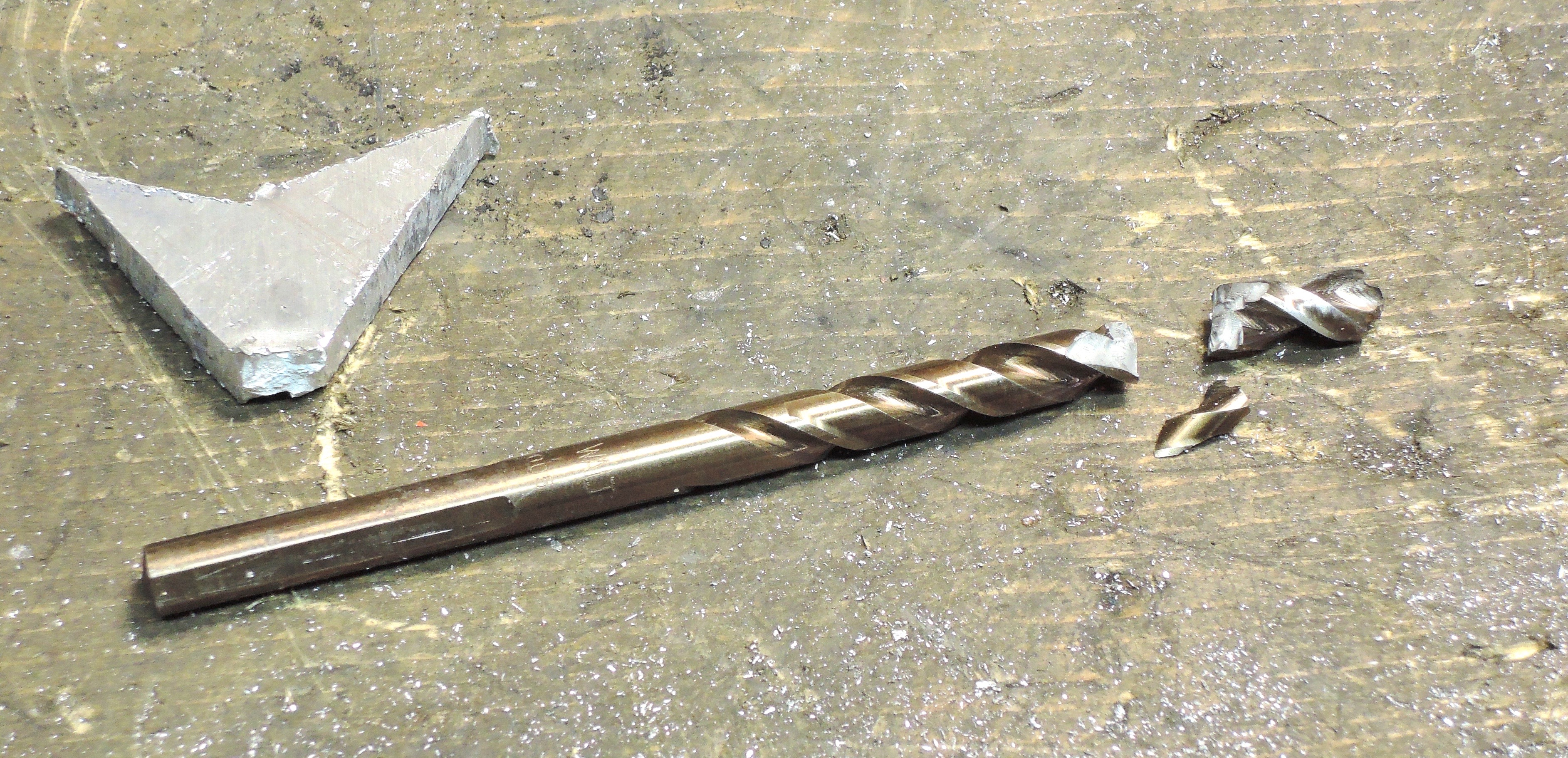

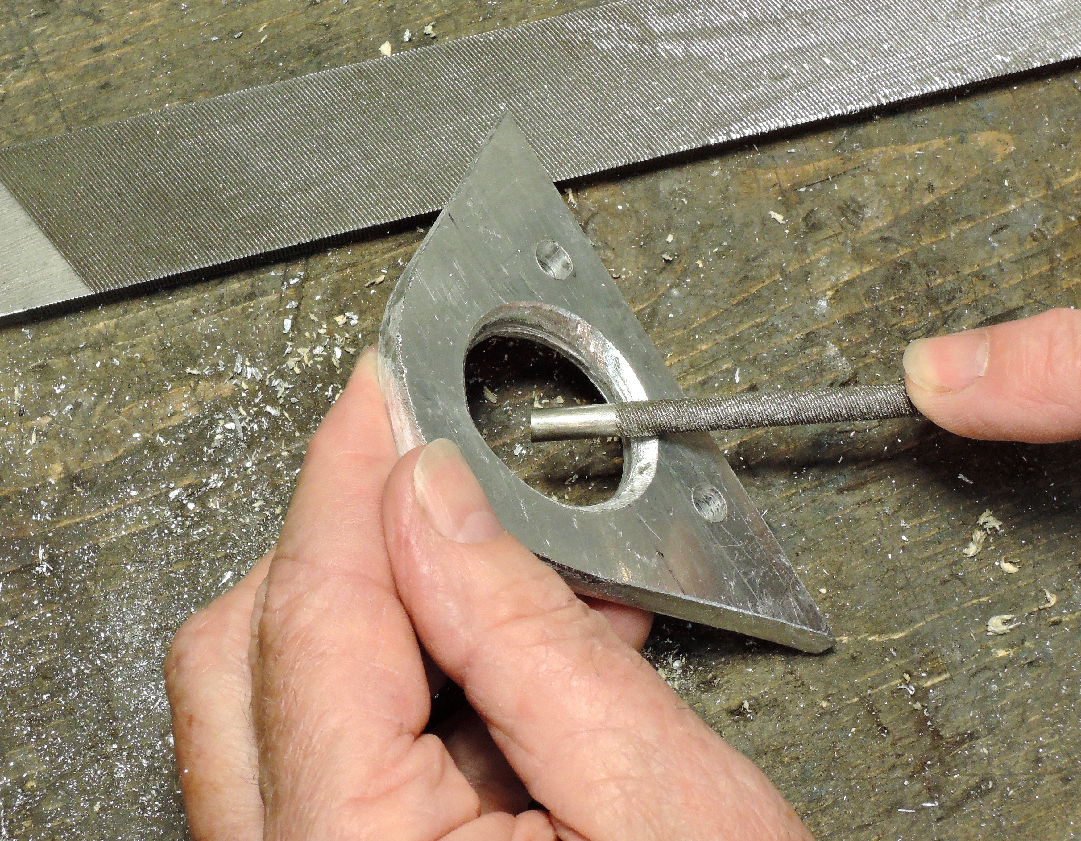

I've finally completed the first mount/spacer for the foot peg plates. Slow go with hand tools but I wanted to get it right the first time. I beveled the mount adjacent to the down tube for a contact fit as on the back side of the hole to conform to the welds. By fitting/tapping the mount several times and filling for fit it now has multiple contact points which should increase overall strength. It looks "hell for stout" as my dad used to say.
I also got to test my safety glasses while drilling through the frame as a 1/4 inch bit shattered and a large piece struck my glasses. It seems as though this project can be dangerous and I'm on guard and aware after two potential accidents. I'll never drill again without eye protection. We all get slack or at least I have in the past. Be safe I say!

Glad you had that protection on! I'm reminded of the time I stuck a spray can of carb cleaner with the red tube on the nozzle, and sprayed it into a carb opening, not realizing it was going to right back out another passage, right into my face! Thankfully, I a lease had my corrective lenses on and it stopped the carb cleaner from spraying directly into my eyes. Safety Glasses are made for a reason, and we are lucky ebenvits drmonstrated WHY they are needdd without getting seriously hurt!!! Agree. Safety First!!!
The above two posts serve as a good reminder to all of us who use tools on a regular basis. Its so easy to become complacent. You only have two eyes. Same goes with hearing protection. I developed tinnitus (ringing in the ears) a few years ago, and have to blame it on using chainsaws, weed trimmers, guns etc, without ear plugs in. Thanks

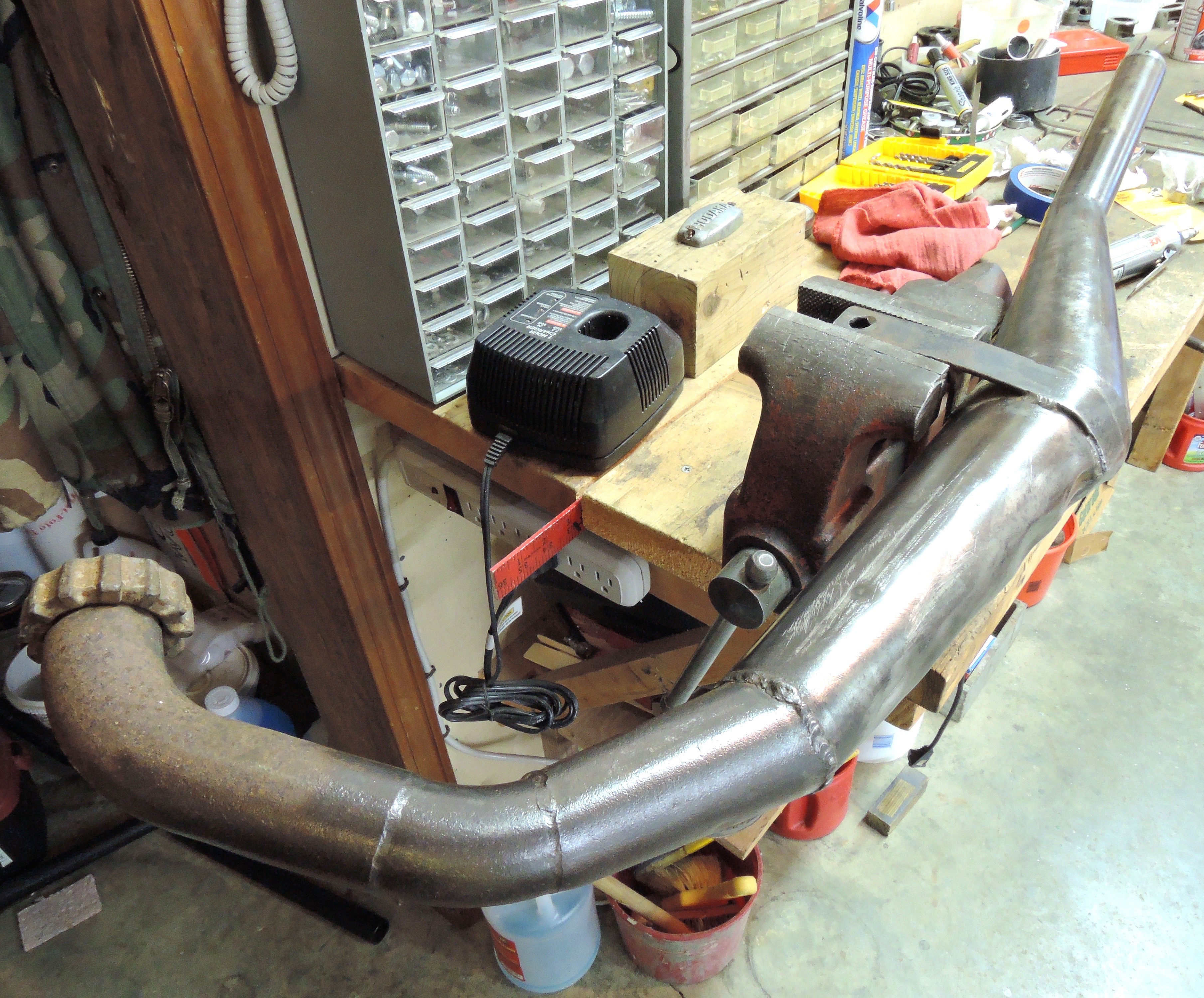

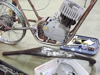

We are still kicking this pipe around with no results. It looks quite acceptable from the top but the bottom is awful. All the dent pullers are shaking their head and willing to try but with no guarantees. I tend to agree with them. Today the clever guy who built the Day One project and I decided that it was time to roll a new cone and do it right. This guy does good work on such things and I have complete confidence all will be well.

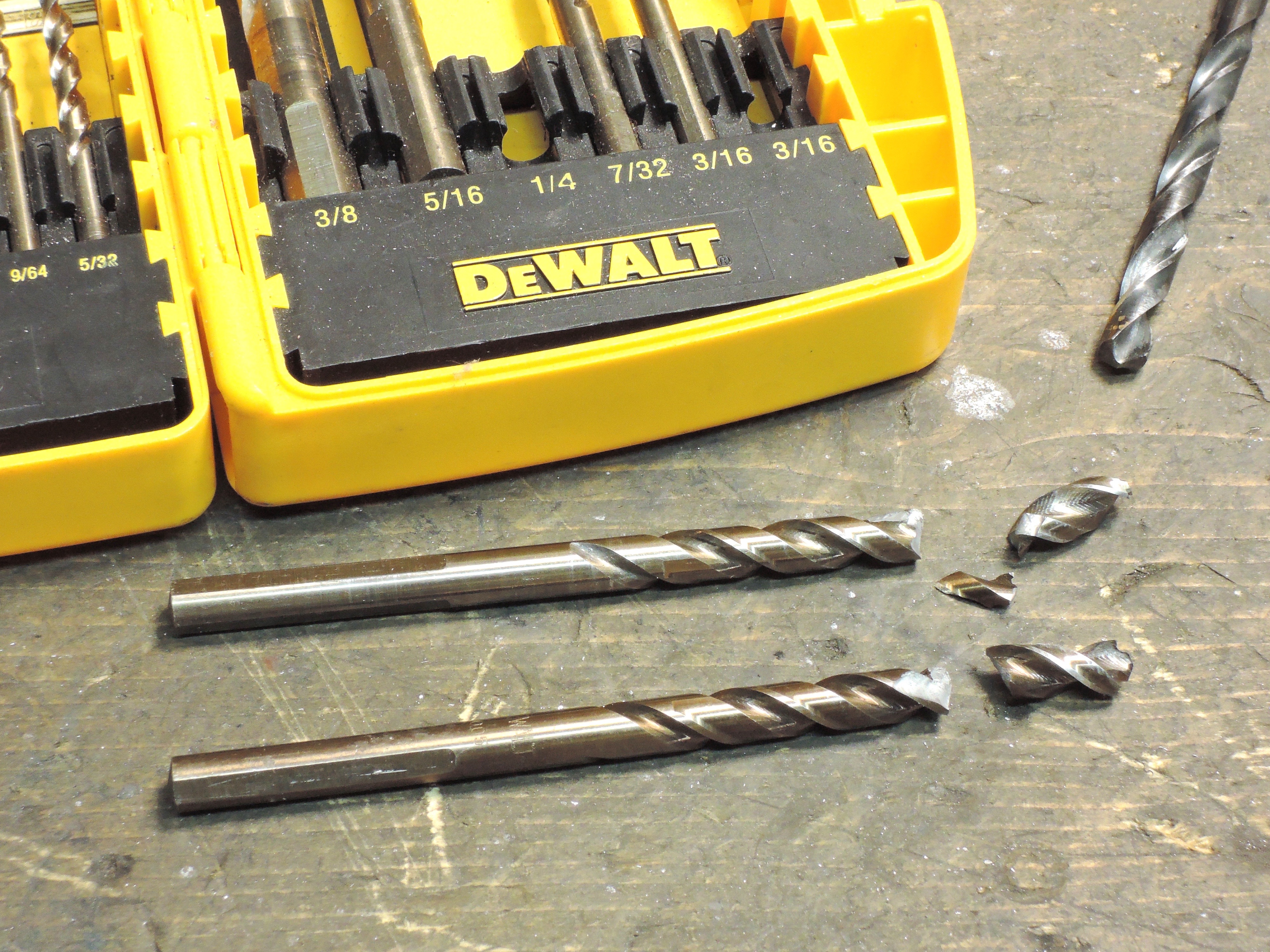

By the way, my second Dewalt 1/4" bit also broke while drilling the frame on the other side. Scary, I had a face shield on this time and it did stay in just two pieces rather than the tree of the other one.

Hey Maxie, Do you think that chamber might be a candidate for filling with water, capping, and freezing or were you thinking of cutting out and welding in new divergent cone?

Oooch, that is unusual. I rarely, if ever, break a larger "Letter" drill. Smaller "Number" drills, all the time. Don't 'spose it's a bad run of the bits?

On the pipe, there are guys who use heat and controlled air pressure to "blow" pipes back into shape. Seems like a procedure to NOT try at home . . . but they securely plug the pipe ends and provide for a means of metering air into and out of the pipe. They heat the deformed area to red (pliable) hot and basically "inflate" the deformed area back into shape. Sorry, I have no leads on where to get that service now - knew a guy once who did it.

A long, long time ago we had a guy on our racing team who built pipes. A local sheet metal shop would cut out and roll the cones and our man would piece them together. The hard part was fitting and turning corners with cones. In this case we have a simple truncated cone to replace and we have an original cone to compare to. We can draw out the cone on construction paper and even fit it precisely before cutting out the metal piece by wrapping the pattern around the original. I'll cut the mounting bracket out of the cone so the fabricator can get a really good fit." What could go wrong?" I always say.
As for the foot peg plate needing more strength at the swing arm pivot has been considered and addressed. The plate will fit over the swing arm boss with a somewhat precision fit as does the spacer. This prevents any rotation. Contact points on the really stiff plate will be 100% on the spacer, near 100% on the swing arm boss and tightly along the frame down tube. Most forces should be rotational and not lateral. All should be well if not over engineered. What could go wrong?

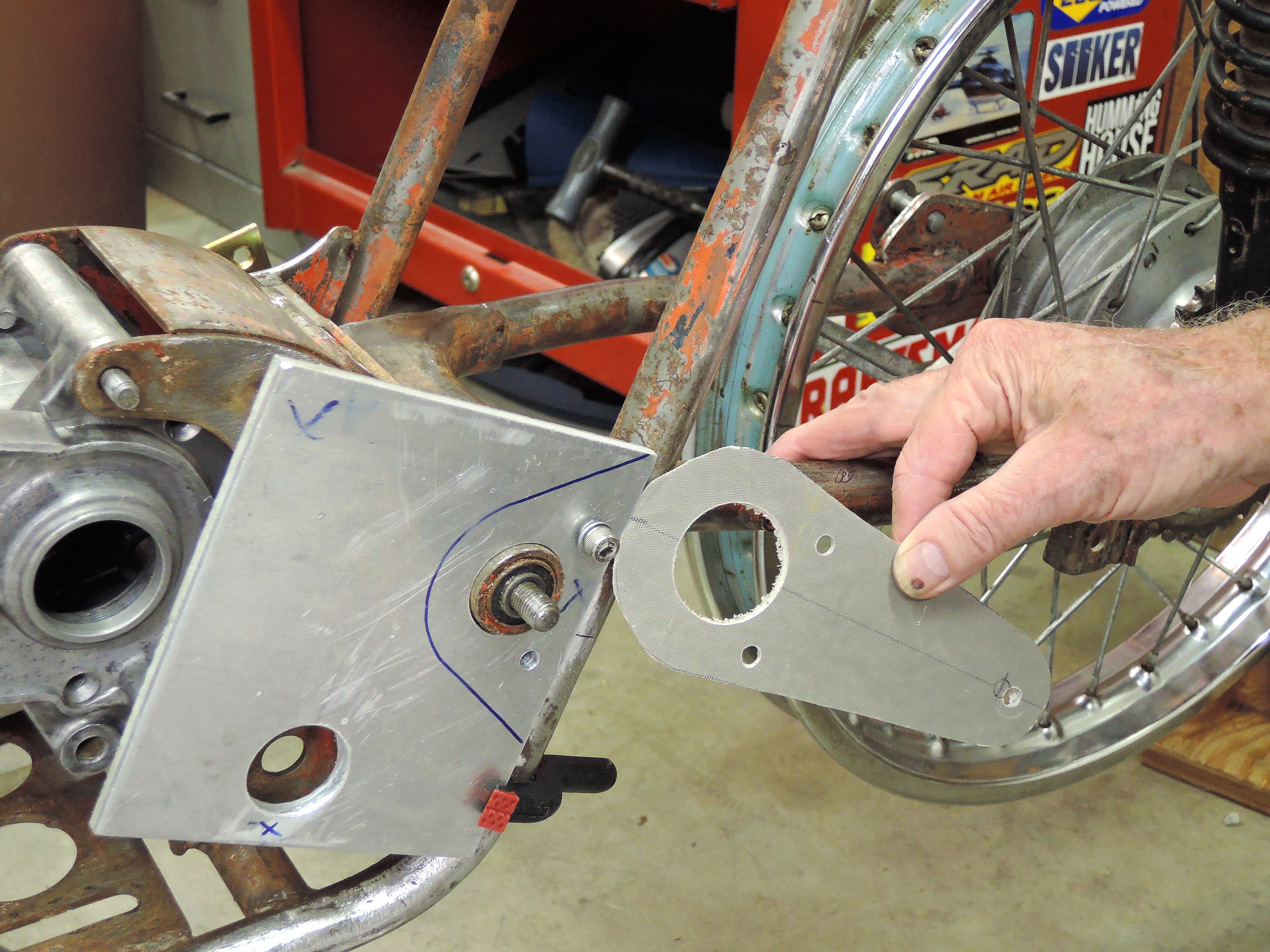

Here's a quick prototype idea just cut out from floor tile to show the concept. I still haven't figured out the exact position for the peg and it could even have different holes for different positions. The final will be constructed from 1/4" aluminum.
I like it. The OCD part of me says "it'll be twisty and bendy" but the Practical part of me says "try it and see". Maybe you could run a secondary stay from the footpeg area down to the lower frame tube. Triangulation is spiritual.

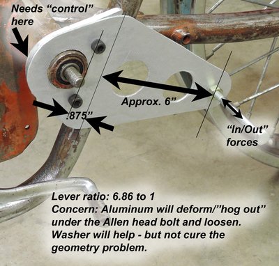

Thought I'd offer up an illustration showing my concern about the peg mount. It IS a difficult problem to "cure".
Weld a stud sticking out sideways ahead of the swing arm pivot? Weld a nut on the frame ahead of the swing arm pivot to accept a bolt where indicated? Other? Leave as currently envisioned, use washer under Allen head bolt and check tightness often? Decisions, decisions . . .
