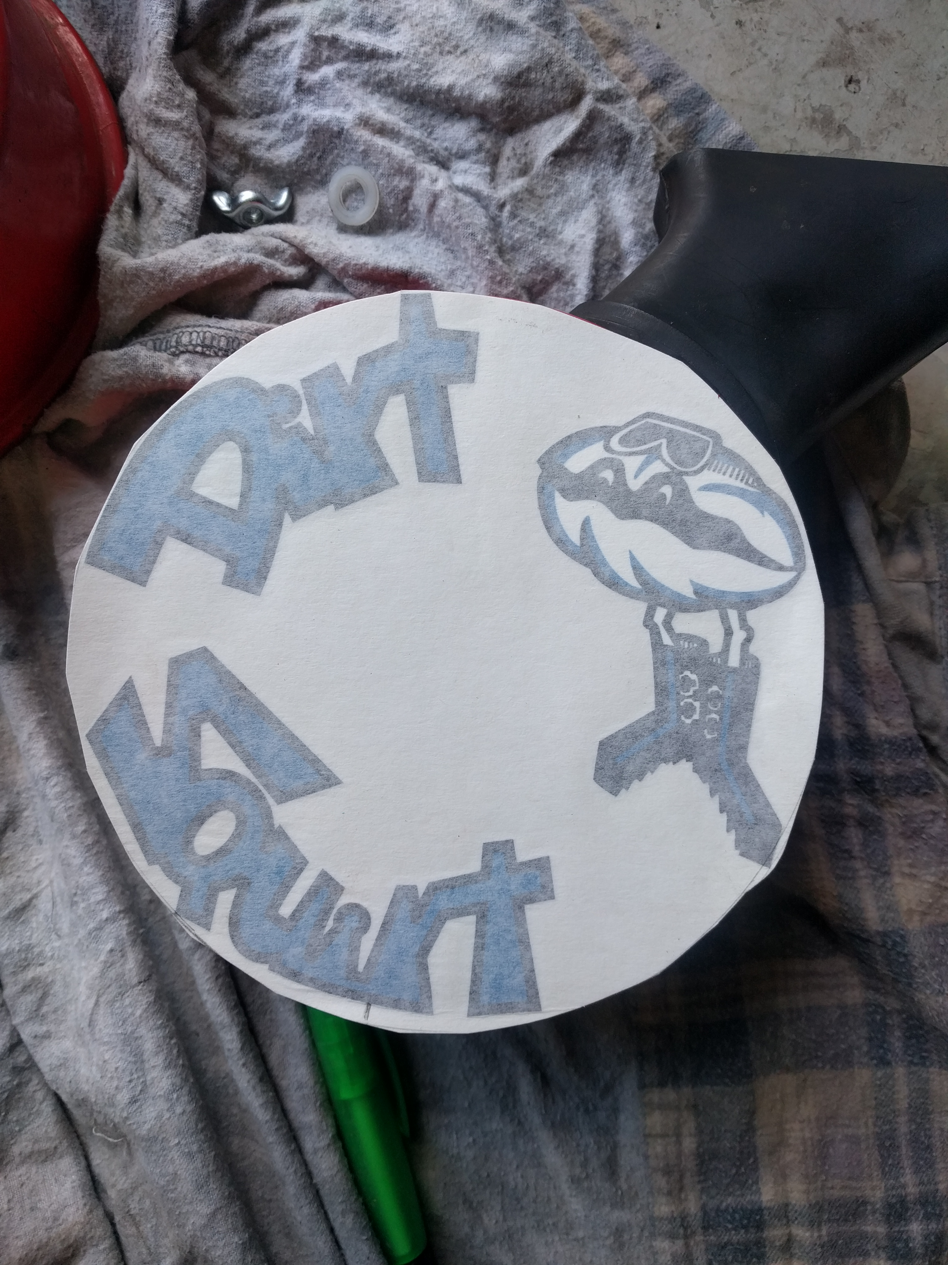

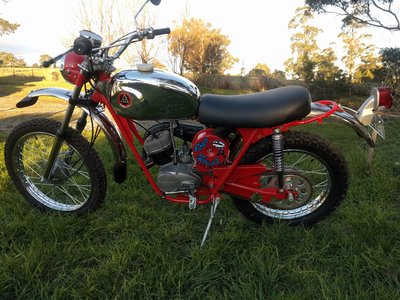

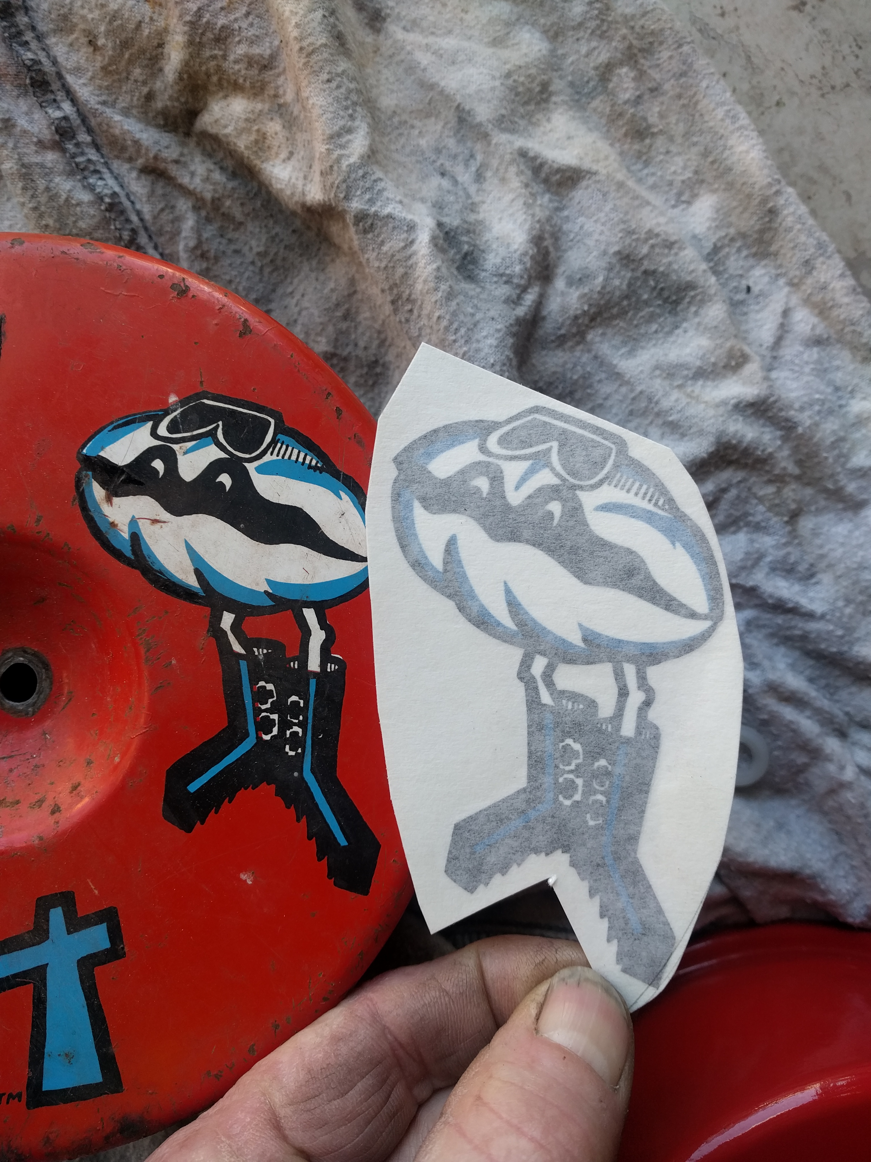

Well every story should have a happy ending....
Finishing touches today
DS sticker put on. Pretty disappointed in this repro decal. It's way too big, bigger than the lid by a bit which meant cutting it into individual sections to sort of make it fit. Also doesn't have the "TM" lettering on it. So at some point I'll toss and do my own.
On the plus side (BIG PLUS side
I fitted this today as well....one number plate

Re: Project Dirt Squirt
Sweet ride. BTW - thanks Captain. I missed your response to my "snick" inquiry.
