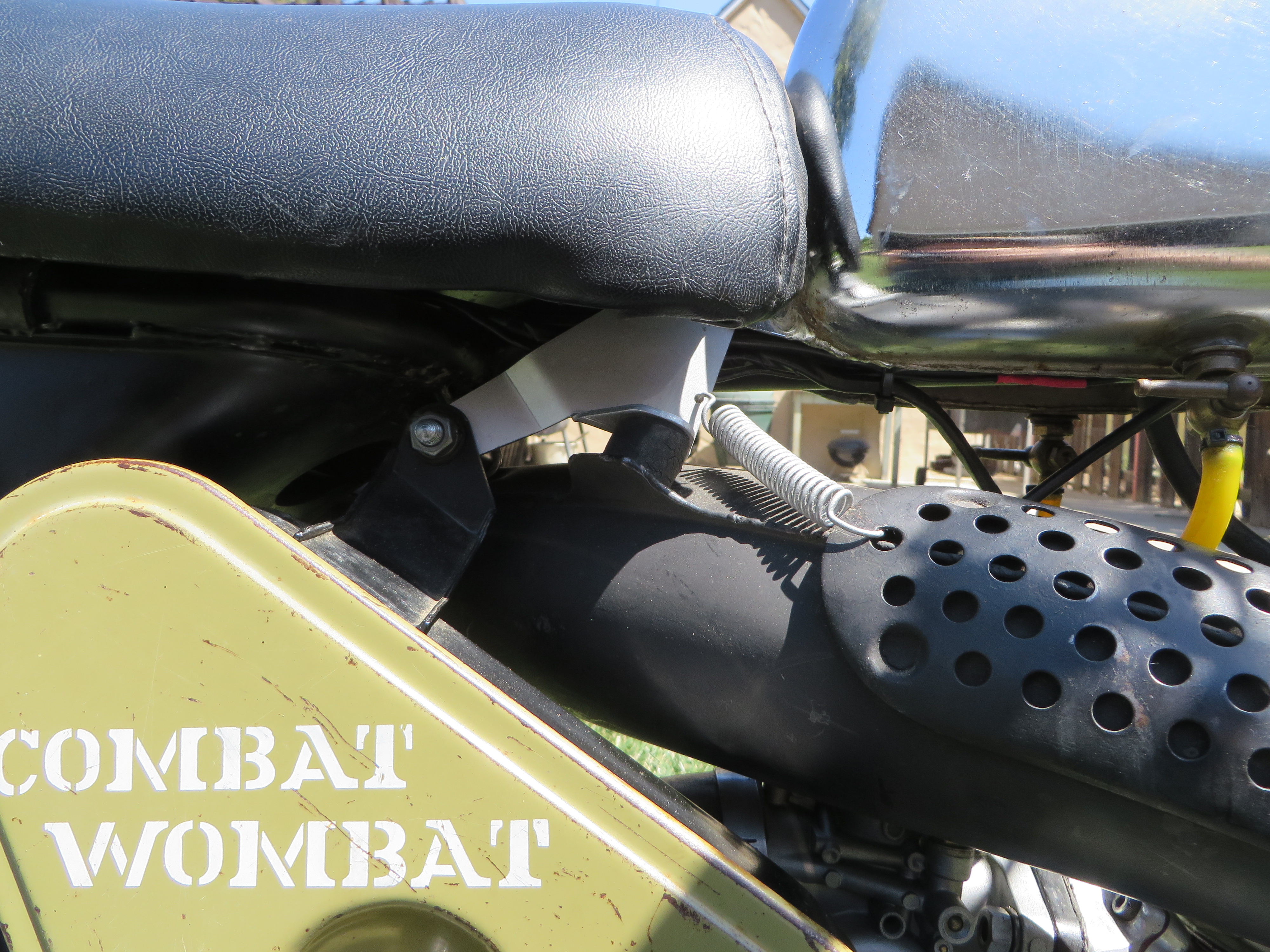

The front setting bracket is under the seat.You need a FIFTH exhaust spring under the seat.

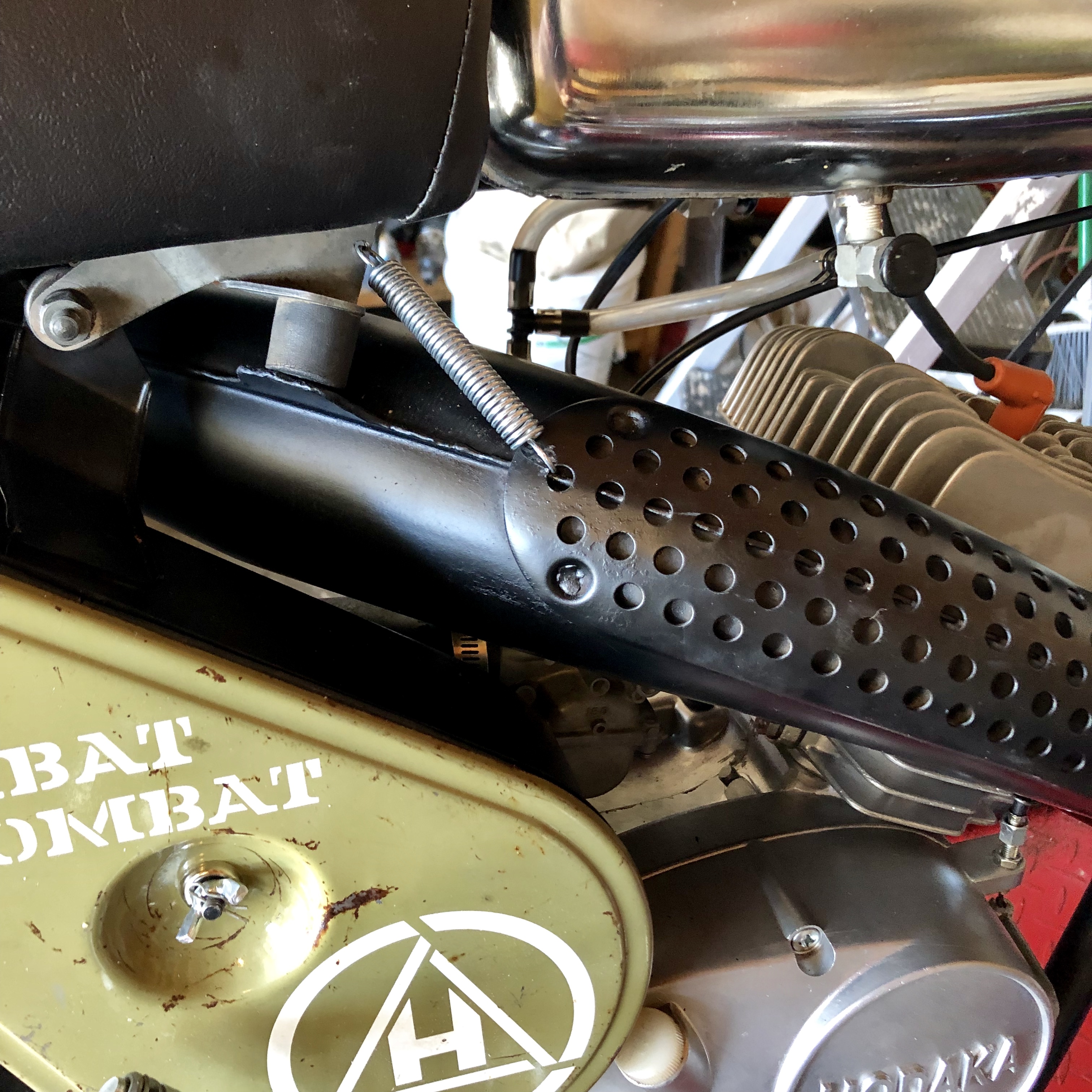

Ahh. I didn’t have That Spring! Thanks! Is it the same as the other exhaust springs? Yes I looked at the parr’s fiche and it is the same. I may have a spare! Thanks for showing me this, Larry!
Edit: Larry. Did you use the 1 1/2” spring here, or the 2”? The 1 1/2” seems too short while the 2” seems a bit loose. Maybe I need a 1 3/4” spring? The parts fiche lists all the exhaust spring as the same part, but I can’t seem to stretch the 1 1/2” far enough.
Re: Victors Combat Wombat Thread!
I used a 2" spring from Ace Hardware.

Went and got the same spring this morning! It seems to be working well! The OEM exhaust spring I had just seemed too tight to make it reach. Maybe age has taken some of the “give” out of the older spring?

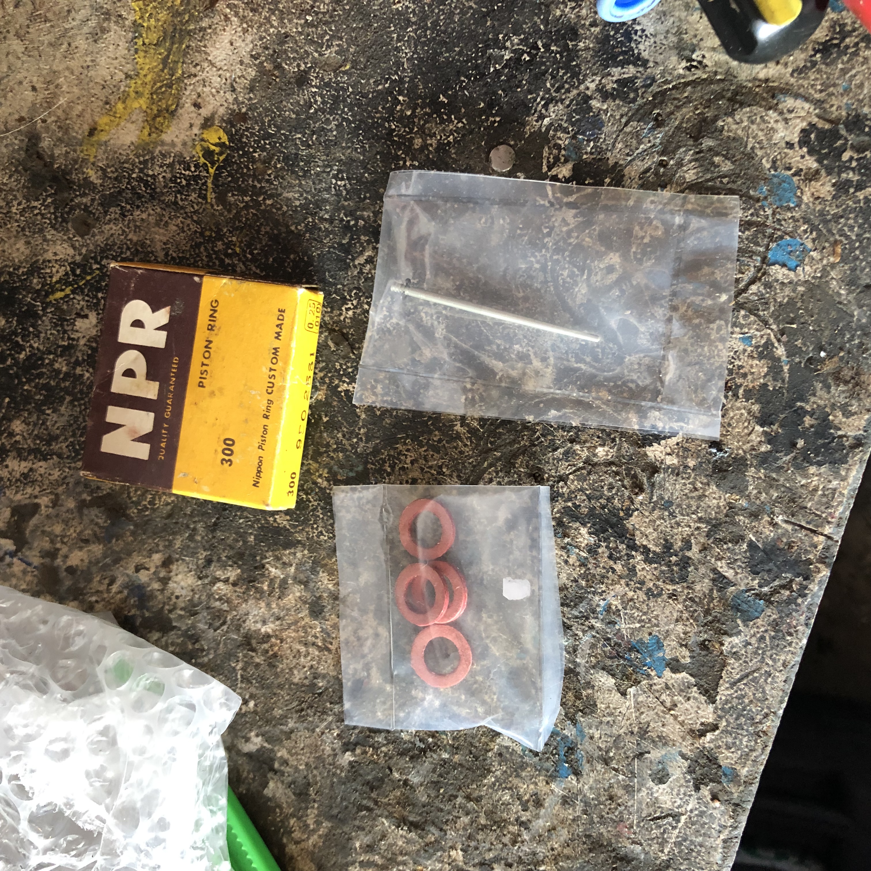

I was waiting for these and didn’t see them in my shipment. Well, as it turns out, Bev had wrapped them with the ring box, and I couldn’t see them thru the bubble wrap! I had set the ring aside in its box & bubble wrap thinking it was just the ring box in the wrap! I finally cut it open and there they were, 4 petcock gaskets and my 5EJ13 stock CW needle! Put the needle in the carb & put the gaskets in my carb tool box! But, you really couldn’t see them thru the bubble wrap!!!
