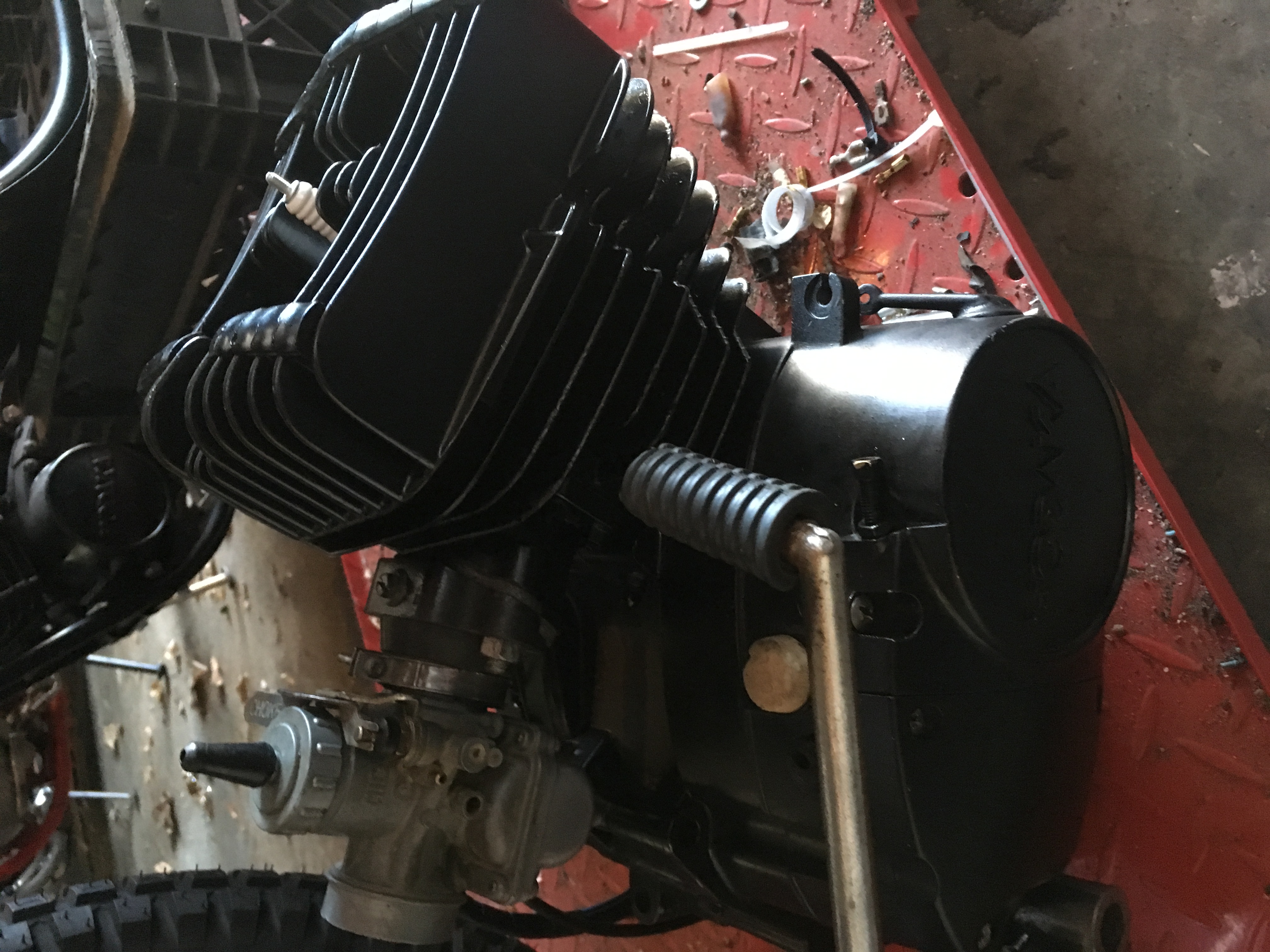

OK!!! Got the piston/cylinder back today! Top end went on like butter!!! Can't believe how easy it was. He didn't have to gap the rings at all because whe he finished the cylinder to be .004 over the piston, the ring gap went from being completely closed to being .008 for the top ring and .018 for the bottom ring!
All horizontal port edges were chamfered & the exhaust port relieved an additional .003 as well. I just can't believe how easy it went together! Just squeezed the rings with my fingers and plop!
Finished the carb up and it has a 160 main jet & a 30 pilot jet in it. Cleaned everything well and put a new O ring on the choke plunger! Don't know if the 160 main will work at this elevation of 7,000 feet, but I figured I'd try it first. Just need some extra hands to drop it in the frame! Yippie!!! :D Victor

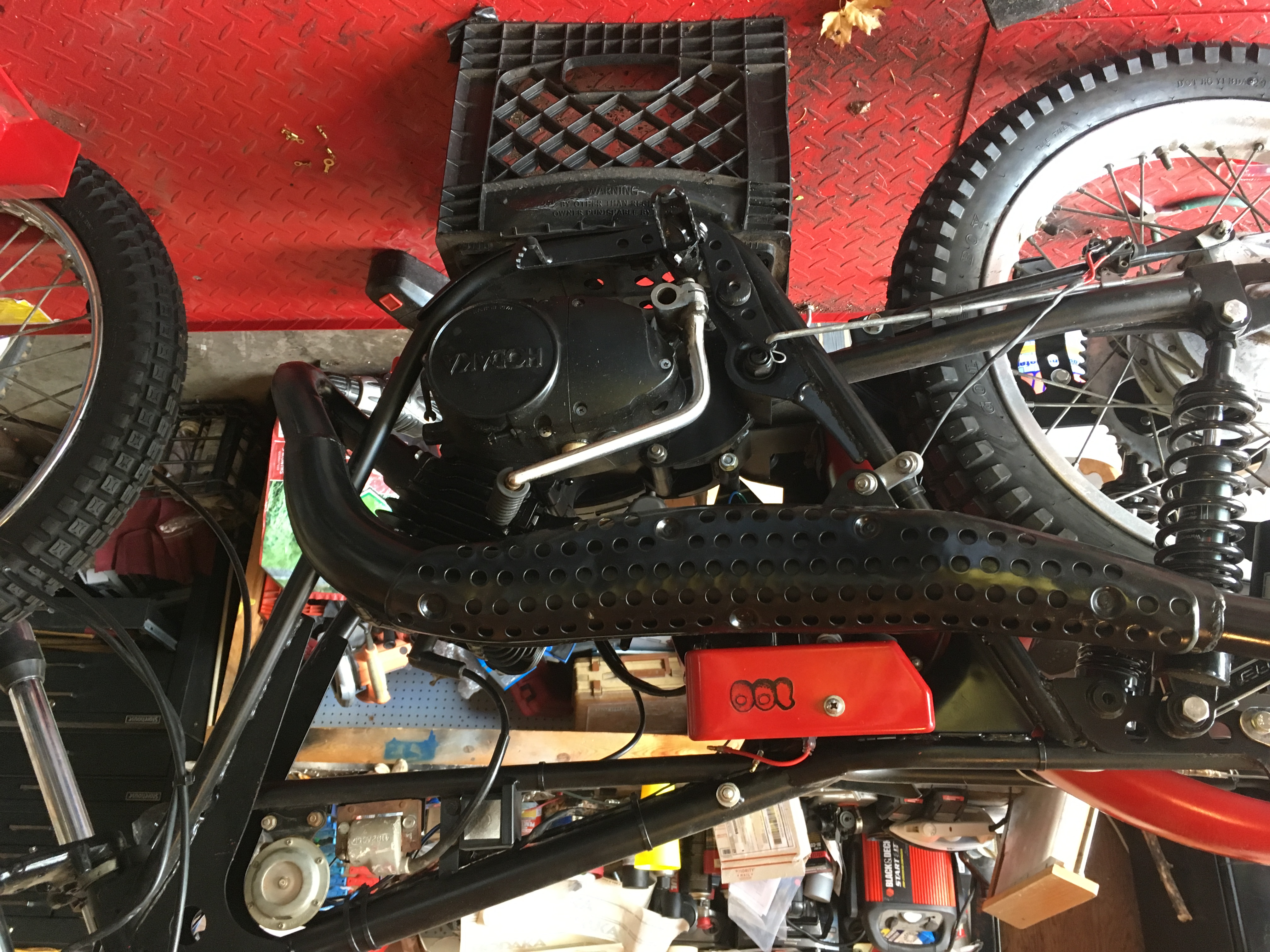

Got the motor in the frame, but, I forgot I didn't have a second exhaust manifold! Bruce had one but it was minus the inner tube piece, so I just ordered a new one. Wait again........ :D Victor
OK. Feeling really STUPID!!! I bought and received a new exhaust port because I couldn't find another one here. Received it yesterday.
Went out to the garage & just found a perfectly acceptable one on the extra cylinder I painted! Damn. Anyway, that was $60 I didn't have to spend! :roll: Victor

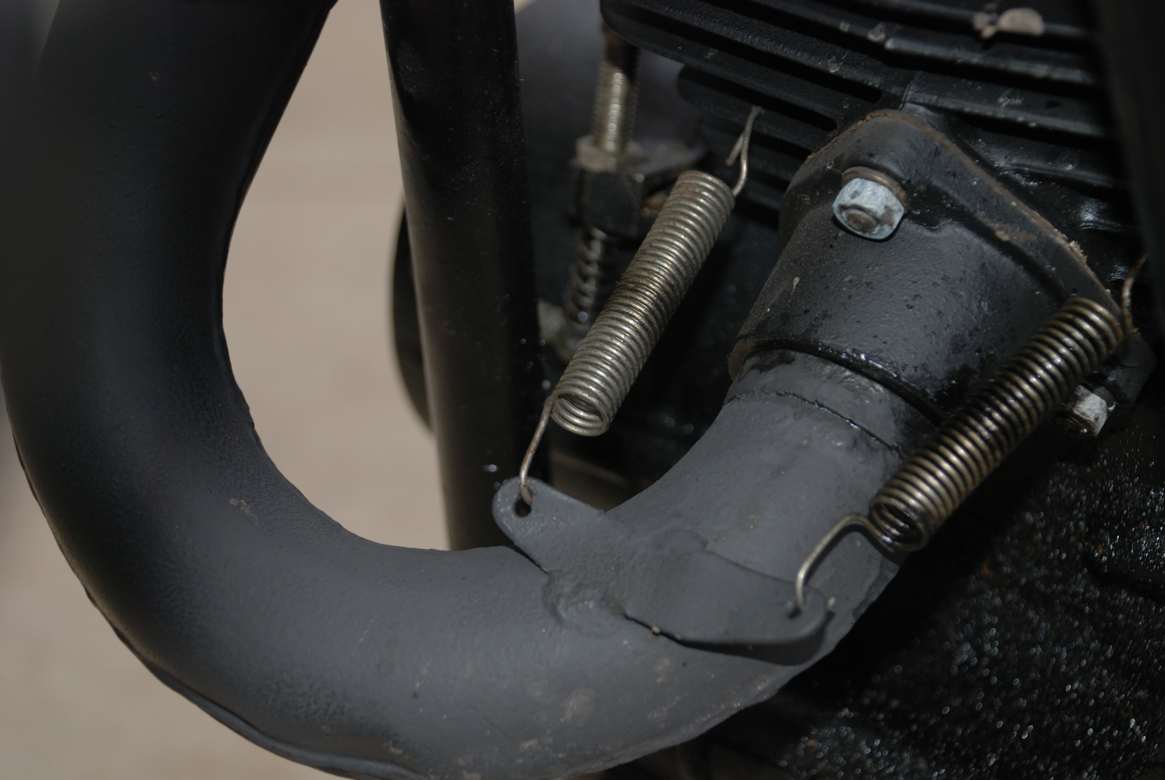

Question to my Toad people! Is there an exhaust gasket to go between the pipe and the exhsust flange? I don't see one on the owner's manual but just making sure. :oops: Victor
Mine is slip fit and maintained in position with springs.
I didn't think it took a donut gasket but I thought I would ask! Thanks Matt! :D Victor

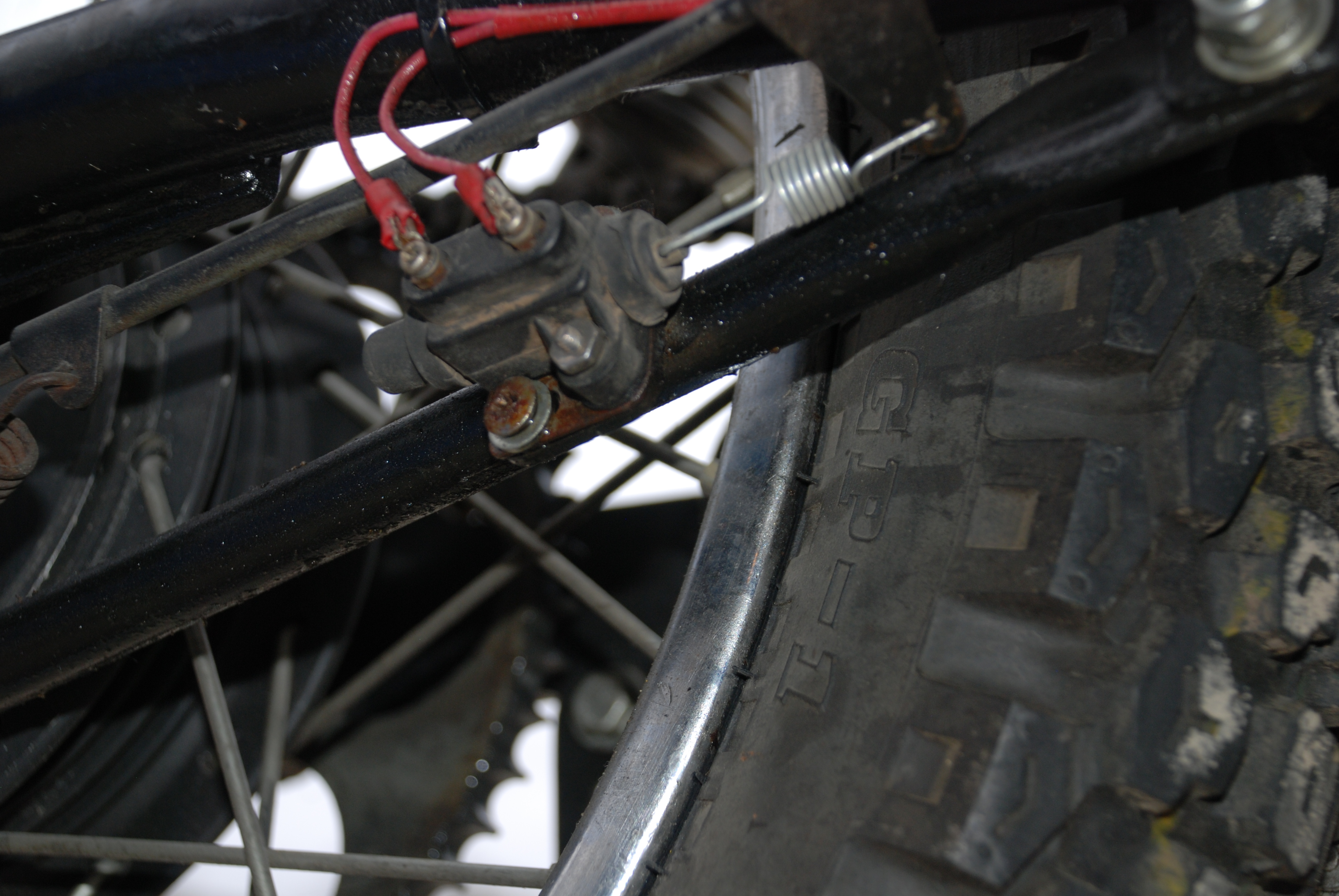

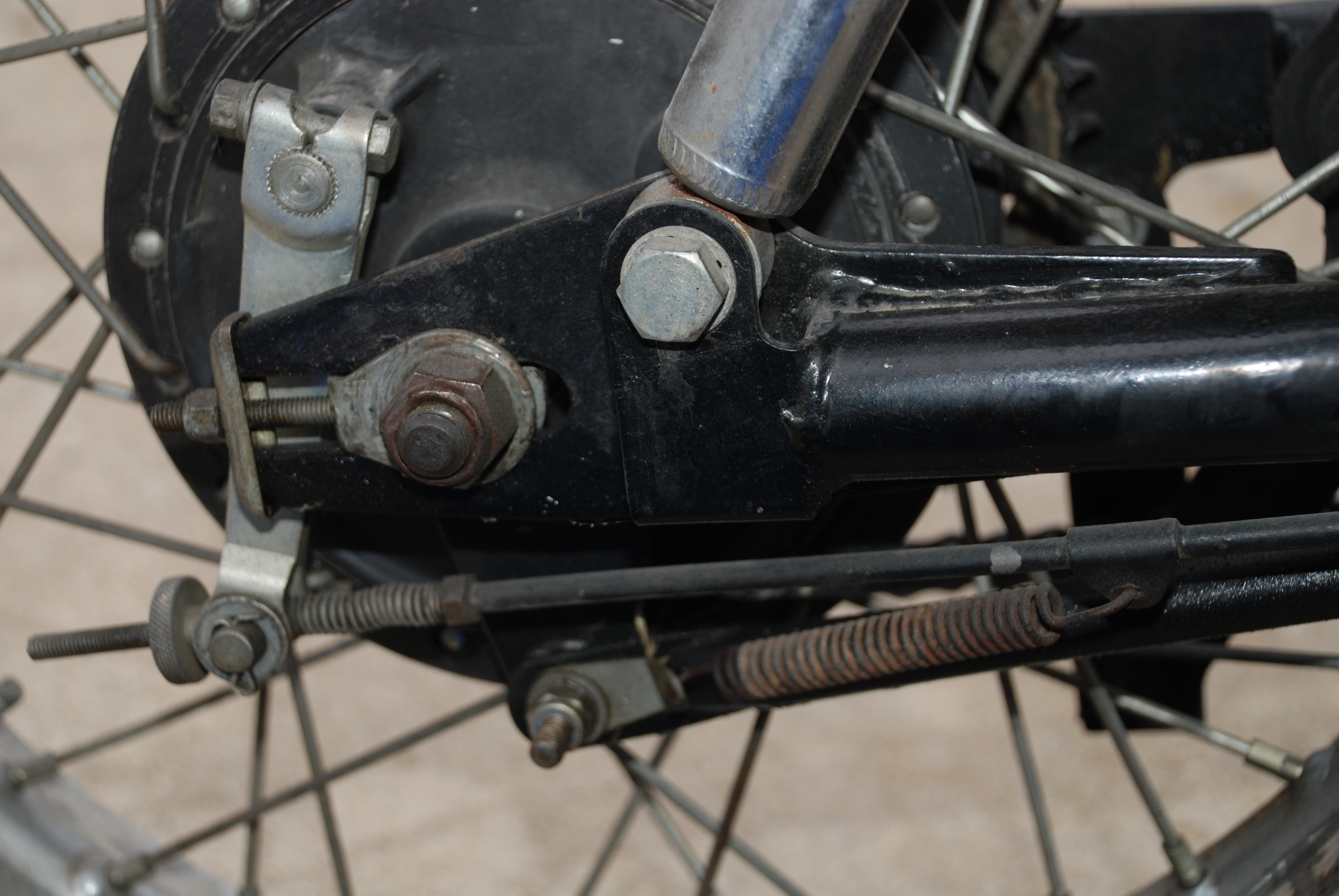

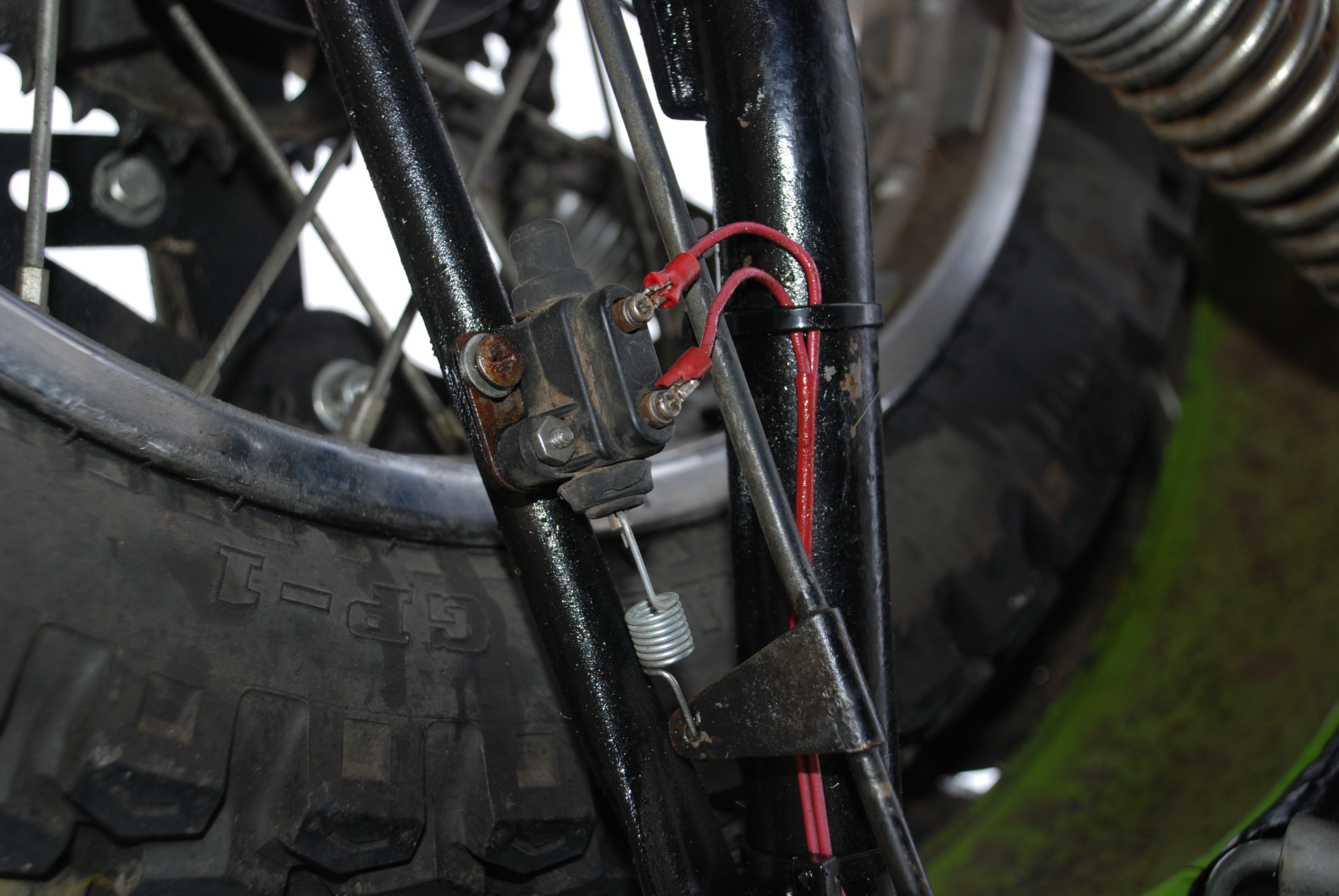

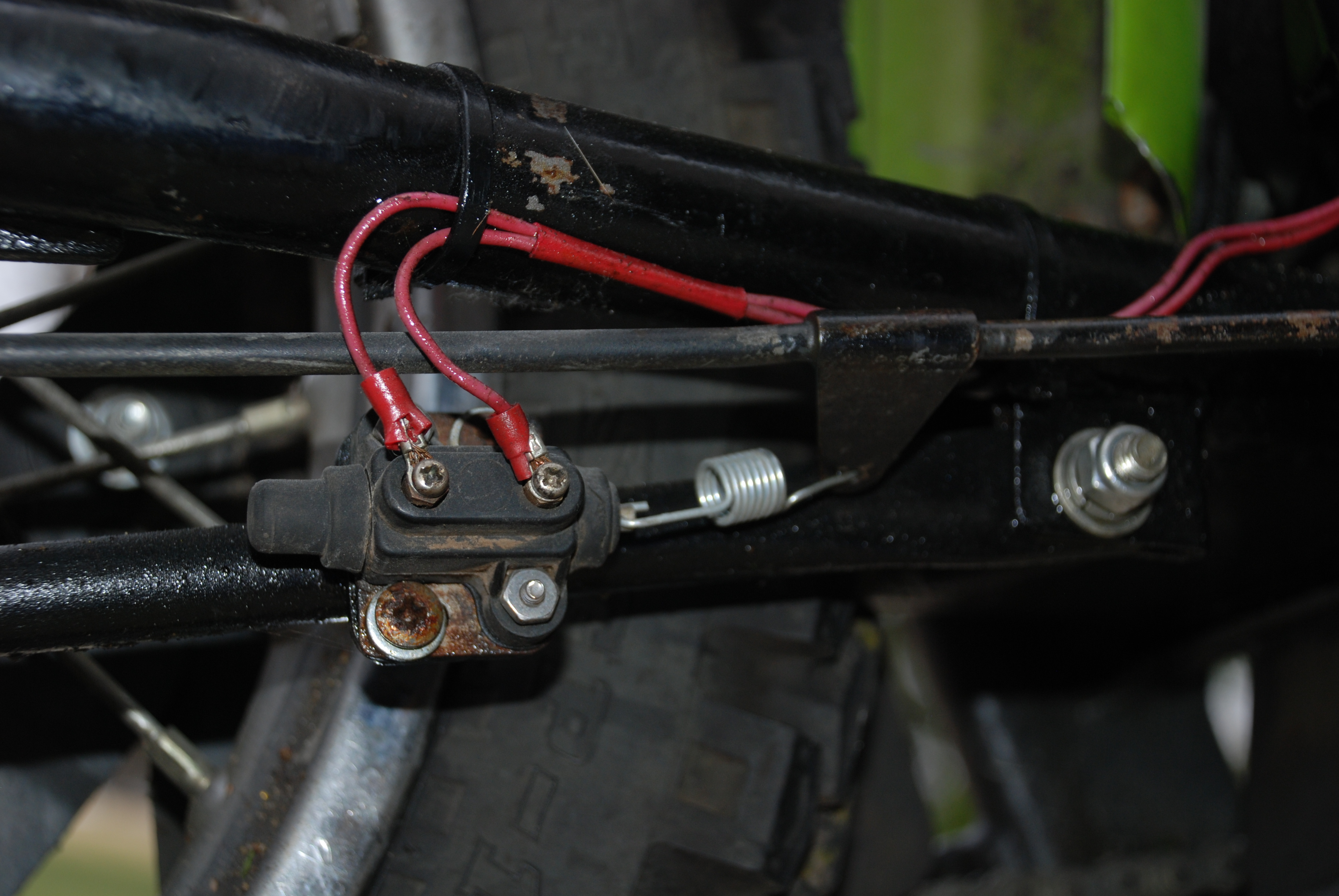

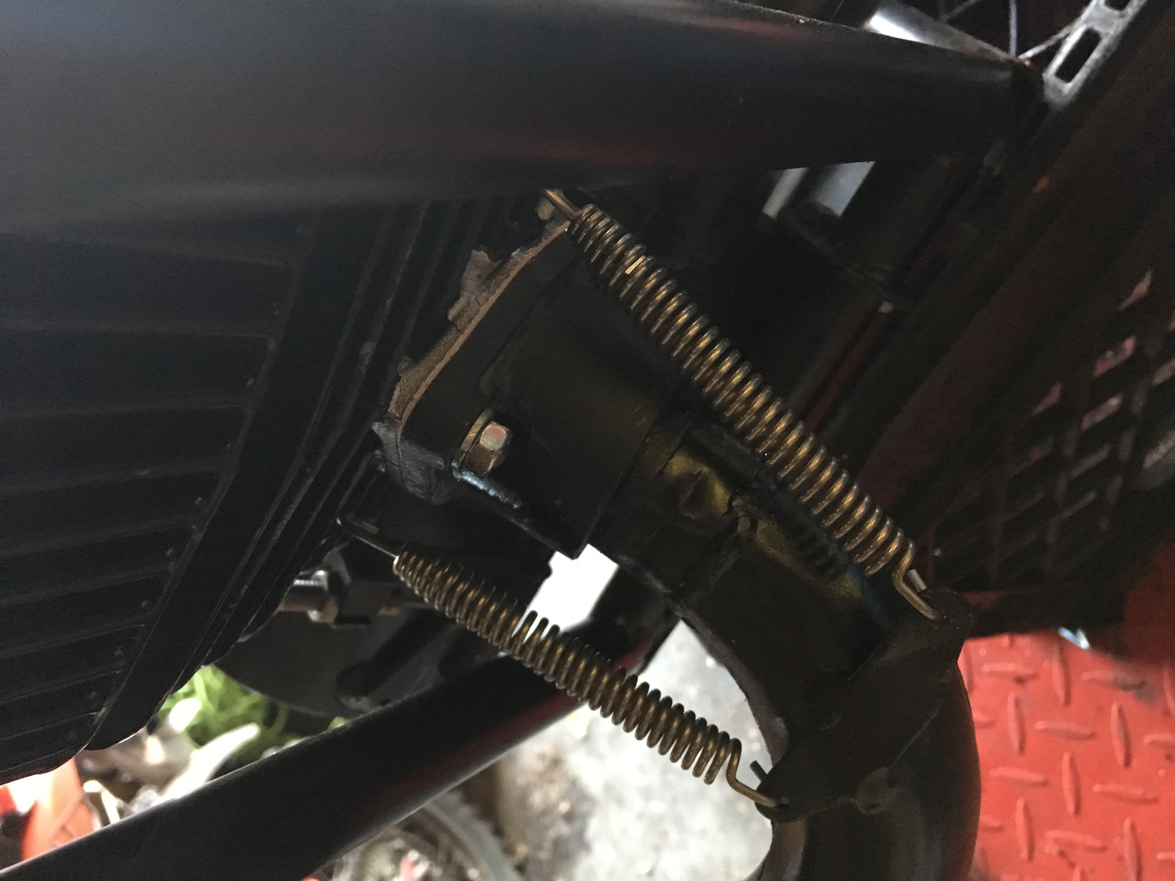

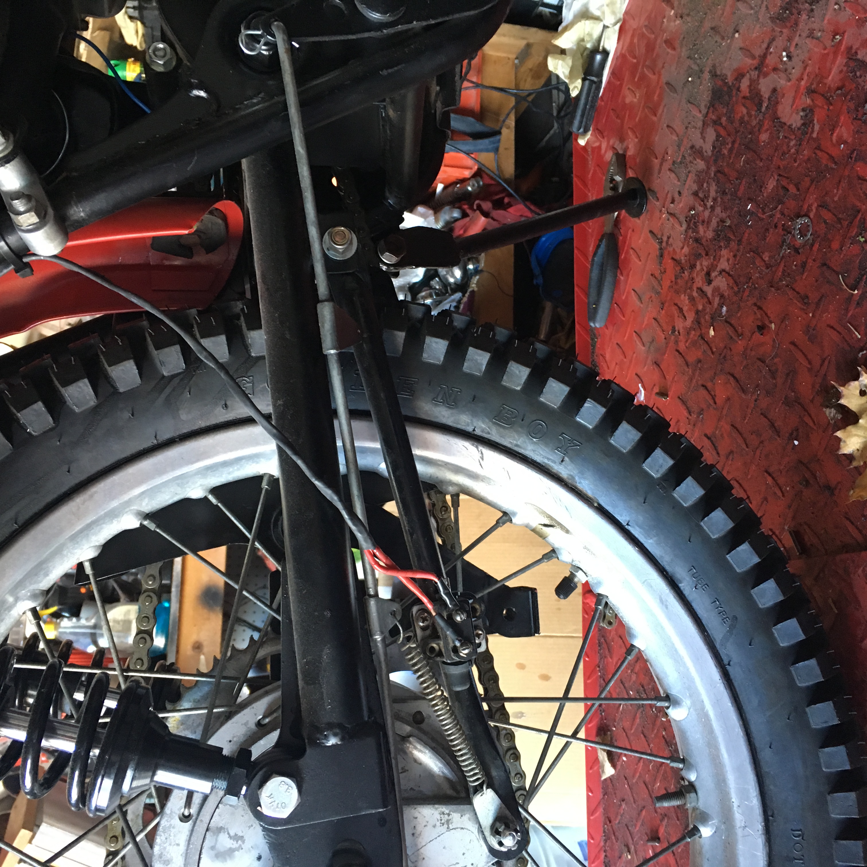

Matt. Can you please do me a favor? Can you take a picture of the springs & rear brake light switch on the rear brake stay arm and post it to me? Mine is looking a bit strange on one and different on the other! Should be the same, I would think since they are both the same model and same month of factory build? It appears I might have the wrong brake rod on one of these Toads, and I think it's the Green one. Also need to know if the brake switch faces towards the wheel or outward! Thanks! :D Victor

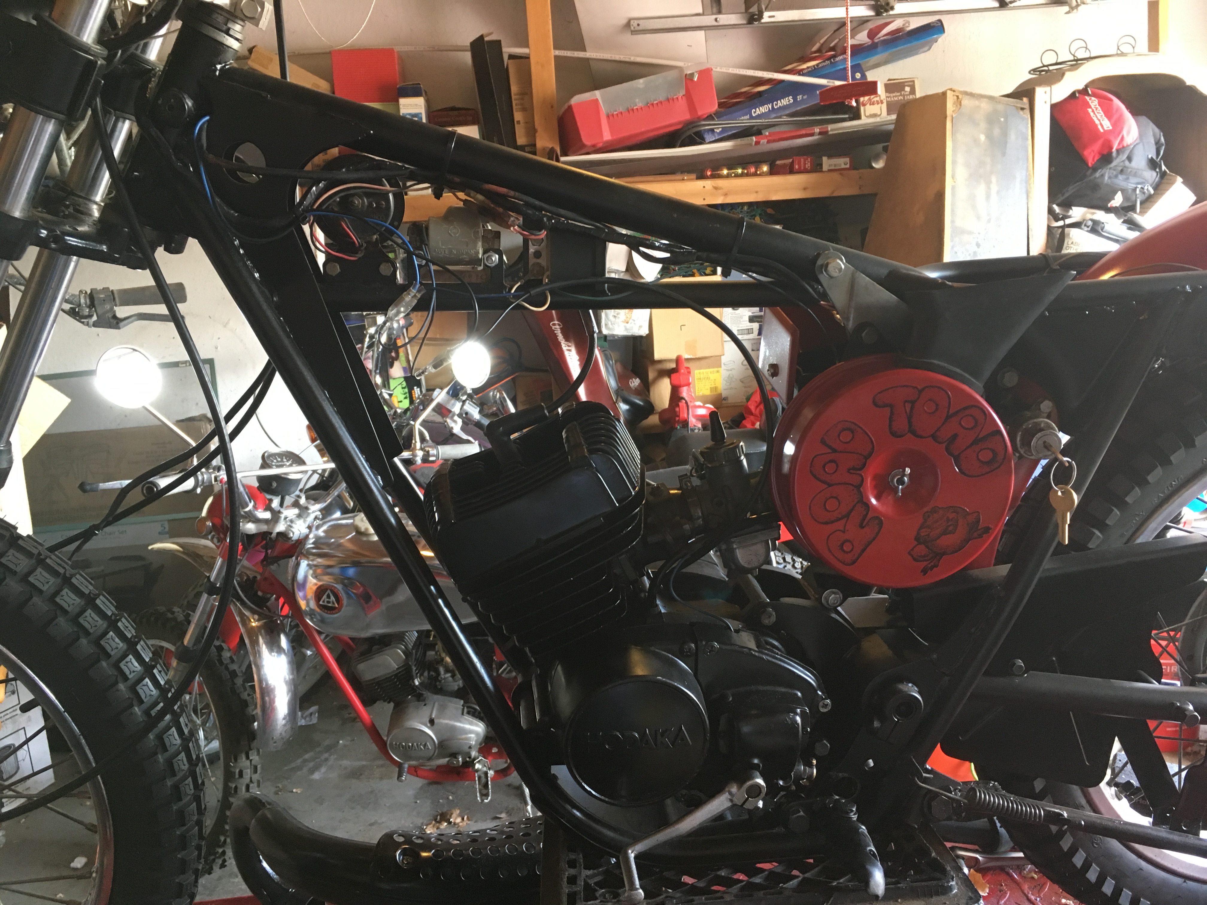

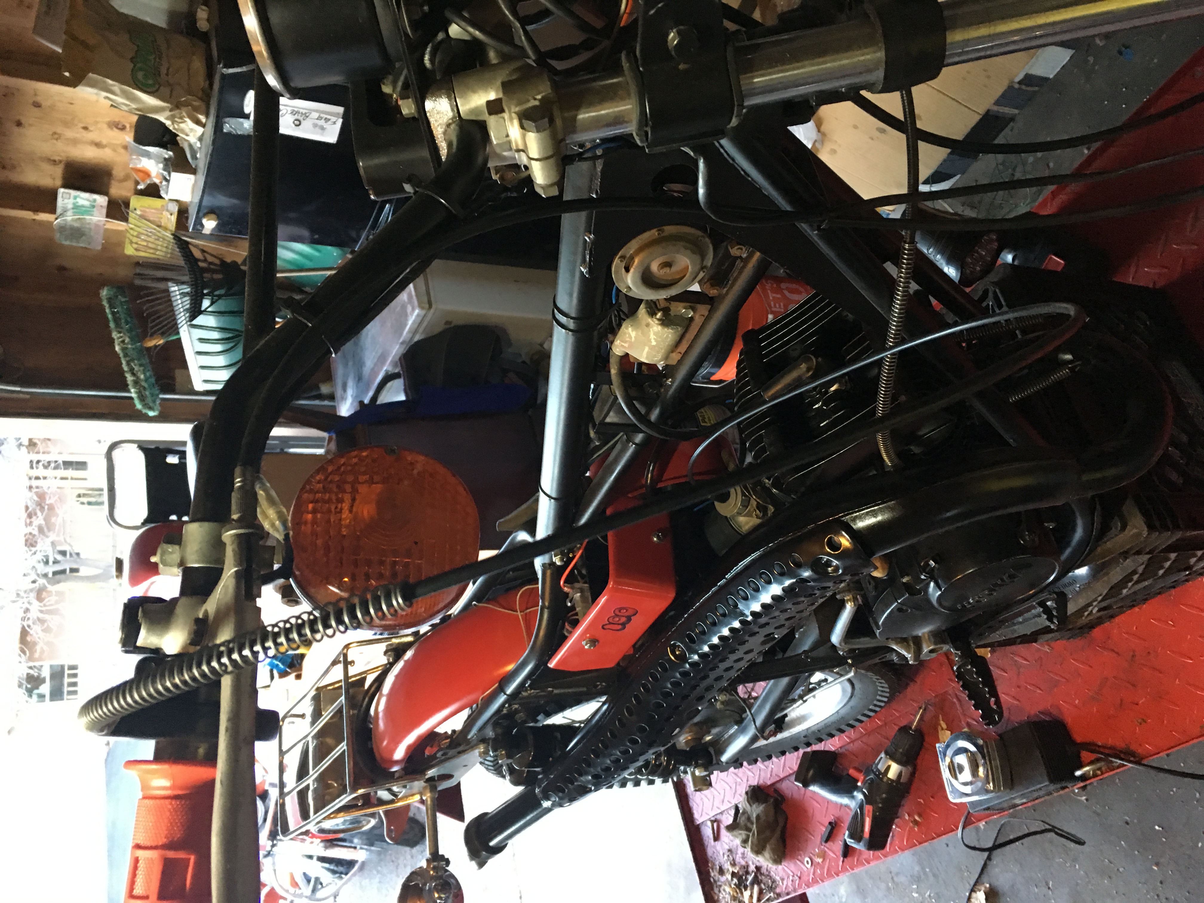

Some new pics! Got the pipe on and the exhaust flange! Also installed the clutch & throttle cables. Put the correct bolt for the castle nut and special washer on the rear brake hub for the brake stay. Need fuel line, a"T" and install the fuel filter. Add the chain, tranny oil and 28:1 for break in and kick that beast over! :mrgreen: Victor!!!

Just got it Victor. I'll get some detail shots and post them tomorrow.

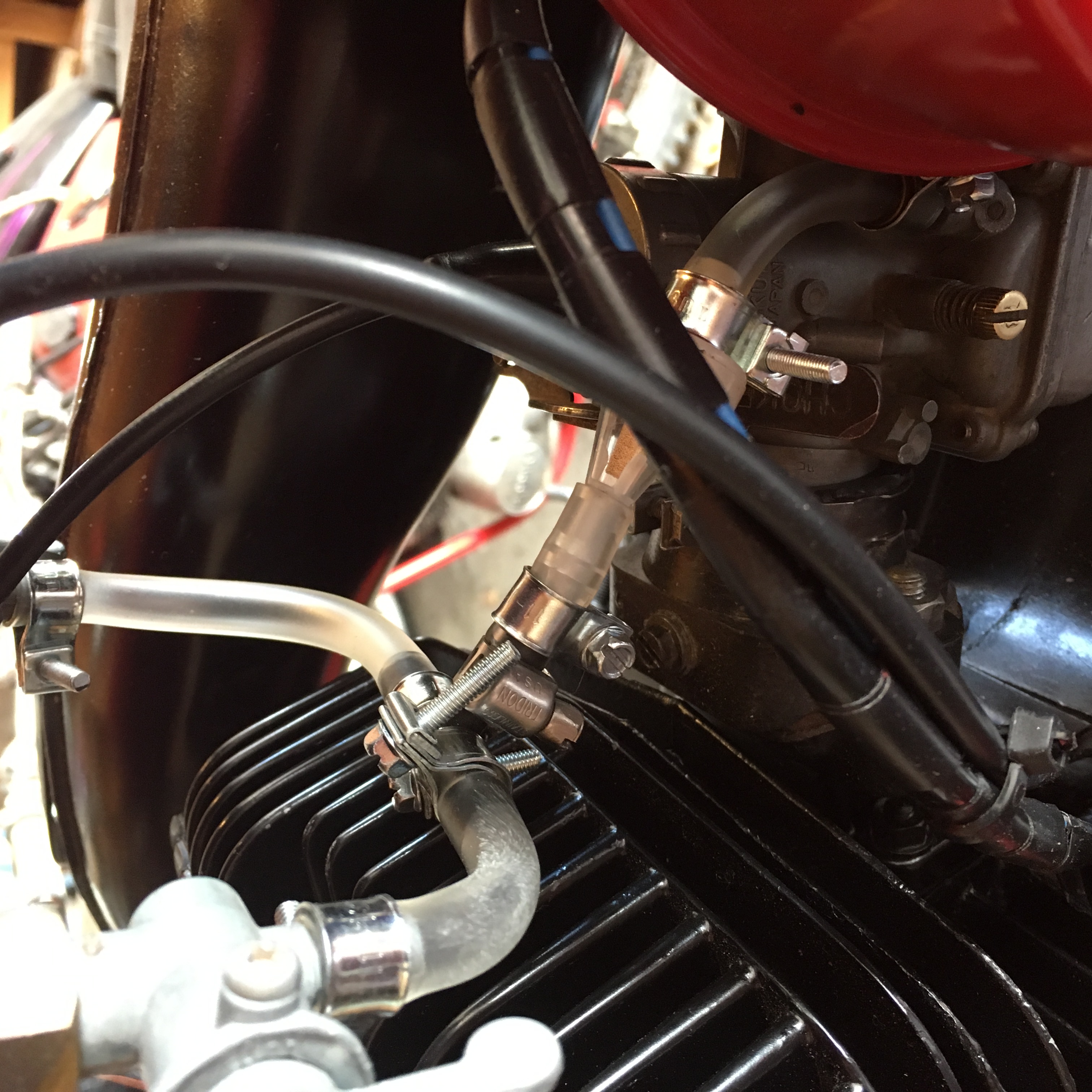

Fuel lines all connected with in line filter. Don't really like the clamps they gave me but they will work for now. :D Victor

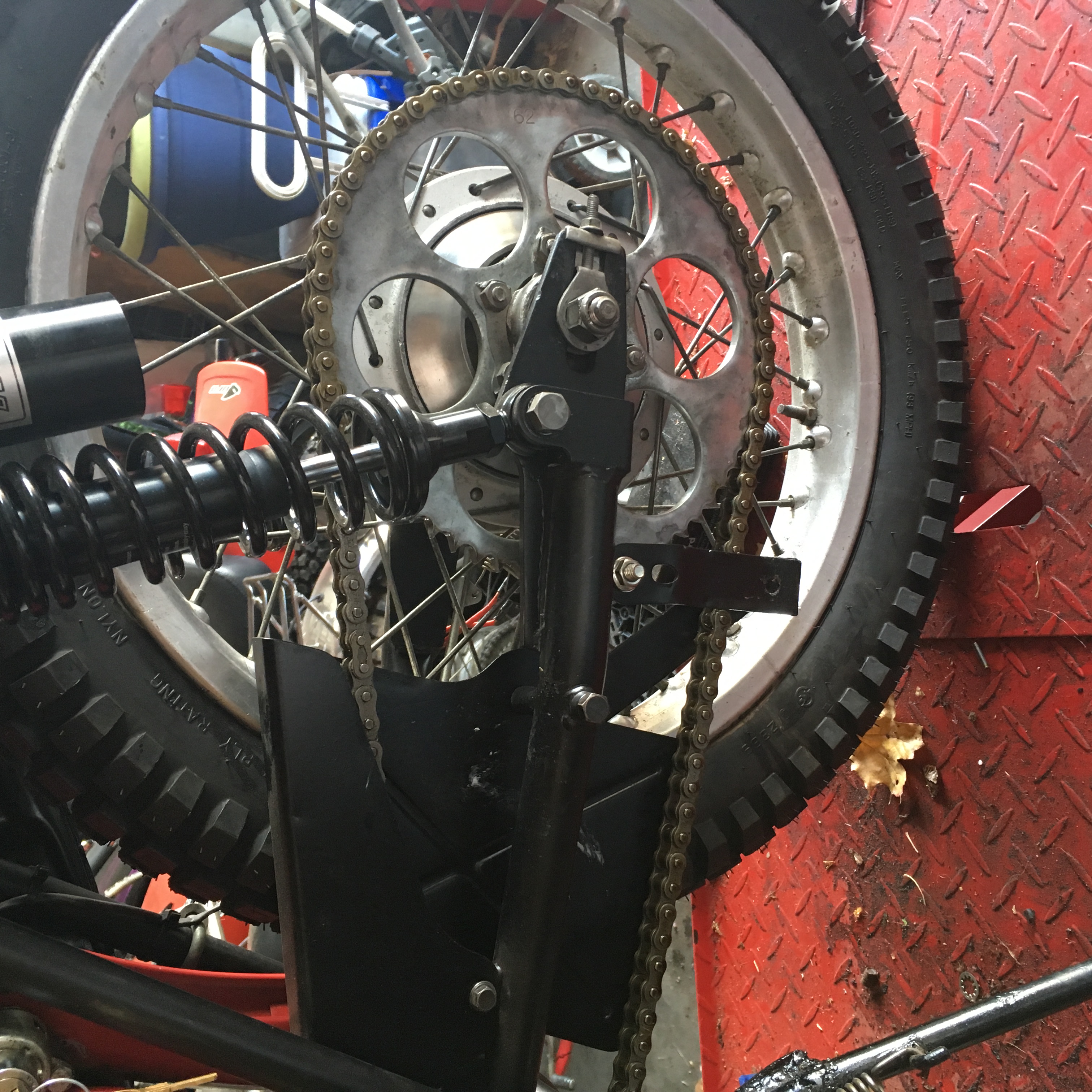

Did my first chain Breaking, instead of taking it to the shop. Bought a Harbor Freight chain breaker & it worked very well! Chain is now mounted and rear wheel center tracking well and axle snugged up! :D Victor

Hey Victor, Here are a few shots of my Road Toad. This is all stock equipment. Hope they help.

Thanks Matt! Your pictures helped me figure out I have the brake stay rod on backwards! :D Victor

Hey Victor, I just thought of something. If you look at my rear brake switch, you can see tiny bolts, nuts, and washers holding the switch housing together with the backing plate that mounts to the bike. Stock, the housing is held together with some type of rivets which, on mine, had pulled through and the whole shootin' match was all apart. I put it back together with the hardware as shown that I was able to find at ACE Hardware. I don't know if this is a known or frequent failure of this particular part. As the switch does see some stress, you might consider preemptively reinforcing yours similarly if it looks like its about to crap out. You should be able to pass these tiny bolts right through the rivets as they are hollow. Just something to consider.
