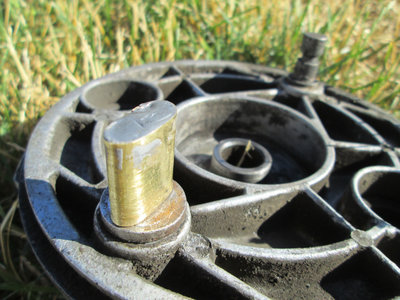

Here's the brake cam built up with a brass sleeve, and JB-Weld to make sure it stays put. It puts the semi-worn brake shoes back into the adjustable range.
The surprise result is that now the braking performance is more powerful and controllable than it ever was before. Before this addition the brake action was weak and spongy, even after breaking in new shoes.
I consider this a temporary mod since I do quite a bit of highway riding and am not comfortable with an additional component patched into the system that might fail at some point. However I think that some experimenting with the brake cam profiles, e.g., crowning/lobing the flat surface of the cam, might yield some improved braking performance over stock.
