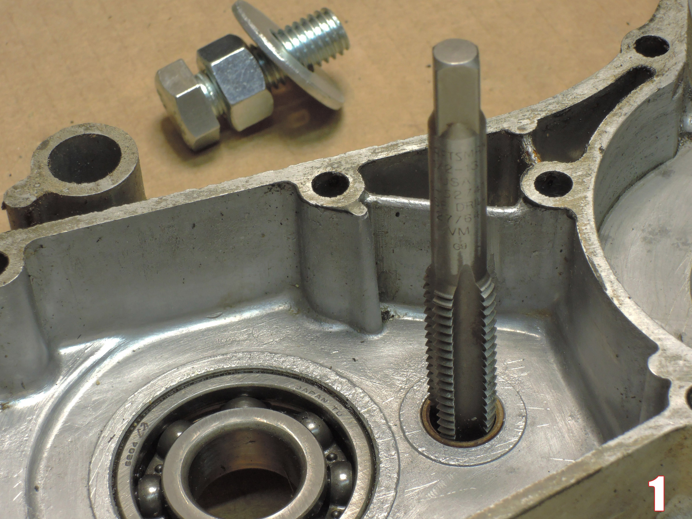

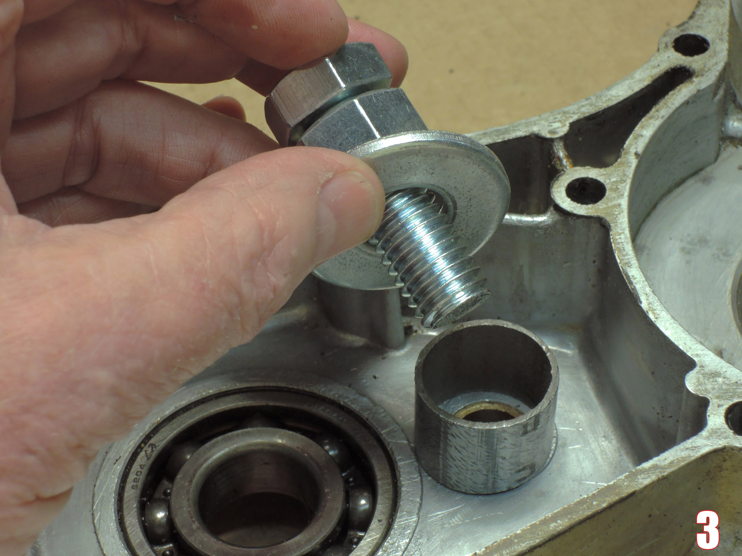

Here's a quick and easy way to pull the main shaft bushing.
The only special tool you will need is a 1/2 – 13 standard tap (#1) and a few things from the hardware store.

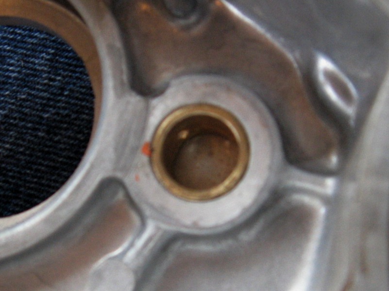

Tap the bushing as shown (#2), about three turns will be all that is needed. You only want to tap about 1/2 the length of the bushing. Don't panic if it's not quite square, it will still work fine.

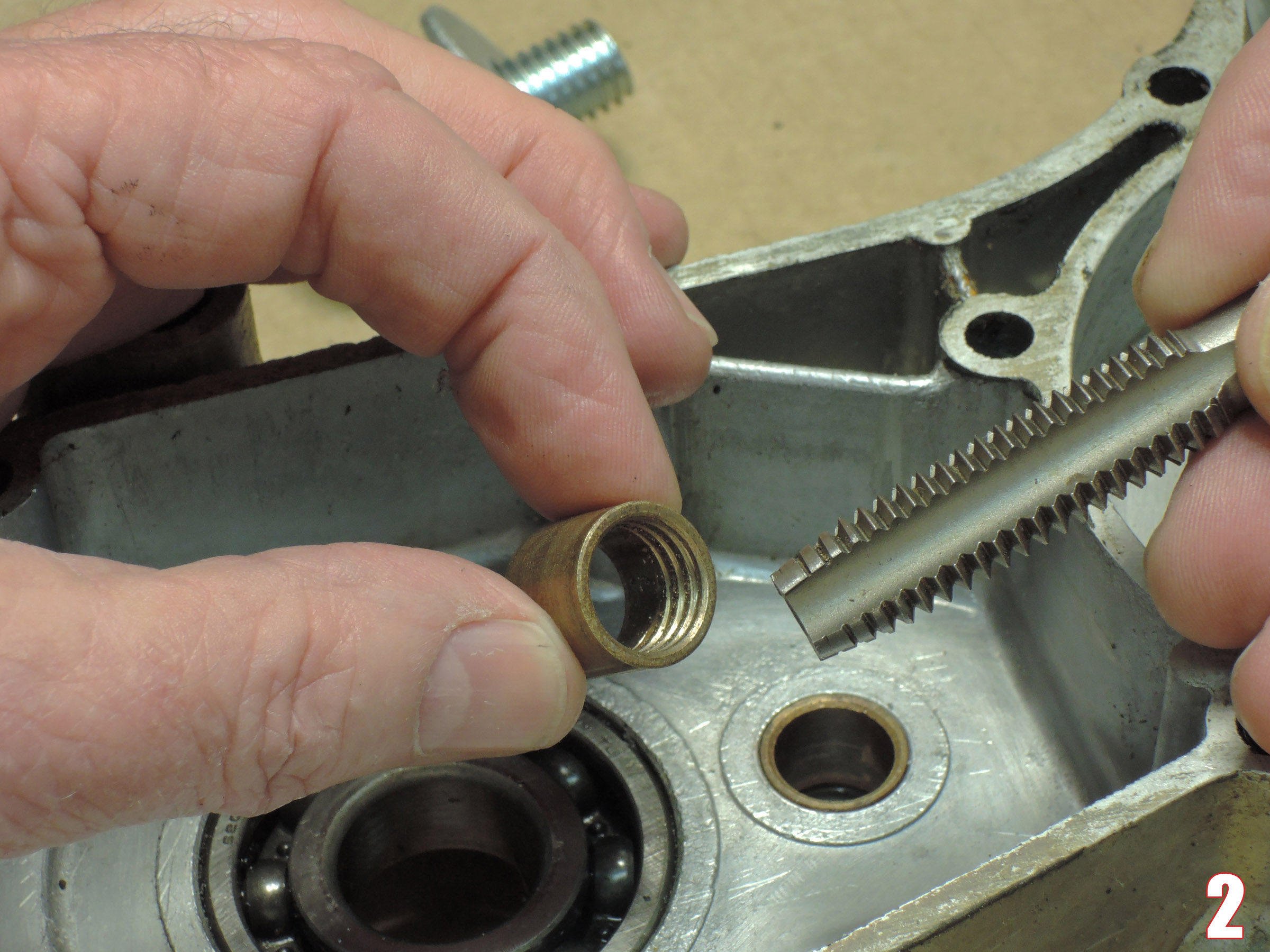

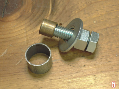

The puller is a standard coarse 1/2 inch bolt/nut/washer and a spacer – mine is a piece of conduit cut to about 5/8 inch (#3).

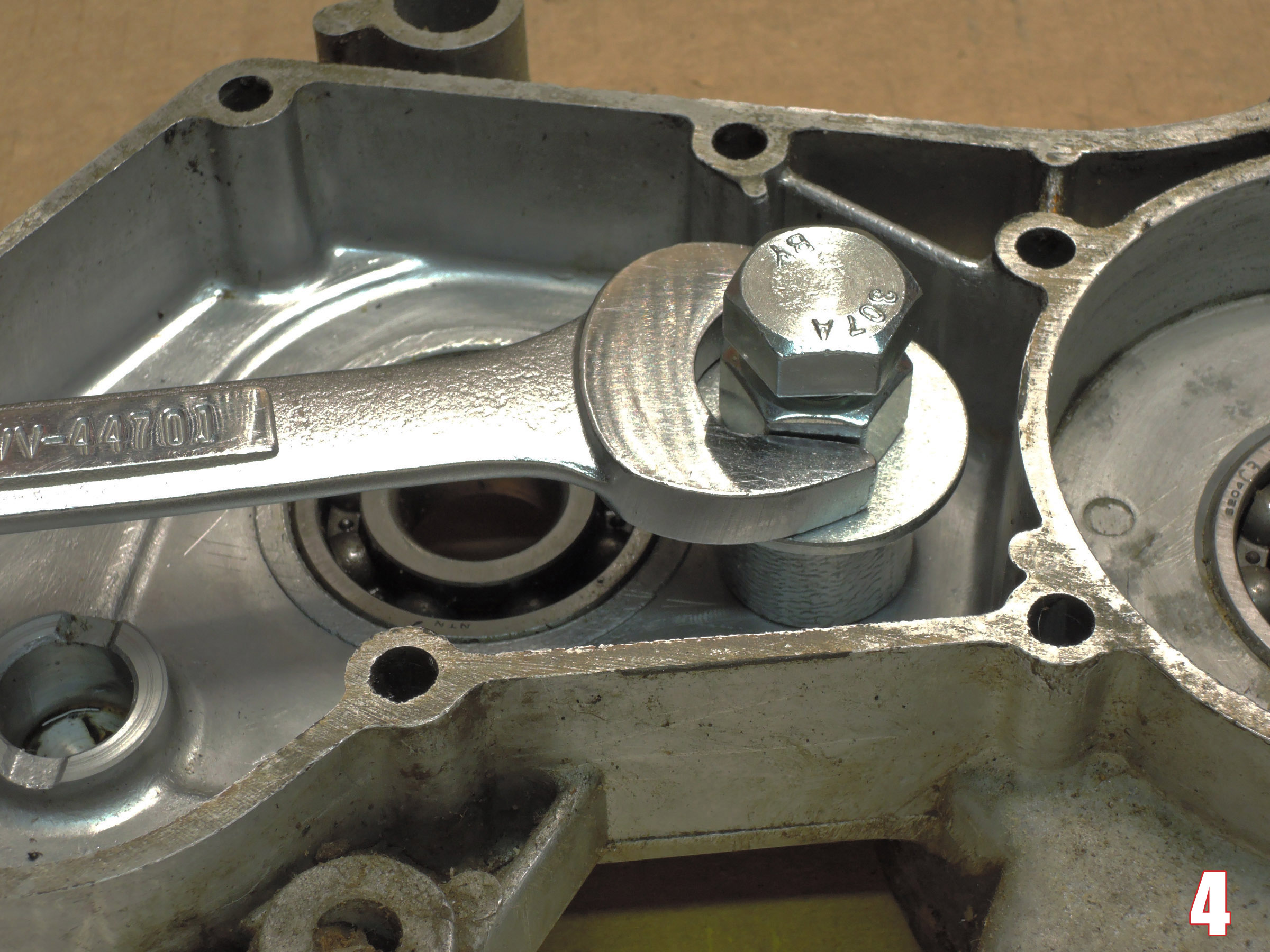

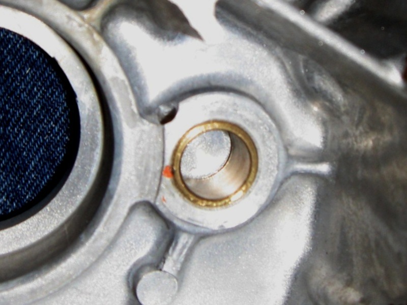

Screw the bolt into the bushing (hand tight) and tighten the nut until the bushing is removed (#4). You'll be surprised at how little effort is needed both tapping and pulling (#5).

Thats how we remove injector cups in diesel engines.

Did you ever try the trick with filling the bushing with grease and tapping the end of the main shaft into it using a non marring type hammer? Pops right out like magic. It's either in the manual or one of those tech tips on Paul's site. Can't remember where I read it, but it works great.
Mike Hawkins

Max, you must be the kind of guy that lays awake at night figuring out how to best do things. This should have been in the service manual instead of the pack with grease and drive out with hydraulics that Mike mentioned. The old method didn't work real well if the bearing was worn a lot. Of course you didn't need any special tools for the old method.
Re: Pulling that Pesky Main Shaft Bushing
Honestly, I've never tried the hydraulic method. I came up with this method years ago out of necessity. You have to admit that this method is more esthetically pleasing than grease, hammers and pliers! (lol). Also as far as 'special tools', the tap can be bought for less than the price of a new bushing. "What ever works" I say!

You can also tap the new bushing for better lubrication , done that for years for automotive trans pilot bushings .
racerclam wrote:You can also tap the new bushing for better lubrication , done that for years for automotive trans pilot bushings .
Rich, can you give a little more detail? So tab the bushing with threads? then put the shaft in?

I am jumping ahead of Rich's answer but it is bedtime. You can also drill an oil hole that can get a little more oil to the bushing.
These pictures are of a Super Combat case and the pictures above do not have an extended boss so it would not be so easy to drill the hole.

You can tap the bushing in the case if your not too agressive , that could spin in the case , then you may have to deburr it since the tap could raise a bit of metal'
