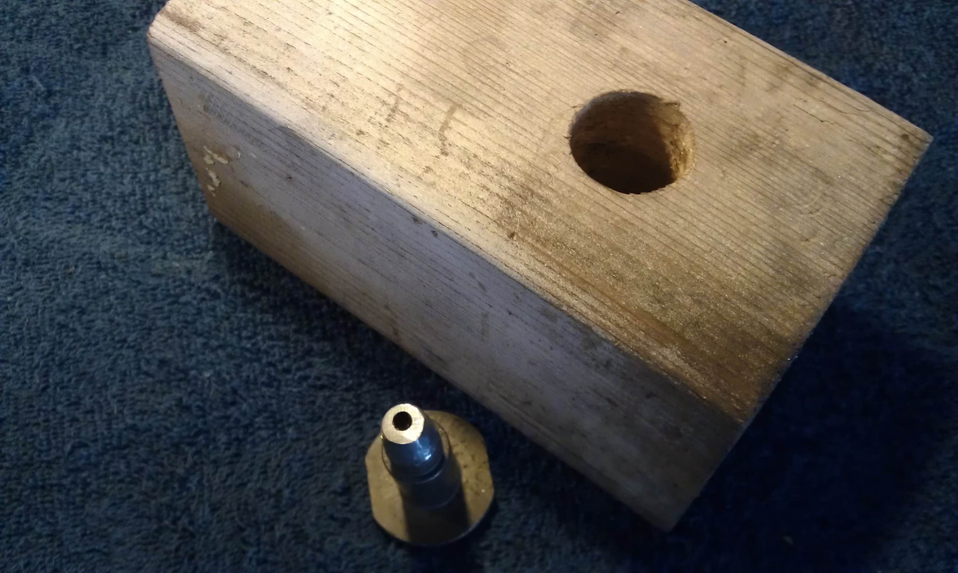

The coin and washer did not work for me because you need to have something that fits inside the counter shaft. May be the coin method works on older models.
What did work for me was that I drilled a hole just a bit larger than the control shaft, length wise in a large bolt. Put the counter shaft into a hole bored into a 4x4 wood block to help hold the unit. Placed the circlip on the recess in the spring stopper and pushed the bolt down onto the shaft. Job done!
