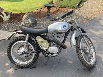

Very recently acquired my dad's CW (1st Gen) that he bought new in 73. I rode this as a kid but it has been in storage now for 35-40 years. It is very clean and complete, just looking to make it trail worthy so figure new tubes and tires would be a good thing to do since it still has the original Nittos from 1973 mounted. I obviously know the stock size and presume the Nittos are no longer being made (couldn't find anything in a quick google search). What recommendations do you of great Hodaka knowledge have for replacement tires? I do have the tubes ordered from Hodaka Parts Inc. Thanks for any suggestions!

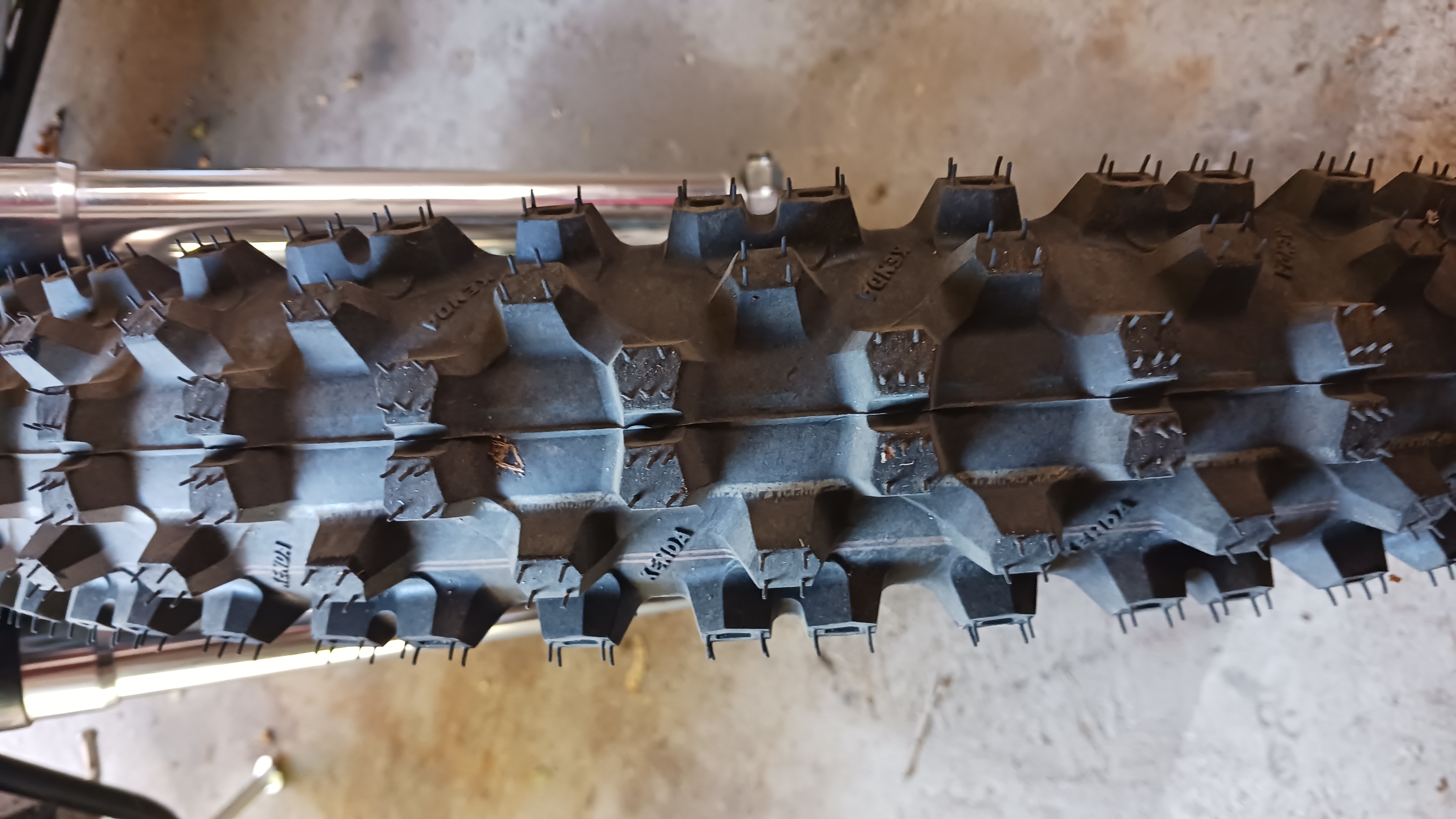

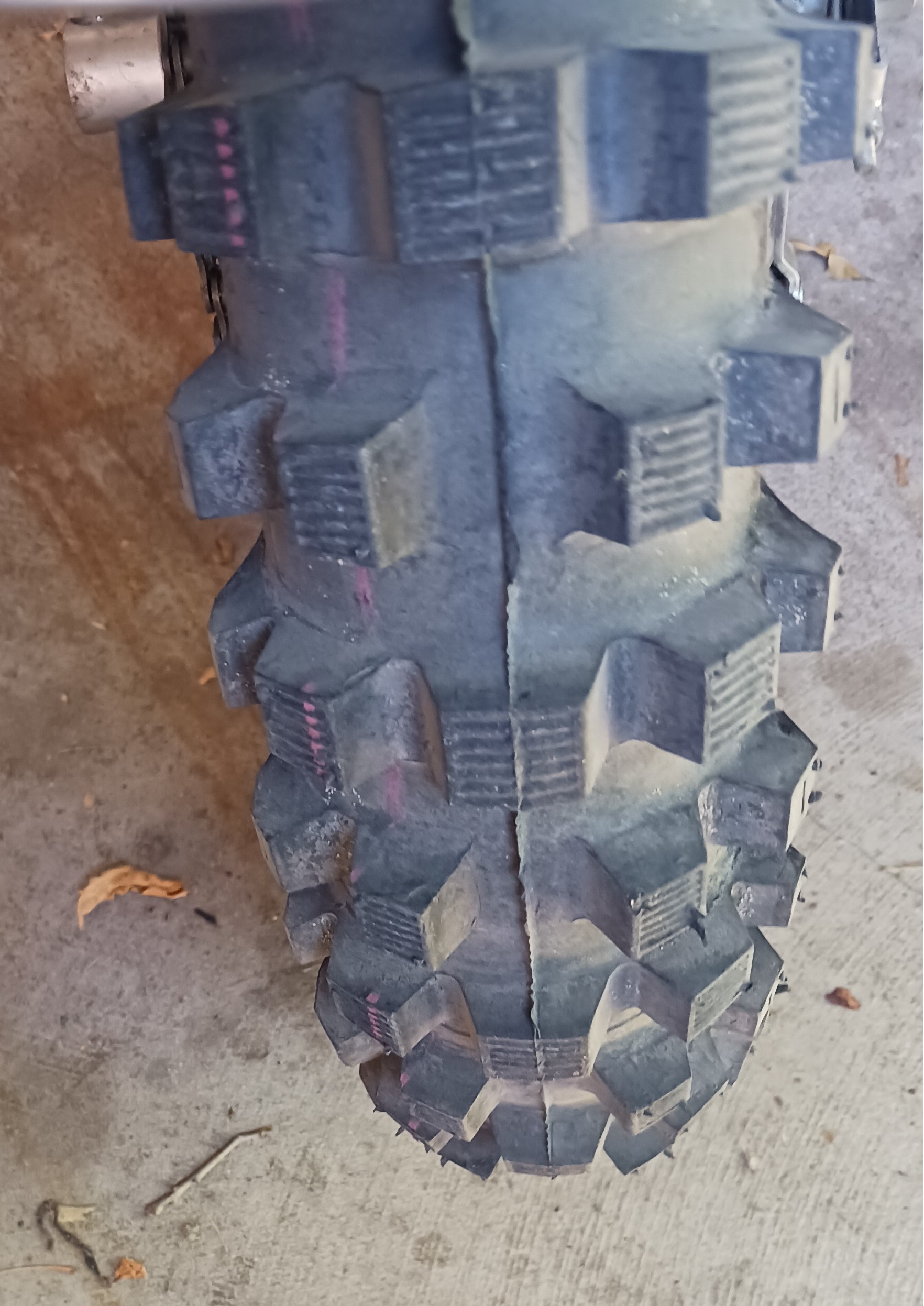

here's what i put on mine and very happy with them .

Great, thanks for the input! No rubbing on chainguard?
