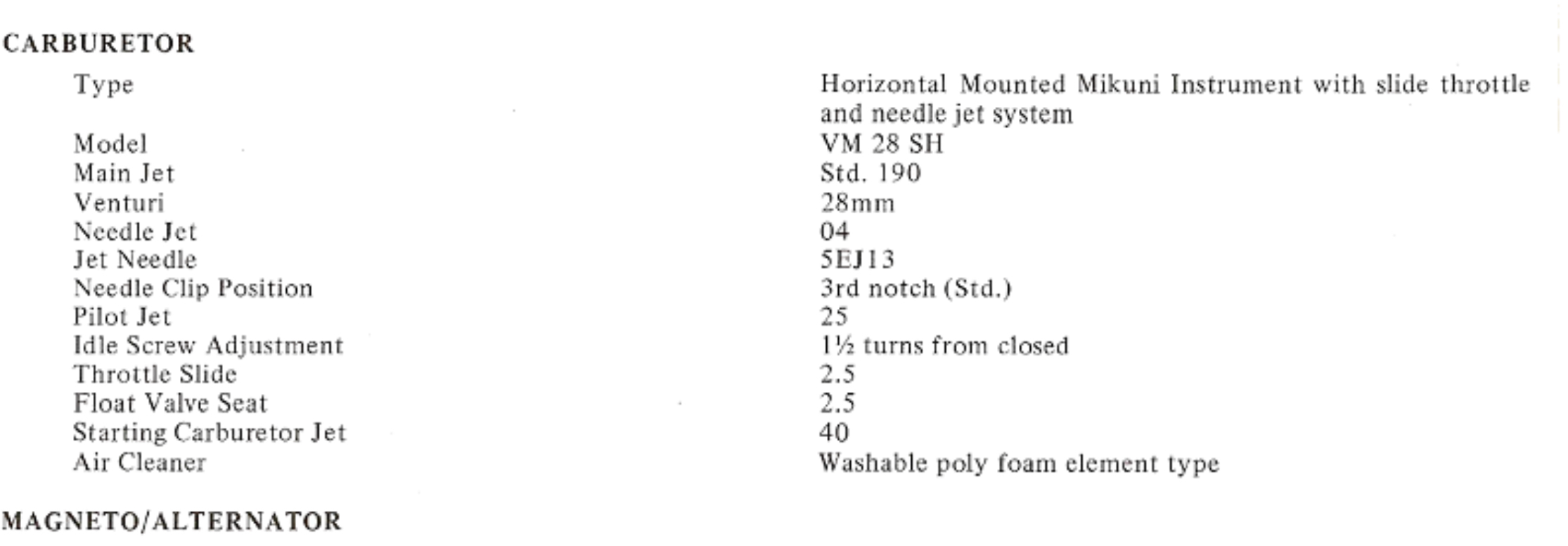

I suspect you may have too small a pilot jet, or possibly main jet, in your 28mm carb. Here is the stock jetting info for a Combat Wombat with a 38mm carb. Double check everything! Hope this helps!

This Carb I got from Hodaka parts came with the stock jetting that Victor describes.
The carb is an all new 28mm mikuni spicket (including slide) that comes with a flange adapter from Hodaka parts and is supposed to be set up for model 95. I know for sure that there is plenty of fuel to the carb and the float valve is not leaking. The motor is not loading up at all. The floats are adjusted paralell to the carb body and that is the only adjustment spec that I know for these carbs and they both came that way. I have gone up from a 25 pilot to a 27.5 and then a 30 I have not tried going leaner than stock because it already seems to lean. Also went up from the 190 main to a 200, although I don't think the main jet has a lot of influence to the part of the power band I am missing. It runs great at the top of the power band. Also, I am at near sea level for altitude.

Well, I went back to my notes on my current carburetor settings. I have 2 Combat Wombats with OEM carbs and they both run the 2.5 slide. However, my track Combat Wombat, with the replacement carb setup, runs a richer 1.5 slide! In my notes, I was chasing an off idle lean condition as well. Hummm, I think this is your issue!!!

My notes showed that I had also tested 2.0 and 1.0 slides. The 1.5 was the ticket.

I could only find a 2.0 so far so I ordered that. It should at least make some difference.
