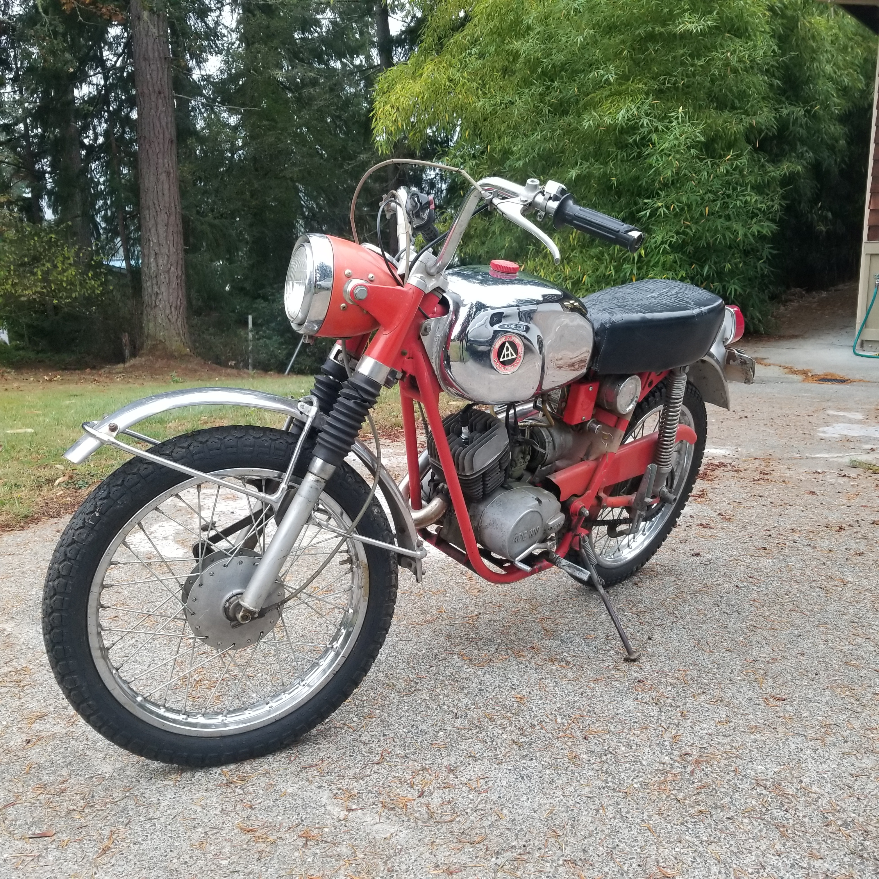

I acquired this Ace 100, model 92, from a guy who bought it from Jim Pomeroy's widow, Linda, a while back. He had it sitting and did not touch it.
Frame no. A18450, engine P21084. I think this same bike is pictured in the Hodaka book with Pomeroy working on it in a shop, but I could be wrong. It's in remarkably decent shape given that it is likely a '67. I plan to clean it up, replace worn parts, but keep the original paint intact. If anyone has any other intel on the history of this bike, I'd love to hear.

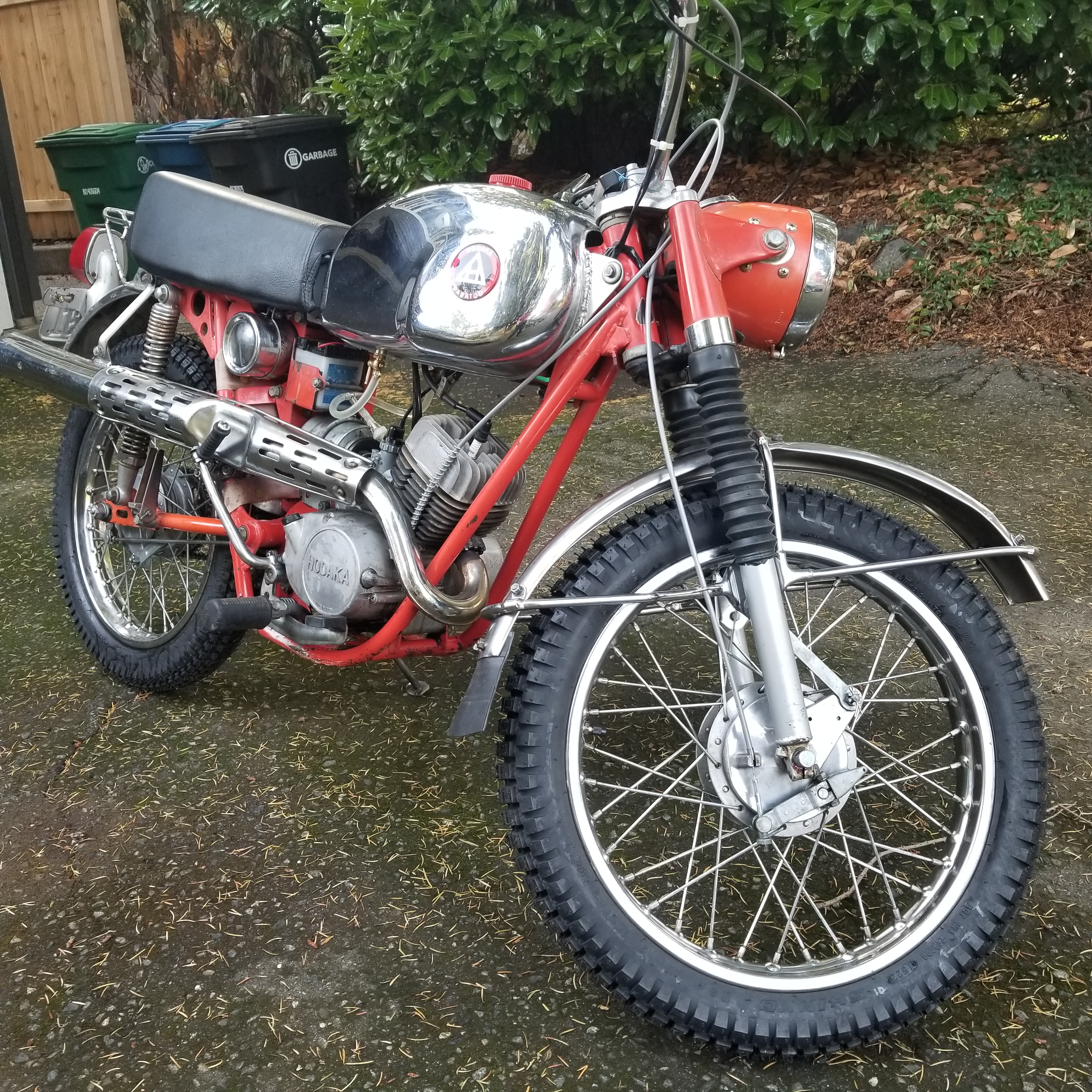

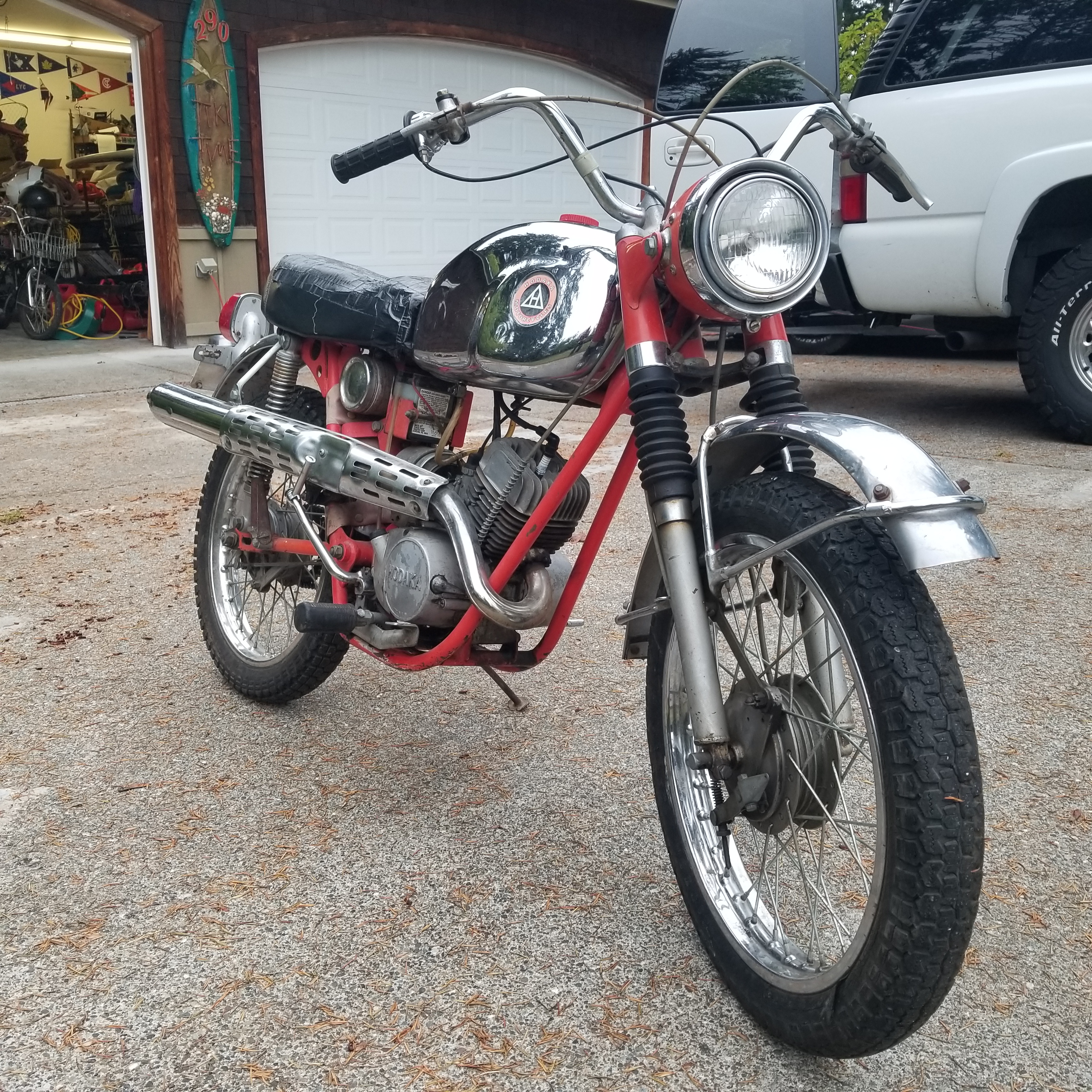

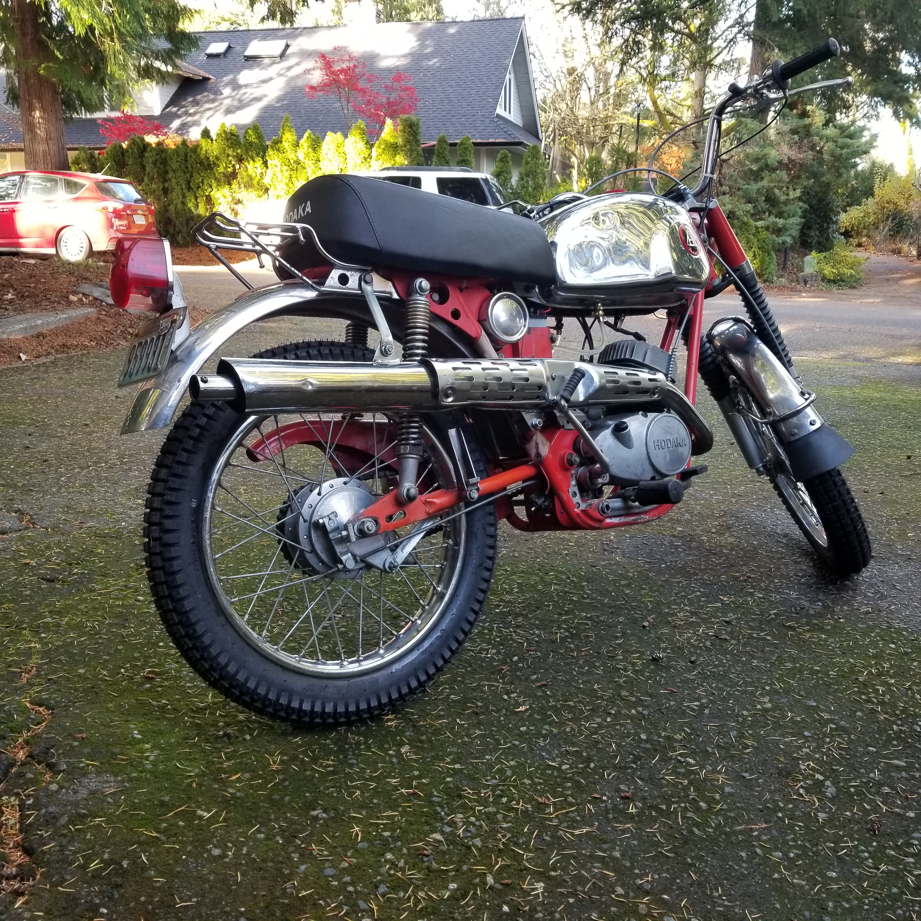

Here are a few current photos of the Model 92 following my cleaning and disassembly of many components. Installed new tires, seat, fork boots, and cables. Runs like a champ.

Looking good James. New cables, foot brake rubber pad and gas line.and the seat really sets it off. The clutch cable should route under the tank. I will call you. ----------- Clarence

Clarence: Yes, please call with your wisdom about the routing of the cables. The clutch cable needs to go "under" but I'm not sure which way to feed it. Easy enough tweak. I also added a 50-tooth sprocket that Bruce Young supplied. Thanks for all the compliments. James
