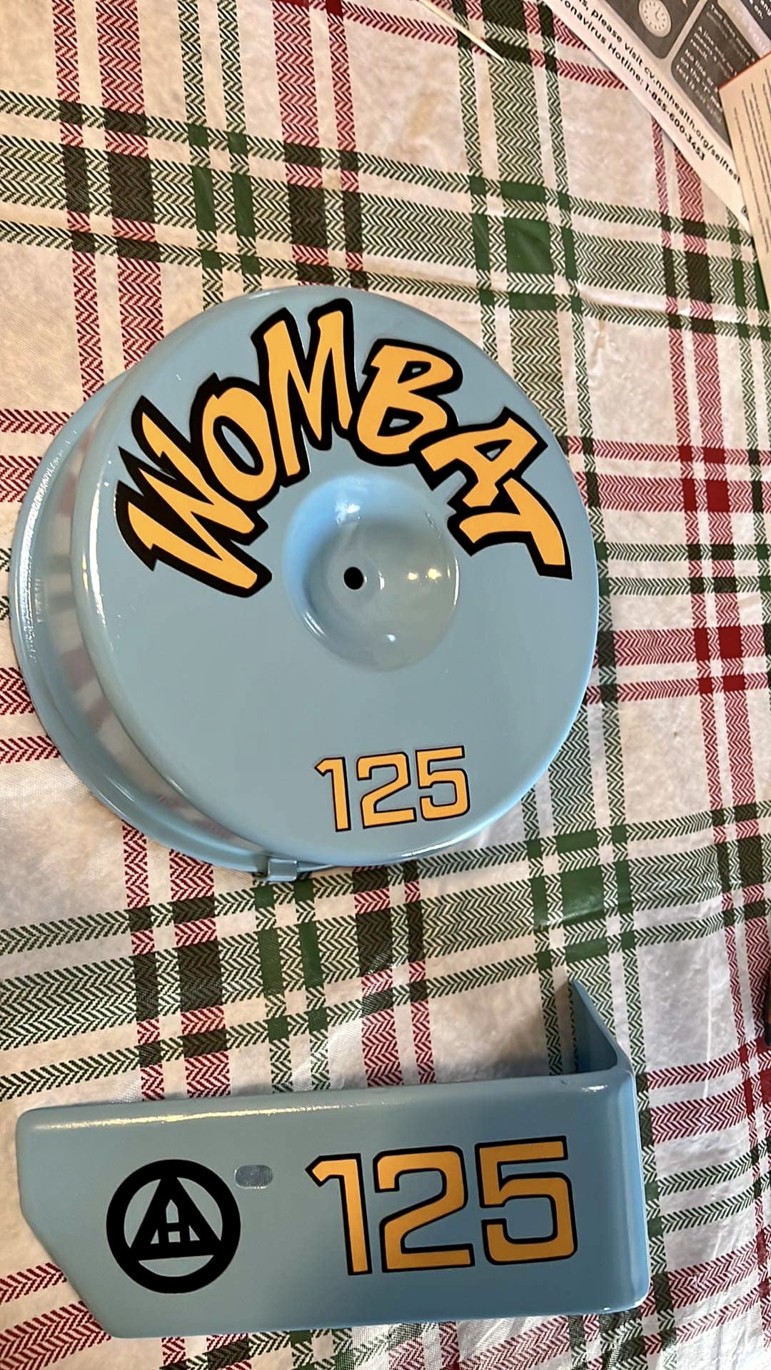

I got some decals on the battery cover & air box cover! I think the colors look good together! Had do some some color sanding on the tank. One more coat of blue & then I can decal the tank as well! But here’s a first peel!

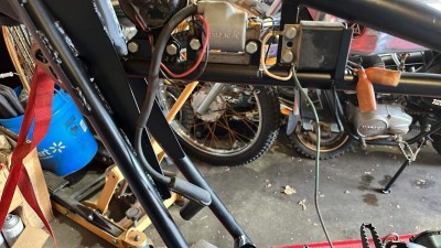

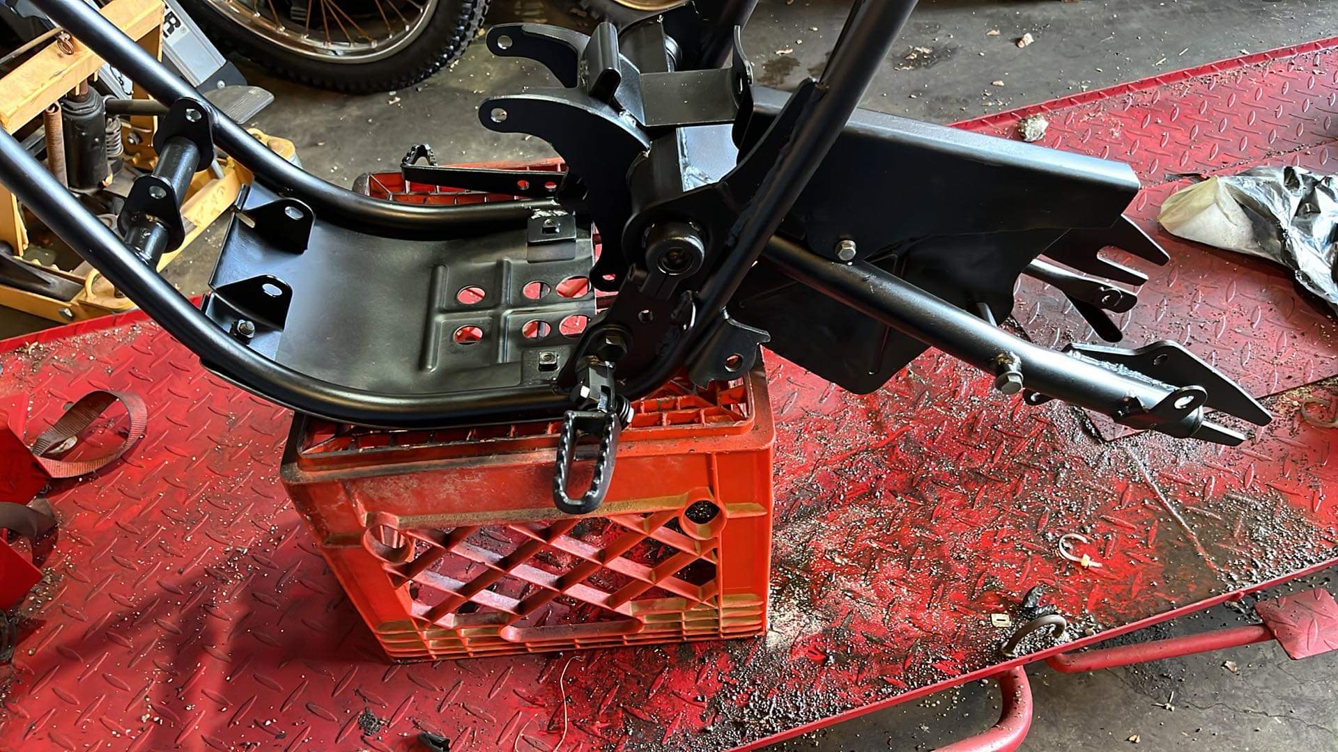

I also did some minor frame assembly work today. Not a lot because my toes keep getting cold from the concrete. But at least a little!
Mounted horn, ignition coil, voltage regulator & also the chain guard and bash plate. At least a few things got done…

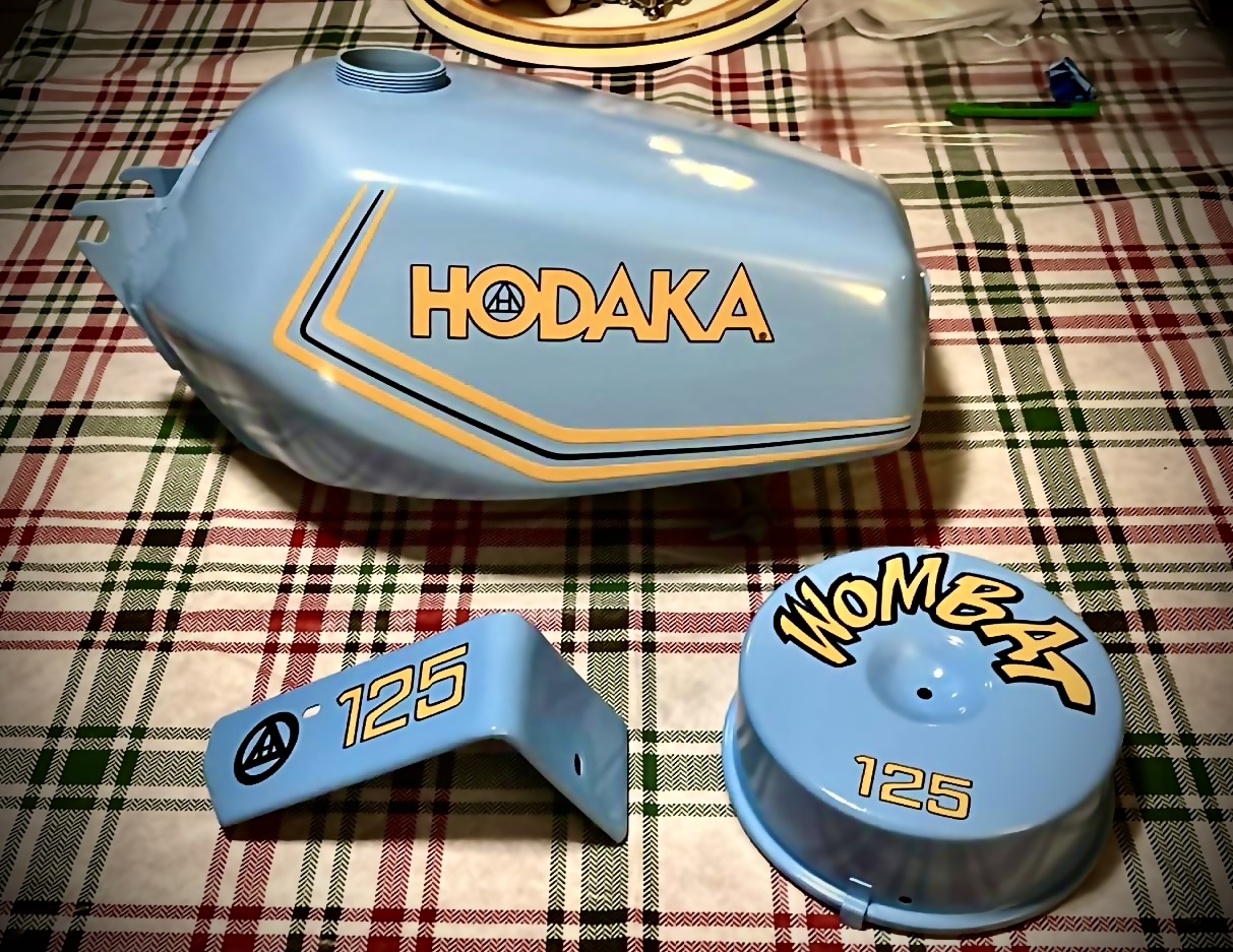

I finished the color sand and final color coat on the tank earlier today! And I just finished the decals on the tank now! Here’s the 3 pieces! Hopefully clear coat soon! It was 58*F today, but snow is predicted for tomorrow with only a high of 37*F. No. Lear coat tomorrow.

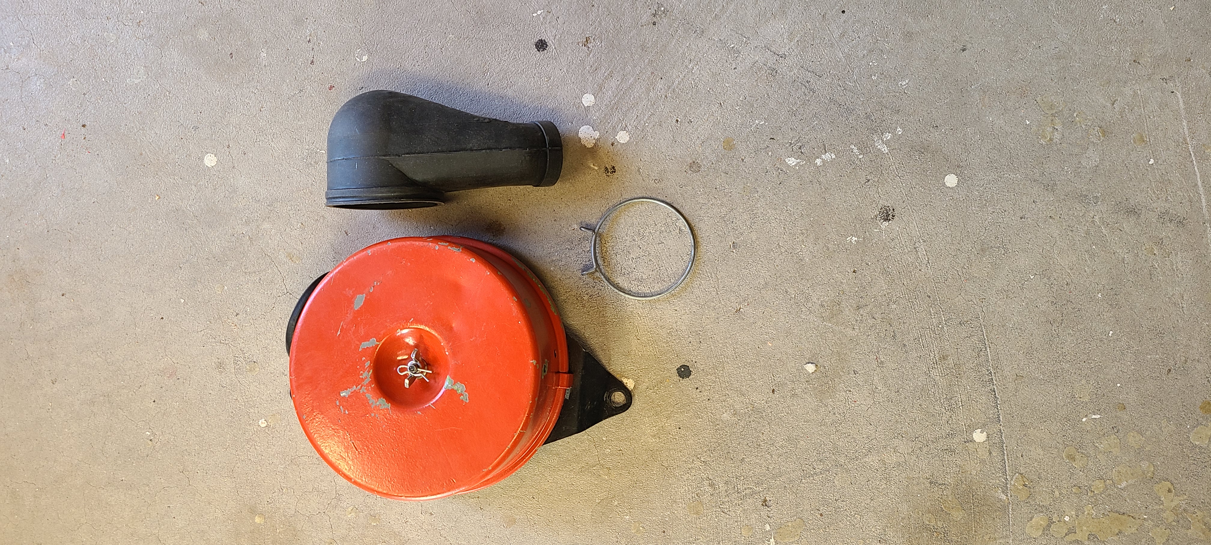

Re: Wombat Side Mounted Aircleaner
I also have a Complete Wombat Aircleaner, Filter, Rubber "J" connector Pipe, and Spring Clip.
Since I am using a Battery Box / Key Ign. Switch, I have to use the Old Original Aircleaner.

Nice! Maybe offer it on The Hodaka Fan Club page!
Re: A New Project Bike!
I like the color ! I think it will look great when it’s all together.
looking good victor. did your battery cover come with the bike or did you have to find one.....albert
I bought a used Toad cover from Bruce, as it was missing. I did have the entire air box, just need to order a new filter & ring from Terry!

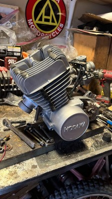

Got my motor back from the vapor blaster. Ready to start motor rebuild!

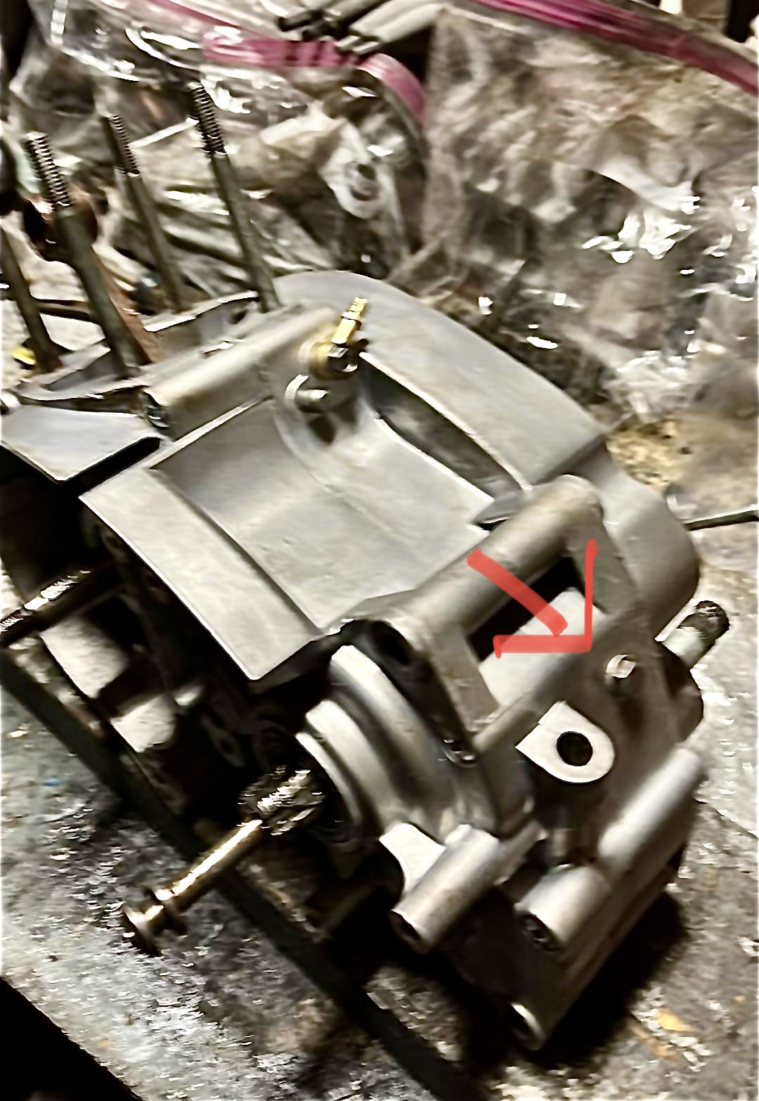

Got my bottom end together last night. Today I put on the clutch assembly and installed the kick lever & spring. However, I found that the thin, unthreaded part of the idle gear retention bolt (#49) broke off and the idle gear is floating in the tranny! So now I have to wait for a new retention bolt to arrive.

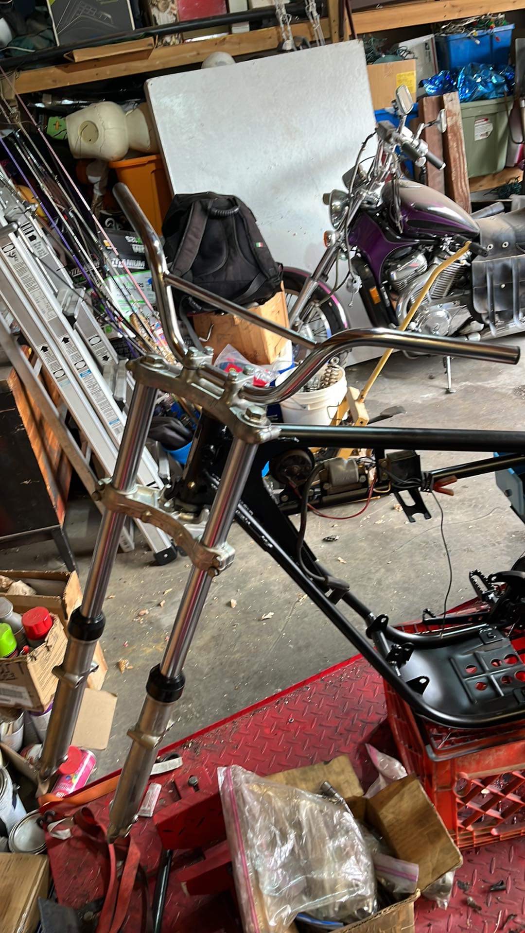

Got my parts in the mail from Terry! I can now finish the rebuild on this 03 motor. Also finished the front fork rebuild. And the triple trees & forks are back on the frame now, along with bars, perches and dual cable throttle!
I also cleaned up and installed the rear rack & tool box on the bike, thanks to missing parts from Bruce!

Got the motor together but I’m not real sure about this counter shaft. I may open it again and swap it out. Seems every time I put the sprocket nut on, it gets really difficult to turn.

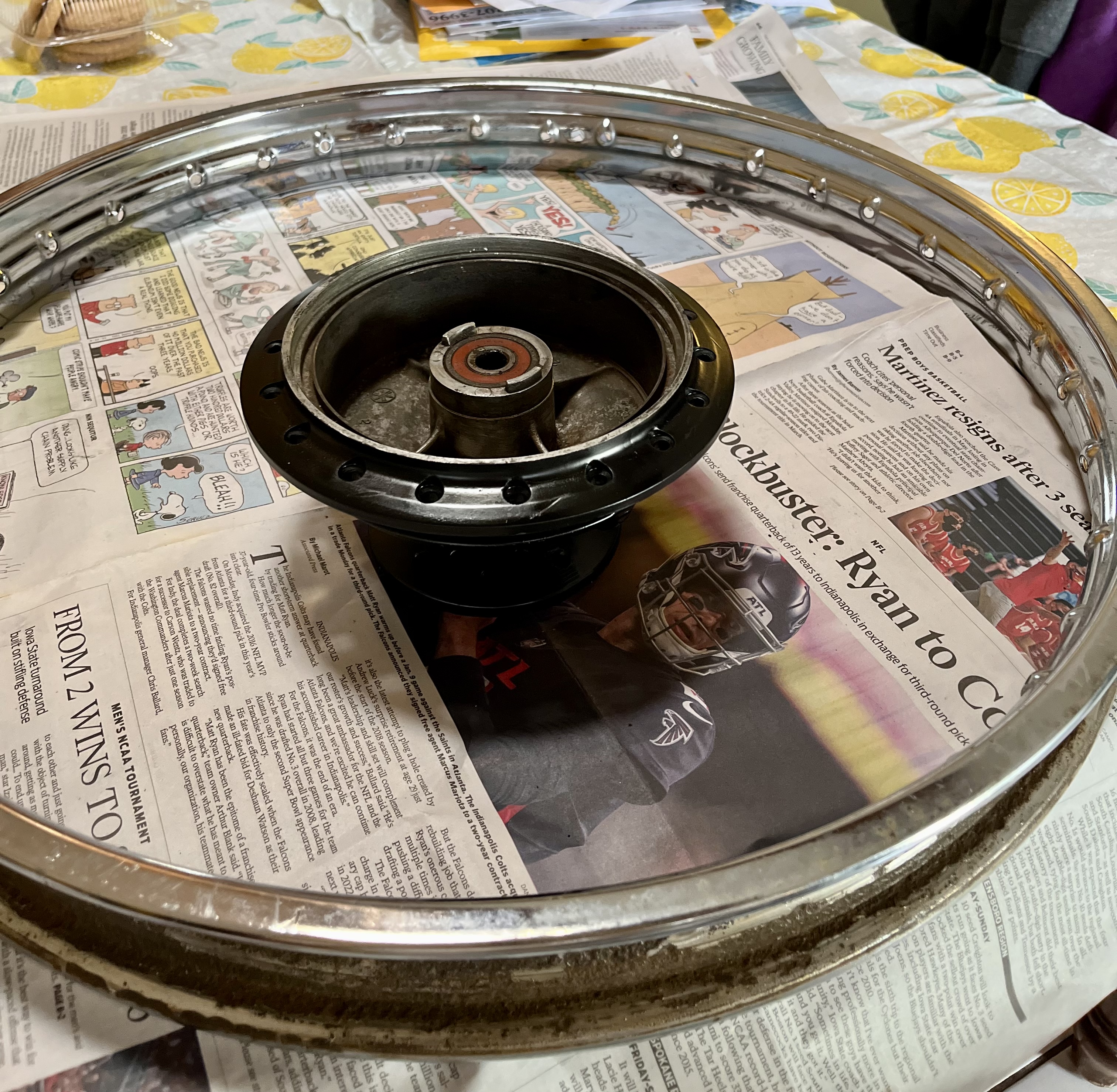

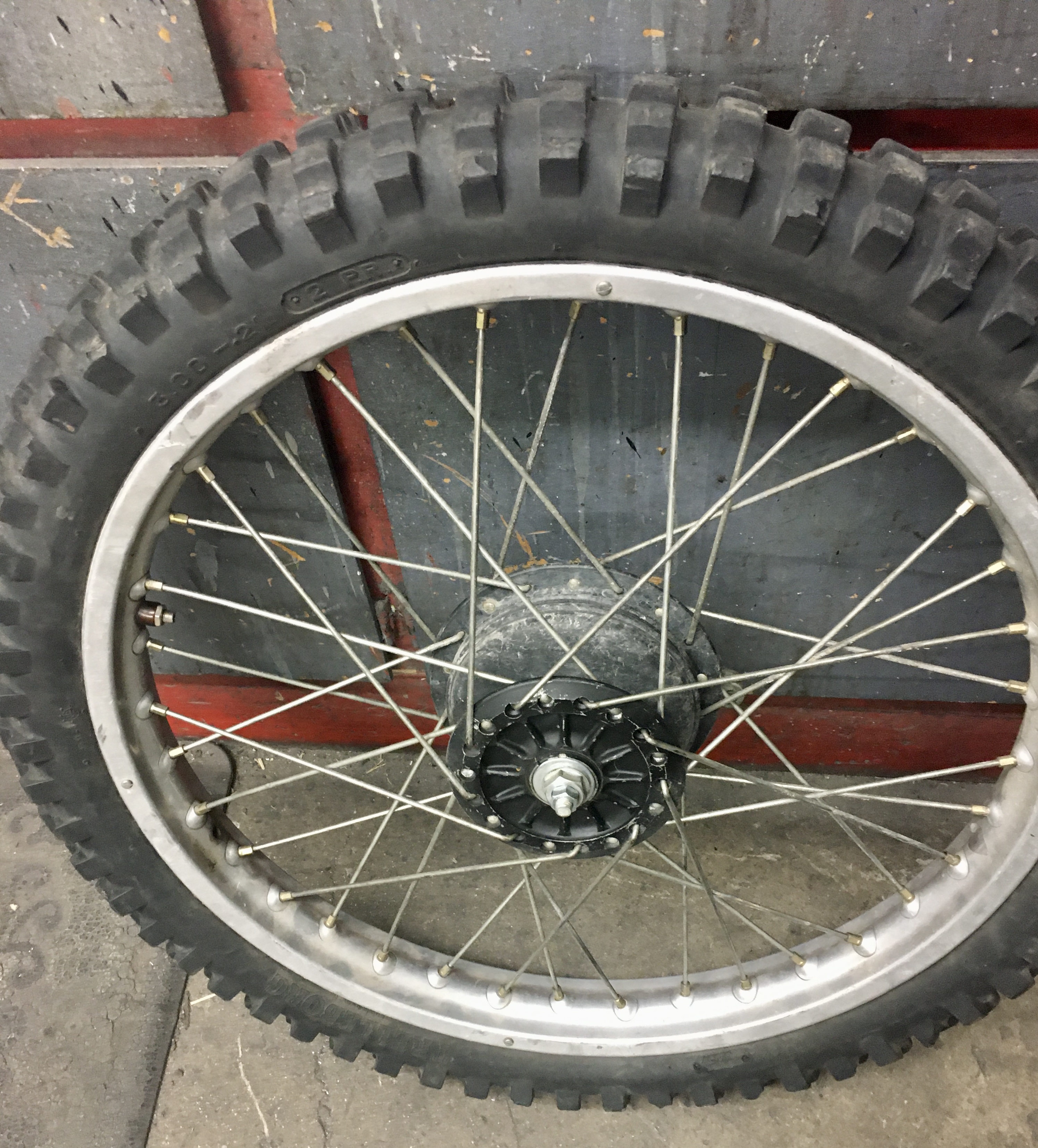

Talk about frustration! I was working in the front wheel I received with this Model 03 Wombat. I decided since the mud catcher rim went so well, I would cut the spokes off the front wheel, clean and polish the chrome rim & clean and paint the hub, and re-spoke the front wheel. All in all, I put about 3.5 hours into this wheel.
Then I realized it had a conical hub and the spokes I had wouldn’t work. I messaged both Terry Larson and Scott Hatch to see if they had replacement spokes for an 03 front wheel.
I was talking on the phone with Lee Fabry, about spoking a conical hub. Then I asked Alan to send me a pic or 2 of his 250 SL wheel since they were supposed to be the same.
When I saw Alan’s pics, I reslized this wasn’t an 03 wheel. Looking closely inside the brake insert if this hub, I then saw it. A Yamaha logo as well as a part number. Turns out this wheel was for a Yamaha DT 125 and not an 03 Wombat!
I told Terry & Scott and they both told me they would check to see what they had and get back to me on Friday.
As I stated, I had also been talking with Lee Fabry about spoking. When I told him in a message it was a Yamaha wheel, he told me he thought he had an 03 front wheel he didn’t need. He text me a couple of pics. I asked what he wanted for it, and let’s just say it was less than the cost of a set of spokes!
I told him to remove the new knobby tire which was on it because I had a matched set of Enduro tires going on this 03, and to keep the tire and backing plate to save shipping weight, because I had 2 backing plates as well! Lee mailed the wheel this morning!
And, I have a friend who wants the Yamaha wheel & I told him he could have it for postage!
Here’s the wheel Lee is sending me, as well as the Yamaha rim & hub. Crisis averted!!!
