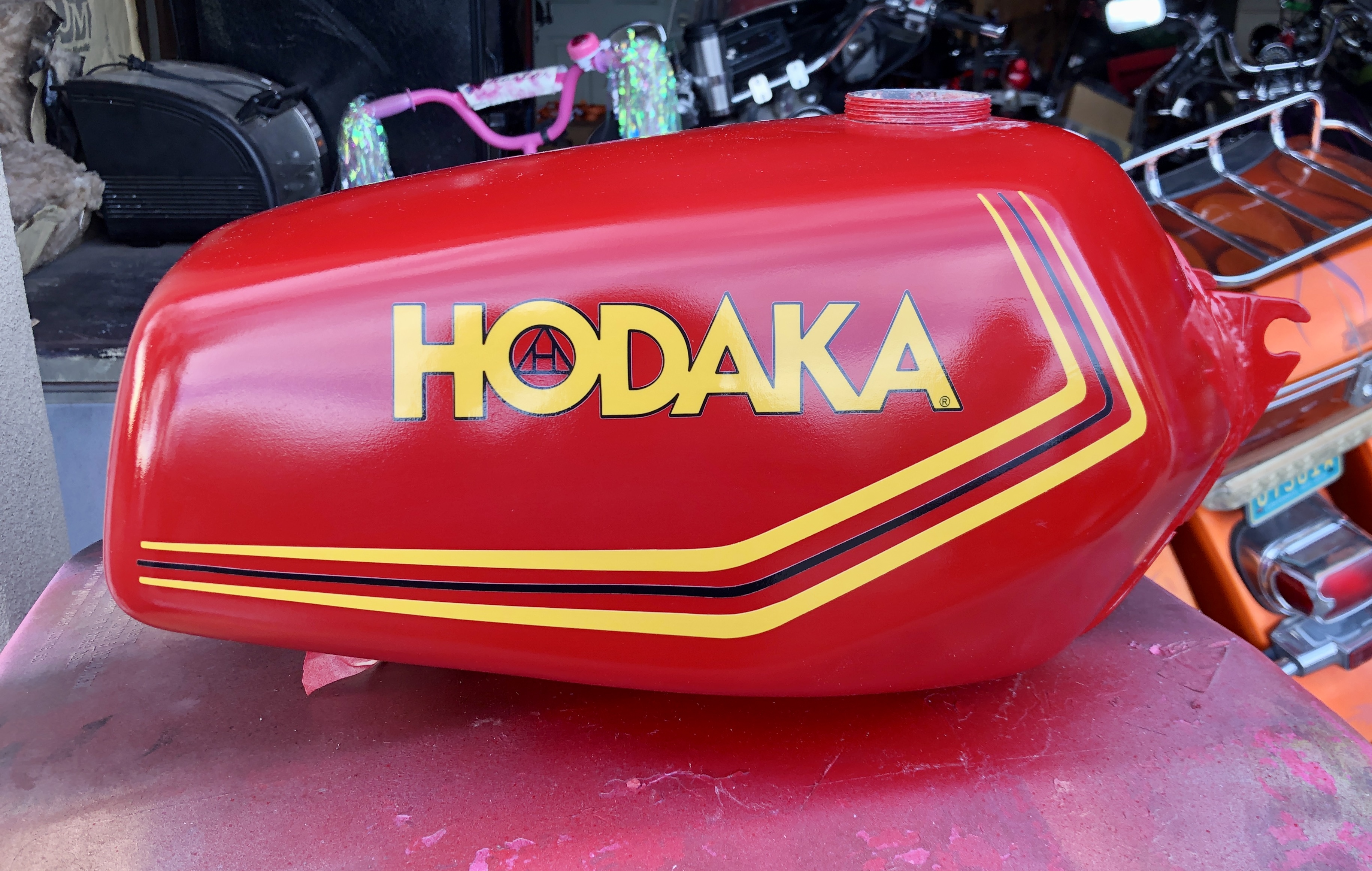

I have settled into this paint for the red frames. This paint & primer in one matches the Rustoleum Safety Red exactly, but it applies easier and second coats without crackling.
For black frames I like the Rustoleum Satin Black. Same type of paint, seems to match the original black frames as best I’ve been able to find!
On my 03 Wombat I used Chevy Victory Red and the matching clear coat to go over the decals.
:ugeek: Victor

Nice pictures Victor a talent beyond me. To my memory max's colors are spot on, I will try and post a picture of one of my pieces, ---------->Clarence

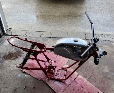

Alittle updated progress was made
Also Needing to source top triple tree mount as it’s broke
