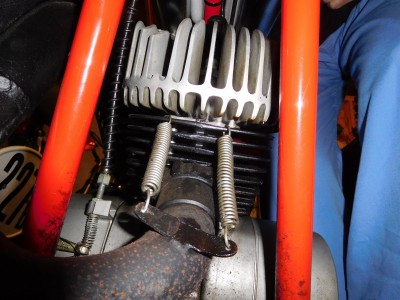

I have this nice Webco head with three broken fins. Does this significantly impair proper cooling? Regardless, I'd like to have it repaired. Suggestions?
Re: Webco head repair
I don't have answers to your questions. Sorry. But I did want to comment that it appears someone cut the fins to run a high pipe. Is that possible?
Hey Dale, Maybe if it was just the two fins. I see the "tunnel"effect. There's a third fin knocked off almost at the base. I'm having a hard time imagining a scenario that would result in that kind of damage to the sheared off fin- other than some dude trying to rock the head off the jug with a pry bar. Maybe true/true and unrelated.
Ah, I see the third fin now. Dang!
