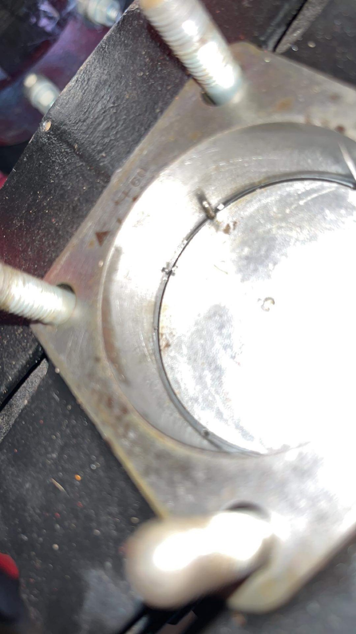

Today I pulled the cylinder, piston & ring from the unit which was giving me only 85 psi on my compression gauge.
Here’s the measurements I got.
It’s a .020 piston
Piston to cylinder gap is .005
Ring gap was .012
(about 1/4” down from top of cylinder)
Ring gap .011
(With ring just above exhaust port)
Cylinder taper .002
As I stated early on, it seems everything is within clearance tolerances. Minimal taper, good piston to cylinder gap, and a little higher than best for ring gap but not unacceptable.
Any thoughts? :ugeek: Victor

Well, I pulled it all apart today. Some of the measurements don’t make sense. It seems to be within tolerances based on the measurements I posted. However, I think the big issue is irregular tapering of the cylinder. This is causing the piston to stick a bit.
So, I packed the cylinder, piston & ring up for shipping & im sending it to Terry tomorrow for a Hodaka Dave inspection and whatever work Dave says it needs. I’m sure it will come back from Dave ready to run, just as stuff always has. Then I can get this bike shipped to Florida!

I tell you this bike is cursed for me.
I got the cylinder back from Terry on Monday. I put the piston on while the bottom end was still on the bike. Cylinder on, head on. Head nuts torqued.
Motor kicked over much easier now that Hodaka Dave did his magic. Kicked it several times. After about 5 kicks Brup Brup. Kick again. Brup, brup, brup. Kick again. Brup, brup, berrring-a-Ning-a.Clunk!
After all that, I knocked the top rod bearing off when mounting the piston. Didn’t see it fall into the crank. Smashed the bearing and bearing needles trapped between the piston & cylinder….
This was a fresh .020 bore and new piston.

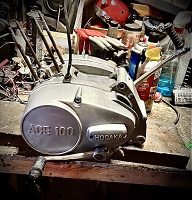

Well the cylinder went off to Terry on Monday. While I was waiting, I put the bottom end back together. However, upon installing the kick lever, even with a new spring, the kick lever was not properly returning.
So I split the cases, pulled the O-ring out from the case & found the O-ring had hardened & was binding the shaft. Luckily, I had a 1/2 dozen extra.
I replaced the O-ring with another new, but softer one & a little grease on the shaft. And it seemed to slide thru smoother. Reassembled the bottom end in about 45 minutes including torque-ing & installing covers. Just waiting for the cylinder to come back with another piston kit. :ugeek: Victor
