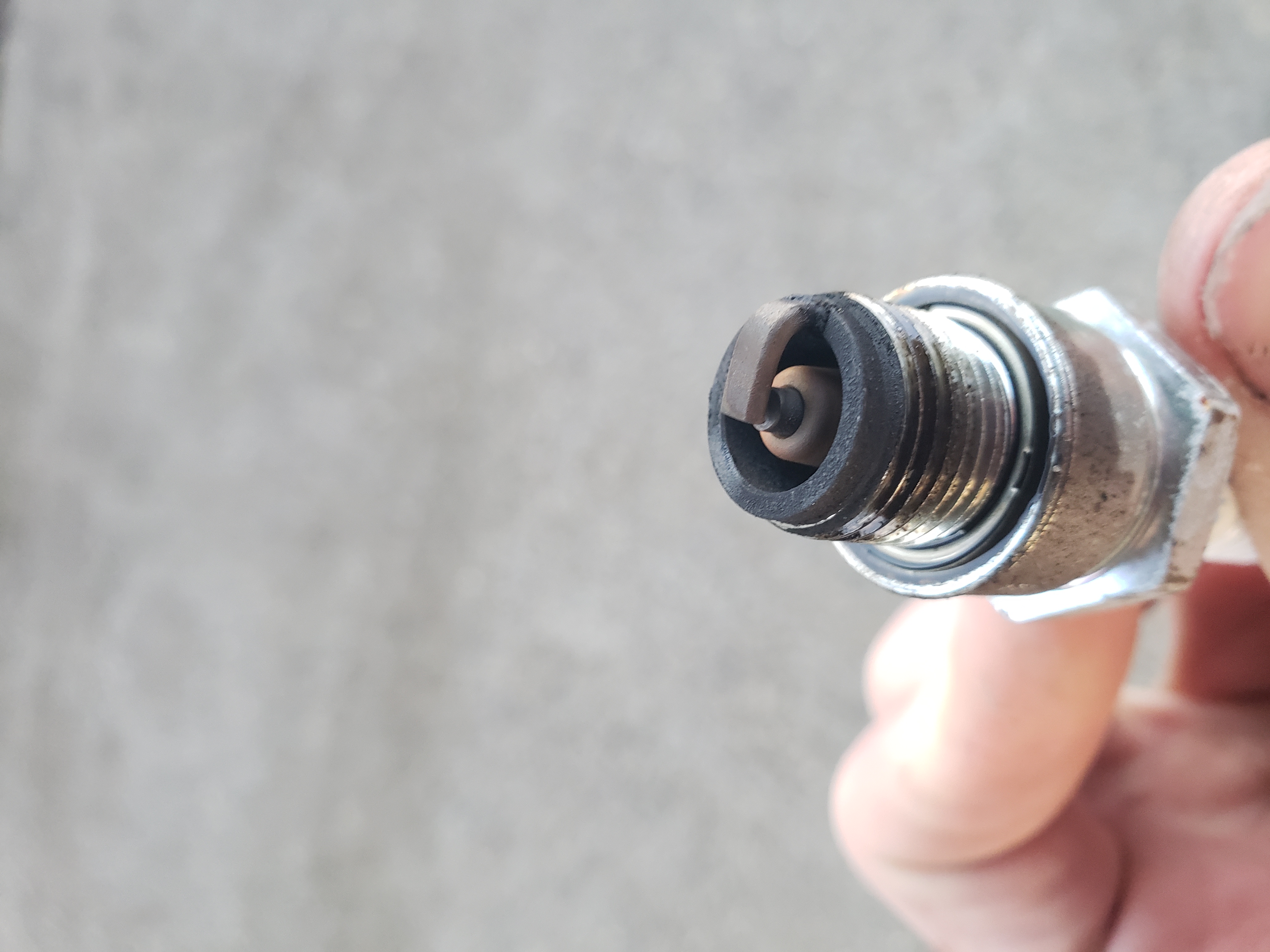

Update on the compression and other stuff. After about 7 kicks the highest reading I got was 130 psi. Seems fine to me. Not sure how tight the gauge needs to be in the plug hole but it was only hand tightened, so it might have leaked a bit. Spark plug looks great according to the reference pictures I've found online. Seems that the mixture is perfect. I have 36 miles on the trip meter now so I'm sure if anything bad is going on it would have been showing signs by now.
Thanks for the additional input and help all.
