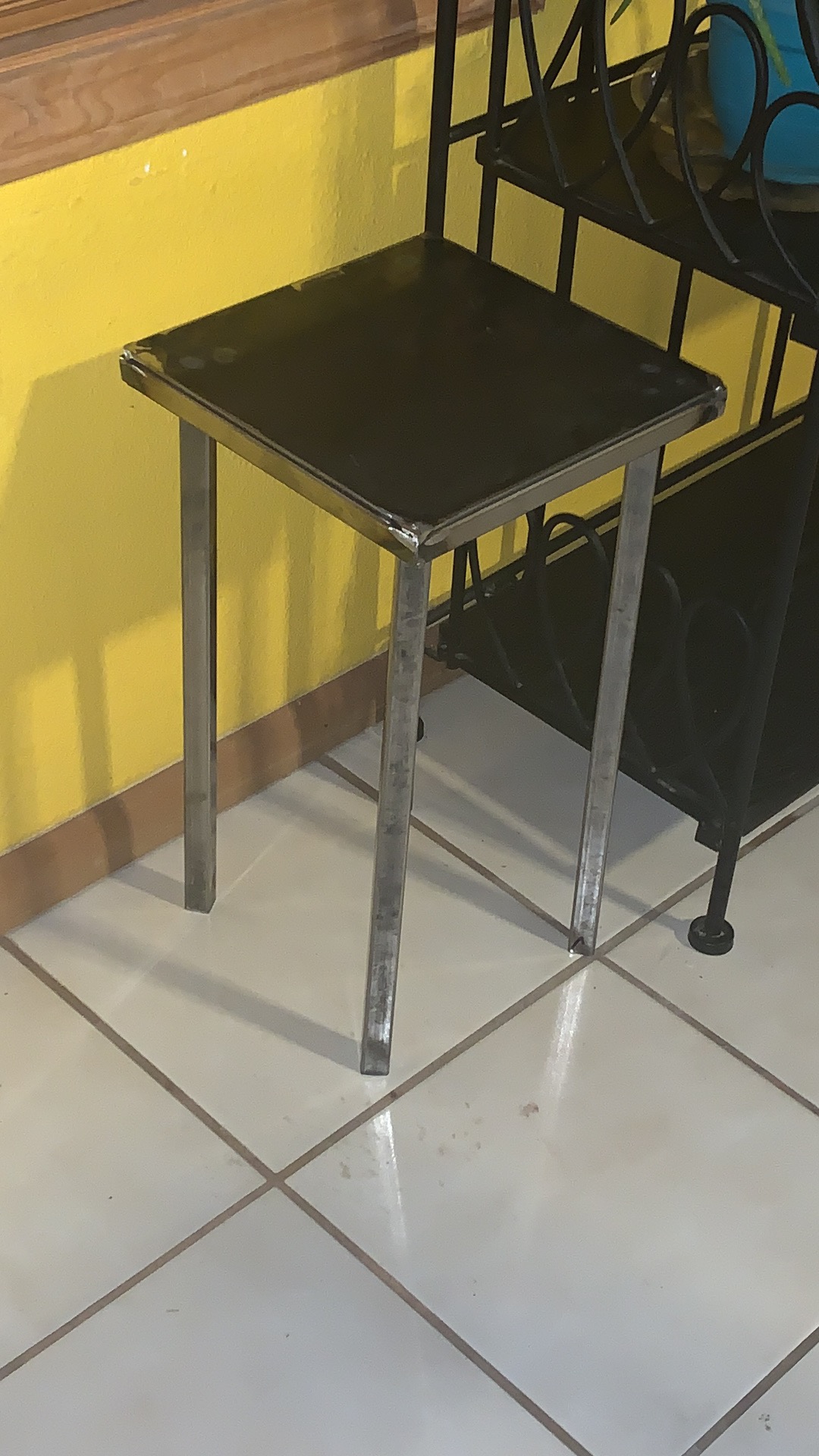

Took one, Thursday & Friday afternoons! Learned a lot, and my wife got a metal table out of it!
Now I can do some more practice welding & do a good job replacing my kick stand brackets. :ugeek: Victor

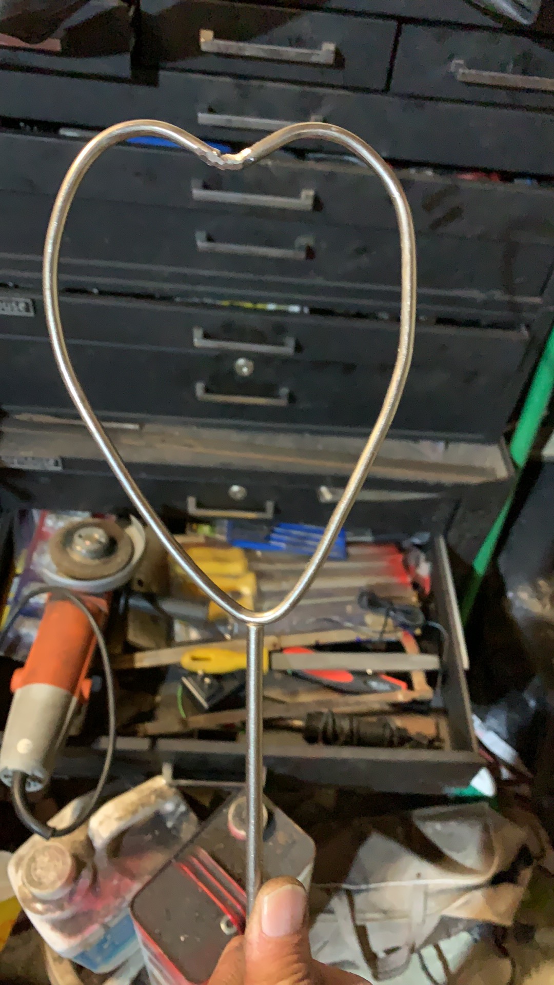

Tonight I did 2 welding jobs. I welded a fire umbrella to a 3/4” pipe. There was a plastic orange cap which I slid up the umbrella shaft. Welded the umbrella to the pipe & ground the welds down in order to pull the cap. Ask down over the joint.
And I took a 2 hot dog fork and bent it into the shape of a heart and welded it together!
The young lady I did this for us into sword swallowing. She wants to swallow the shaft with the heart on it, while she sets the heart on fire. The shaft is almost 3 feet long, so if she swallows half of it the flaming heart will stay away from her face! :ugeek: Victor

You hang with an interesting crowd, Victor.
Re: Welding class...
no disrespect victor , your doing very well getting better at welding but if i was going to stick welded metal rod down my throat id find a professional welder, just saying
Well. What can I tell you. She asked me for the favor & I said I’d try. The weld was successful and nowhere near what’s going down her throat. The part I welded becomes a ring of fire..... :ugeek: Victor

its always good to help some one out . interesting way to use your new found skill . good for you victor
