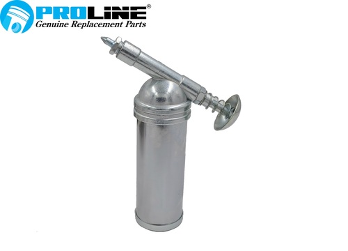

I use one of these. Made for a chainsaw bar. Works well. The pointed tip will push the zero ball in then pump the grease in.
Re: Zerk fittings
Just replace your grease gun tip with a pointed tip (pointed and not the needle type). Works well.

DITTO the pointed/needle tip, often used on chainsaw bars. You can buy them separately to screw onto a standard grease gun.
Just insert the needle straight against the spring loaded ball valve in the zerk and Bob's Your Uncle. If you deviate a few degrees with the needle then it doesn't work.
