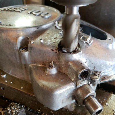

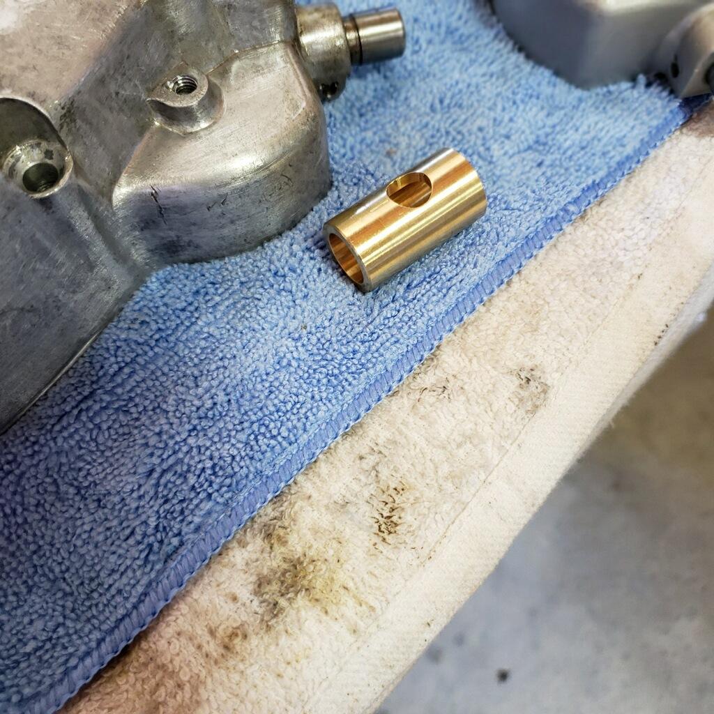

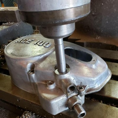

You might want to look into Boring out, and "Bearing Bush" the Shifter Shaft Hole in the Left Outer Case.
This is a Greg Watkins Fix.

Re: Engine Rebuild - Parts and Things to Check or Measure?
I wonder how long those brass sleeves last? Anyone have one that has lots & lots of miles on one to say how long they hold up without replacing? Just curious, that’s all. :ugeek: Victor
A lifetime as we ride today. The old one was steel on aluminum -------------- Clarence
What Clarence said.
If you service the shift cover as you should then there is no way it is going to wear out in our lifetime.

I guess you could wait until the STOCK (Steel shifter shaft, to Alum. case hole) wears out, then do the Mod. (it is done on the easy to removable Left shifter case.
Moxie 1944
The trouble with that is the foot change shaft wears oblong and that is not good. If you are not going to ride much, it wouldn't make much difference. -------------- Clarence
