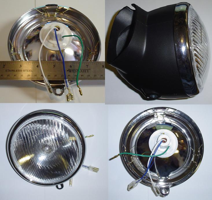

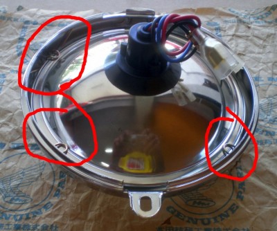

save yourself some time and grief. I wrote those articles Dale mentioned above and I can tell you that the Honda CT90/110 bulb is the way to go. You can purchase aftermarket replacements for the Honda bulb at DRATV.com part# 400019. or you can find them on eBay. (the black housing is not included)
Make sure you purchase new 6v 35/35w bulbs with it, they come with 12v bulbs.
Remove the Honda trim ring, replace it with your Wombat trim ring AFTER you have cut the brackets out. Mount it into the wombat ring just like the honda ring was mounted using the mounting springs.
(NOTE: The lens, reflector, and bulb are positioned to properly aim the hi/low beam and if they move, your beam will be off. I would mark the lens and reflector so that they can re-aligned again and use a silicon sealant to "glue" them together while you have it out.)
Trial and error will identify which wires are hi and low beam, (I don't remember). green is ground.
The CT headlights are of the same vintage and the lens/reflector can be mounted permanently since the bulbs are replaceable without ever removing the lens/reflector again. And bulbs are less than $5.00 each
