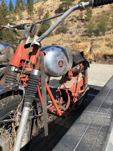

Just picked these up today. My initial assessment tells me that I have enough here to put one complete bike together and a stripped down rider.
Two Ace 100s. 2 complete engines, both stuck. 3 gas tanks the best one of which appears to be an early Super Rat tank. Headlight and taillight in the bin. Nitto tires that are holding air. Shifter cases appear to be in good condition. One front wheel and maybe the forks are not original?
Lots of good stuff here.
First step will be to get the pressure washer out. Then go through the parts tote.
I’ll keep you posted.
