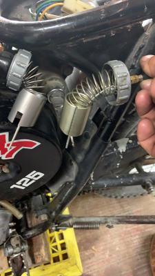

The carb is a 93B Super Rat carb. The 2.0 slide would not drop down in the slide tube and sat almost 3/8” too high. So the bike was staying at high rpm the minute it started. It would start, but the rpm would not drop. Changing to the 2.5 slide, you could see it drop down to where I’m used to seeing the slide show up.
The 94 Wombat calls for a 2.5 slide not a 2.0, while the Super Rat calls for a 2.0 slide and much bigger jets. The bike was a DPO bike. It didn’t have the VM24 SH-83B carb which was original to it.
So I had Alan change the carb to match what the 83B called for, except leaving the needle to match the needle jet. So it got a 160 main, a 25 pilot, a 2.5 slide and left the 4D3 needle with the N8 needle jet. The bike ran great! He did several laps around the track and it ran and sounded like it should.
Tomorrow, I’m going to have him clean and build to specs a VM24 SH-83B carb which he removed from another 94 Wombat. Then we will try the SH-83B carb on this Wombat and see if there are any performance differences!

Machine has an in line fuel filter. It also appears that the 2.0 slide was not traveling all the way down, possibly a binding return spring. It’s hard when troubleshooting in British Columbia when you’re in New Mexico. But I’m sure you can all appreciate that.
The best thing I can offer is I had Alan completely clean the carb, including the choke pathway. The slide which Alan told me was a 2.0 slide looked physically shorter than his 2.5 slide. Possibly he misread the slide and it was a 3.0, I keep telling Alan, “I don’t know because I wasn’t there.” So I can only report the information I was given.
But the previous slide was, indeed, much shorter than the 2.5 slide he changed to. That much I could tell because he photographed them side by side. It doesn’t mean I’m wrong, it means I was given the incorrect information. As you can see in the photo, the shorter slide on the left was in the carb. The 2.5 slide is the one on the right. Both longer & the recommended slide for a 94 Wombat with a 24mm carb. :ugeek: Victor

Is the slide on the left of the picture a correct valve for that carburetor in general?

Joe. All I can tell you is the cable was brand new. It appears the return spring inside the top of the slide was binding. But, the slide was also much shorter as shown in the photo.
Ed, thanks for the clarification on the 2.0 vs the 2.5 slides. I should have separated the comment by saying because it would not return all the way down, it was running too lean & idling too high.
In any event, putting the 2.5 slide specified for the VM24 SH-83B carb with a different spring seems to have cleared up the issues. :ugeek: Victor
Re: Carbs...carbs....carbs...
🙂 No it was not running too lean because of the 2.0 slide. It was idling wayeee too fast because the slide was not bottoming i.e. it was at a partial throttle setting of (say) 1/8th or 1/4 throttle when it was supposed to be at zero (idle) throttle. Not lean, -- advanced throttle.

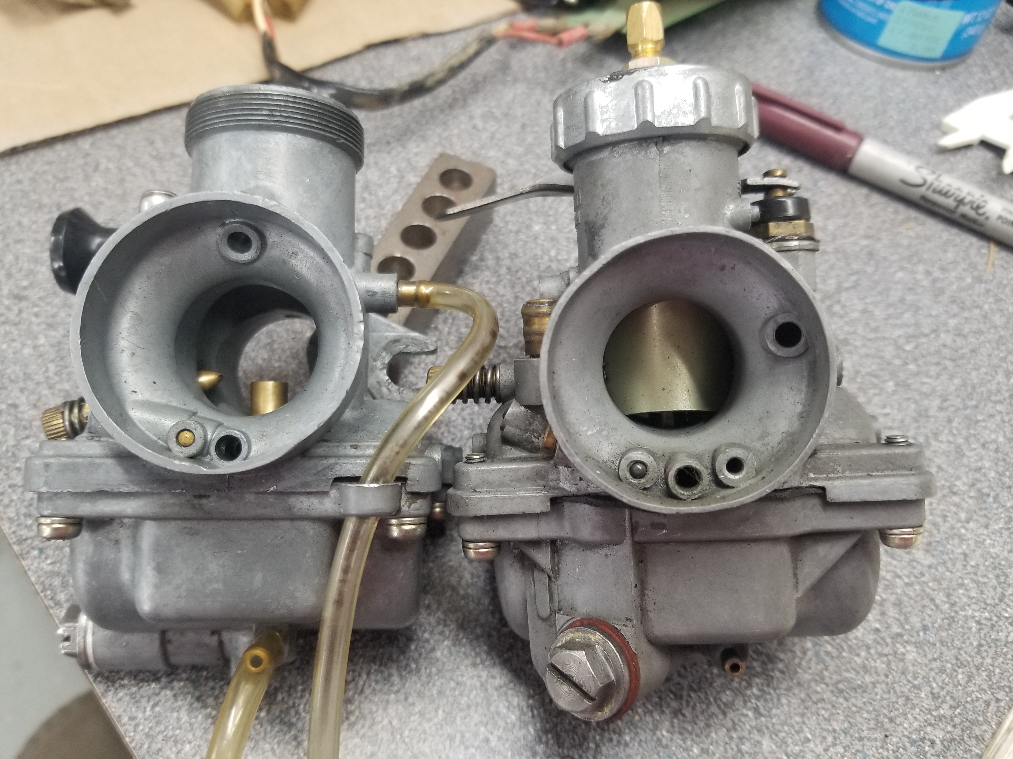

Question:
I have an early Wombat, #17 off the line. I was told the early carbs were garbage and Hodaka changed the carbs out once they figured out the problem. Anybody know anything about that?
If you look at the carb on the left, in the bottom of the venturi (below where the slide would go) you can see a brass extension of the needle jet assembly. If it is sticking up like that one, it should be one of the good ones. The carb on the right you can't tell, because the slide is in the way of seeing the brass extension. While both of those carbs appear to be 24mm, they are different models (like one from a Wombat and one from a Super Rat of other brand bike).

I also have an early Wombat with the early style carb. I've been tinkering with it off and on for years and have never been able to get it to run the way I would like. I was told about the "boat anchor carb" issue and was lucky enough to find a "good" carb on ebay. I assumed once I changed carbs the thing would run great. It did not. I followed all the jetting procedures in the Wombat manual and it runs, just not well. So I pulled out the boat anchor and set it back to stock as per the manual and put it on the bike and preliminary indications are that the bike runs much better. So yes it is a known issue and the Wombat manual gives the serial #s that are affected. In my case I'm kind of perplexed but am not going to argue with positive results.

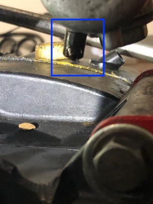

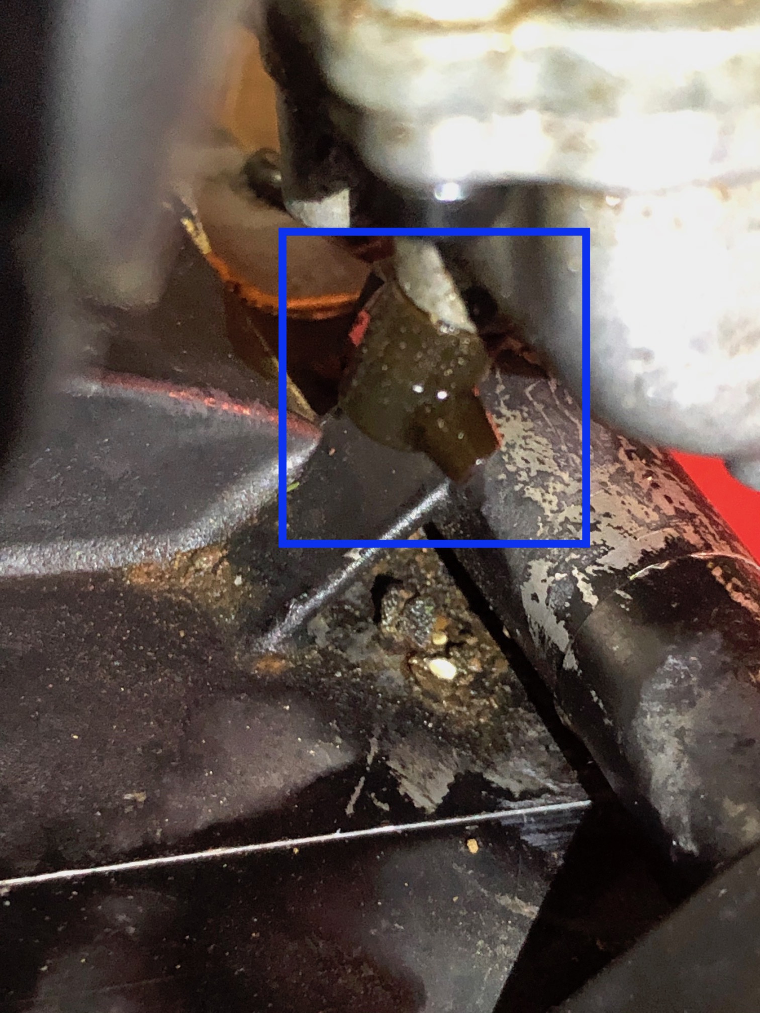

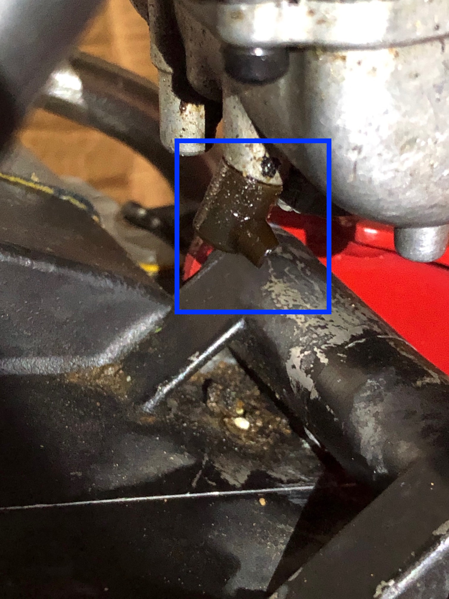

I'm new to the forum and also a first time owner of a Hodaka Road Toad (99). I'm wondering if you could help be identify an issue I'm having with my carb. When I leave the valve open on the bottom of the gas tank, I'm getting a leak out of the bottom of the carb. It appears that there's some type of zerk fitting on the bottom that's broken. It's located right next to the drain plug. Any ideas what this part might be? I'm trying to find a replacement for it, but can't find a good schematic that shows the bottom of the carb.
Thanks in advance for the help.
Dan
That appears to be just the carb bowl overflow. There is usually a short length of tubing to drain over the back side of the motor. The issue is most likely from the float valve and seat not sealing and shutting off the gas flow when the floats put pressure on it. Could also be a leaking float but less likely.
The float valve might just need a good cleaning. Replacements are also available.

I have one of the 'boat anchor' carbs. What parts need to be replaced to make it work right?
Methinks you may be missing the point about the boat anchor/paper weight carb. NO one has found the proper mix of parts to make it run right (not even Harry Taylor).
