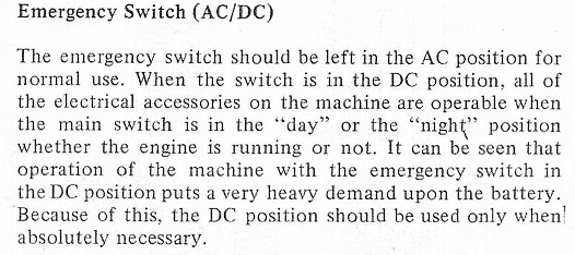

With the e-switch in the dc position should the headlamp come on with the keyswitch in the "day position" ?

Is your keyswitch 94 or 94A? On my 94A, the toggle switch DC position turns on the headlight in both 'Day' and 'Night' key position. The 94A is a lights on all the time bike and the keyswitch is different internally than the 94. Day and Night positions are essentially the same on the 94A.

Let me say that now I'm not sure about the 94A keyswitch being different. And I'm not sure about daytime running lights on the 94A either. I'm doing the final assembly on my 94A now (I haven't ridden it since the late '70s!!). Memory fades in 40 years. So I won't know about operation with AC until I start it. I'm sure there are others here who know for sure.

Well, looks as if I would have found that paragraph I wouldn't have had to ask the question. Thanks for posting it. Could you do me a favor and look at the brown wire connector in your headlamp and tell me if it has space for three or four wires? Just curious. D
