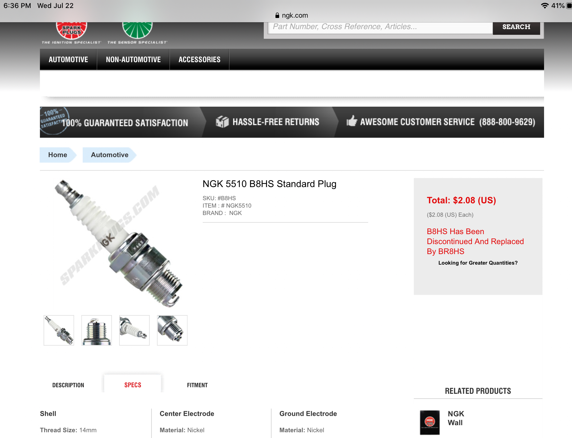

NGK B8HS discontinued
Post by Tether »
The B8HS has been discontinued and replaced with the BR8HS a resistor plug. I has always been my understanding that resistor pugs were not a good choice with the old points ignition.
